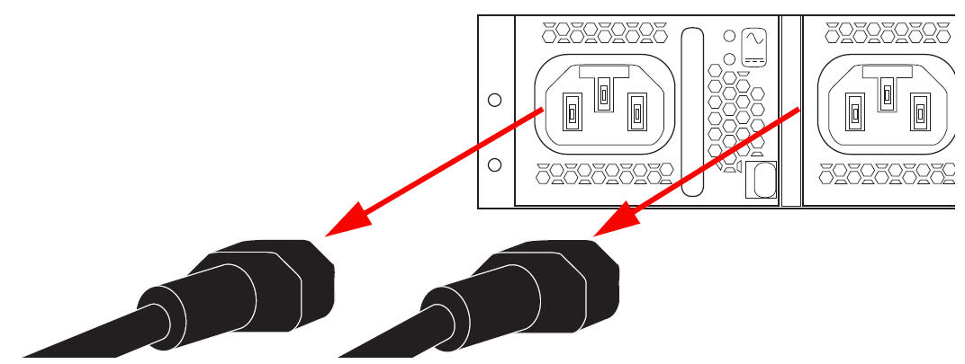

  1. Remove the AC or DC power cables from the power supplies.
    Figure 5-1 Removing the Power Cords
    This diagram shows the power cords being removed.

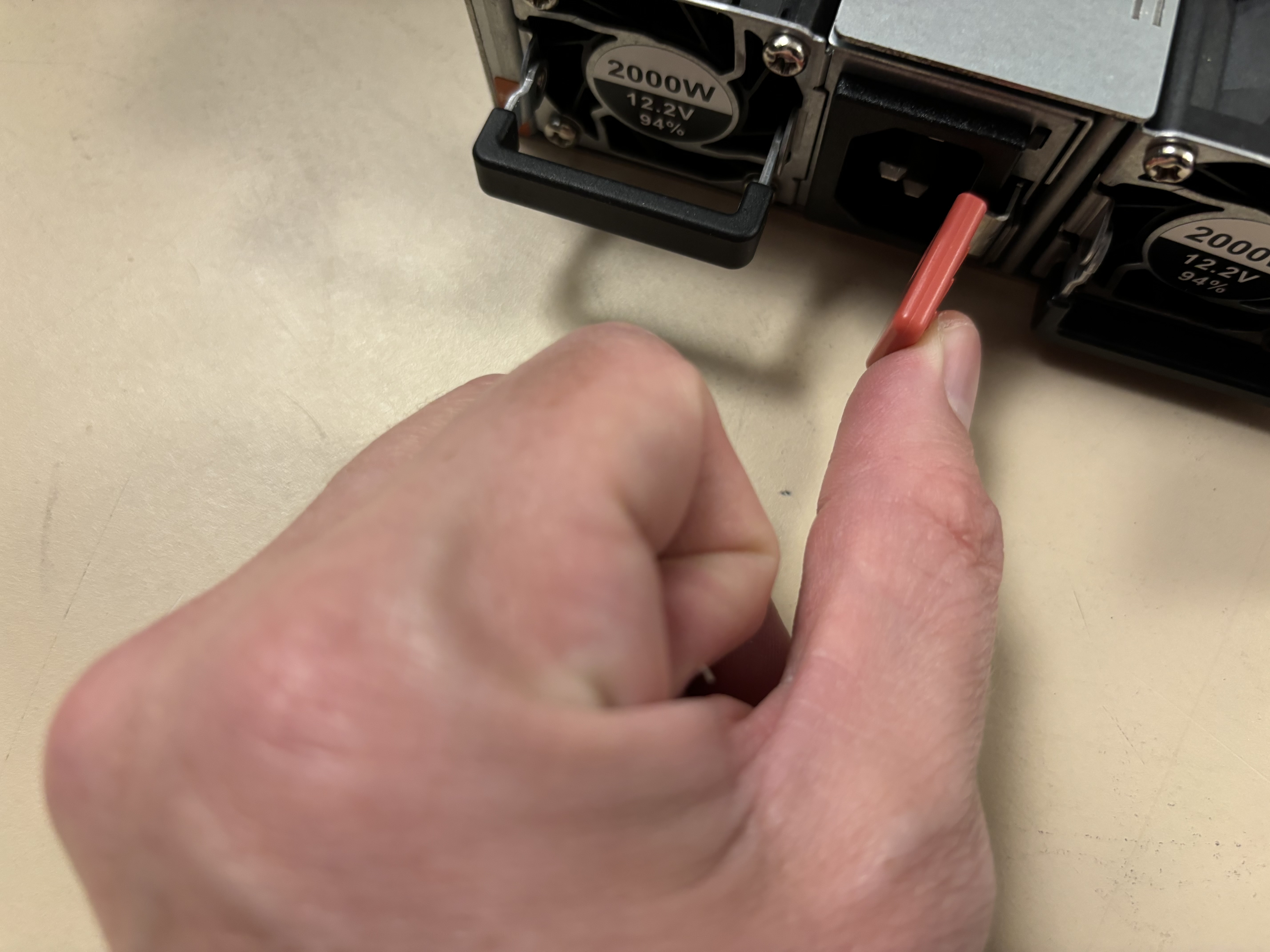

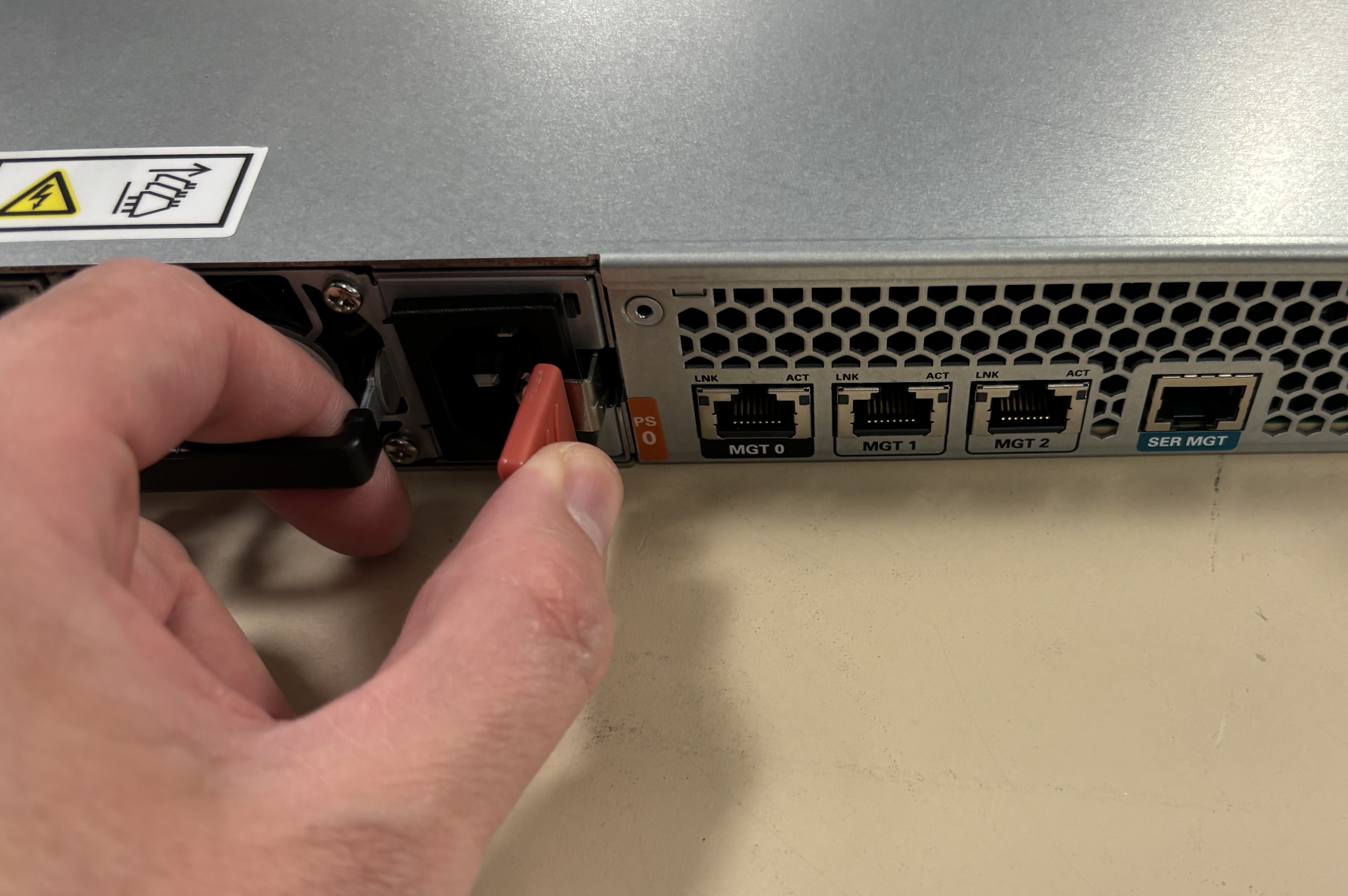

  2. With your thumb, push the red locking tab to the left to unlock the power supply from the chassis.
    Figure 5-2 Releasing the Locking Tab
    This diagram shows how to properly release the locking tab.

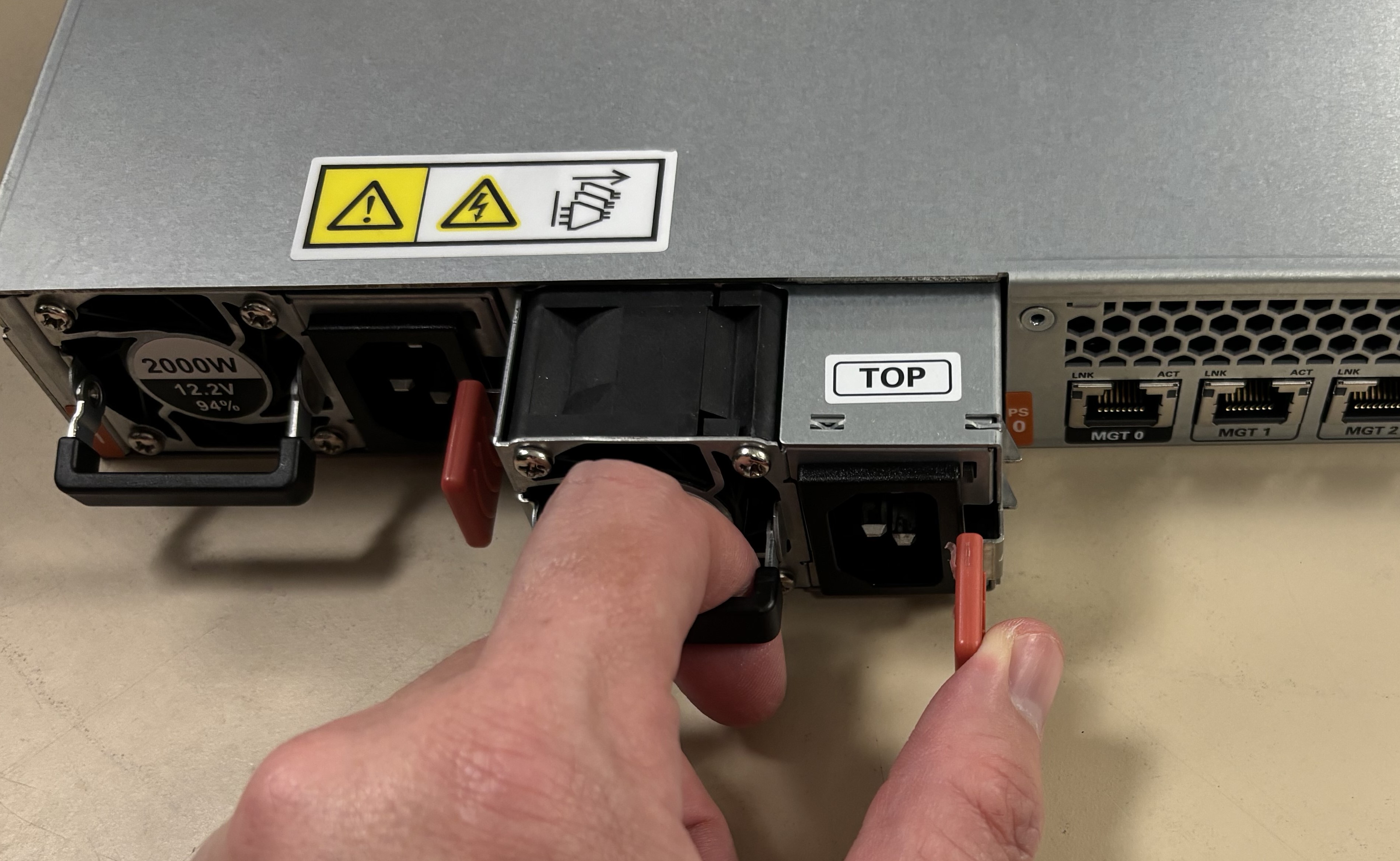

  3. Holding the handle, pull the power supply towards you. This will disengage the power supply from the chassis.
    Pull handle
  4. Continue pulling the power supply towards you until it is completely removed from the chassis.
