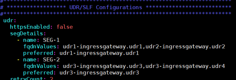

- In the initial deployment, there are two segments, SEG-1. SEG-2.
Figure 4-1 Segments Deployed

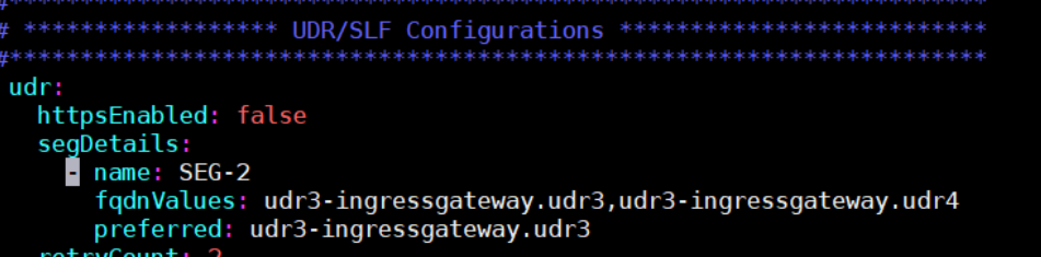

- The user identifies that SEG-1 has gone down and wants to remove it. To
remove SEG-1, user should remove the entire segment configuration details
from the .yaml file as shown below:
Figure 4-2 Removing Segment Details
