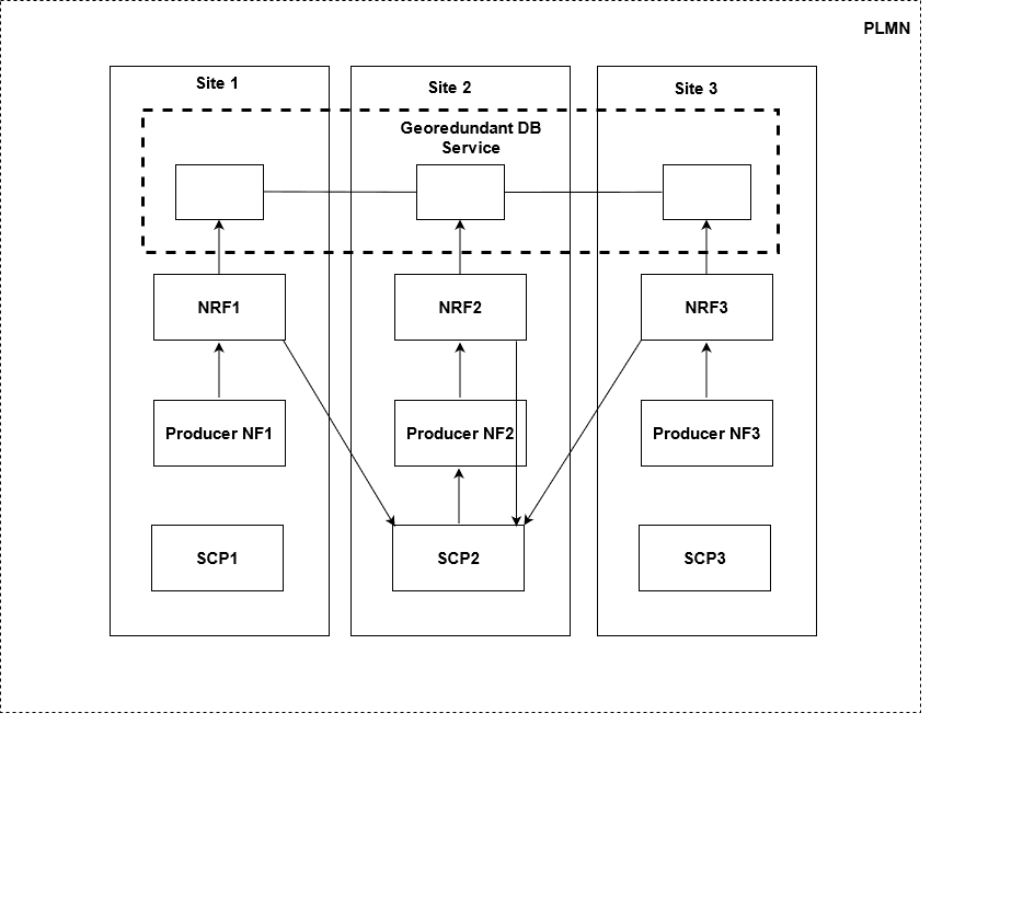

Producer NF Registration Notification from NRF to SCP
The following image is an example of a scenario that describes how SCP receives producer NF registration notifications from NRF instances.
Figure 9-1 Producer NF Registration Notification from NRF to SCP
There are three NRF instances, NRF1, NRF2, and NRF3, which are deployed as georedundant NRFs across three sites, in an NRF set. SCP1 and SCP3 do not establish communication with the corresponding NRF instances such as NRF1 and NRF3. However, SCP2 subscribes with NRF2 for all changes for 5G NF types. When producer NF1, NF2, and NF3 register with NRF1, NRF2, and NRF3, respectively, SCP2 receives notification regarding producer NF1, NF2, and NF3 registration from NRF1, NRF2, and NRF3.
SCP uses the nfStatusNotificationUri callback URI to receive notifications from NRF. nfStatusNotificationUri notifies SCP about registrations, deregistrations, or profile changes of any NF profile. To subscribe to NRF notifications, SCP uses the POST method.
The following format of the callback URI is used by SCP in Subscription requests:
http://<scp-worker FQDN or IP>:<scp-worker
    Port>/ocscp/scpc-notification/v1/notification/<nrfRegionSetID>/<nftype>/<UUID>
Where,
  • The FQDN or IP address is determined by the deployment configuration.
  • scp-worker Port indicates the service port of SCP-Worker.
  • nrfRegionSetID indicates the NRF's region or SetID based on the NRF configuration used during deployment.
  • nfType indicates the NF type to which the Subscription is sent.
  • UUID is the Universally Unique ID.
SCP can process notifications containing full NFProfiles that is nfProfile or partial profiles that is profileChanges. For more information about nfStatusNotificationUri, see 3GPP 29.510.

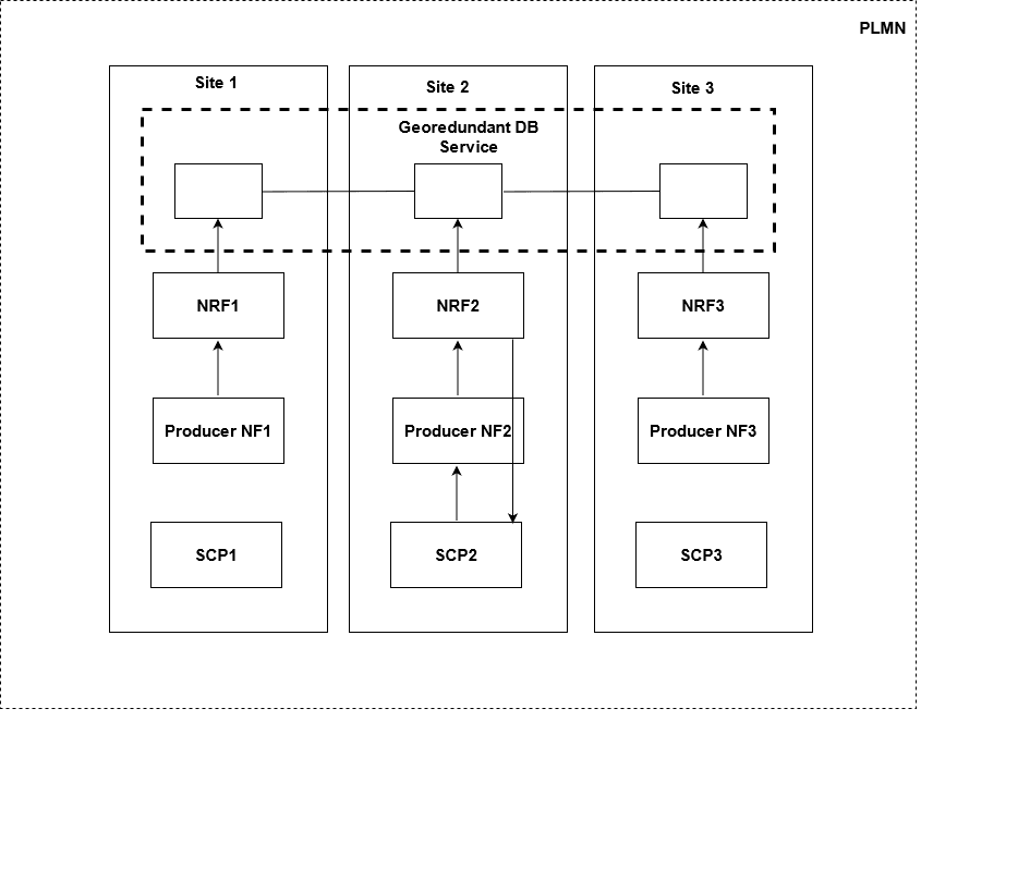

5G NF Topology Audit Response from NRF
The following image is an example of a scenario that describes how SCP receives 5G NF topology audit response from NRF.
Figure 9-2 5G NF Topology Audit Response from NRF
There are three NRF instances, NRF1, NRF2, and NRF3, which are deployed as georedundant NRFs across three sites, in an NRF set. Producer NF1, NF2, and NF3 register with NRF1, NRF2, and NRF3, respectively. SCP1 and SCP3 do not establish communication with the corresponding NRF instances such as NRF1 and NRF3. When SCP2 performs period audit for 5G NF types with NRF2, SCP2 receives audit response from NRF2 with all producer NF1, NF2, and NF3 irrespective of where they are registered.
