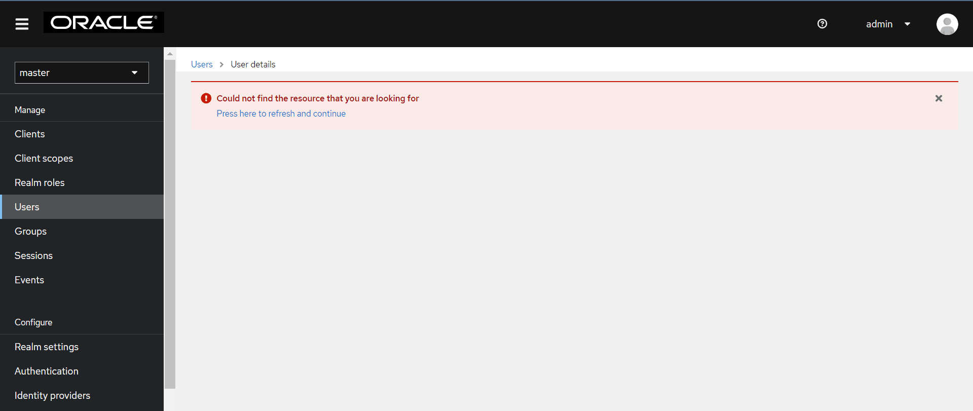

4.3 Admin user created under CNC Console realm is unable to access CNC Console IAM
Problem: The user with ‘Admin’ privileges is unable to access CNC Console IAM.
Solution: Users created under the Cncc realm have access only to CNC Console Core and not to CNC Console IAM. To access CNC Console IAM, create the admin user under the Master realm.

4.28 CNC Console IAM GUI gives an error while accessing some resources under master realm
CNC Console IAM GUI gives an error while accessing some resources under master realm.
Problem:
CNC Console IAM GUI throws the following error when some resources are accessed under the master realm:
"Error: Could not find the resource that you are looking for. Press here to refresh and continue."
Solution:
Some resources (APIs) are blocked under the "master realm" or "cncc realm" because of security reasons. This restricts the user from making any configuration changes. These resources are not applicable for Console. So, whenever the user tries to access blocked resources(APIs), the admin user always gets the error message asking the user to refresh and continue. It is expected behavior. Also note that CNC Console IAM is enabled with a single admin user. All admin operations must be carried out by the same admin user.
Figure 4-1 Unable to Find Resource Error
Unable to find resource error
