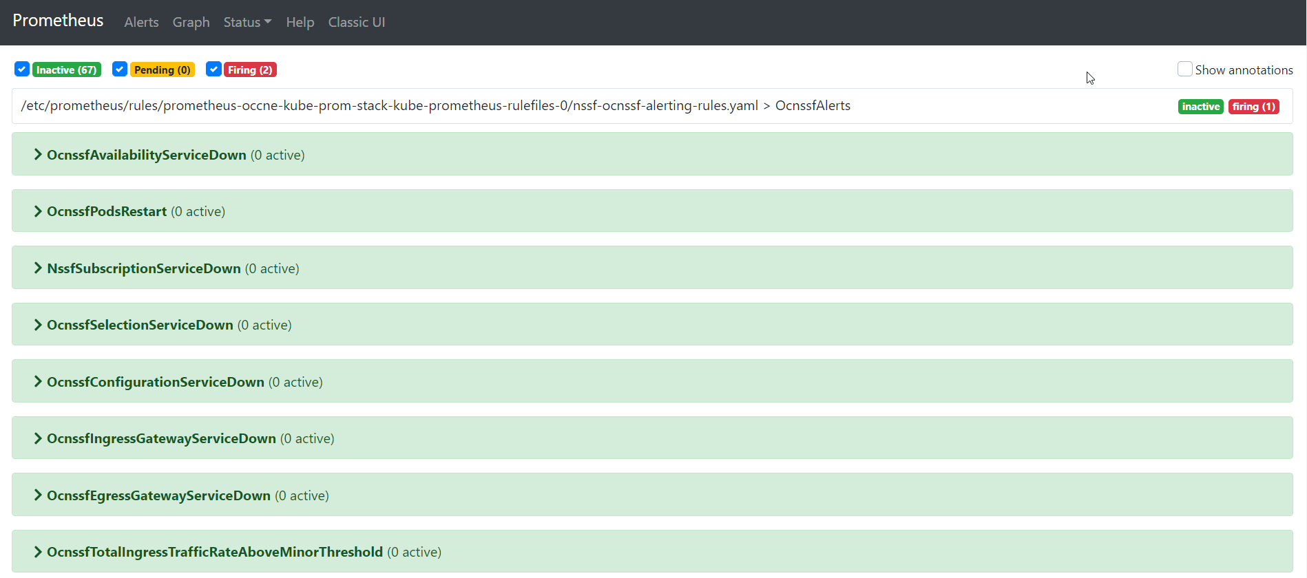

$ kubectl get prometheusrules --namespace <namespace>Example:
$ kubectl get prometheusrules --namespace ocnssfSample output:
NAME AGE nssf-ocnssf-alerting-rules 1m - Log in to Prometheus GUI and verify the alerts section.
The alert configuration file must be loaded as shown in the figure.
The Prometheus server takes an updated configuration map that is automatically reloaded after approximately 60 seconds. Refresh the Prometheus GUI to confirm that the NSSF Alerts have been reloaded.Steps to Check Alerts in Prometheus

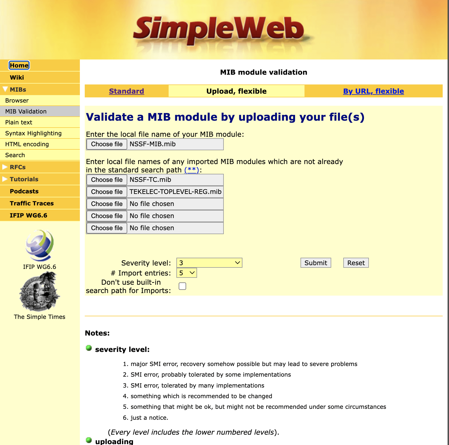

Procedure to Validate MIB Files
This procedure explains how to validate the MIB files and how to fix some common errors.
- Download MIB Files: Download the MIB files onto your PC. In the NSSF
                    environment, the files are named as follows:
- NSSF-MIB.mib
 - NSSF-TC.mib
 - TEKELEC-TOPLEVEL-REG.mib
These files are located in the path /ocnssf/observability/mib.
 - Open Simpleweb MIB Validator: Open the Simpleweb MIB validator page.
 - Upload MIB Files:
- Under "Enter the local file name of your MIB module," click the "Choose File" button.
 - Select the MIB file you want to validate, click "Open," and the file will be added to the web page.
 - Inspect MIB Definitions:
- Open the MIB file on your PC using any suitable application.
 - In the "IMPORTS" section, identify the MIB definitions listed after the word "FROM."
 - Skip standard MIBs such as "SNMPv2-SMI," "SNMPv2-TC," etc., as they are already included in the Simpleweb MIB validator by default.
 - Handling Private MIBs:
- For other MIBs, especially private MIB files, locate the corresponding MIB file for each definition.
 - If the MIB file names differ from the MIB DEFINITIONS, rename the file
                            as <MIB definition>.mib. For example:
- Original MIB file name: Private-MIB-File.mib
 - MIB definition in "IMPORTS" section: FROM PRIVATE-MIB Rename the file to: PRIVATE-MIB.mib
 - Upload Corrected File Names:
- Upload the corrected file names into the Simpleweb MIB validator. In NSSF, the corrected file names will be NSSF_MIB.mib, NSSF-TC.mib, TEKELEC-TOPLEVEL-REG.mib.
 - Click "Choose Files" and then click "Submit" to complete the process.
By following these steps, you can ensure the proper validation of MIB files, including the handling of standard and private MIBs.
