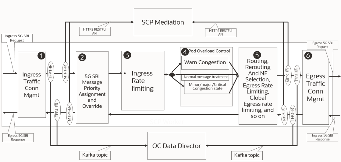

SCP is a decentralized solution composed of control plane and data plane. This solution is deployed with 5G Network Functions (NFs) for providing routing control, resiliency, and observability to the core network.
Figure 2-1 Service Communication Proxy Architecture
The SCP solution is deployed either as a default outbound proxy to NF instances or as a router model, where SCP is configured as HTTP2 outbound proxy at each NF in cloud native environments.
