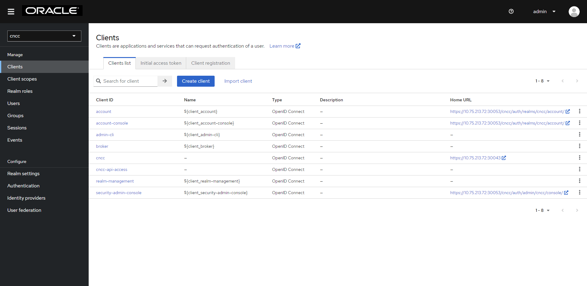

 - On the right pane, click Clients. The following screen
                        appears:
Figure 6-1 Clients
 - Click cncc-api-access. The following screen appears:

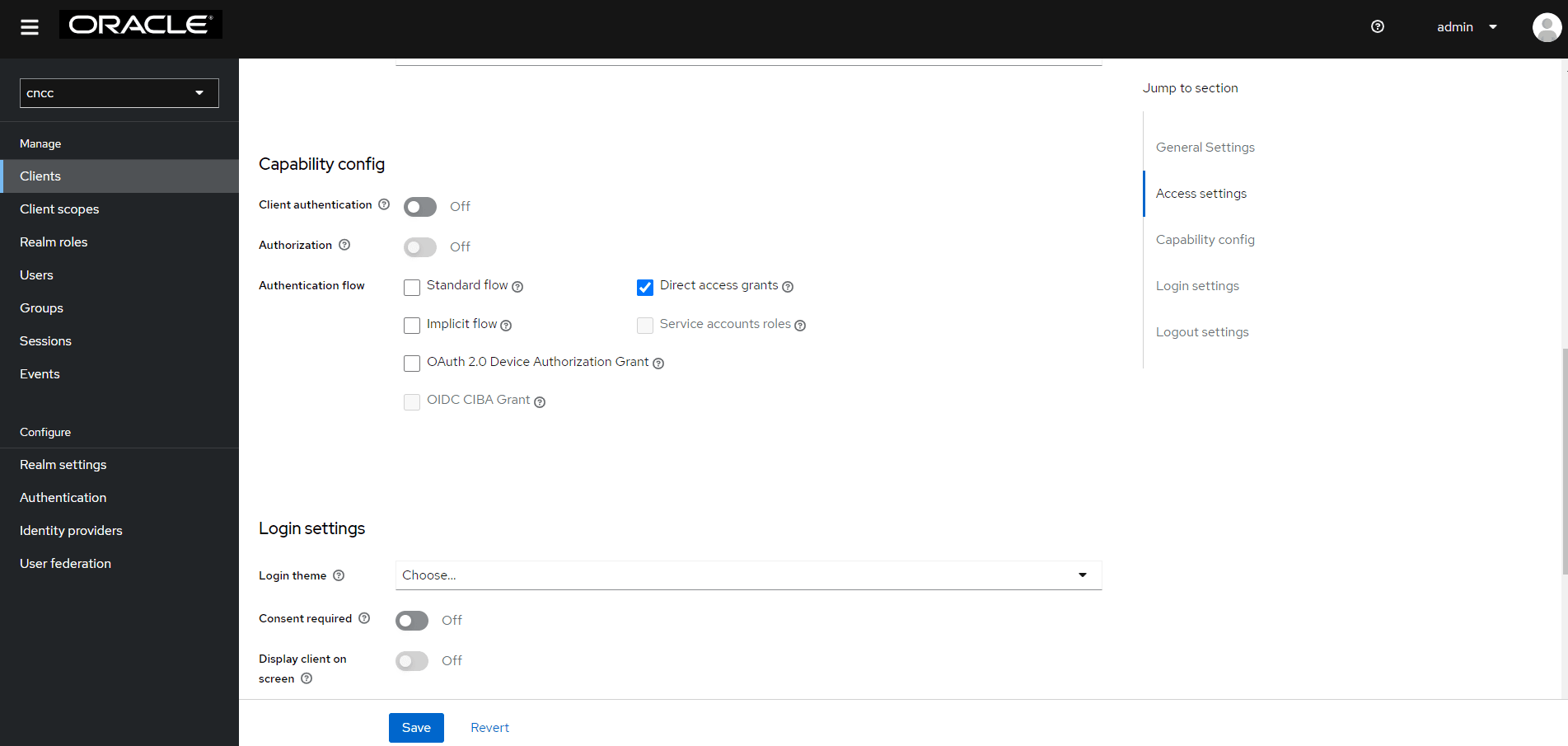

 - Navigate to the Capability config section in the Settings tab and
                    select the Direct Access Grants checkbox. Click Save.
Figure 6-3 Direct Access Grants
