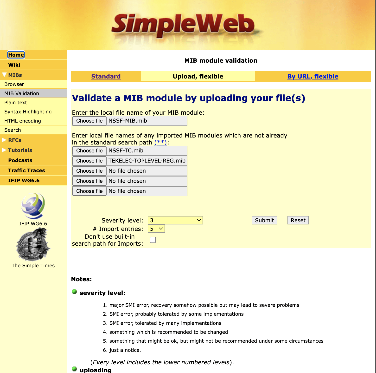

The SNMP MIB files are used to define the MIB objects. When uploaded to Wireshark and MIB tools, such as MIB Browser and Trap Receiver, users can see the detailed MIB definition instead of just the OID. All tools require the valid syntax of MIB files, and even minor errors can cause the upload to fail.
Procedure to Validate MIB Files
This procedure explains how to validate the MIB files and how to fix some common errors.
- Download MIB Files: Download the MIB files onto your PC. In the NSSF
environment, the files are named as follows:
- NSSF-MIB.mib
- NSSF-TC.mib
- TEKELEC-TOPLEVEL-REG.mib
These files are located in the path /ocnssf/observability/mib.
- Open Simpleweb MIB Validator: Open the Simpleweb MIB validator page.
- Upload MIB Files:
- Under "Enter the local file name of your MIB module," click the "Choose File" button.
- Select the MIB file you want to validate, click "Open," and the file will be added to the web page.
- Inspect MIB Definitions:
- Open the MIB file on your PC using any suitable application.
- In the "IMPORTS" section, identify the MIB definitions listed after the word "FROM."
- Skip standard MIBs such as "SNMPv2-SMI," "SNMPv2-TC," etc., as they are already included in the Simpleweb MIB validator by default.

- Upload Corrected File Names:
- Upload the corrected file names into the Simpleweb MIB validator. In NSSF, the corrected file names will be NSSF_MIB.mib, NSSF-TC.mib, TEKELEC-TOPLEVEL-REG.mib.
- Click "Choose Files" and then click "Submit" to complete the process.
