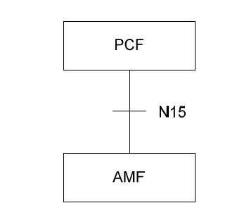

Policy implements Access and Mobility (AM) management service related policies over the N15 interface towards Access and Mobility Management Function (AMF).
The following figure describes the communication between PCF and AMF over the N15 interface:
Figure 3-3 Communication between PCF and AMF over N15
AMF can perform the following functions:
- Enforcing control of policy decisions related to Radio Access Technology (RAT) or Frequency Selection Priority.
- Enforcing Service Area Restrictions. It is executed in User Equipement (UE).
- Enabling location tracking for a UE to get periodic updates on the current location of a subscriber.

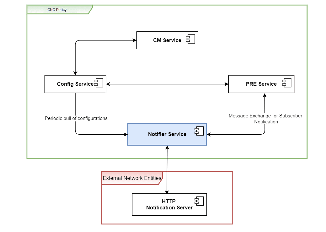

Policy Notifier service is an optional service that allows Policy to send notifications to the subscribers about their current data usage. This service is independent of deployment mode and can be enabled in all the supported deployment modes.
As part of subscriber quota management and based on the defined policies, the user is notified about their current usage at various levels. For example, when a user consumes 80% of the granted quota, a notification must be sent to notify the user about its usage. Similarly, when they reach or exceed the threshold, a notification must be sent informing the user about reduced quality of service or even suspension of service. With the Notifier service, Policy can send either HTTP notification or short messages (SMS) using SMPP to subscribers, based on the policies configured by operators, through an external notification server.
In the current release, Policy supports subscriber notification only using HTTP and SMPP protocols.This feature is supported only for PCRF-Core call flows.
The following diagram shows how Notifier Service fetches configurations from Config service and on receiving notification request from PRE, sends out the notification to the subscriber via external notification server:
Figure 3-4 High Level Notifier Service Diagram

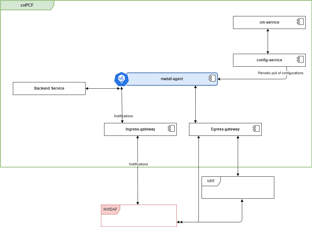

3.6 NWDAF Agent
Policy 22.4.0 includes phase one implementation of Policy integration with NWDAF for testing purposes.It also queries Network Repository Function (NRF) client for fetching NWDAF information. For NWDAF, autonomous NRF discovery and static configuration is only supported, on-demand is not yet supported. For more information on autonomously discovered NF profiles for NWDAF, see Discovered NF Instances.
A 5G network contains a vast number of devices and sensors generating an enormous amount of data. The NWDAF Agent allows the Communications Service Providers (CSPs) to efficiently monitor, manage, automate, and optimize their network operations by the data collected and analytics generated across the network. It also helps the CSPs in achieving the operational efficiency and provides an enhanced service experience. Currently, NWDAF Agent supports slice load level analytics as part of the analytics data that is provided from NWDAF.
Figure 3-6 Interaction between Policy and NWDAF Agent

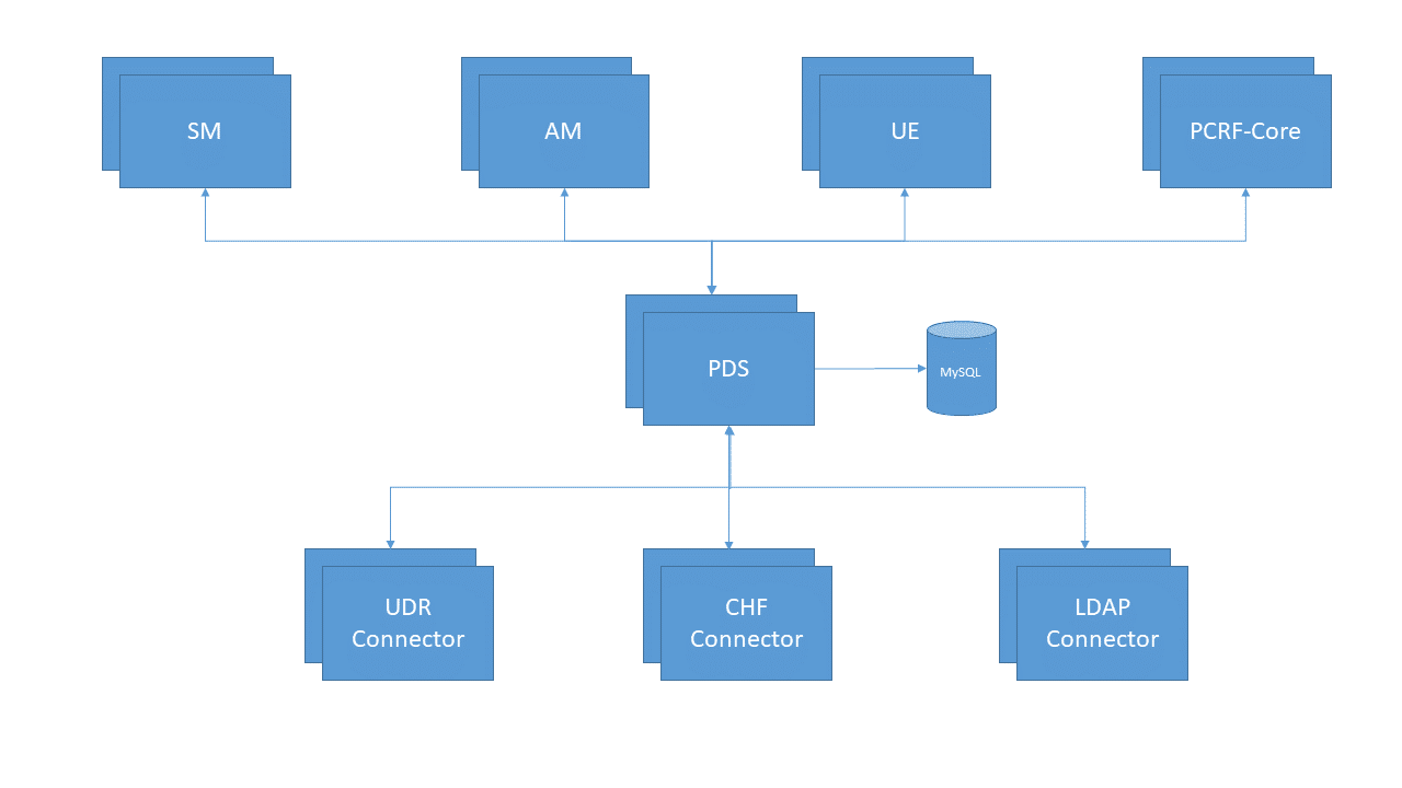

Policy Data Source Service (PDS) is an intermediate layer which interfaces Core Services (SM/AM/UE/PCRF-Core) with the protocol specific connector layers (UDR/CHF/LDAP Connectors). PDS also holds the subscriber information in its database when a new session gets established for a given subscriber and cleans-up the information when the last session termination happens. PDS is also responsible for storing the Subscriber State Variables except session level in its database and provides these variable information across multiple core services which requests the information.
You could define the workflows for PDS and the workflow would define the flow of request processing. This workflow is internal to the PDS project and should consult with engineering team for any update.
The following figure depicts the PDS architecture:
Currently, PDS supports SUPI/GPSI as the search key. It does not support NAI as the search key.UDR Connector- UDR Connector is a protocol specific layer which converts the request send by PDS to nUDR specific format and forwards to real UDR for subscription information. It also provides an ability to subscribe for profile change at UDR.
Figure 3-8 PCF-AMF communication
PCF UE Policy service performs the following functions:

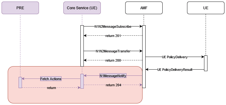

Figure 3-11 UE and PRE interaction
- Write successfully the installed UPSI as a string value in VSA and update it to UDR.
- Define remote state variables, set values to variables and write in VSA and update it to UDR.
- Write successfully the installed UPSIs and UEPolicySection in UDR using the 3GPP Attributes-Non Fragmented or Fragmented (at message level).
- Write successfully the installed UPSIs and UEPolicySection in UDR using the 3GPP Attributes.
- Retransmit the failed UPSIs or new UPSIs, based on conditions like PLMN, SUPI, the failed UPSIs.
- Skip the retransmit of UPSIs, based on conditions like PLMN, SUPI, the failed UPSIs.
- Abort the transaction of transferring the UEPolicy in N1N2Message based on conditions like PLMN, SUPI, the failed UPSIs.
- Define remote variables other than UPSI, set values to variables and write in VSA and update it to UDR.
