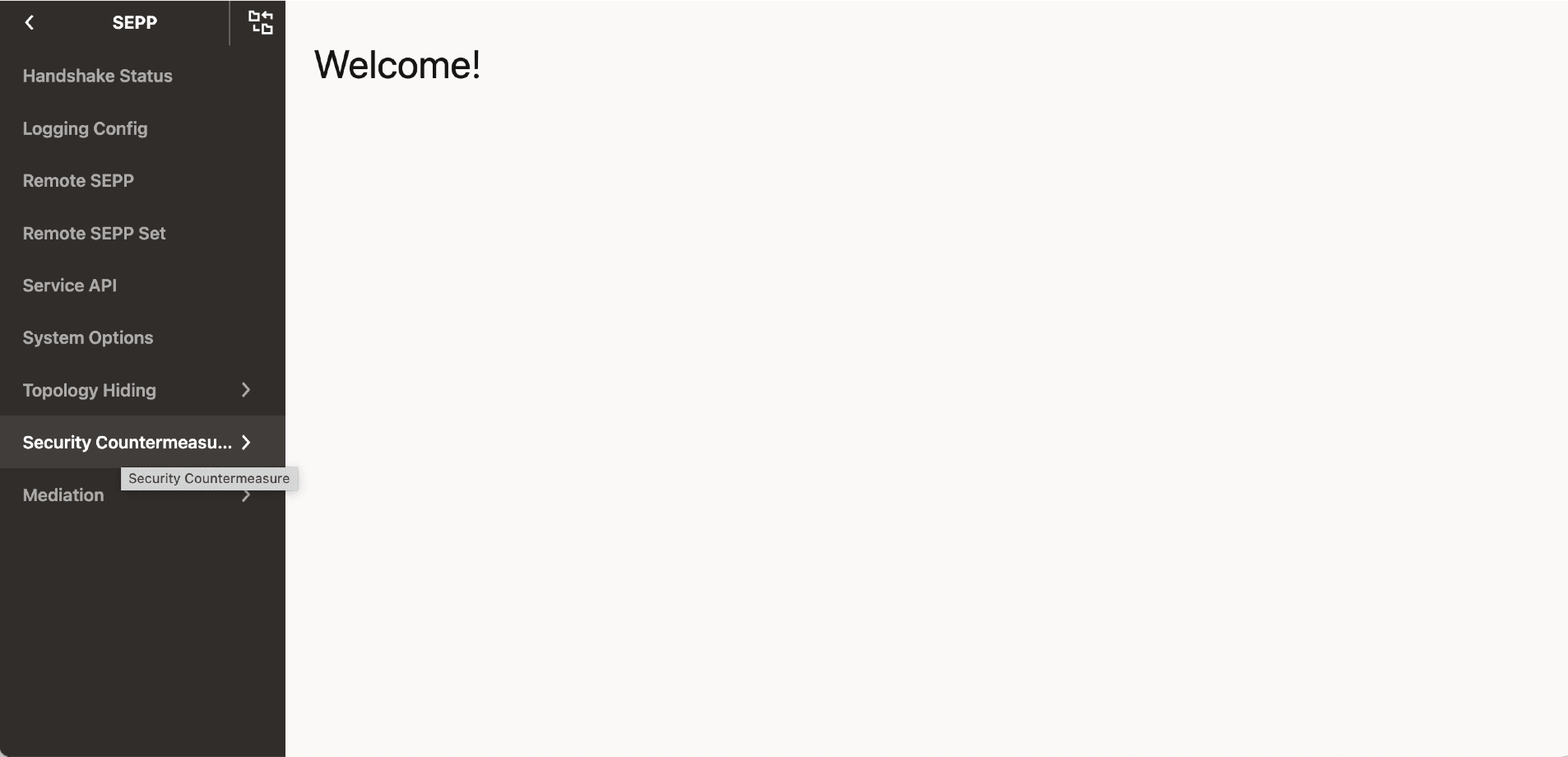

On selecting SEPP from the drop-down list, the following screen appears:
Figure 4-3 SEPP Welcome Screen
img/sepp-cncc-22.4.0.png

4.2.8 Security Countermeasure
The Security Countermeasure option is used to enable and configure the Cat-0 SBI Message Schema Validation feature, Cat 1 -Service API Validation feature, Cat 2 – Network ID Validation feature, and Cat 3 – Previous Location Check feature.
The Service API Allowed List REST API is used to do the configurations on the allowed list of REST APIs.
4.2.8.1 Cat 1 -Service API Validation
The Security Countermeasure option is used to enable the Cat 0 - SBI Message Schema Validation feature, Cat 1 -Service API Validation feature, Cat 2 – Network ID Validation feature, and Cat 3 - Previous Location Check feature.
Perform the following procedure to do the Cat 1 -Service API Validation configurations:
  1. From the left navigation menu, navigate to SEPP and then click Security Countermeasure.
  2. Click Cat 1 -Service API Validation under Security Countermeasure, Option page appears on the right pane.
  3. Set Security Countermeasure parameter to True to enable the Cat 1 -Service API Validation feature.
  4. Click Service API Allowed List under Cat 1 -Service API Validation, the Service API Allowed List page appears on the right pane.
  5. Click Add from the top right side to add or update the allowed REST APIs and supported methods.

  1. From the left navigation menu, navigate to SEPP, and then click Security Countermeasure.
  2. Click Cat 2 -Network ID Validation under Security Countermeasure, the Option, Cat 2 -Network ID Validation List , Header, and Body IE appears underneath.
  3. Click Cat 2 -Network ID Validation List , the Cat 2 -Network ID Validation List page appears on the right pane.
  2. Click Cat 3 - Previous Location Check feature under Security Countermeasure, the Trigger List appears underneath.
  3. Click Trigger List, the Cat 3 - Previous Location Trigger List screen appears at the right pane. The Cat 3 - Previous Location Check feature details are available on the screen.
  3. Click Header, the Serving Network ID and UE ID appears underneath.
  4. Click Serving Network ID, the Serving Network ID Header details are available in the screen.

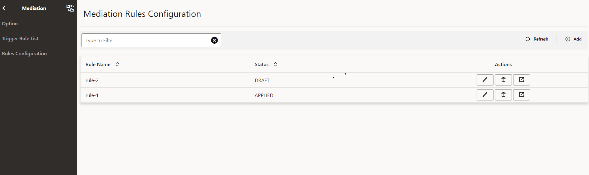

Mediation Rules Configuration
Rules configuration screen allows the user to compile, create, update, delete, clone and apply the mediation rules using CNCC.
Perform the following procedure to configure the mediation rules:
  1. From the left navigation menu, navigate to SEPP and then select Mediation. The Rules Configuration screen appears underneath.
  2. Click Rules Configuration, the list of all the existing rules with corresponding status appears.
    Figure 4-4 Mediation Rules Configuration Screen
  3. Click Add to add a new rule. The Add Mediation Rule page appears and user can add the mediation rule information.
    Figure 4-5 Add Mediation Rule Screen
    Rule Name, Format, Status, Mediation Mode, Code, and State are the mediation rule parameters.
  4. Click Edit button of an existing rule to modify that rule. The Edit Mediation Rule page appears and user can edit the rule information.
    Figure 4-6 Edit Mediation Rule Screen
  5. Click Delete button of an existing rule to delete that rule, confirmation dialog box appears and user can click OK to delete the rule or Cancel to cancel the deletion.
  6. Click View button of an existing rule to view the rule’s details.
