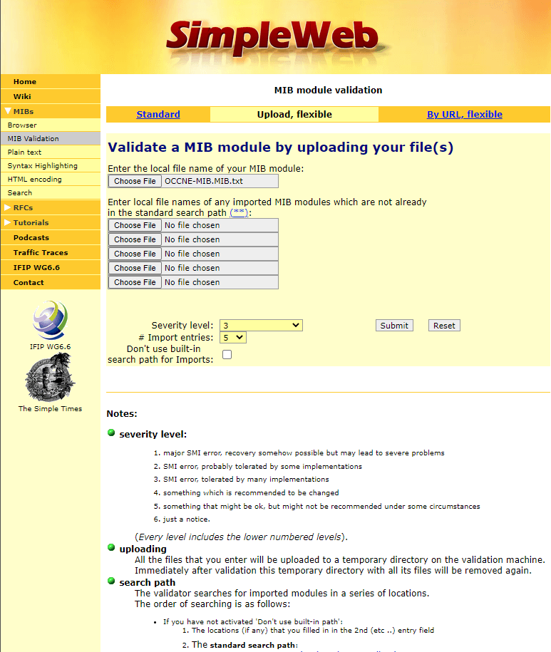

  2. Open Simpleweb MIB Validator: Open the Simpleweb MIB validator page.
  3. Upload MIB Files:
    Upload MIB
    1. Under "Enter the local file name of your MIB module," click the "Choose File" button.
    2. Select the MIB file you want to validate, click "Open," and the file will be added to the web page.

  6. Upload Corrected File Names:
    Upload MIB corrected
    1. Upload the corrected file names into the Simpleweb MIB validator. In NSSF, the corrected file names will be NSSF_MIB.mib, NSSF-TC.mib, TEKELEC-TOPLEVEL-REG.mib.
    2. Click "Choose Files" and then click "Submit" to complete the process.
By following these steps, you can ensure the proper validation of MIB files, including the handling of standard and private MIBs.
