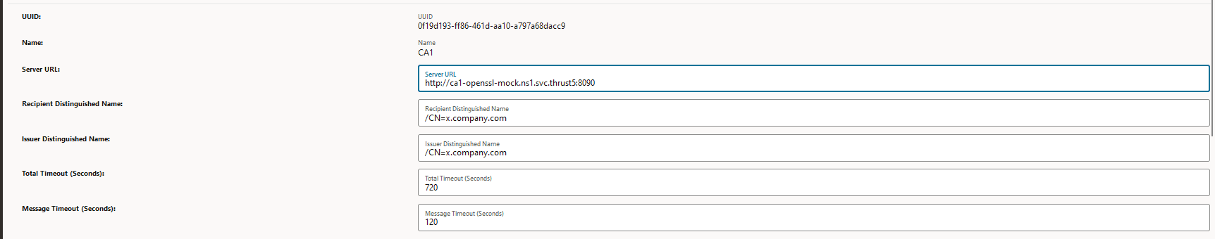

  1. Create the Issuer:
    The following screenshots provide a sample configuration for creating the issuer using CNC Console GUI
    1. Figure -4 Create Issuer
      Create Issuer

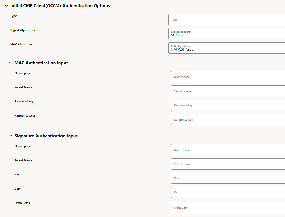

    2. Figure -5 Initial CMP Client(OCCM) Authentication Options

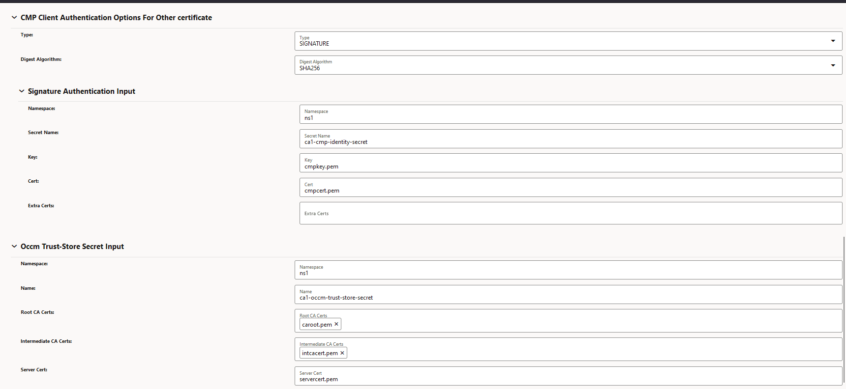

    3. Figure -6 CMP Client Authentication Options for Other Certificate

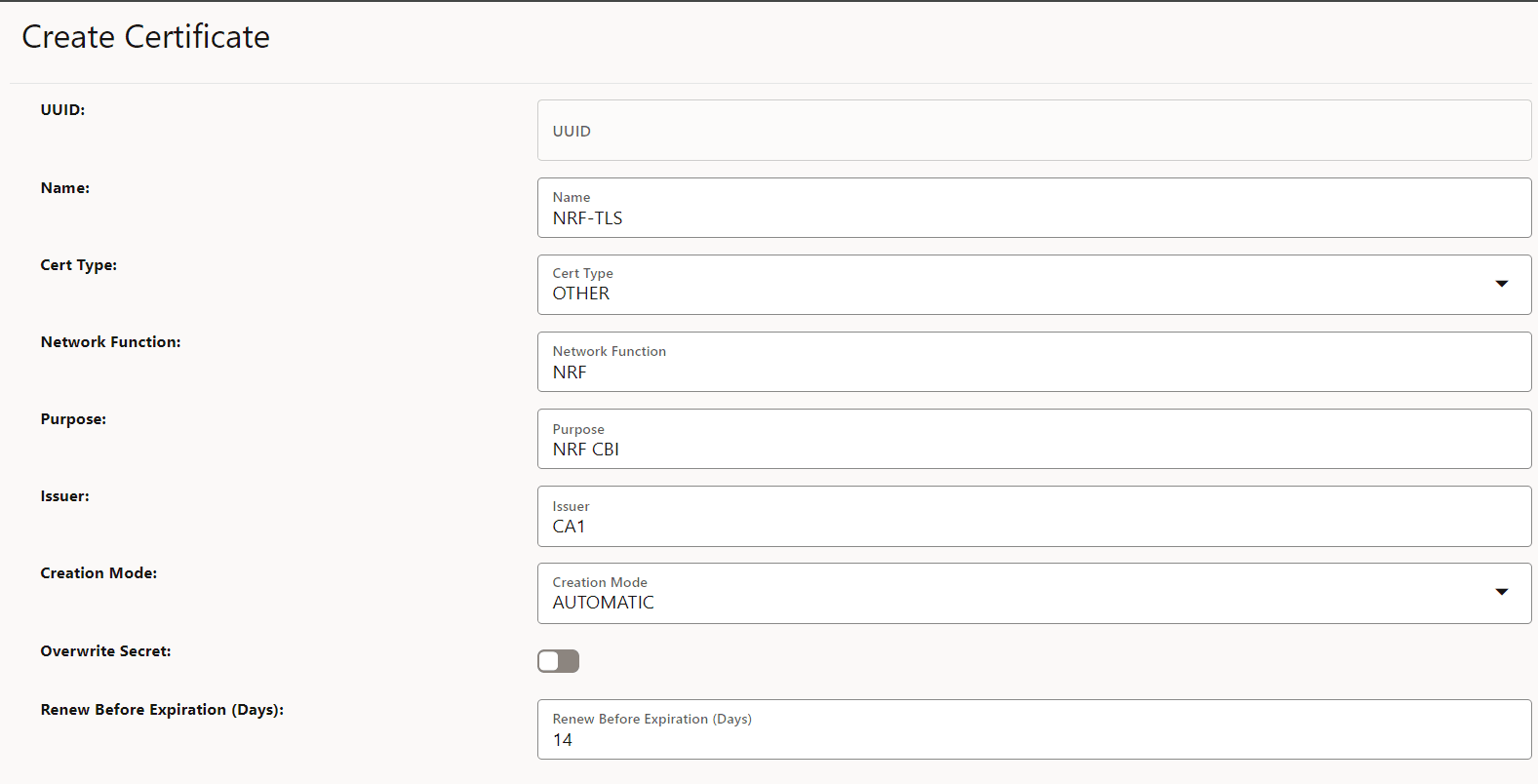

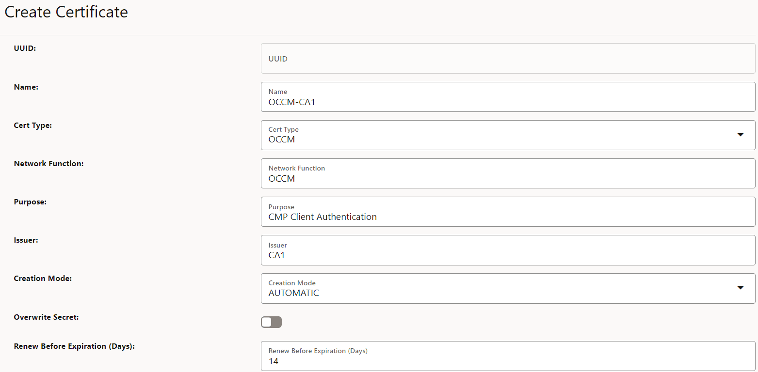

  2. Create OCCM Certificate:
    The following screenshots provide a sample configuration for creating OCCM Certificate using CNC Console GUI. Here, OCCM certificate is configured manually.
    1. Figure -9 Create OCCM Certificate

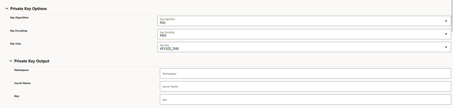

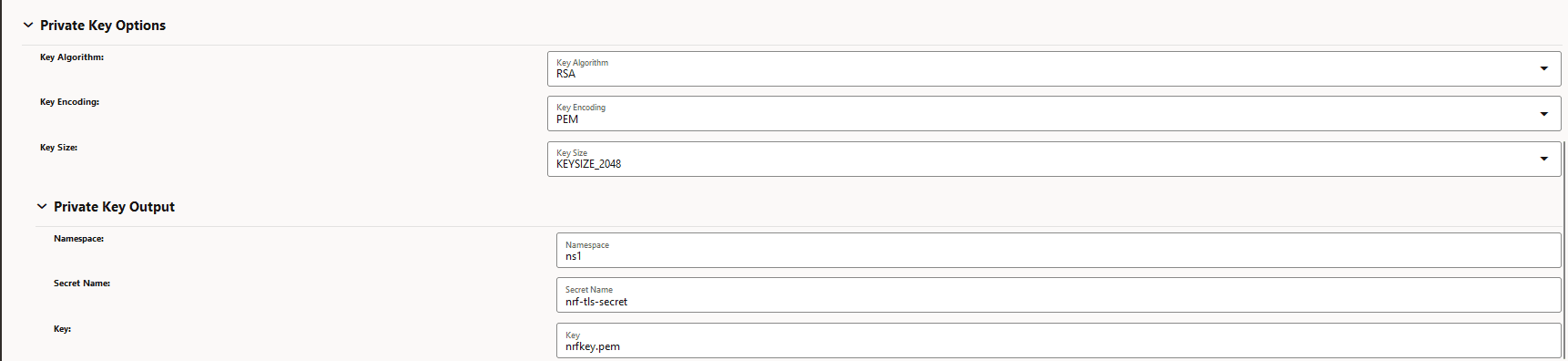

    2. Figure -10 Private Key Options
      Private Key Options

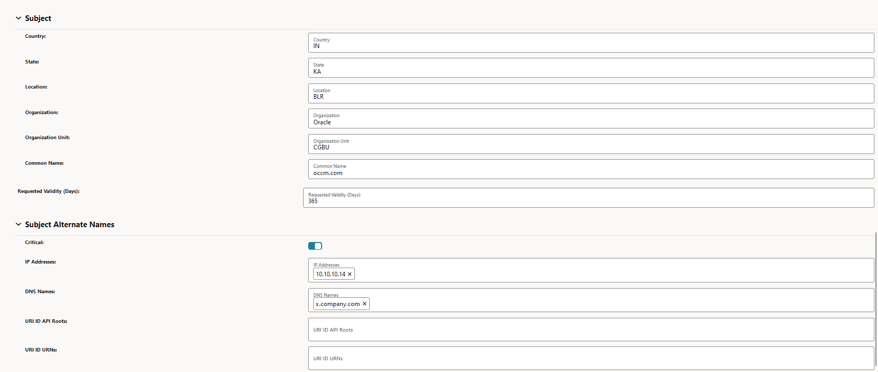

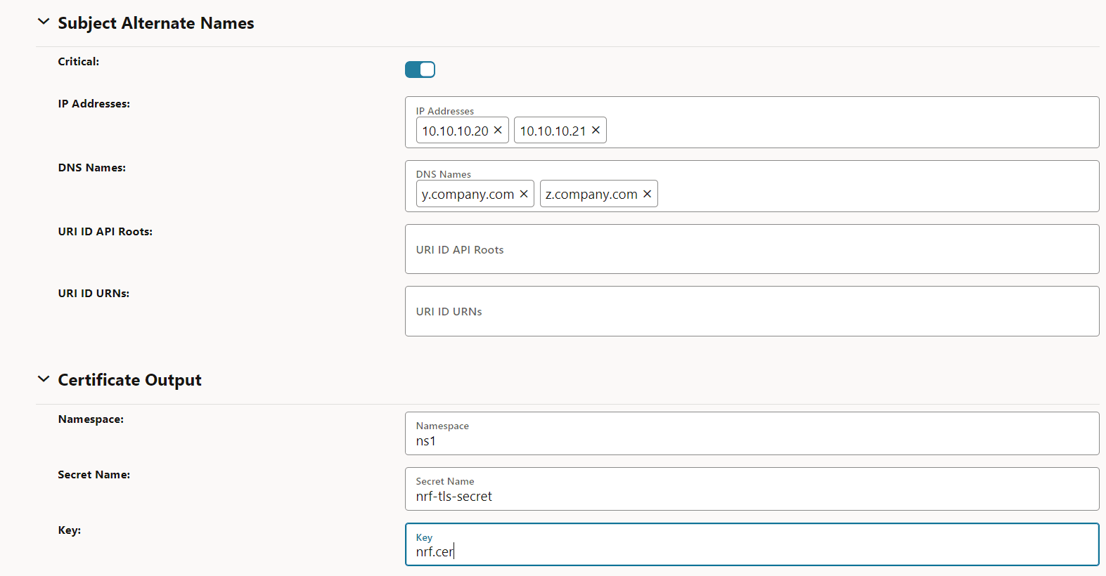

    4. Figure -12 Subject and Subject Alternate Name

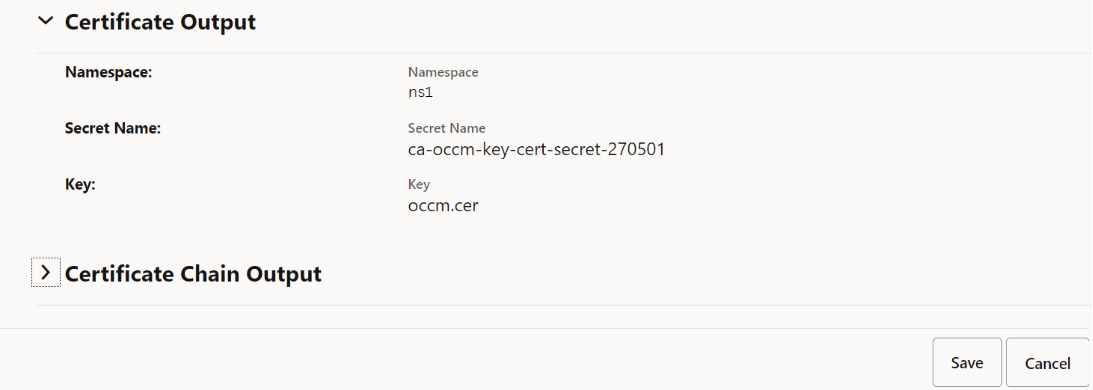

    5. Figure -13 Certificate Output and Certificate Chain Output

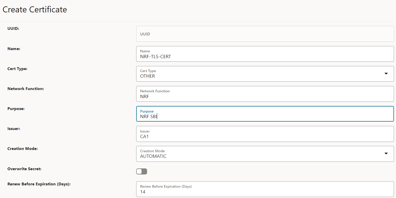

  3. Create NF Certificate (PEM encoding):
    The following screenshots provide a sample configuration for creating NF Certificate using CNC Console GUI.
    1. Figure -14 Create NF Certificate
    2. Figure -15 Private Key Options
      Private Key Options

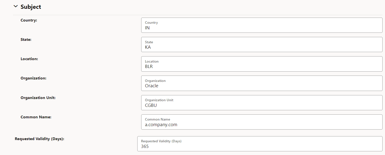

    4. Figure -17 Subject and Subject Alternate Names

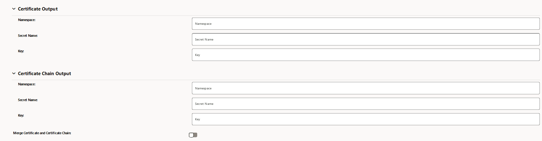

    5. Figure -18 Certificate Output
      Certificate Output

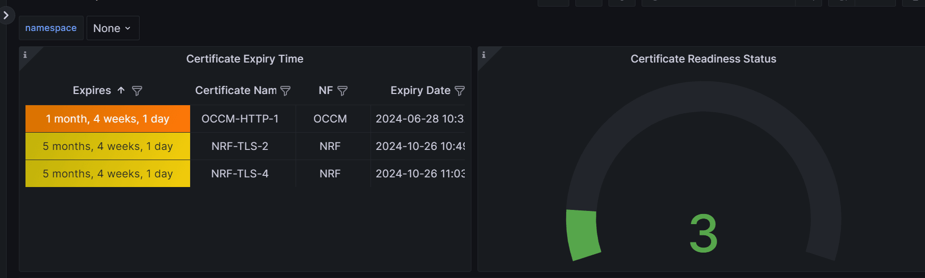

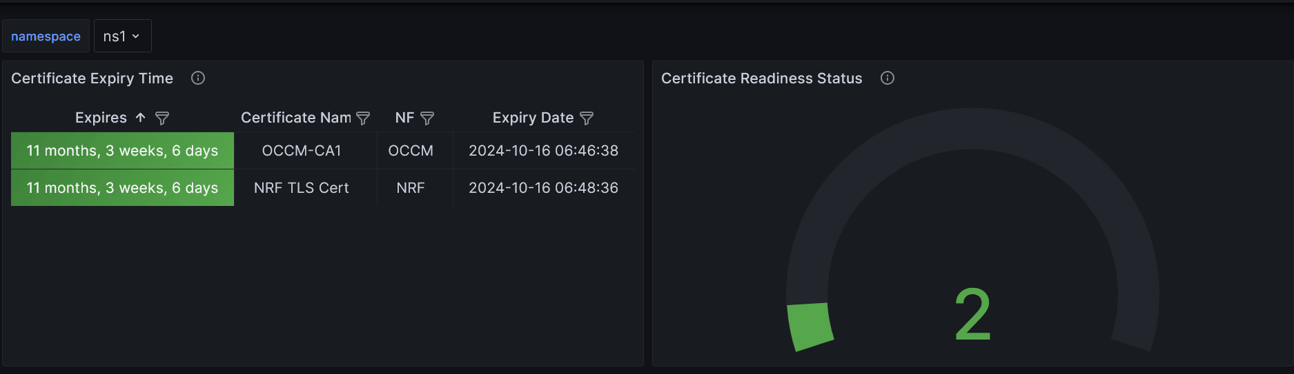

  4. Check Grafana Dashboard
    Check the grafana dashboard to view the certificates created.
    Figure -19 Sample Grafana Dasboard
    The screenshot shows that NRF TLS Cert and CA1 certificates are created successfully. The left panel indicates their expiry time and the right panel shows that both are ready to be consumed.

Create NF Certificate (DER encoding):
The following screenshots provide a sample configuration for creating DER encoded NF Certificate using CNC Console GUI.
  1. Certificate metadata
    Figure -20 Certificate Metadata

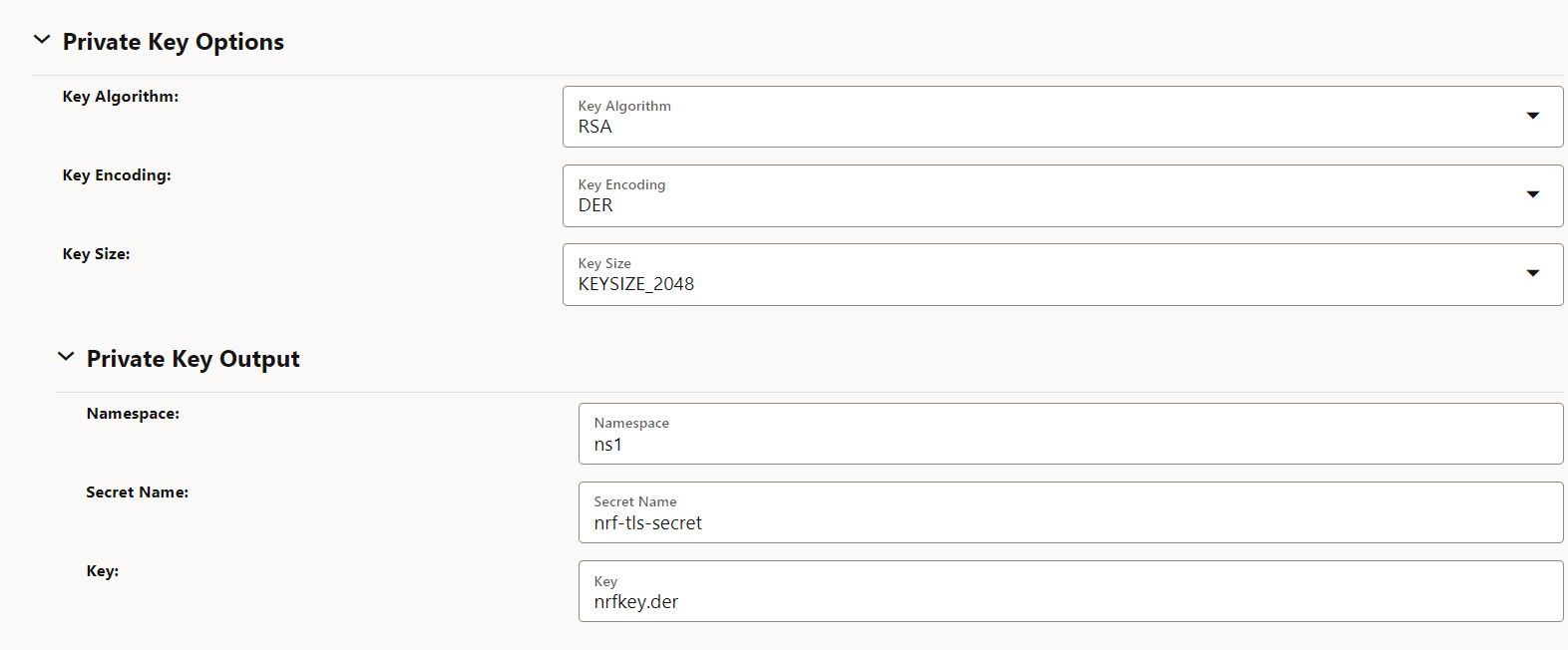

  2. Private Key Options
    Figure -21 Private Key Options
    Private Key Options

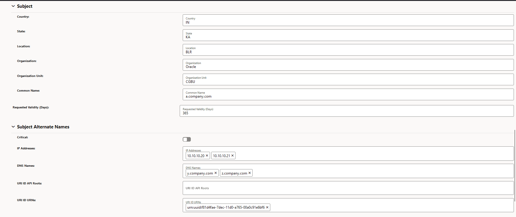

  4. Subject
    Figure -23 Subject
    Subject
  5. Subject Alternate names
    Figure -24 Subject Alternate names

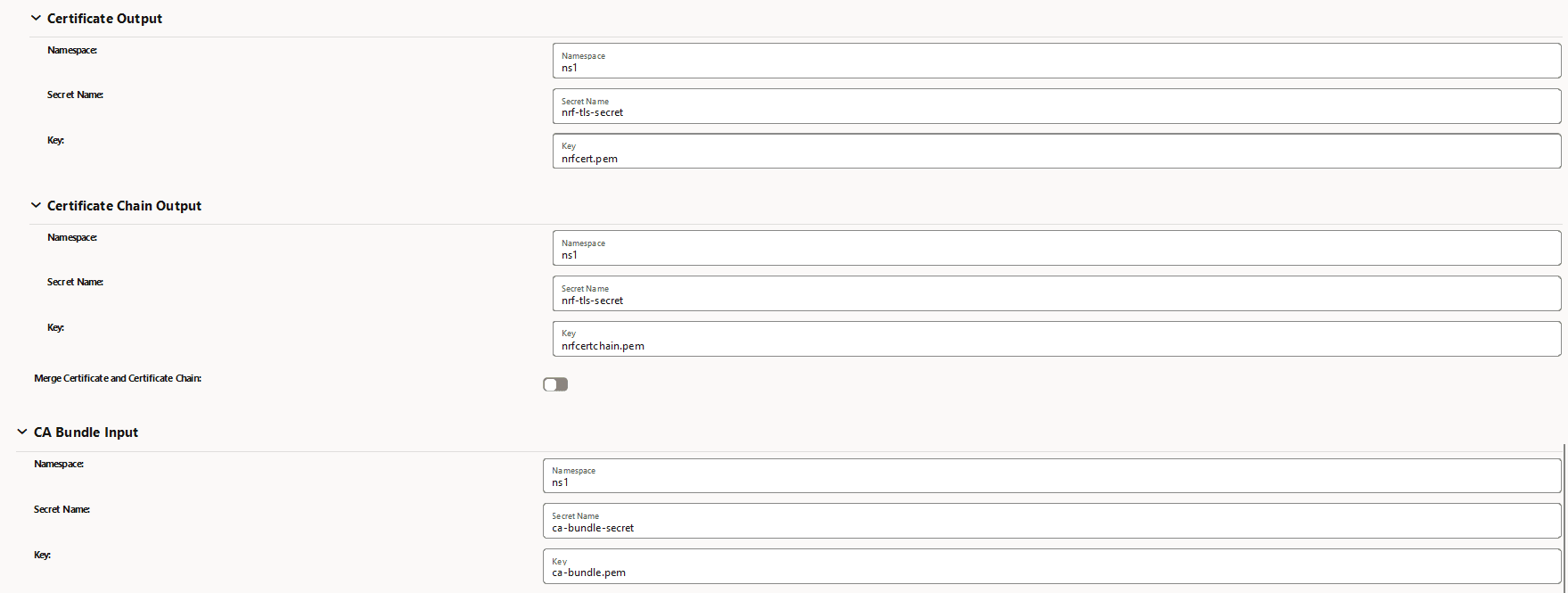

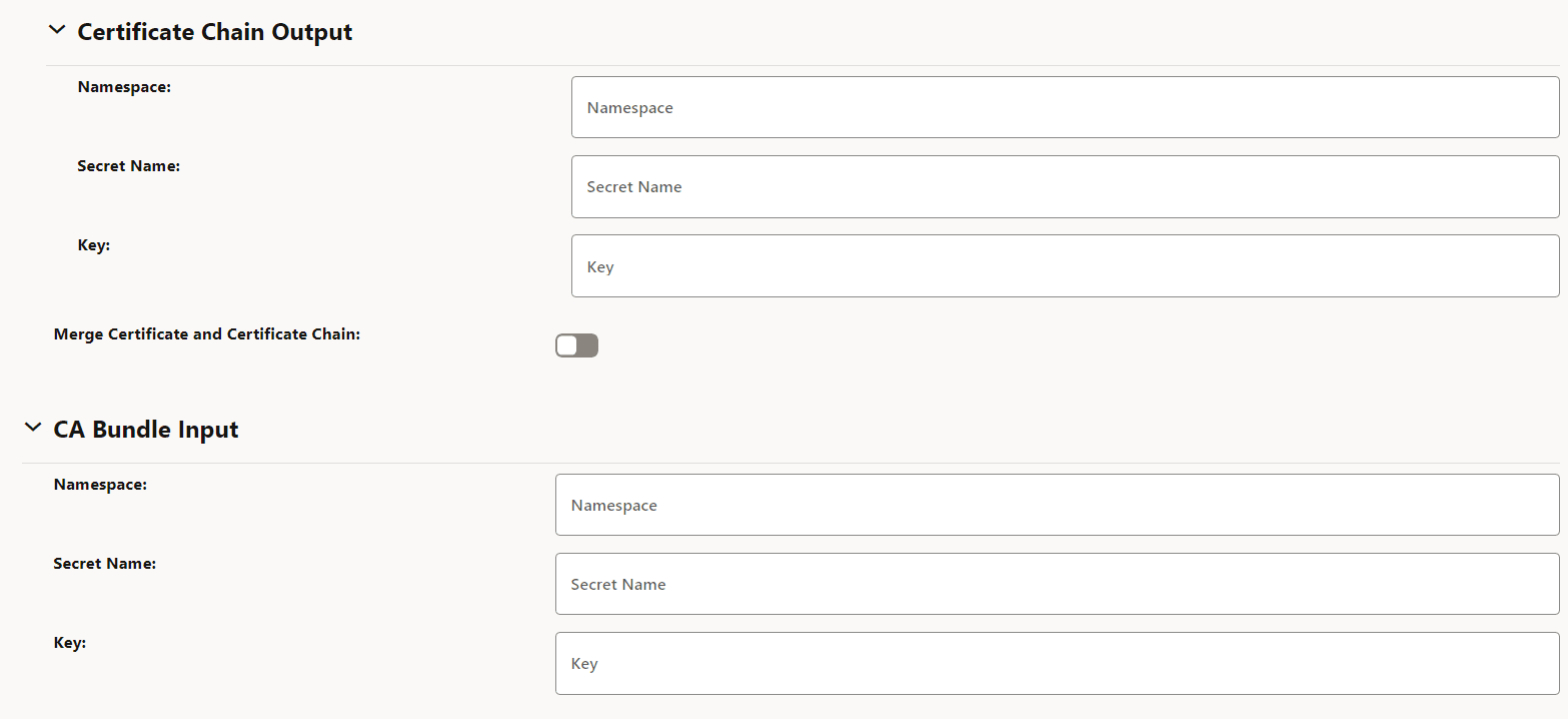

  6. Optional Certificate chain output and CA bundle input fields
    Figure -25 Optional Certificate chain output and CA bundle input fields

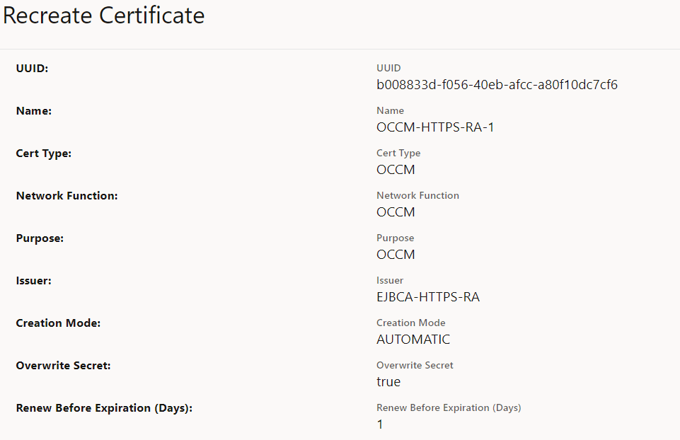

    Figure -27 Certificate Page
    Edit Certificate
    The Recreate Certificate page appears. The configurations on this page are not editable.
    Figure -28 Recreate Certificate Page
  4. On the Recreate Certificate page, click Save to trigger the recreate request.
    Figure -29 Click Save
    Click Save

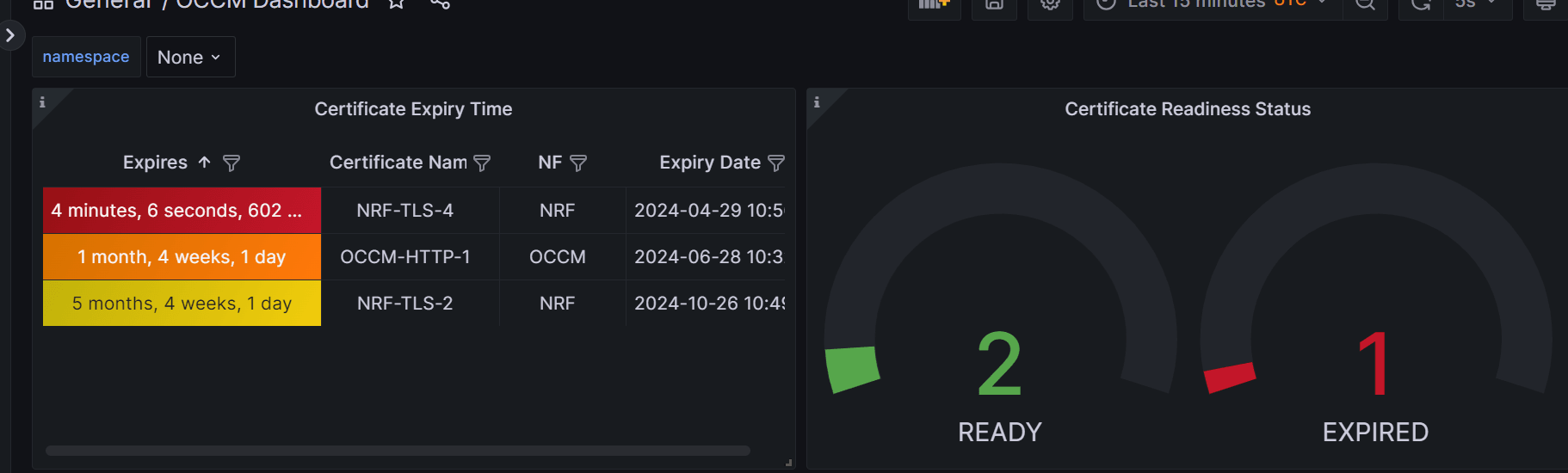

  6. Check the grafana dashboard to view the created certificate. A sample of the grafana dashboard when an expired certificate is recreated is as follows:
    Figure -30 Grafana Dashboard - Certificate Readiness Status
    Grafana Dashboard - Certificate Readiness Status when two certificates are ready and one has expired
    Figure -31 Grafana Dashboard - Certificate Readiness Status
    Grafana Dashboard - Certificate Readiness Status when expired certificate has been recreated and all three certificates are in ready status
