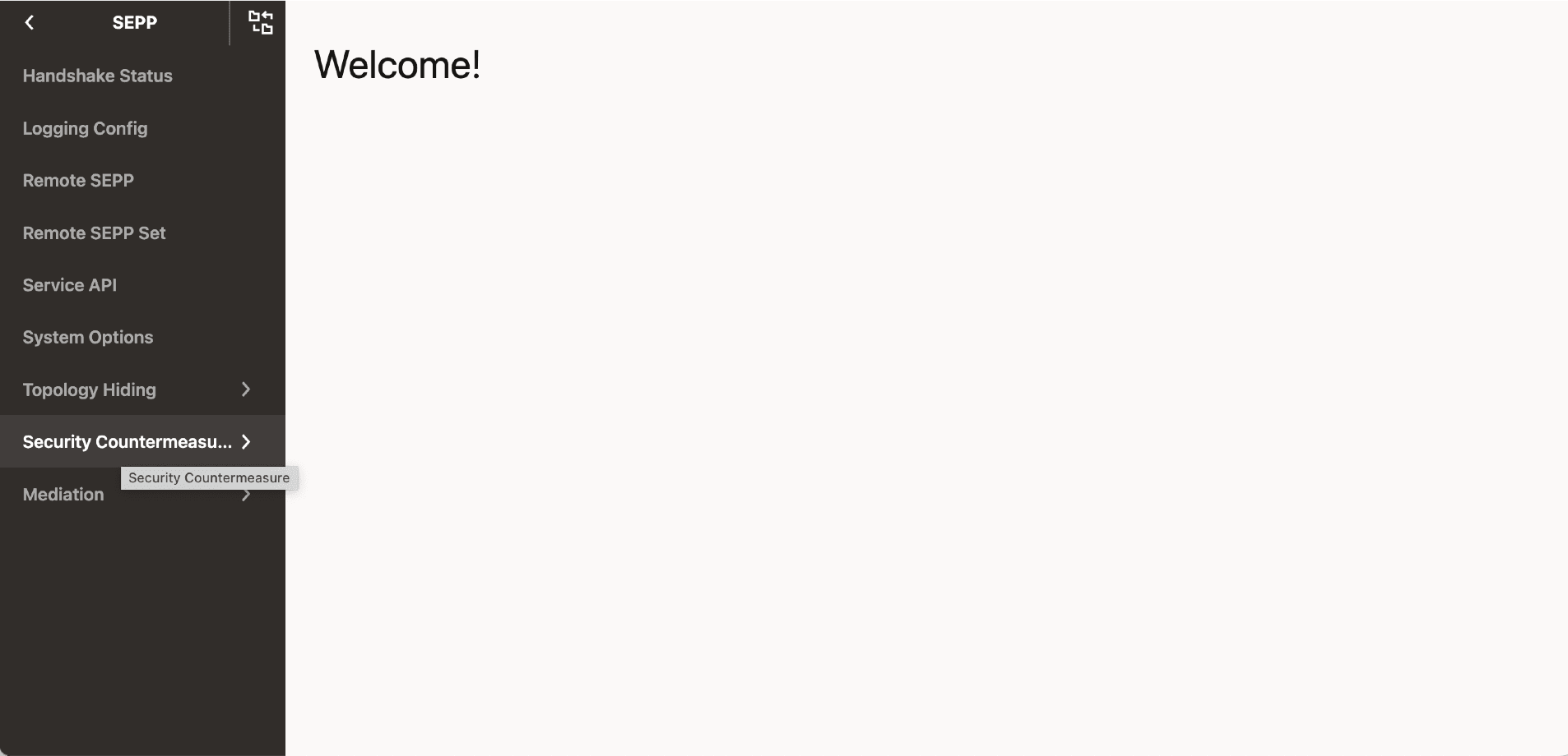

4.2 SEPP Configuration
This section describes how to configure different SEPP features and services using CNC Console.
On selecting SEPP from the drop-down list, the following screen appears:
Figure 4-3 SEPP Welcome Screen

4.2.8 Security Countermeasure
The Security Countermeasure option is used to enable and configure the Cat-0 SBI Message Schema Validation feature, Cat 1 -Service API Validation feature, Cat 2 – Network ID Validation feature, and Cat 3 – Previous Location Check feature.
The Service API Allowed List REST API is used to do the configurations on the allowed list of REST APIs.

- From the left navigation menu, navigate to SEPP, and then select Security Countermeasure.
- Select Cat 2 – Network ID Validation.
- The Header screen appears underneath.

- From the left navigation menu, navigate to SEPP, then select Security Countermeasure.
- Then select Cat 2 – Network ID Validation.
- The Body IE screen appears underneath.
