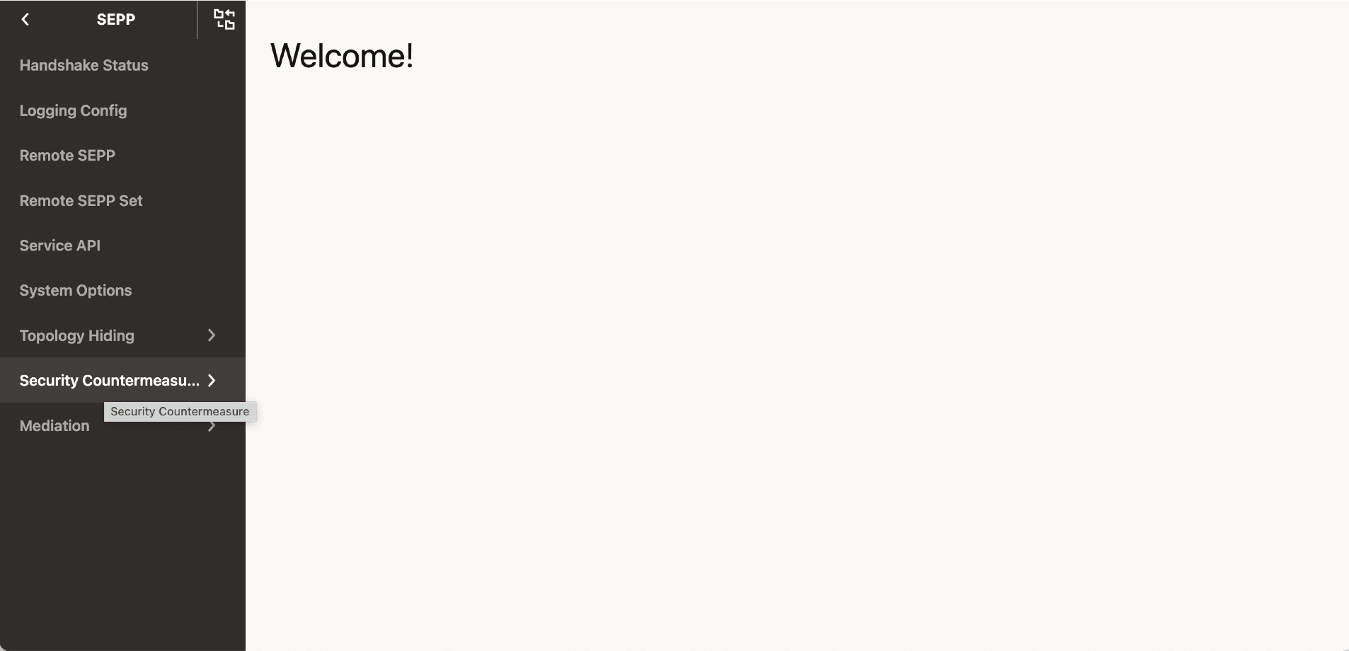

On selecting SEPP from the drop-down list, the following screen appears:
Figure 4-3 SEPP Welcome Screen
img/sepp-cncc-22.4.0.png

4.2.8 Security Countermeasure
The Security Countermeasure option is used to enable and configure the Cat-0 SBI Message Schema Validation feature, Cat 1 -Service API Validation feature, Cat 2 – Network ID Validation feature, and Cat 3 – Previous Location Check feature.
The Service API Allowed List REST API is used to do the configurations on the allowed list of REST APIs.

  1. From the left navigation menu, navigate to SEPP, and then click Security Countermeasure.
  2. Click Cat 2 -Network ID Validation under Security Countermeasure, the Option, Cat 2 -Network ID Validation List, Header, and Body IE appears underneath.

4.2.9 Mediation
The mediation option allows the user to set Mediation feature as ENABLED or DISABLED and configure the mediation options.
Perform the following procedure to enable or disable the mediation feature:
  1. From the left navigation menu, navigate to SEPP and then click Mediation. The options appears underneath.
  2. Click Options, the options screen appears at the right pane. The Mediation Feature and Error Configuration details are available in the screen.
  3. Click Edit icon to modify the Options. The Edit Options page appears.
  4. Set the Mediation Feature to True or False and configure the Error Configuration parameters Action, Status Code, and Title.

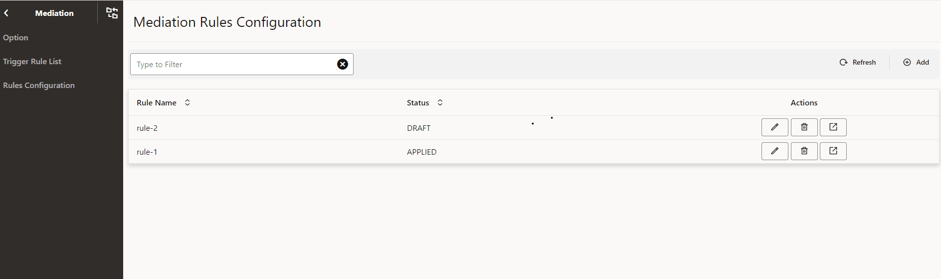

Mediation Rules Configuration
Rules configuration screen allows the user to compile, create, update, delete, clone and apply the mediation rules using CNCC.
Perform the following procedure to configure the mediation rules:
  1. From the left navigation menu, navigate to SEPP and then select Mediation. The Rules Configuration screen appears underneath.
  2. Click Rules Configuration, the list of all the existing rules with corresponding status appears.
    Figure 4-4 Mediation Rules Configuration Screen
  3. Click Add to add a new rule. The Add Mediation Rule page appears and user can add the mediation rule information.

Status M Enum Mediation rule status: APPLIED or DRAFT
State M Enum
Compile, Clone, Save, Draft, Apply
The user can select one of these states.
Mediation Mode M Enum
MEIDATION_ACTIVE: its only applicable to mediation microservice active mode
MEDIATION_TEST: its only applicable to mediation microservice test mode
The user is required to configure the mediation rules using MEDIATION_ACTIVE mediation mode. MEDIATION_TEST mode is only for internal purpose.
Code M String
Mediation rule code content.
The user has to prepend the following data block along with the needed rules in the code section and save to create the rule in DRAFT status. If the user wants to apply the rule on mediation microservice then user can edit the rule and save it again with Apply state.
package com.oracle.cgbu.ocmediation.nfmediation;
    import com.oracle.cgbu.ocmediation.nfruleengine.NFDroolsRuleEngine;
    import com.oracle.cgbu.ocmediation.factdetails.Request;
    import com.oracle.cgbu.ocmediation.factdetails.Response;
    import java.util.Map;
    import java.util.HashMap;
    dialect "mvel"
Format M Enum Rule format. Only DRL is supported currently.
New Rule Name C String New rule name is to be given only when state is clone.
  • The rule name for a rule in the DRAFT status must be unique. Otherwise, the new rule overwrites the old one.
  • The new rule is always created and saved with DRAFT status in the database. User needs to save the rule with APPLY state to apply the rule to mediation microservice.
