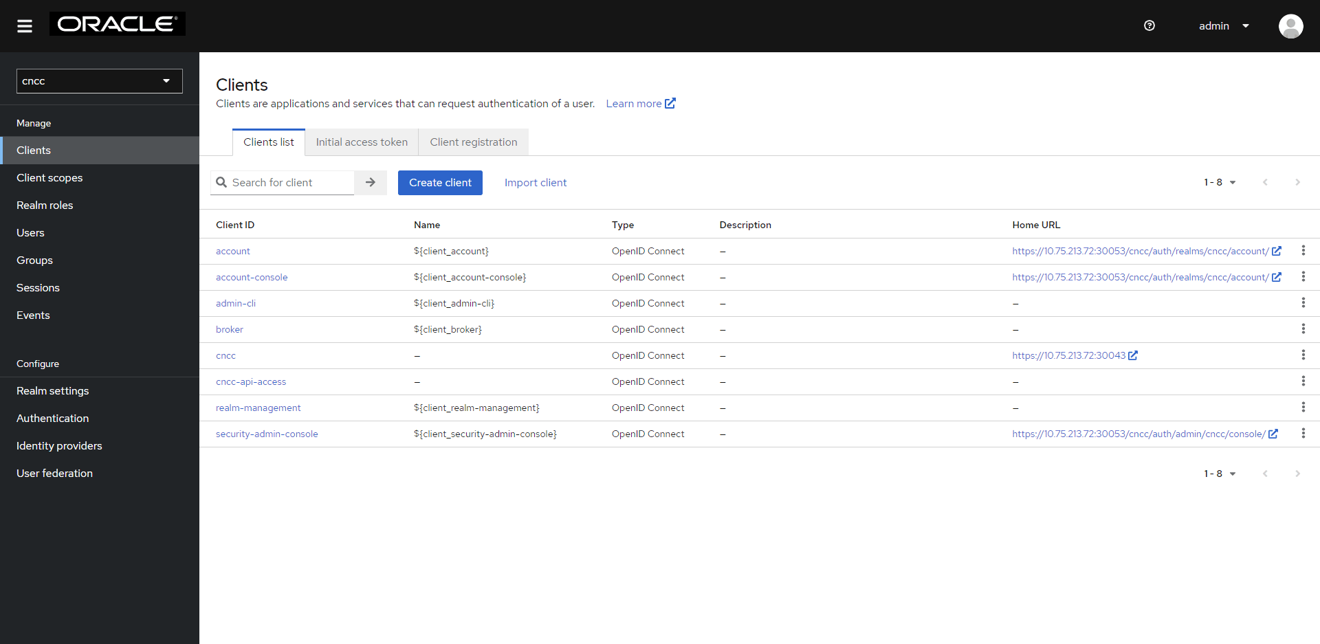

  1. Log in to CNC Console IAM with valid credentials.
  2. Click the cncc realm.
  3. On the right pane, click Clients. The following screen appears:
    Figure 6-1 Clients
    Clients
  4. Click cncc-api-access. The following screen appears:
    Figure 6-2 cncc-api-access
    cncc-api-access

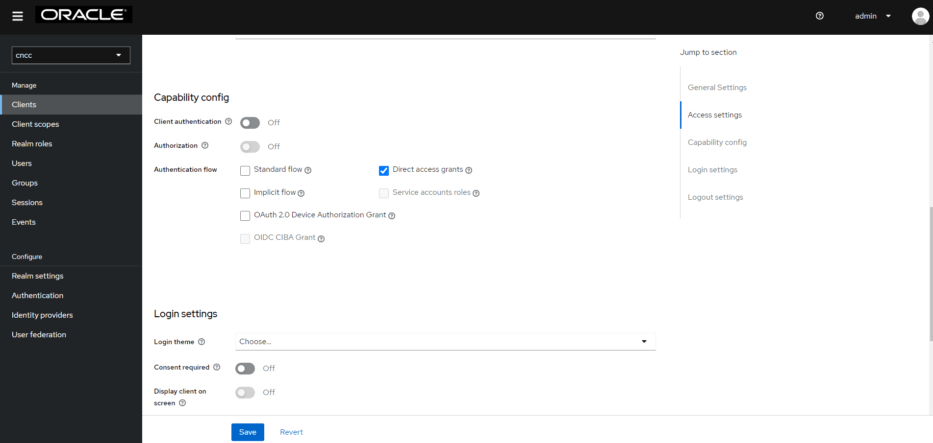

  5. Navigate to the Capability config section in the Settings tab and select the Direct Access Grants checkbox. Click Save.
    Figure 6-3 Direct Access Grants
Perform the following procedure to generate the access tokens:
