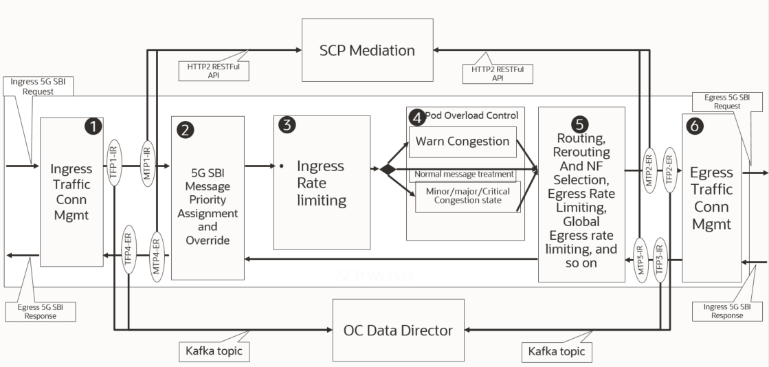

2.1 5G SBI Message Processing and Trigger Points
The following image represents how SCP processes ingress 5G SBI message requests from consumer NFs.
Figure 2-2 5G SBI Message Processing and Trigger Points
