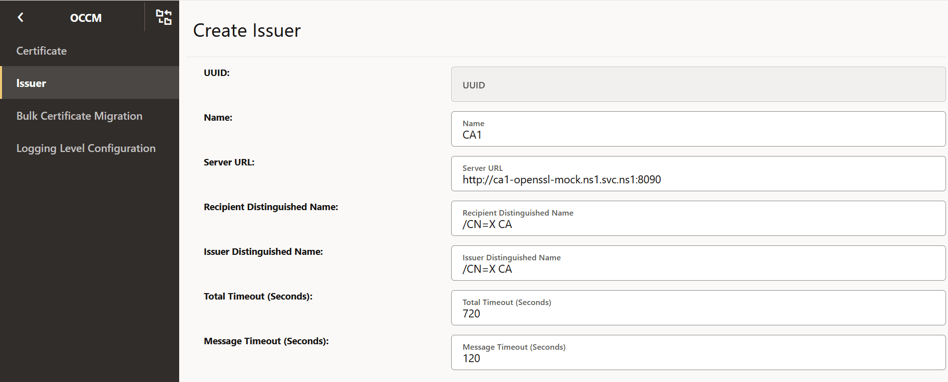

- Create the Issuer:
The following screenshots provide a sample configuration for creating the issuer using CNC Console GUI
Figure -7 Create Issuer

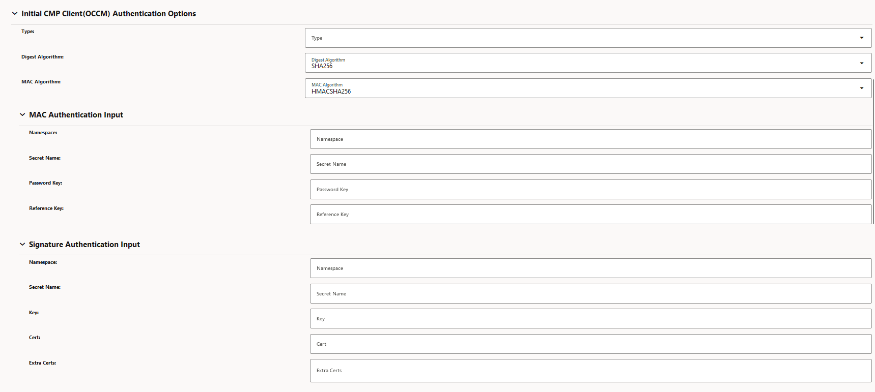

Figure -8 Initial CMP Client (OCCM) Authentication Options

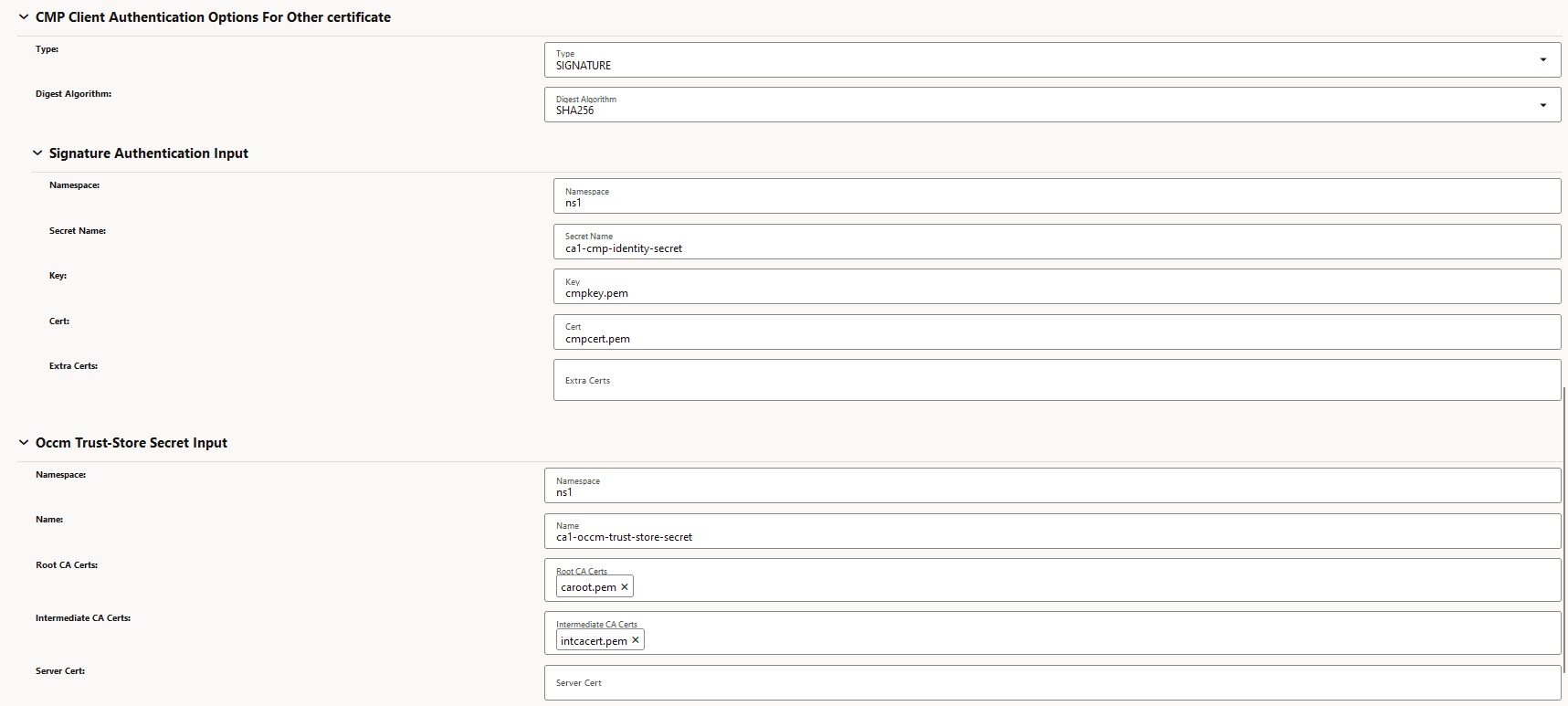

Figure -9 CMP Client Authentication Options for Other Certificate

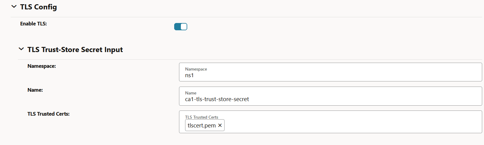

- To enable HTTPS communication, provide HTTPS scheme in the server URL field
and provide the TLS trust store certificates under TLS config.
Figure -10 HTTPS Scheme
Figure -11 Enable TLS Config

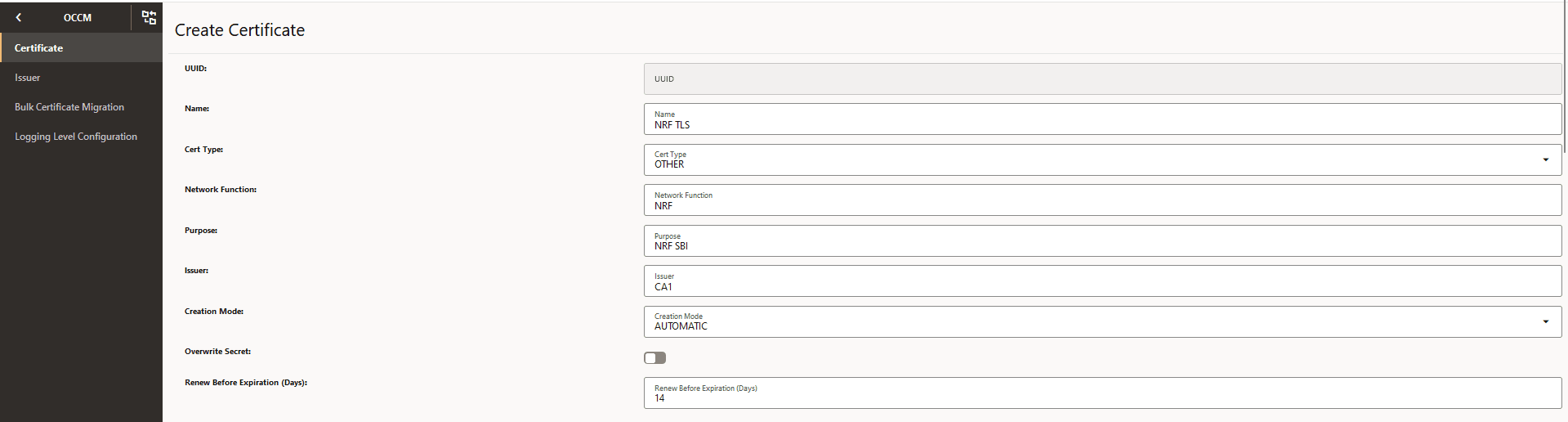

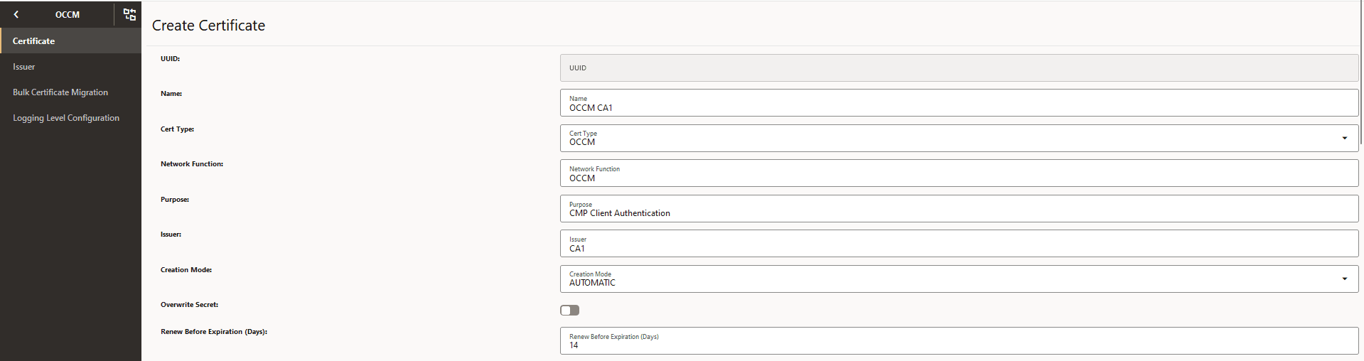

- Create CMP Identity (OCCM) Certificate:
The following screenshots provide a sample configuration for creating CMP Identity (OCCM) certificate using CNC Console GUI. Here, OCCM certificate is configured manually.
Figure -12 Create CMP Identity (OCCM) Certificate

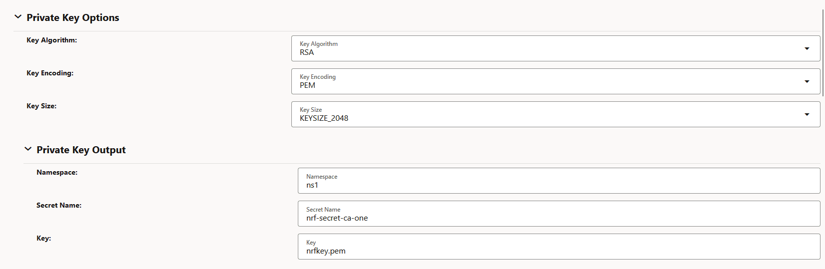

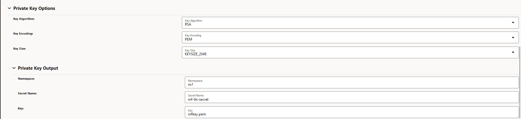

Figure -13 Private Key Options

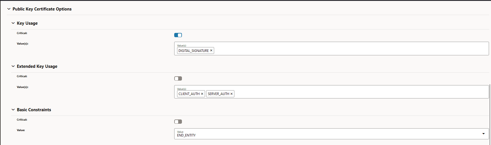

Figure -14 Public Key Certificate Options

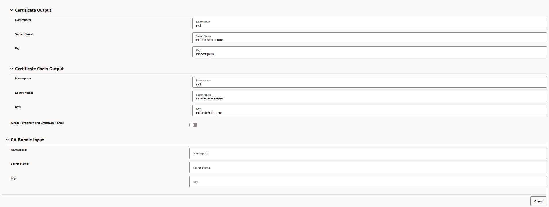

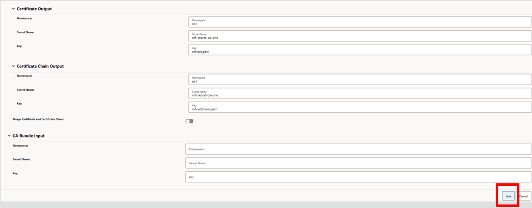

Figure -16 Certificate Output and Certificate Chain Output
- Create End Entity (NF) Certificate: (PEM encoding):
The following screenshots provide a sample configuration for creating NF Certificate using CNC Console GUI.
Figure -17 Create End Entity (NF) Certificate
Figure -18 Private Key Options
Figure -19 Public Key Options

Figure -21 Certificate Output

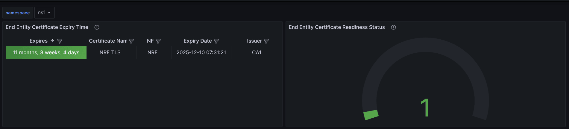

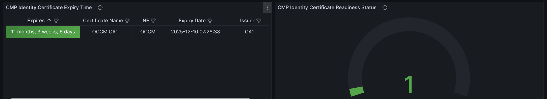

- Check Grafana Dashboard
Check the grafana dashboard to view the certificates created.
Figure -22 End Entity (NF) Sample Grafana Dasboard
Figure -23 CMP Identity (OCCM) Sample Grafana Dasboard
The screenshot shows that NRF TLS Cert and CA1 certificates are created successfully. The left panel indicates their expiry time and the right panel shows that both are ready to be consumed.

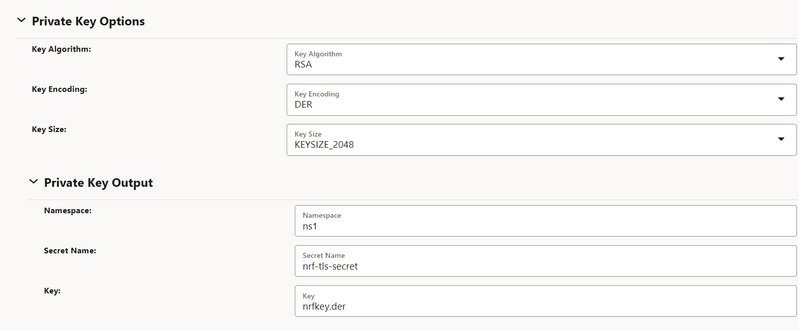

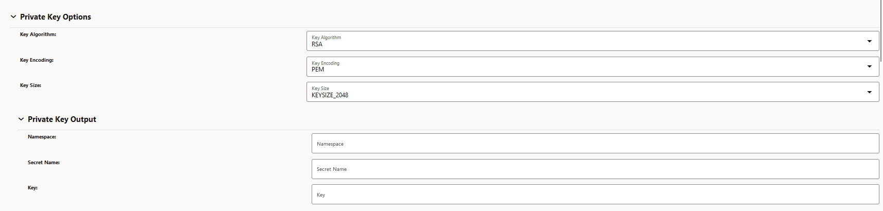

Private Key Options
Figure -25 Private Key Options

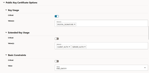

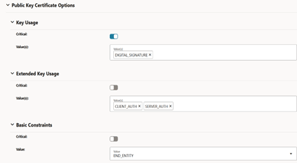

- Public Key Certificate Options
Figure -26 Public Key Certificate Options

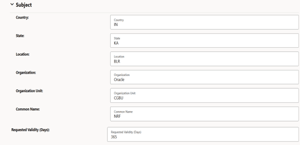

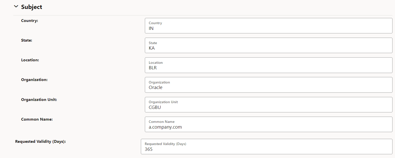

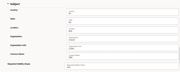

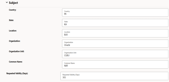

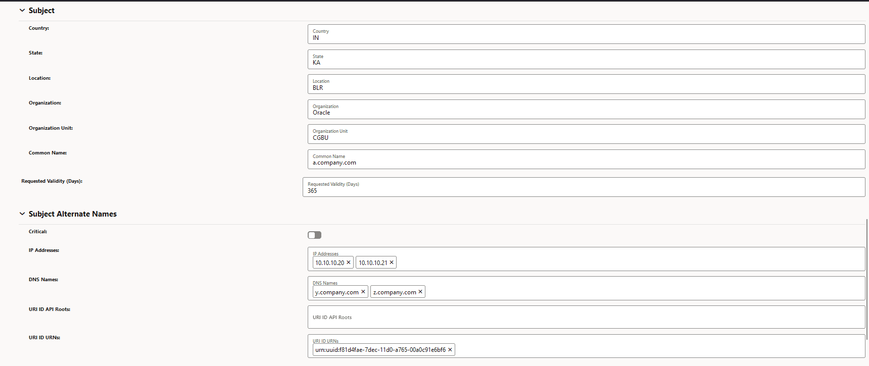

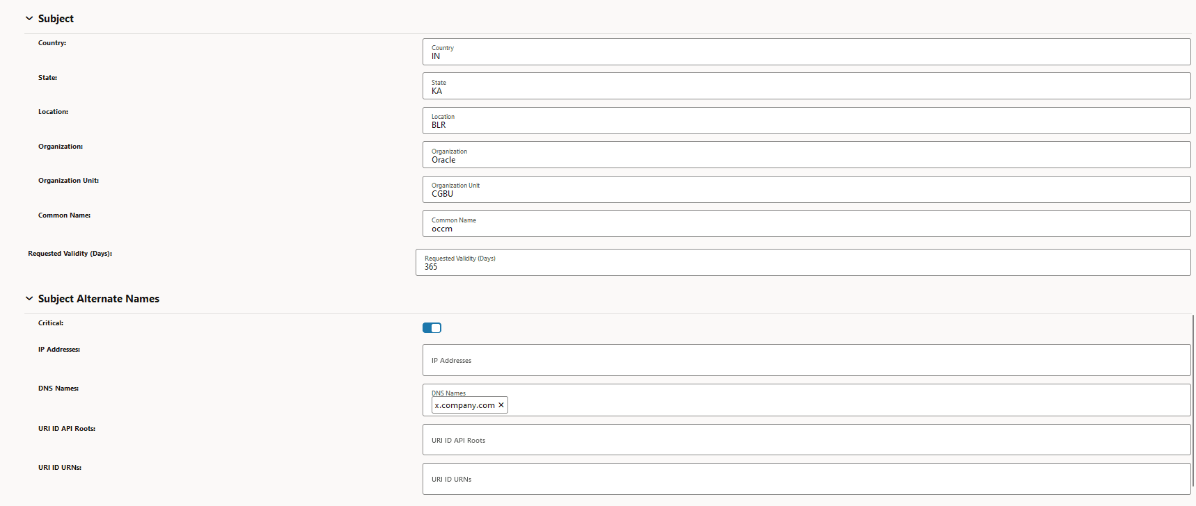

- Subject
Figure -27 Subject

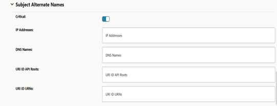

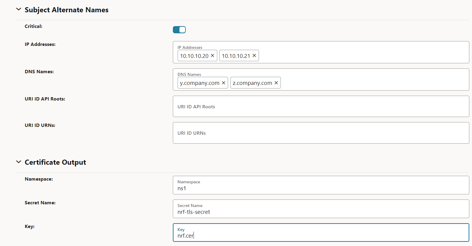

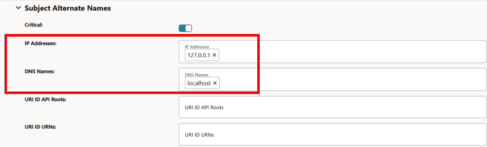

Subject Alternate names
Figure -28 Subject Alternate names

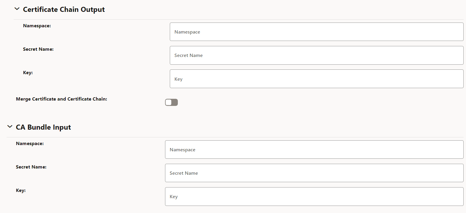

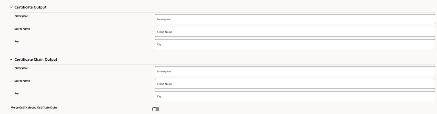

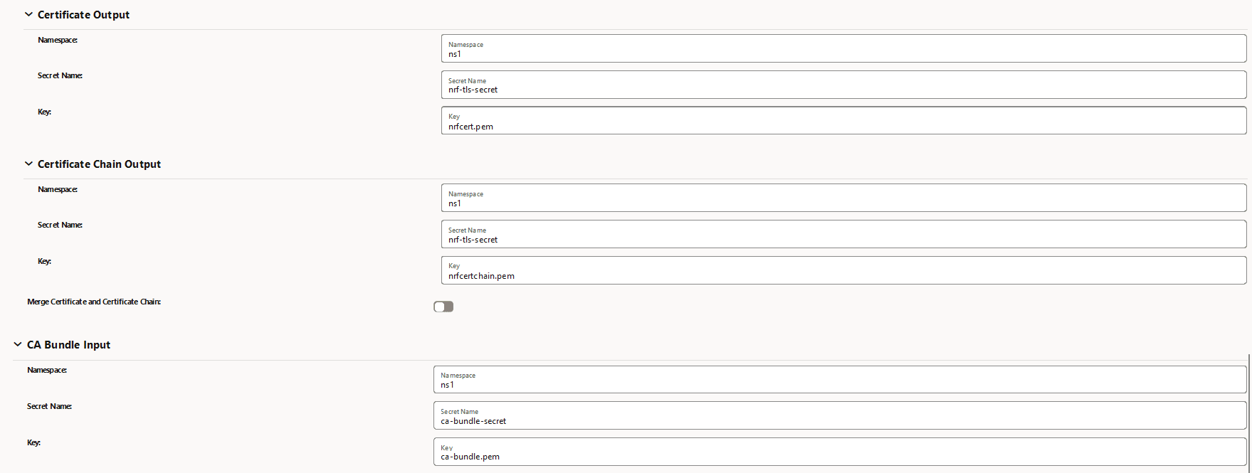

- Optional Certificate chain output and CA bundle input fields
Figure -29 Optional Certificate chain output and CA bundle input fields
Check Grafana dashboard
Figure -30 End Entity (NF) Sample Grafana Dasboard
The screenshot shows that NRF-TLS Certificate is created successfully. The left panel indicates its expiry time and the right panel shows that it is ready to be consumed.

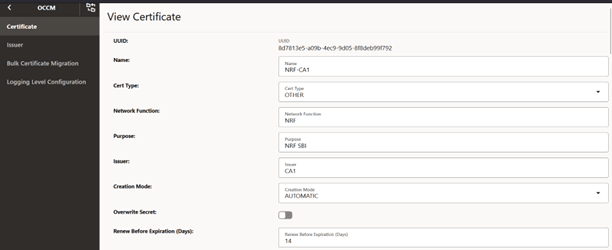

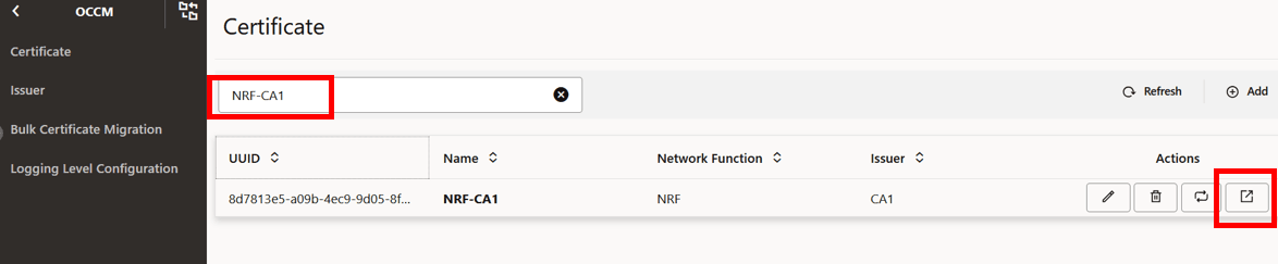

- Navigate to the Certificate page and select
the certificate to be edited. View the current configuration before editing.
Figure -31 Certificate Page
Figure -32 View Certificate
Figure -33 View Certificate: Private Key Options
Figure -34 View Certificate: Public Key Certificate Options
Figure -35 View Certificate: Subject
Figure -36 View Certificate: Subject Alternate Names (SANs)
Figure -37 View Certificate: Certificate Output

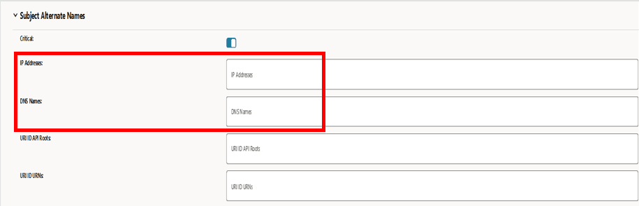

- If the certificate (secret) exists in the system, verify its secret
content with respect to current configuration before editing. Here in the
example, no SAN entry can be seen on the certificate as certificate
configuration related to SAN are missing.
Figure -39 Missing SANs

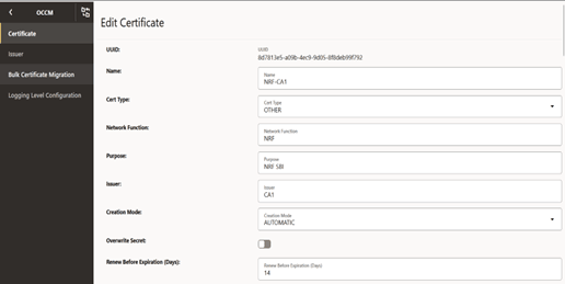

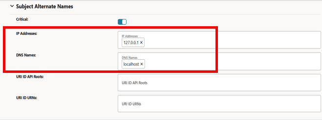

- Edit the certificate configuration field(s) and click
Save.
Figure -40 Certificate
Figure -41 Edit Certificate

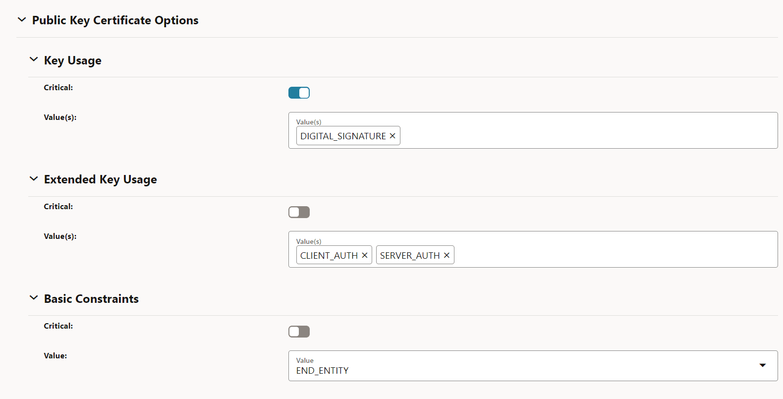

Figure -42 Edit Certificate: Private Key Options
Figure -43 Edit Certificate: Public Key Certificate Options
Figure -44 Edit Certificate: Subject
Figure -45 Edit Certificate: Subject ALternate Names (SANs)
Figure -46 Updated IP address and DNS Names
Figure -47 Click Save

Figure -52 View Certificate: Subject
Figure -53 Updated Subject Alternate Names (SANs)
Figure -54 View Certificate: Certificate Output

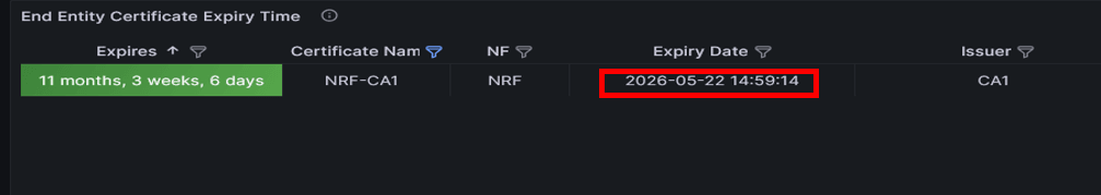

In the following screenshot, the certificate expiry has been extended as shown
in the End Entity Certificate Expiry Time panel.
Verify that the secret content is updated as per the edited configuration.
Figure -55 End Entity Certificate Expiry Time panel
Figure -56 Secret Updated with SAN

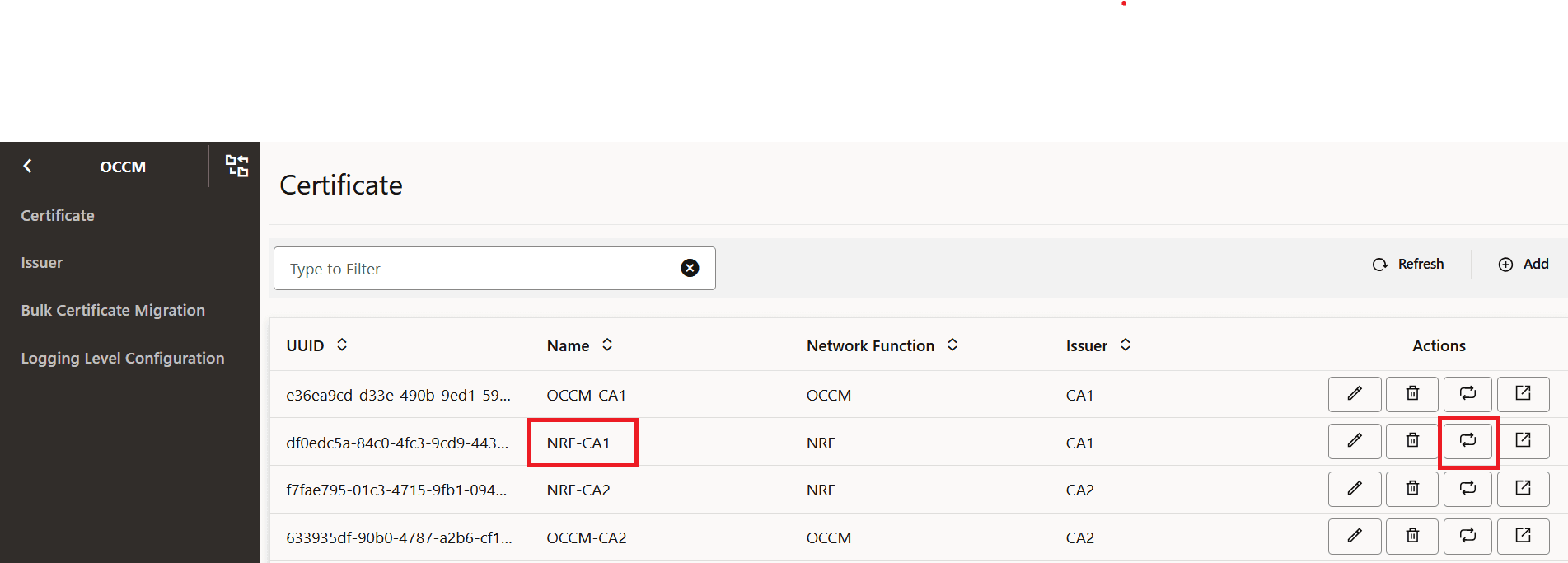

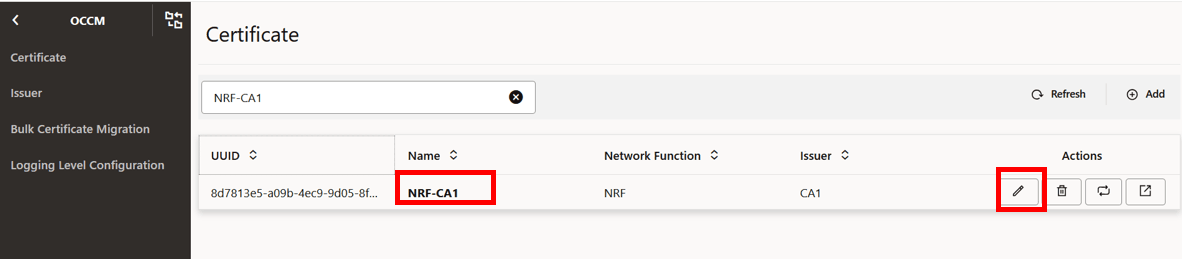

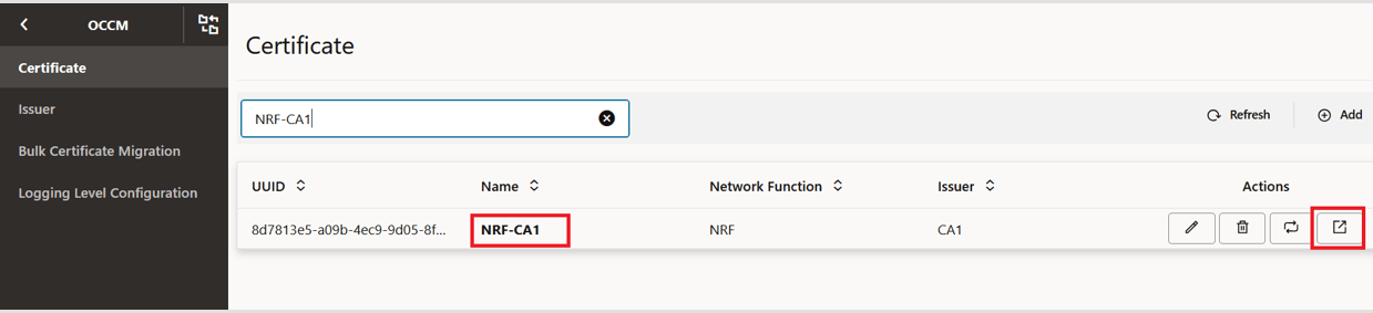

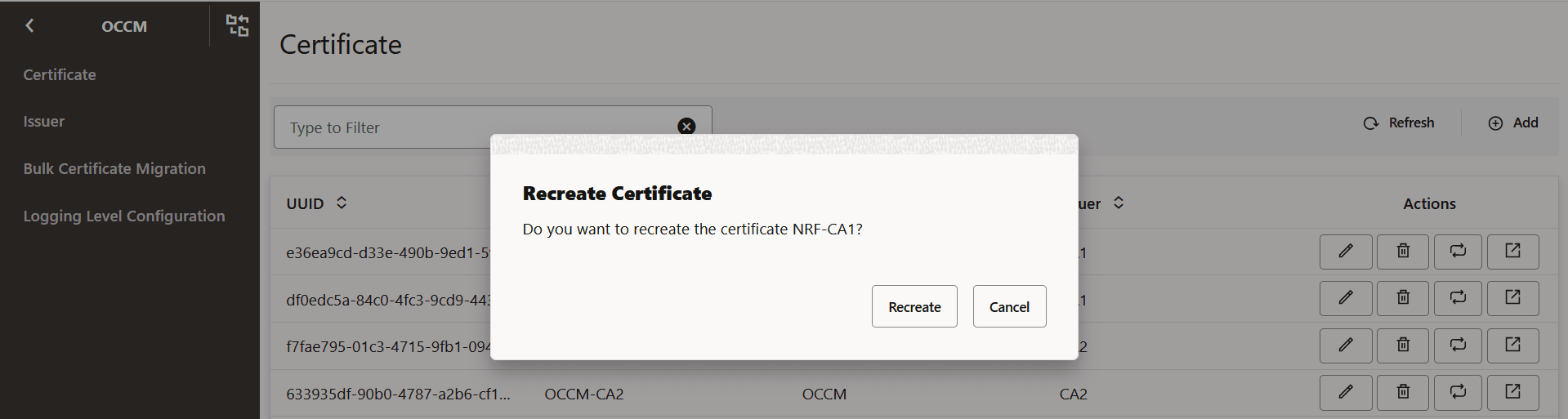

- Log in to CNC Console using your login credentials and select the OCCM Instance.
- Click OCCM from the left pane and then click Certificate.
- Click the Recreate Icon next to the
certificate that you want to recreate. For example, to recreate NRF-CA1, click
the recreate button for NRF-CA1.
The Recreate Certificate dialog box appears.
Figure -57 Recreate Icon
Figure -58 Recreate Certificate
- Click Recreate to proceed. Click Cancel to discard your progress and close the dialog box.

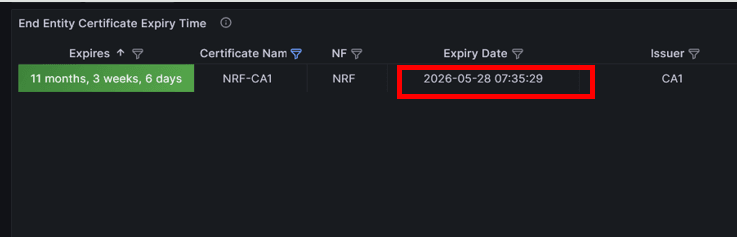

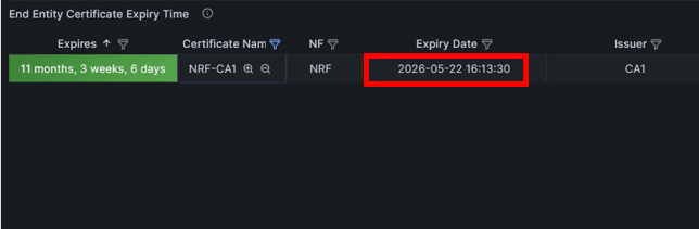

- Check the Grafana dashboard to view the recreated certificate
- Check the 'End Entity Certificate Expiry Time' panel to verify that the
certificate expiry date has extended after successful recreation. In
case the recreation fails, the certificate expiry date will not be
extended and will display the remaining validity.
Figure -59 End Entity Certificate Expiry Time

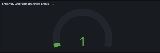

- Check the 'End Entity Certificate Readiness Status' panel to verify the
certificate status. If recreation succeeds, the status will be set to
READY, otherwise the status will be set to FAILED.
Figure -60 End Entity Certificate Readiness Status

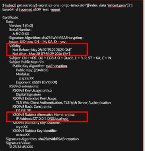

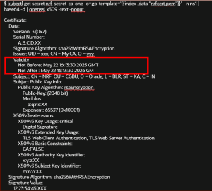

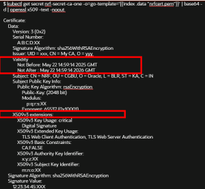

- Optionally, verify that the certificate validity has been extended
by checking the content of the kubernetes secret corresponding to the
configuration. Run the following command to verify the Kubernetes
secret:
$ kubectl get secret nrf-secret-ca-one -o=go-template='{{index .data "nrfcert.pem"}}' -n ns1 | base64 -d | openssl x509 -text -nooutA sample response is as follows:Figure -61 Secret with Extended Validity

- Create the destination issuer CA2 with the requisite configuration. For more
information about the steps, see Managing Issuers.
Figure -62 Create Issuer
Figure -63 Initial CMP Client (OCCM) Authentication Options
Figure -64 MAC Authentication Input
Figure -65 CMP Client Authentication Options For Other certificate
Figure -66 Occm Trust-Store Secret Input
- Create CMP (OCCM) Identity certificate OCCM-CA2 corresponding to the
destination issuer CA2. For more information about the steps, see Managing Certificates.
Figure -67 Create Certificate

- View the configuration to check the certificates on which migration
is initiated.
Figure -73 View Bulk Certificate Migration
- Check the Grafana dashboard to verify the migration status of each
certificate displayed under the field Bulk Certificate Migration Initiated
certificates:
- When the migration is successful on a certificate.
- To verify the migration status for each certificate refer to the End Entity Certificate Expiry Time and the End Entity Certificate Readiness Status panels .
- On the End Entity Certificate Expiry Time the corresponding issuer of the certificate considered in bulk migration is updated to the destination issuer (CA2) and the expiry date will be extended based on the configuration.
- On the End Entity Certificate Readiness Status the certificate will be in the READY state.
In the following example, the bulk migration is triggered on three certificates. The updated issuer, expiry, and the readiness status are shown as follows:Figure -74 End Entity Certificate Expiry Time
Figure -75 End Entity Certificate Readiness Status
- When the migration fails on a certificate.
- The corresponding issuer of the certificate will NOT
be updated to the destination issuer on the End Entity
Certificate Expiry Time panel and it will keep pointing
to the source issuer (CA1). The expiry will not be updated since
recreation has failed. Similarly, the end entity certificate
readiness status will also preserve the previous status. The
failed migration on all the three certificates are as
follows:
Figure -76 End Entity Certificate Expiry Time Failed
