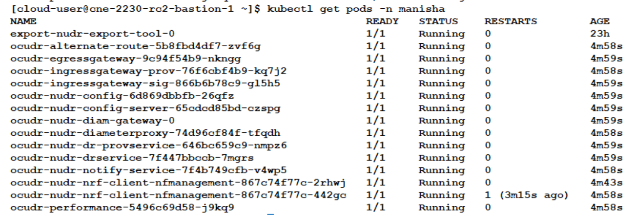

  • Run the following command to check the installation of UDR.
    $ kubectl get pods -n <ocudr-namespace>
    Figure 4-1 Sample Output: UDR Pods Status
    The STATUS of all the pods is 'Running'.

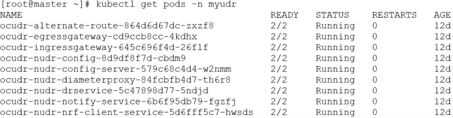

  • Run the following command to verify whether UDR specific pods are working as expected:
    Figure 4-2 Sample Output: UDR Pods Status
    Sample Output UDR Pods Status
    Result: In the figure given above, you can see that the status of all the pods is 'Running'.
    The number of pods for each service depends on Helm configuration. In addition, all pods must be in a ready state and you need to ensure that there are no continuous restarts.

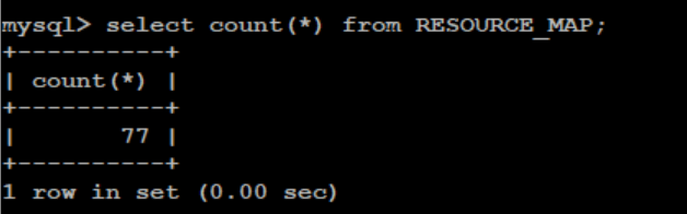

  • Log in to the NDB cluster and verify the creation of UDR database with all the tables. To check the entries in the database tables, run the following command:
    select count(*) from RESOURCE_MAP
    It ensures that the connection is fine and the database is created successfully. This count differs based on the udrServices option selected under the global section of the custom-values.yaml file. But this table cannot be empty.
    Figure 4-3 Sample Output: Verifying Table Entries in Database
