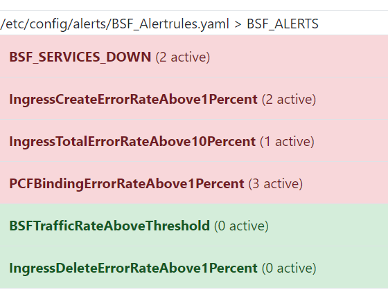

- Verify the alerts in Prometheus GUI.
The following image shows the BSF Alerts:

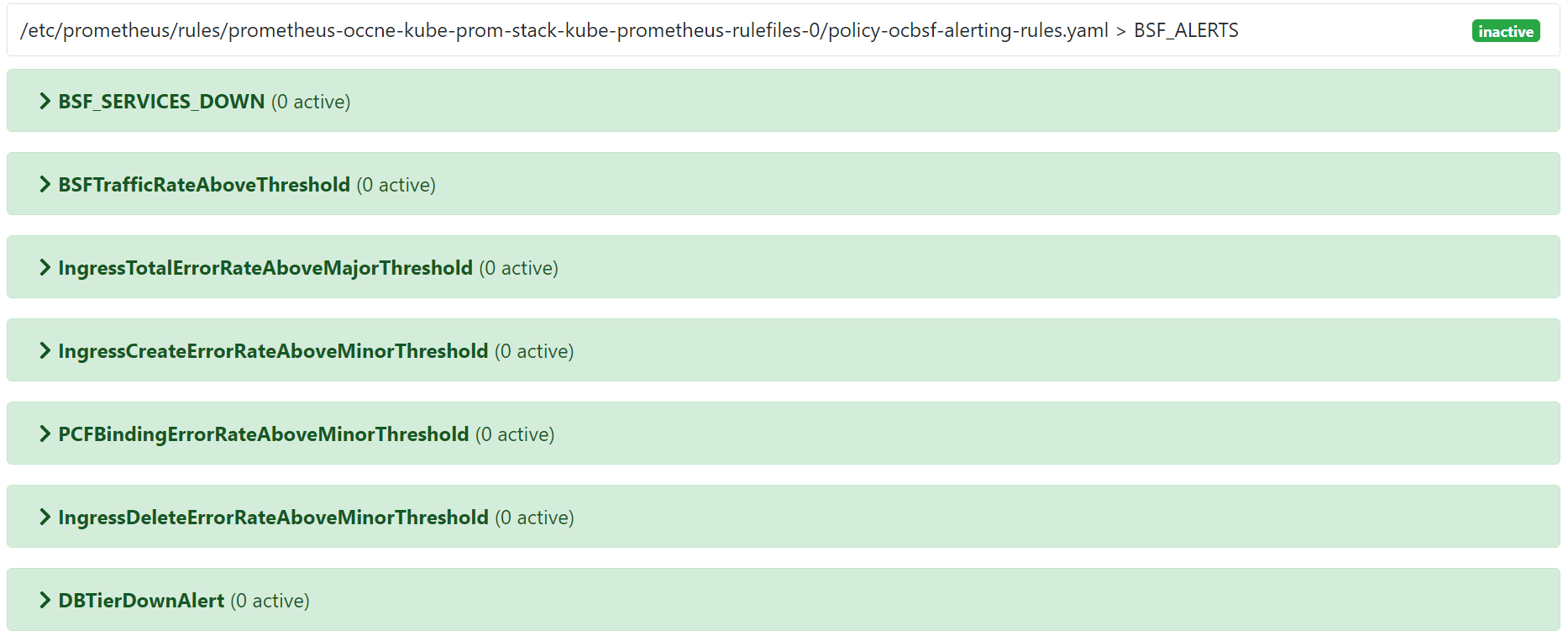

$ kubectl apply -f ocbsf-alerting-rules.yaml -n <namespace>To verify if the CRD is created, run the following command:kubectl get prometheusrule -n <namespace> - To verify the alerts in the Prometheus GUI, select the Alerts tab and view alert details by selecting any individual rule from the list of configured alerts.
Figure 5-1 BSF alerts on Prometheus Dashboard
