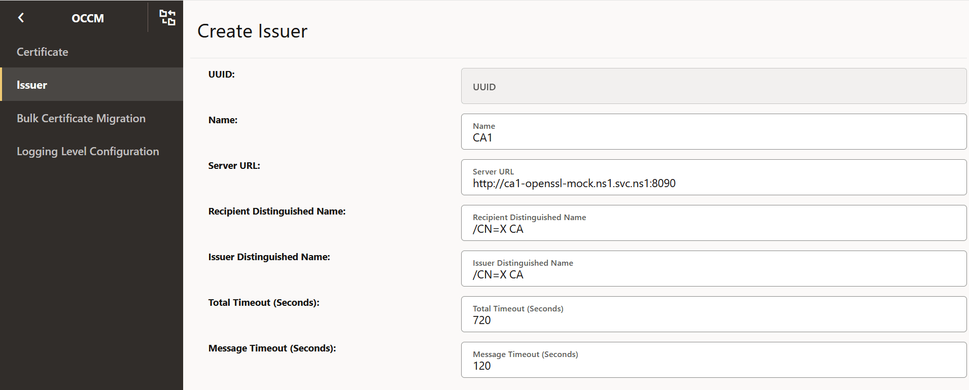

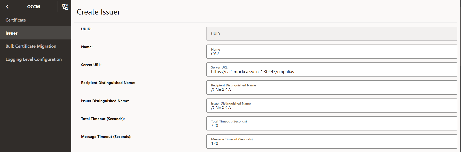

  1. Create the Issuer:

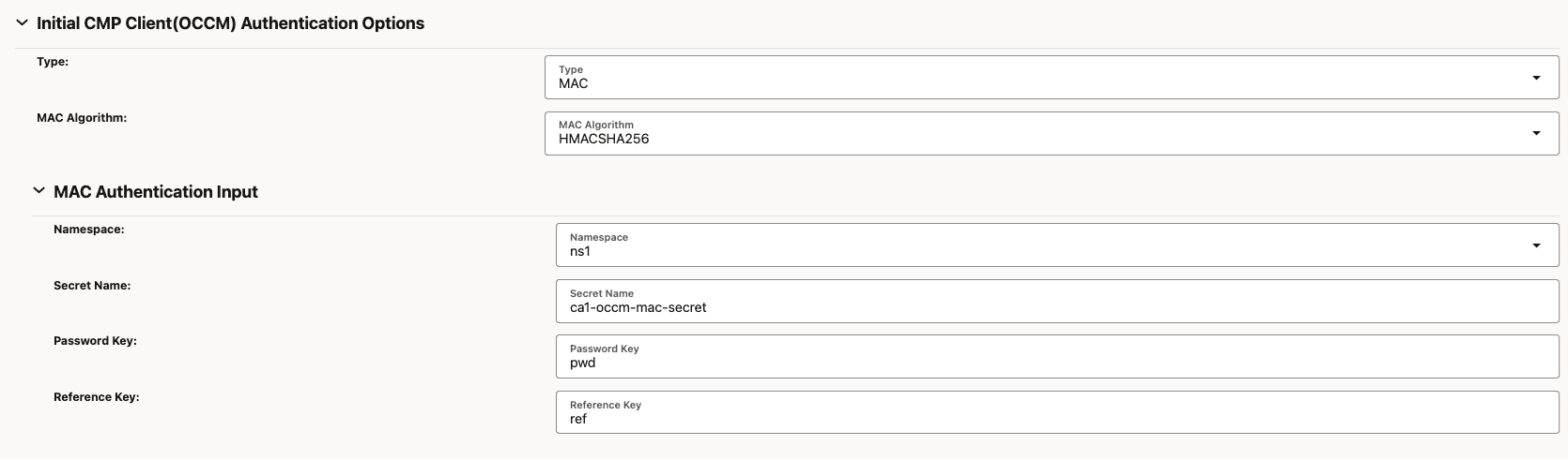

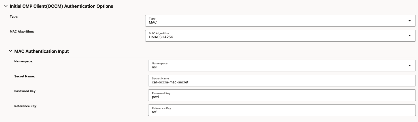

    The following screenshots provide a sample configuration for creating the issuer using CNC Console GUI
    1. Figure -7 Create Issuer
      Create Issuer

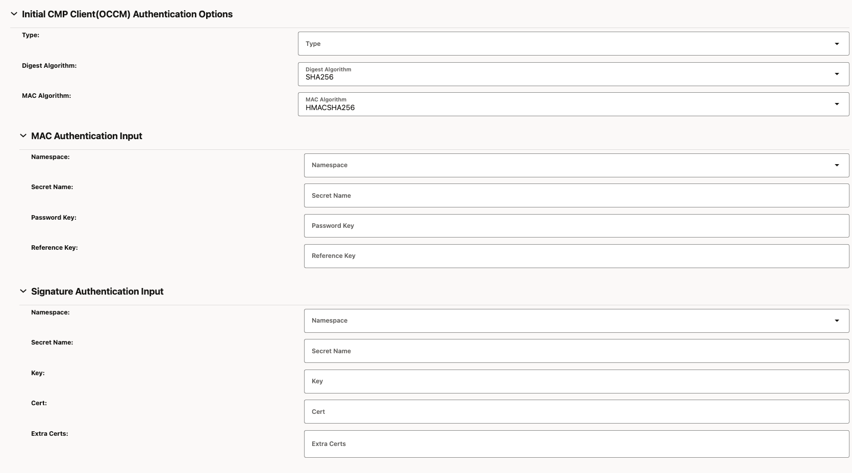

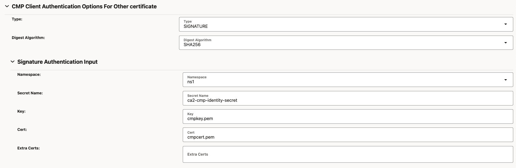

    2. Figure -8 Initial CMP Client (OCCM) Authentication Options

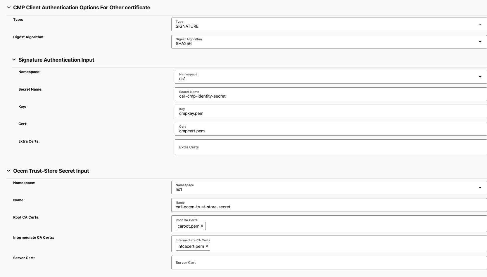

    3. Figure -9 CMP Client Authentication Options for Other Certificate

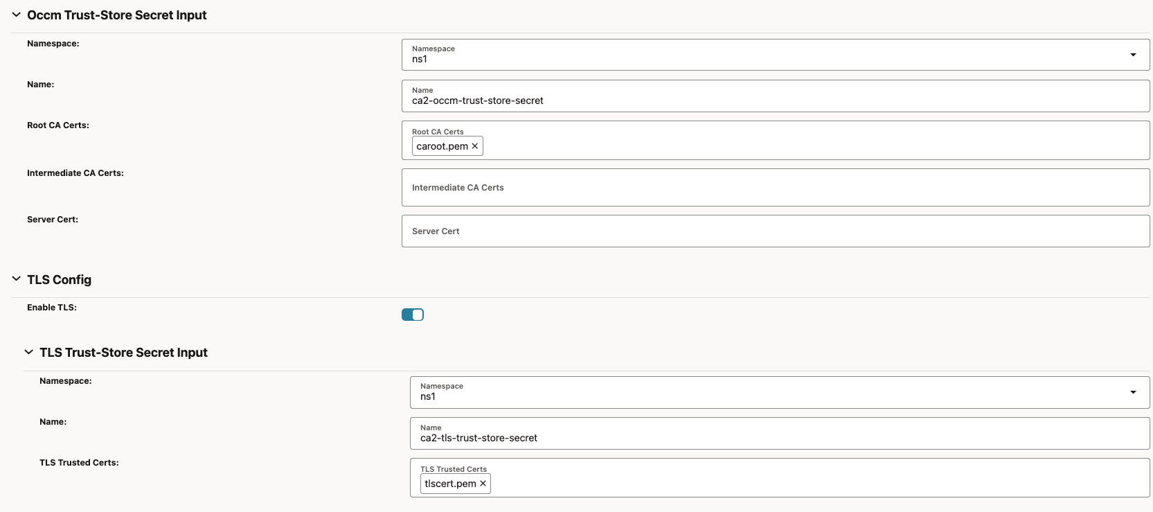

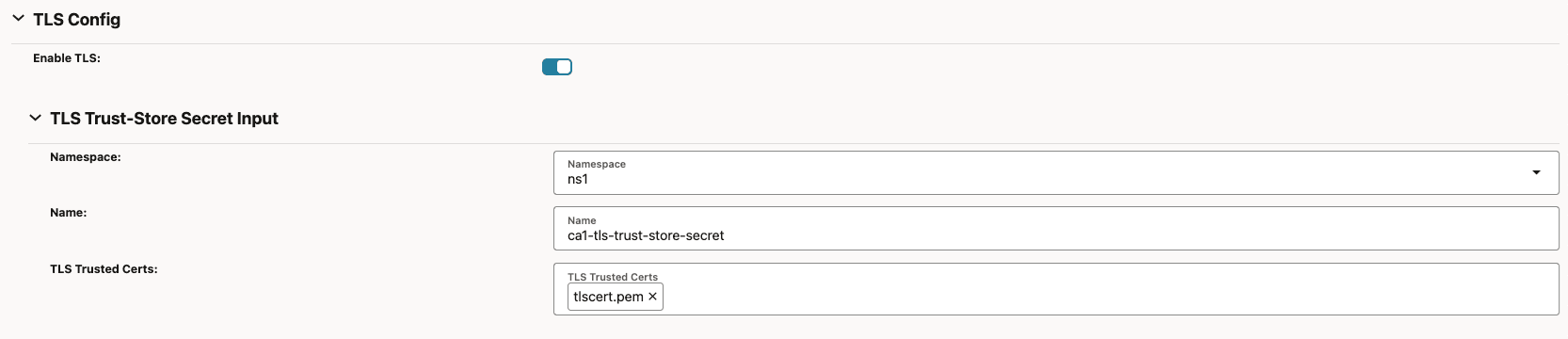

    4. To enable HTTPS communication, provide HTTPS scheme in the server URL field and provide the TLS trust store certificates under TLS config.
      Figure -10 HTTPS Scheme
      HTTPS Scheme
      Figure -11 Enable TLS Config
      Enable TLS Config

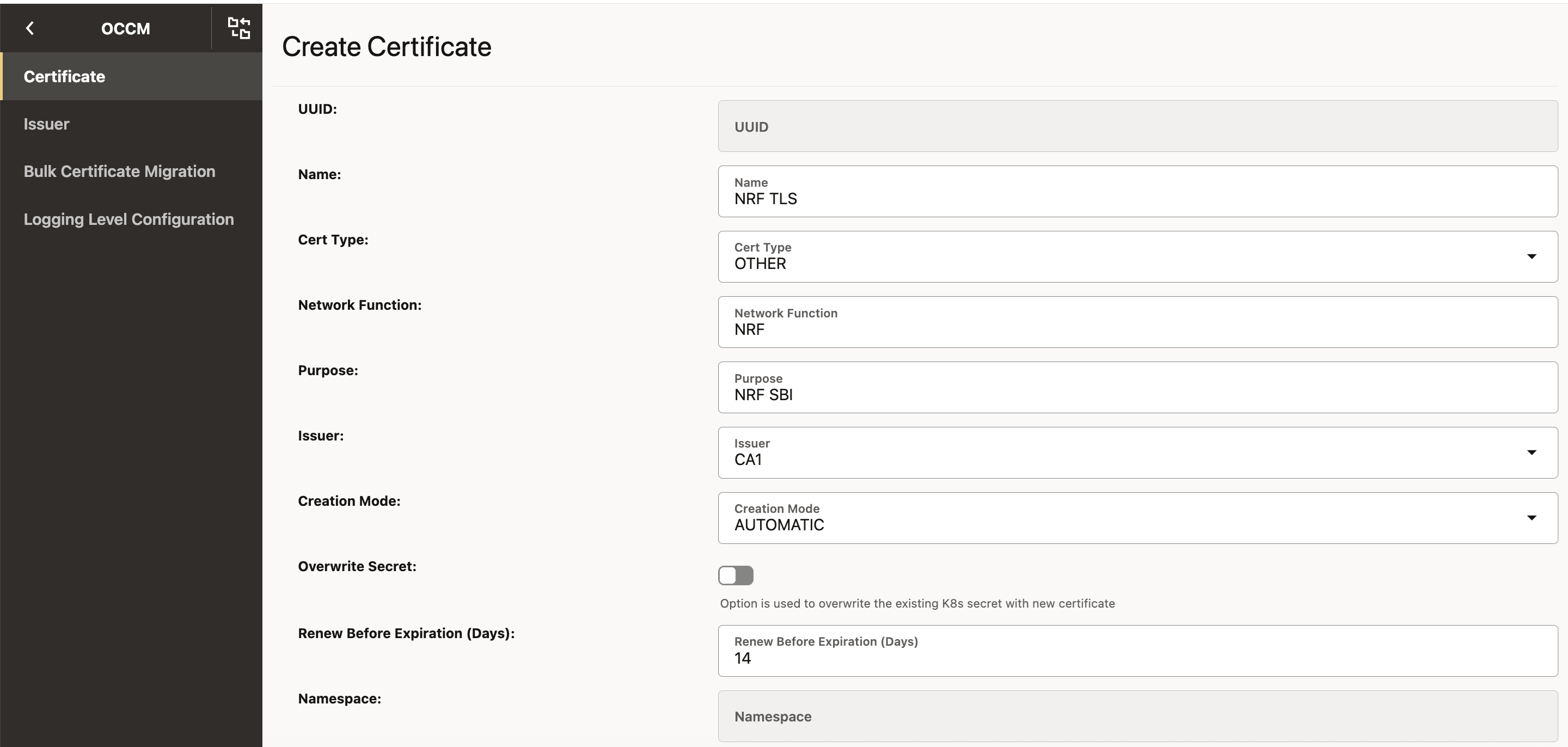

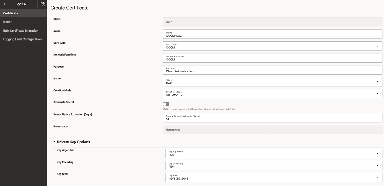

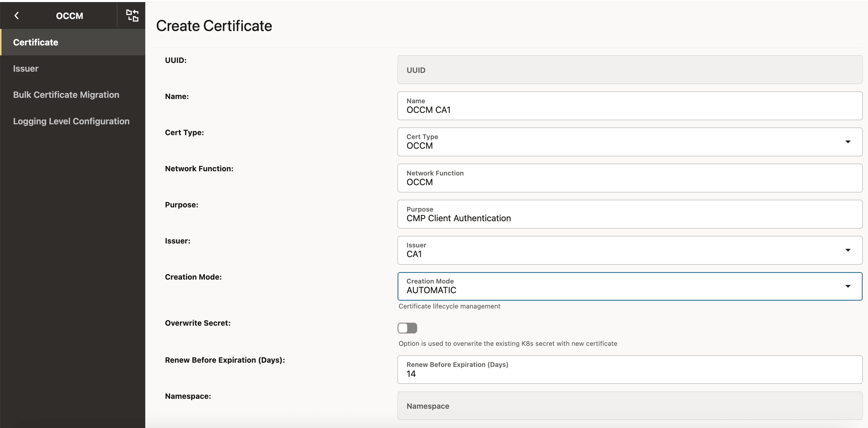

  2. Create CMP Identity (OCCM) Certificate:
    The following screenshots provide a sample configuration for creating CMP Identity (OCCM) certificate using CNC Console GUI. Here, OCCM certificate is configured manually.
    1. Figure -12 Create CMP Identity (OCCM) Certificate
      Select Issuer from the Issuer dropdown in the Create Certificate GUI screen.

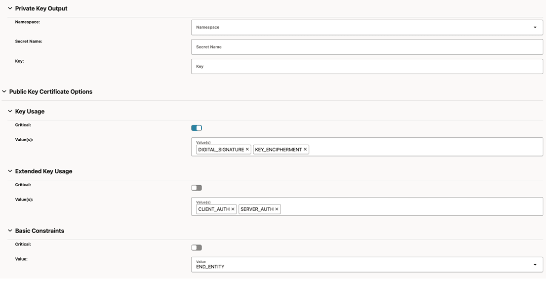

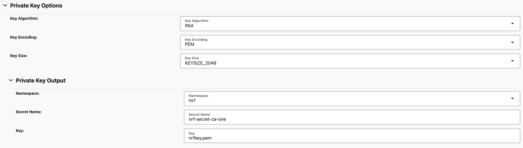

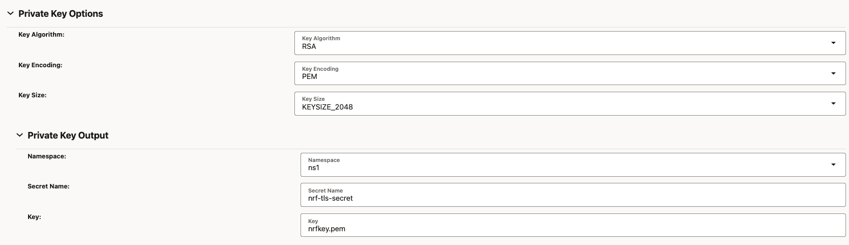

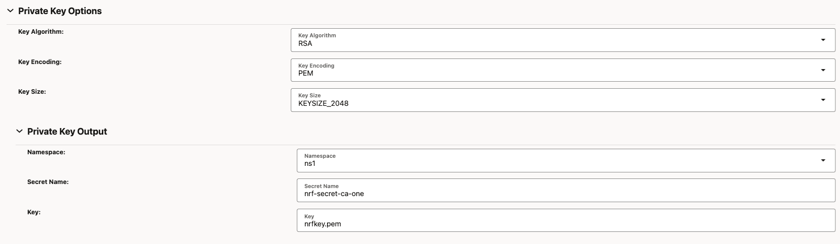

    2. Figure -13 Private Key Options
      Private Key Options

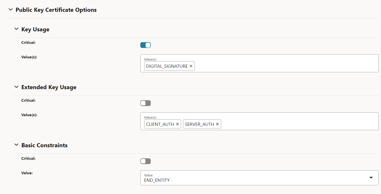

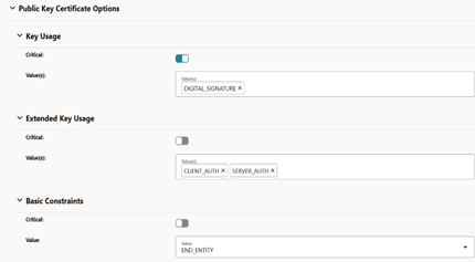

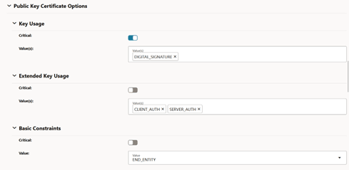

    3. Figure -14 Public Key Certificate Options

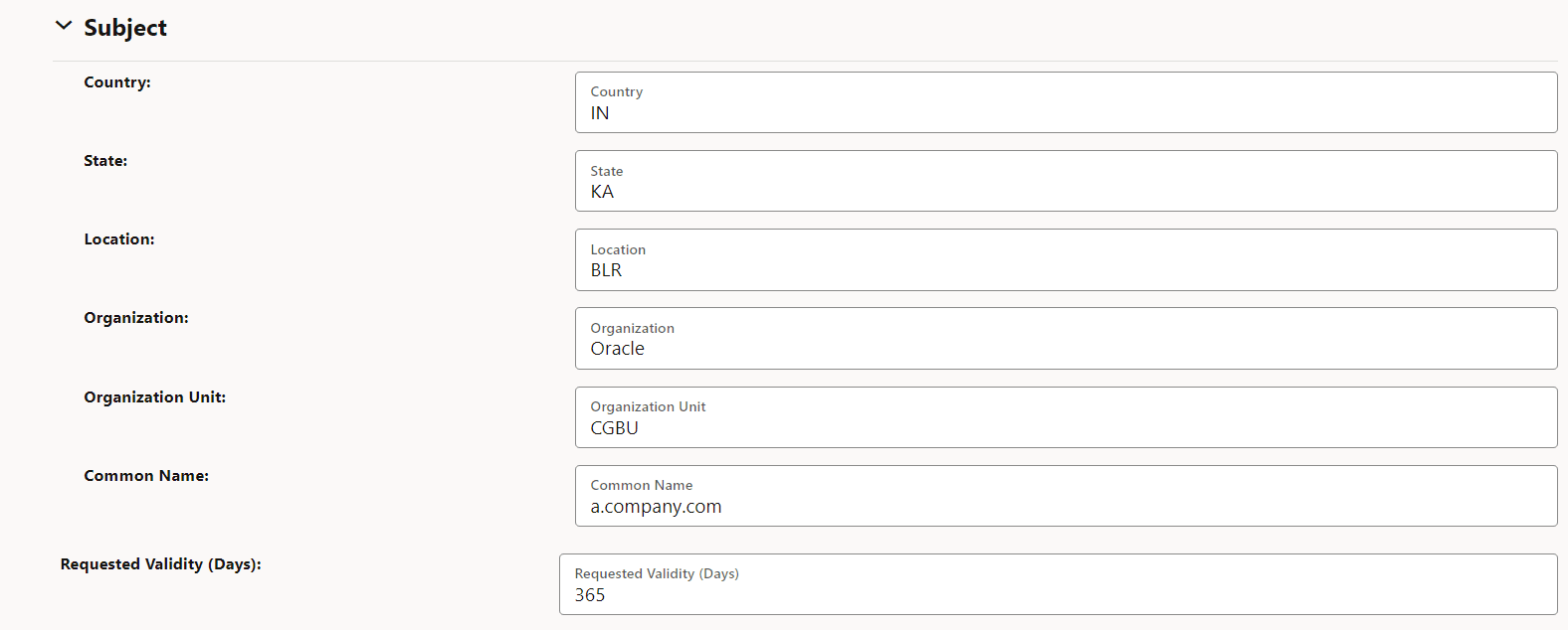

    4. Figure -15 Subject and Subject Alternate Name

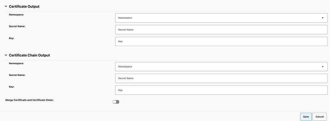

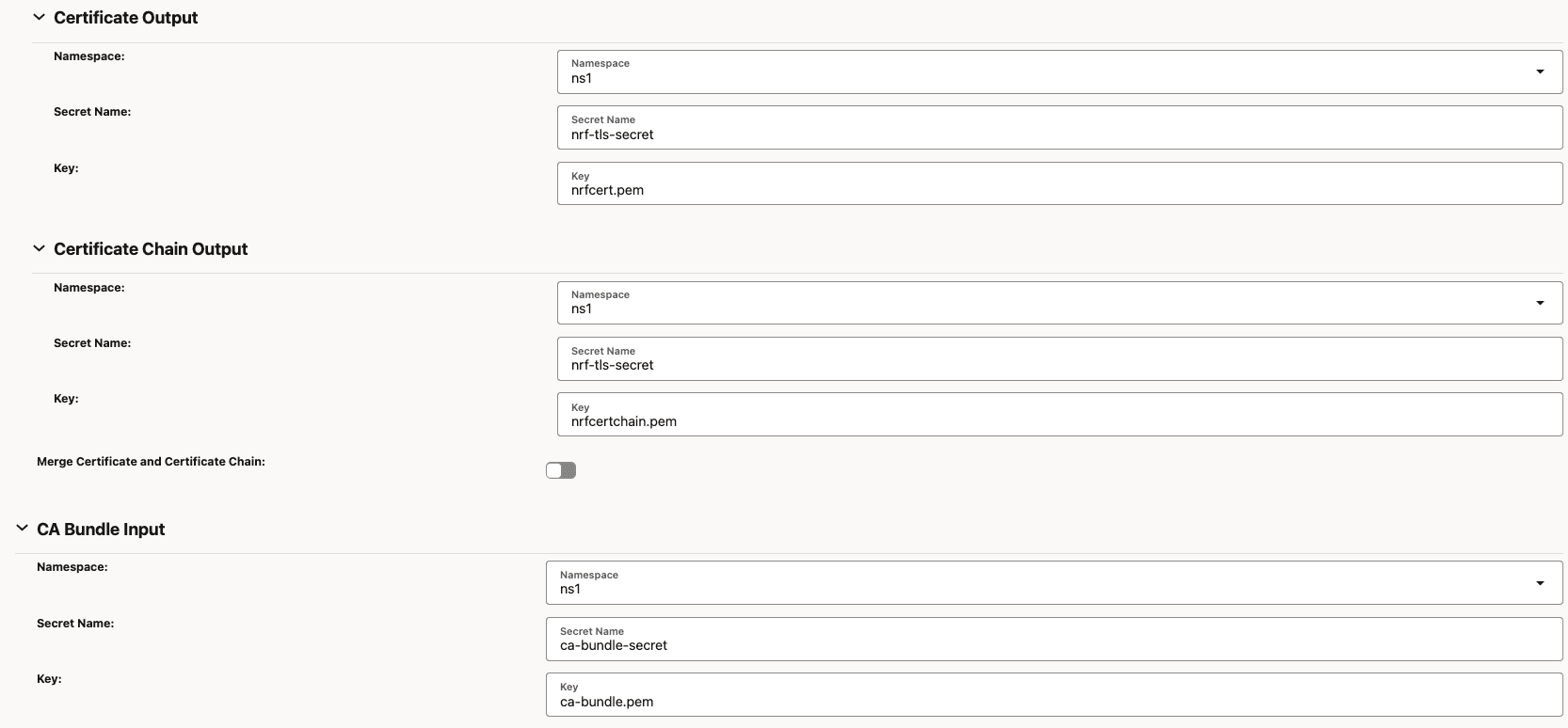

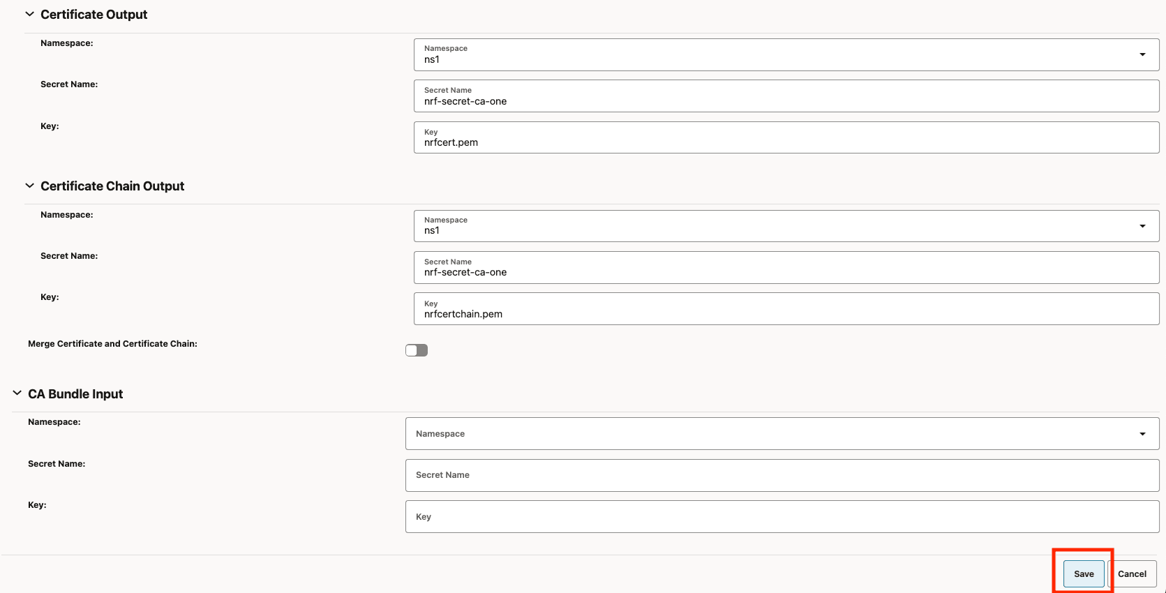

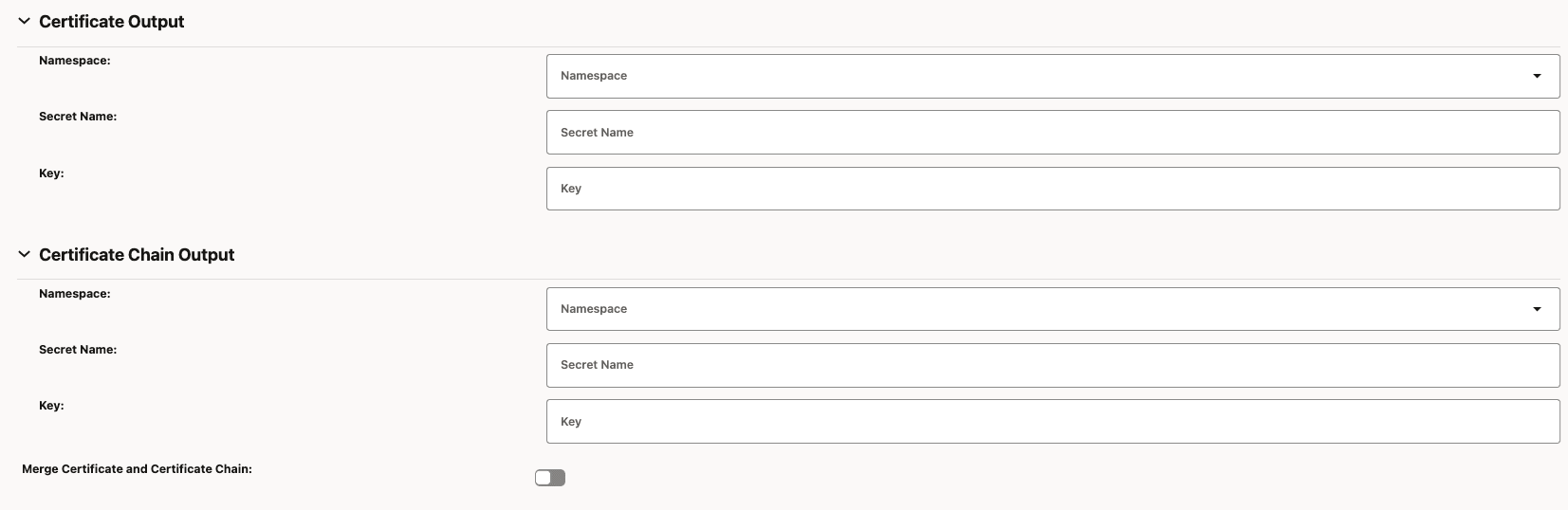

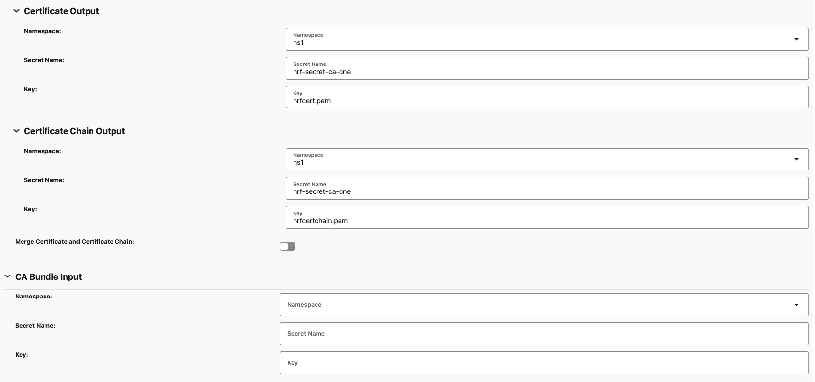

    5. Figure -16 Certificate Output and Certificate Chain Output

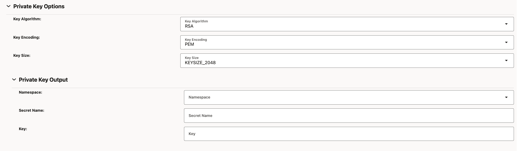

    2. Figure -18 Private Key Options
      Private Key Options

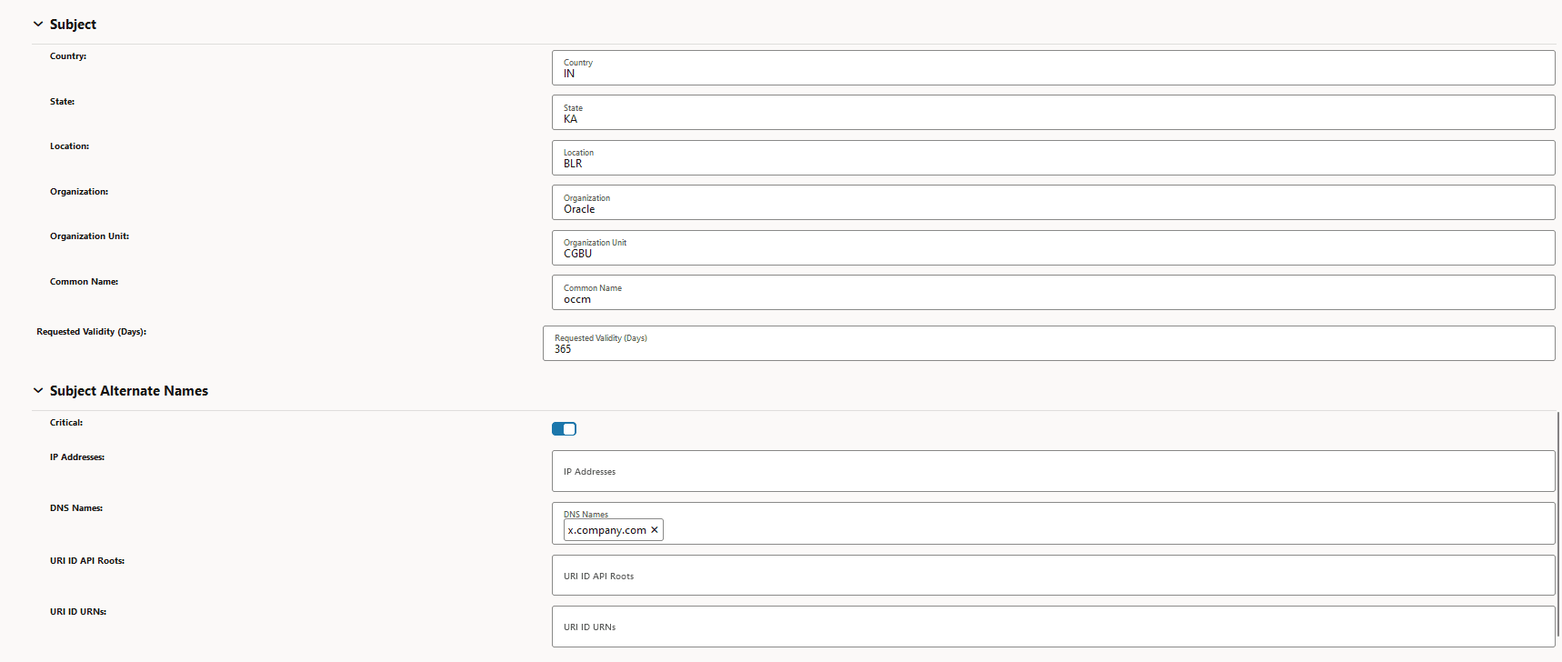

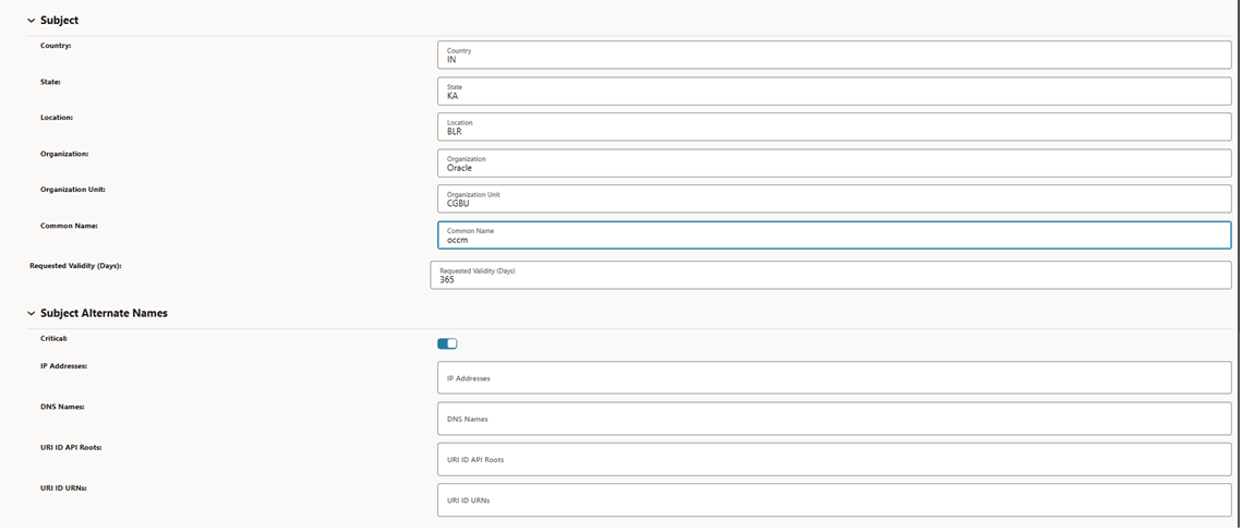

    4. Figure -20 Subject and Subject Alternate Names

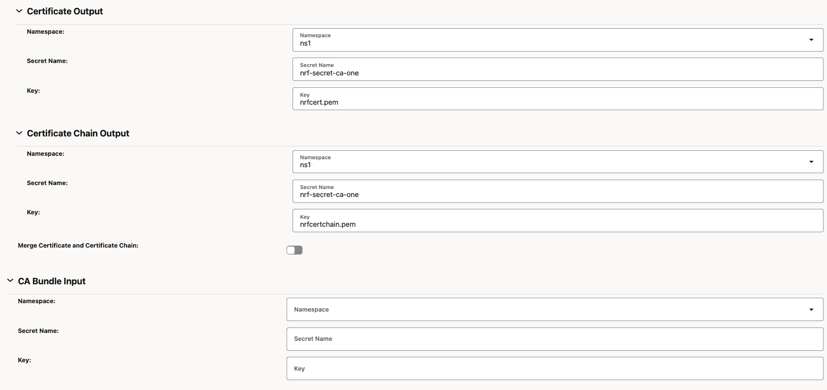

    5. Figure -21 Certificate Output
      Certificate Output

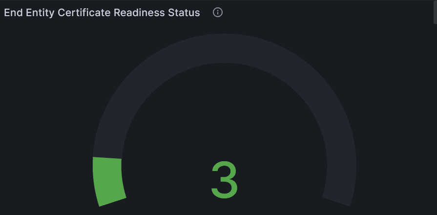

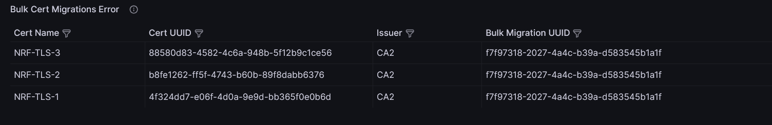

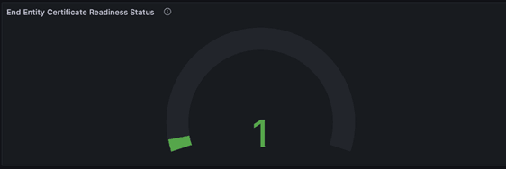

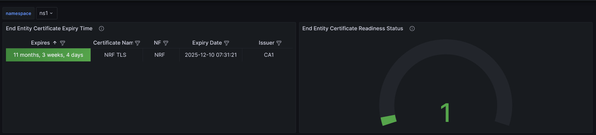

  4. Check Grafana Dashboard
    Check the grafana dashboard to view the certificates created.
    Figure -22 End Entity (NF) Sample Grafana Dasboard

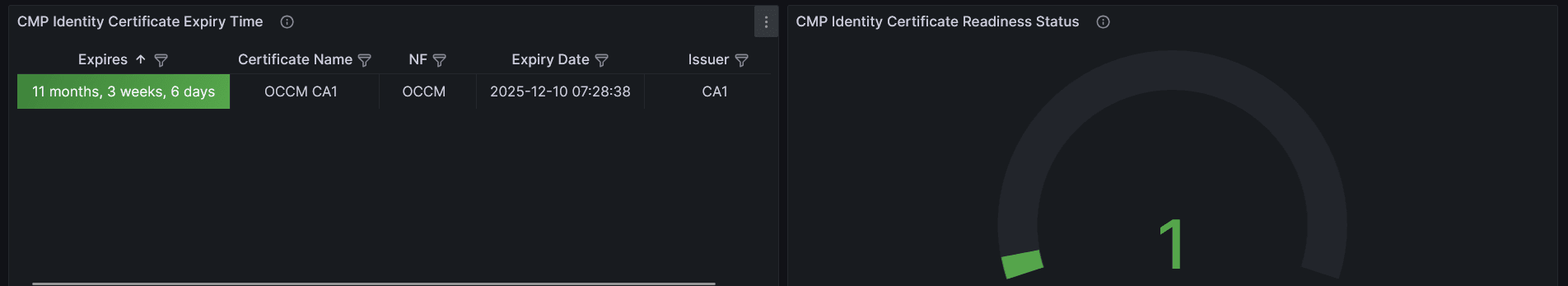

    Figure -23 CMP Identity (OCCM) Sample Grafana Dasboard
    The screenshot shows that NRF TLS Cert and CA1 certificates are created successfully. The left panel indicates their expiry time and the right panel shows that both are ready to be consumed.

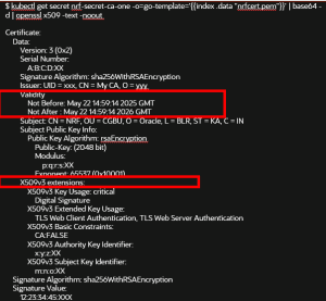

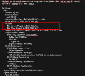

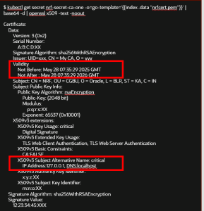

    Output of openssl x509 command for the certificate:
    kubectl get secret <k8s-secret-name> -n <namespace> -o=go-template='{{index .data "<certificate-output-K8s-secret-key>"}}' | base64 -d | openssl x509 -text -noout
    For example:
    $ kubectl get secret nrf-tls-secret -n ns1 -o=go-template='{{index .data "nrfcert.pem"}}' | base64 -d | openssl x509 -text -noout
    Certificate:
      Data:
        Version: 3 (0x2)
        Serial Number:
          XXXXXXXXX
        Signature Algorithm: sha256WithRSAEncryption
        Issuer: CN = x.company.com
        Validity
          Not Before: Dec 10 07:31:22 2024 GMT
          Not After : Dec 10 07:31:21 2025 GMT
        Subject: C = IN, ST = KA, L = BLR, O = Oracle, OU = CGBU, CN = a.company.com
        Subject Public Key Info:
          Public Key Algorithm: rsaEncryption
            Public-Key: (2048 bit)
            Modulus:
              00:c9:1b:35:bf:21:e6:1f:69:9e:78:25:07:4b:6e:
             XXXXXXXXX
            Exponent: 65537 (0x10001)
        X509v3 extensions:
          X509v3 Key Usage:
            Digital Signature
          X509v3 Extended Key Usage:
            TLS Web Client Authentication, TLS Web Server Authentication
          X509v3 Basic Constraints:
            CA:FALSE
          X509v3 Subject Alternative Name:
                    IP Address:10.10.10.20, IP Address:10.10.10.21, DNS:y.commpany.com, DNS:z.commpany.com, URI:urn:uuid:f81d4fae-7dec-11d0-a765-00a0c91e6bf6
          X509v3 Subject Key Identifier:
            2B:0D:XXXXXXXXXXXX
          X509v3 Authority Key Identifier:
            20:03:XXXXXXXXXXX
      Signature Value:
       XXXXXXXXXXXXXXXXXXXXXXX

  2. Private Key Options
    Figure -25 Private Key Options
    Private Key Options

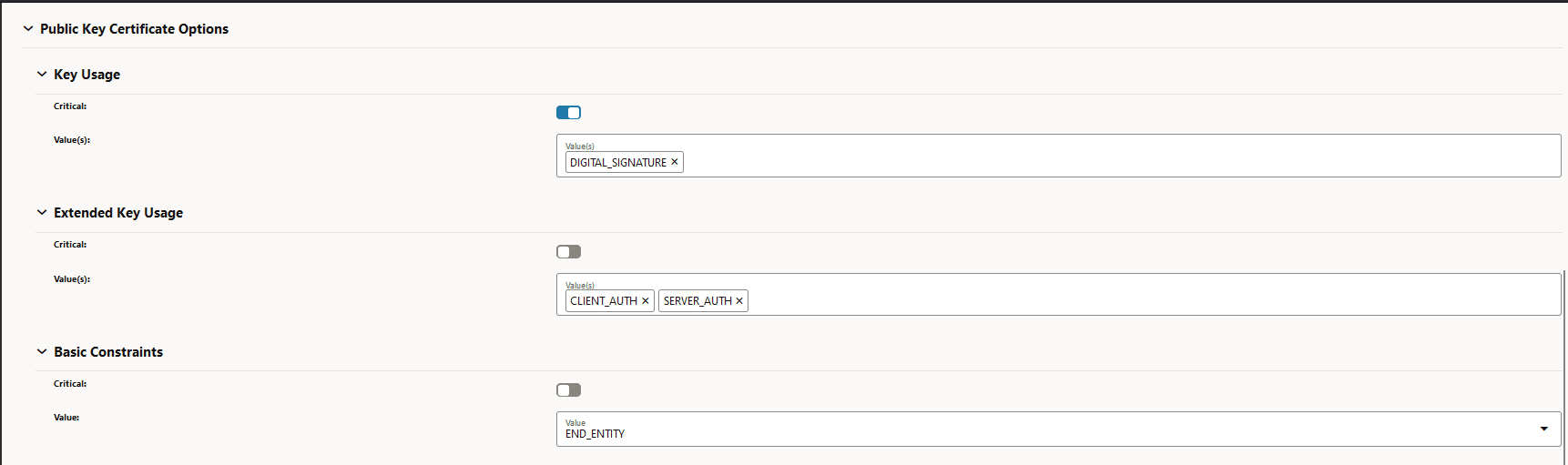

  3. Public Key Certificate Options
    Figure -26 Public Key Certificate Options

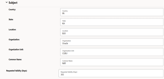

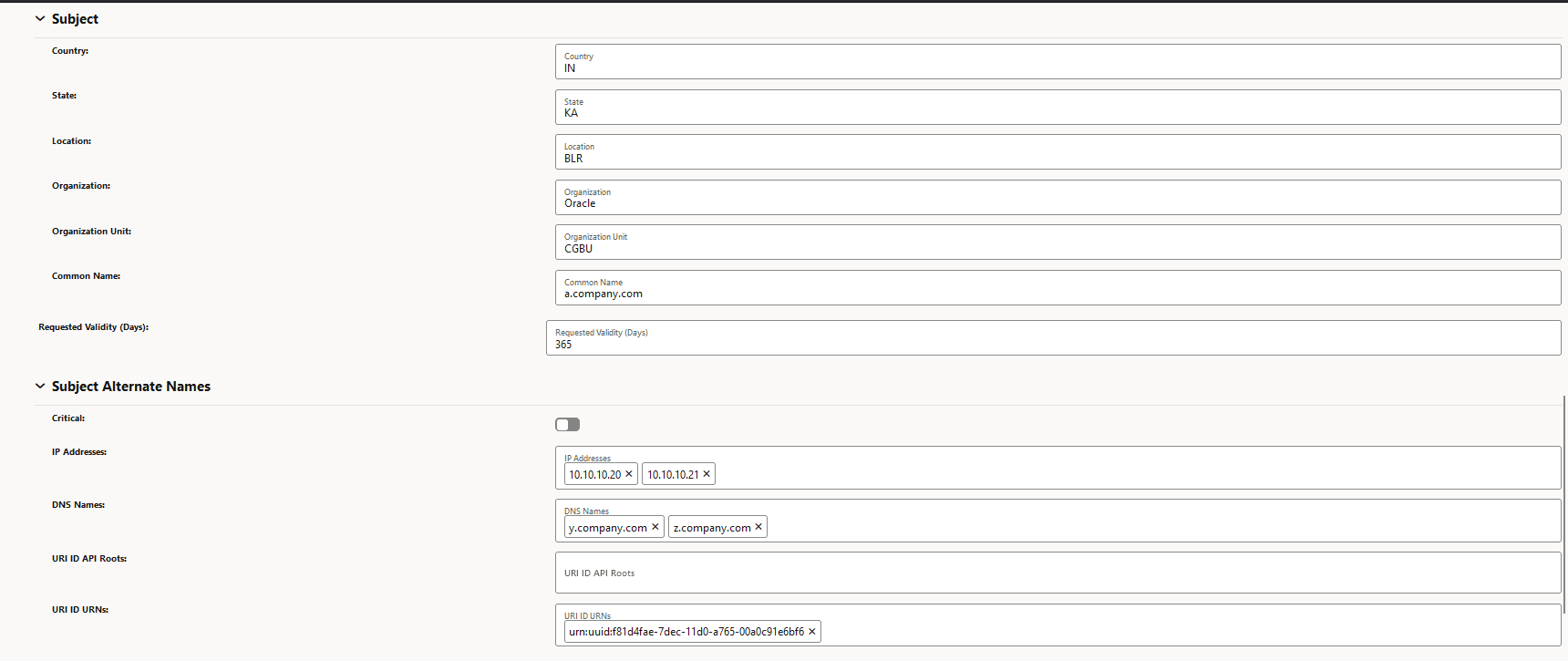

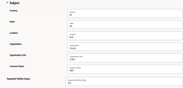

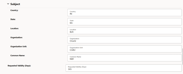

  4. Subject
    Figure -27 Subject
    Subject

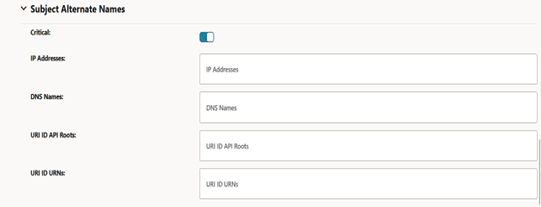

  5. Subject Alternate names
    Figure -28 Subject Alternate names

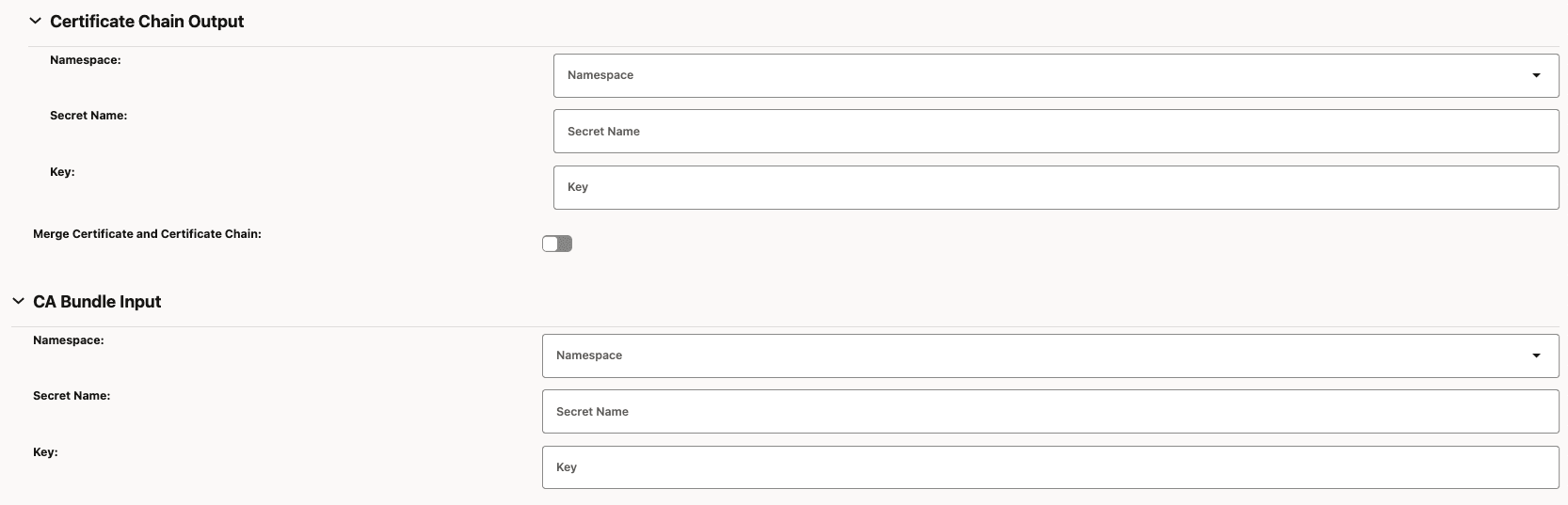

  6. Optional Certificate chain output and CA bundle input fields
    Figure -29 Optional Certificate chain output and CA bundle input fields

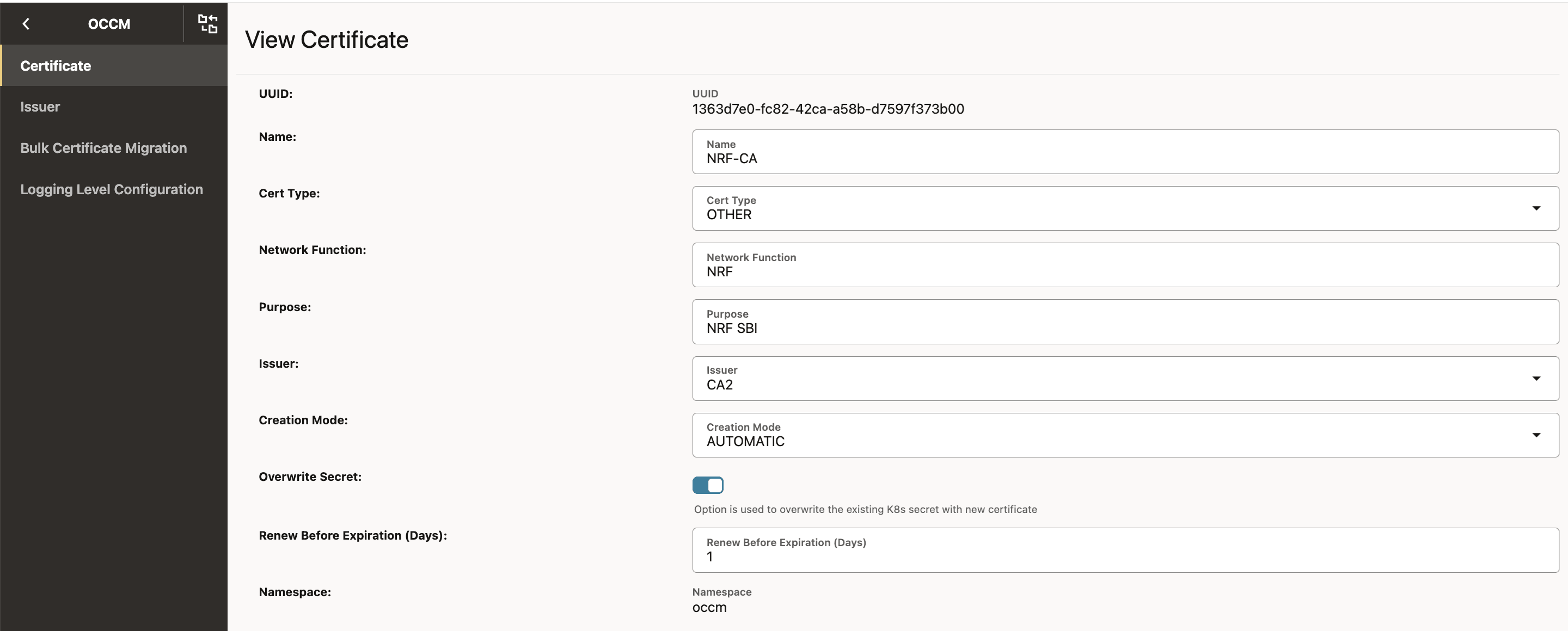

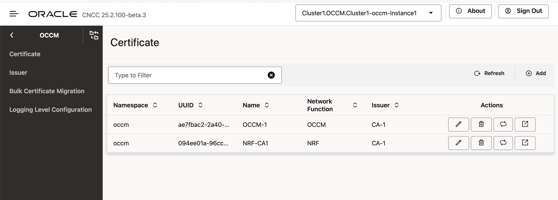

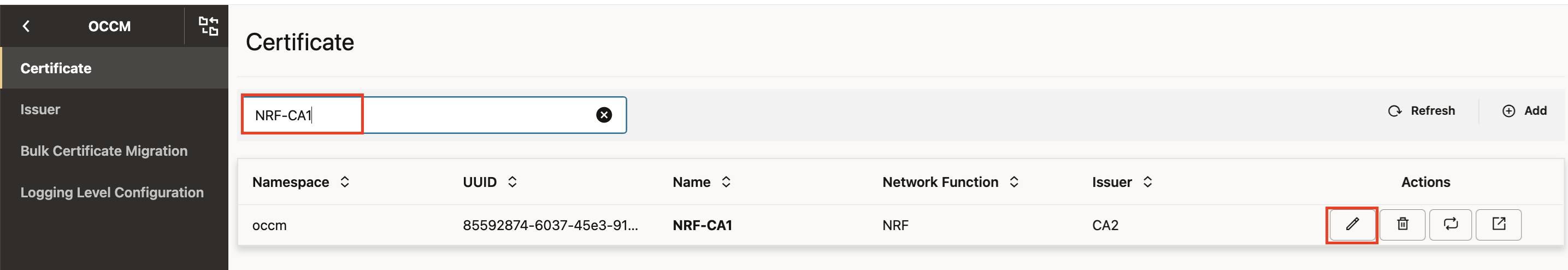

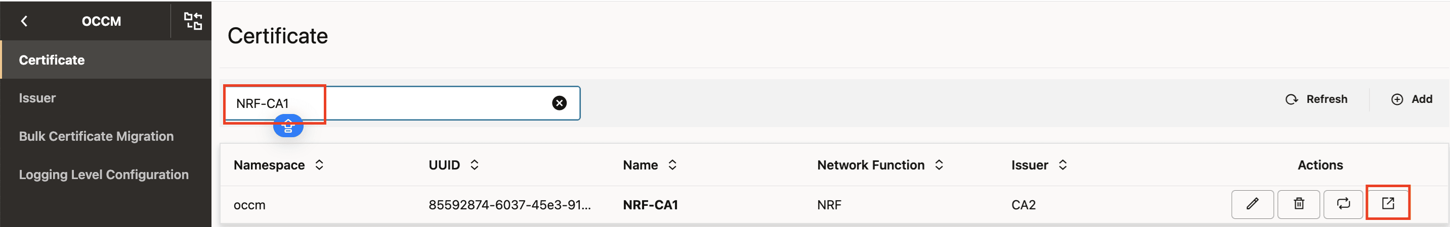

  1. Navigate to the Certificate page and select the certificate to be edited. View the current configuration before editing.
    Figure -31 Certificate Page
    Certificate Page
    Figure -32 View Certificate
    View Certificate

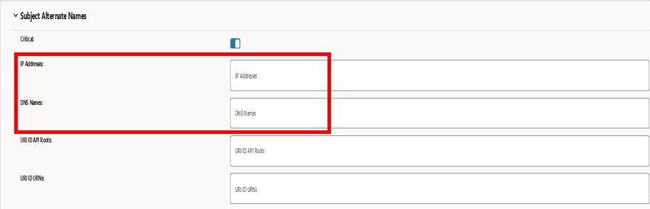

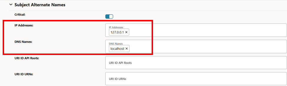

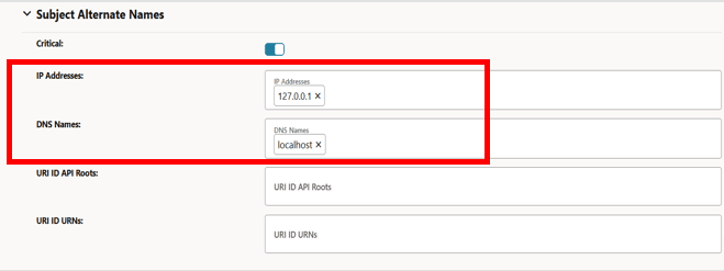

    Figure -36 View Certificate: Subject Alternate Names (SANs)
    Missing Subject Alternate Names

  3. If the certificate (secret) exists in the system, verify its secret content with respect to current configuration before editing. Here in the example, no SAN entry can be seen on the certificate as certificate configuration related to SAN are missing.
    Figure -39 Missing SANs
    Missing Certificate Configurations

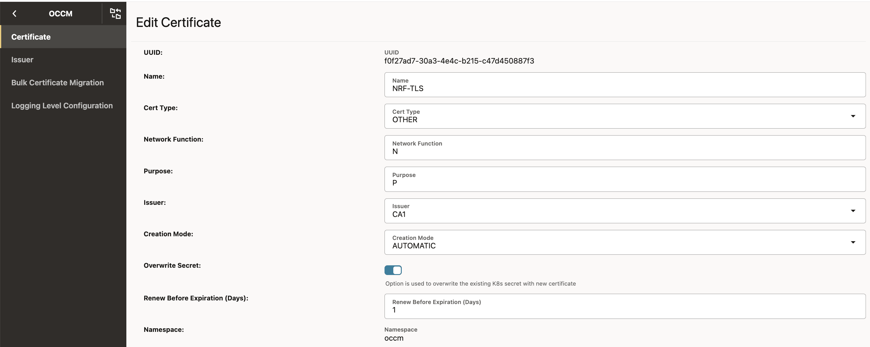

  4. Edit the certificate configuration field(s) and click Save.
    Figure -40 Certificate
    Certificate
    Figure -41 Edit Certificate
    Edit Certificate

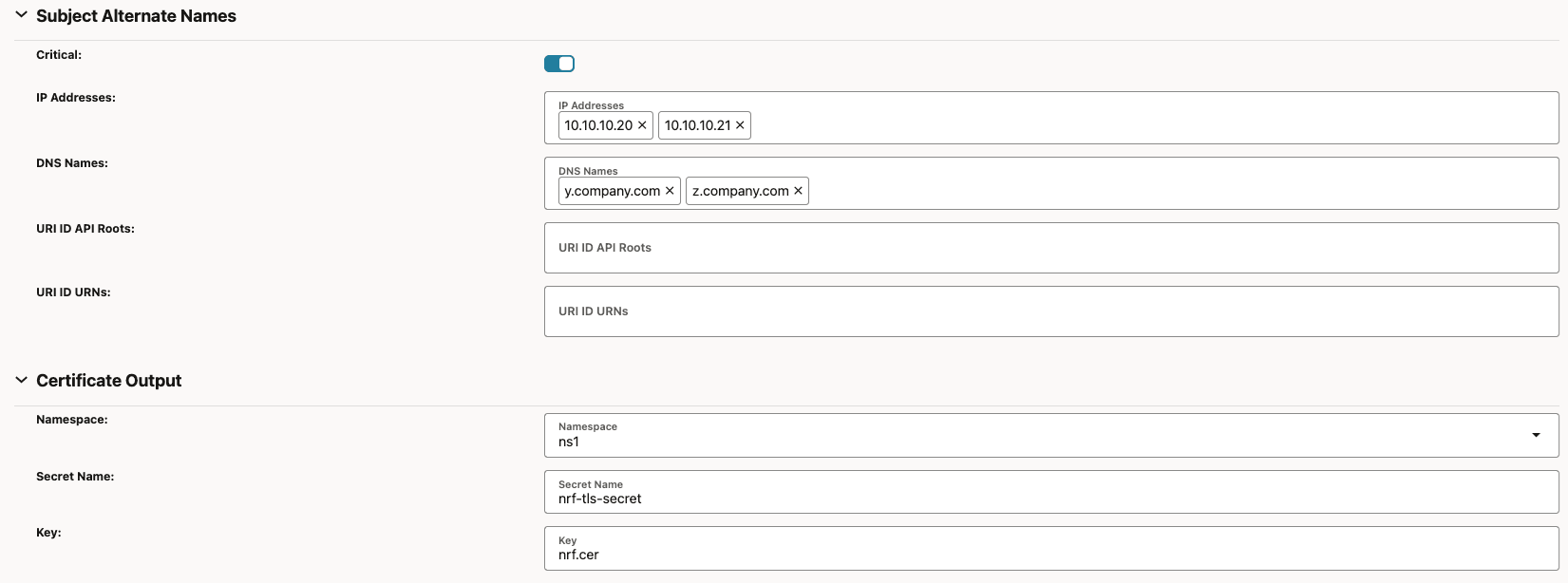

    Figure -45 Edit Certificate: Subject ALternate Names (SANs)
    Edit the SAN fields
    Figure -46 Updated IP address and DNS Names

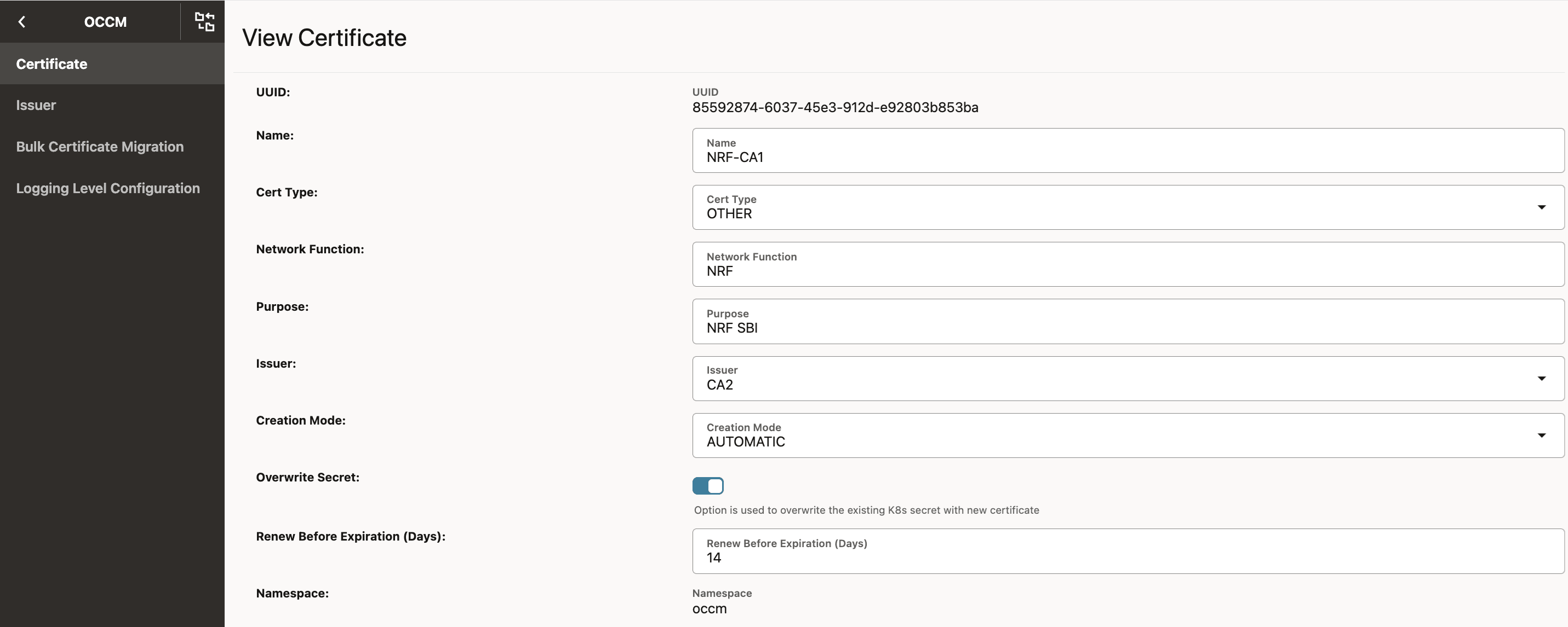

    Figure -49 View Certificate
    View Certificate

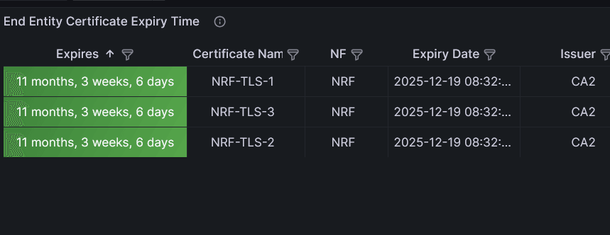

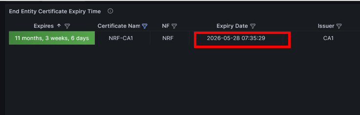

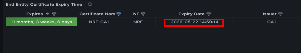

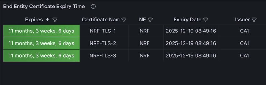

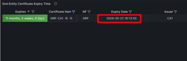

  6. If the field update triggers recreation, verify that certificate recreation with updated configuration is successful. See the Grafana dashboard to verify that the certificate expiry has been extended, the certificate status is ready, and the secret content has been updated as per the new configuration. In the following screenshot, the certificate expiry has been extended as shown in the End Entity Certificate Expiry Time panel.
    Figure -55 End Entity Certificate Expiry Time panel
    Verify that the secret content is updated as per the edited configuration.
    Figure -56 Secret Updated with SAN

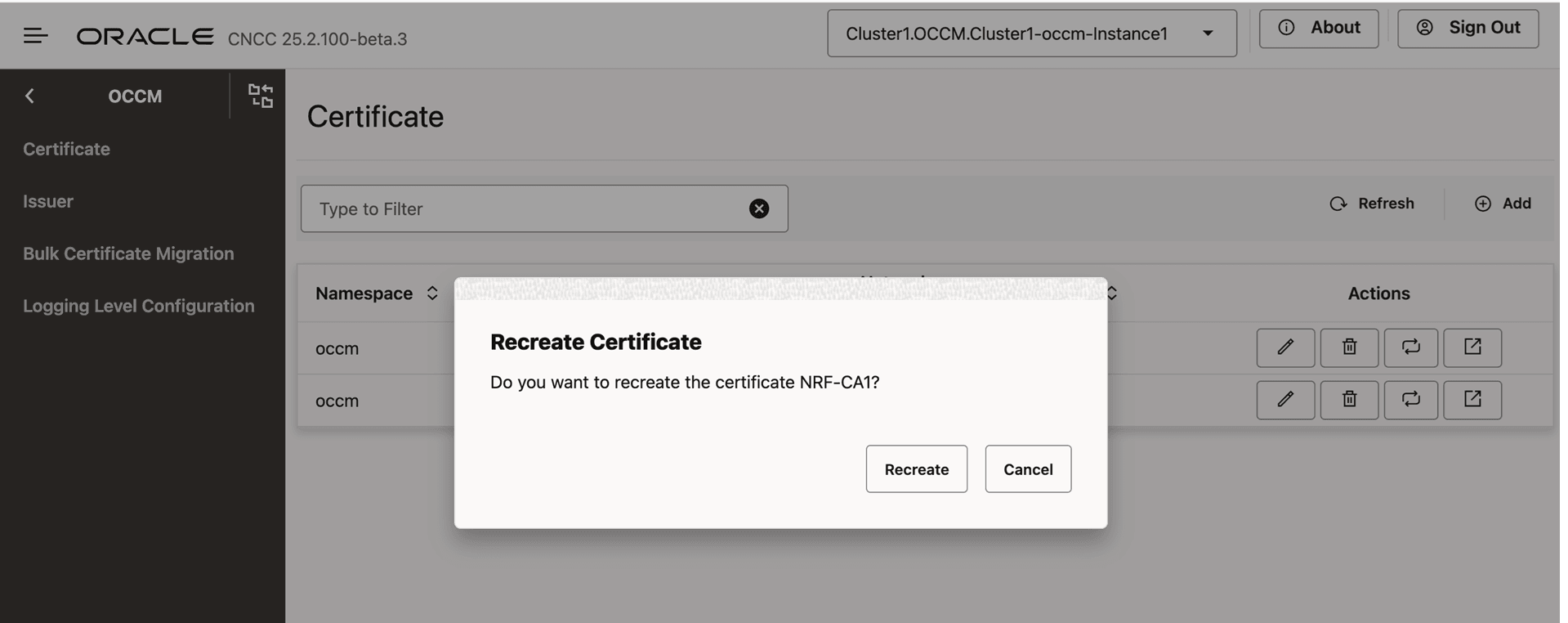

A.1.3 Recreating Certificates - Sample Configuration
This section describes the procedure to recreate a certificate.
To recreate certificates:

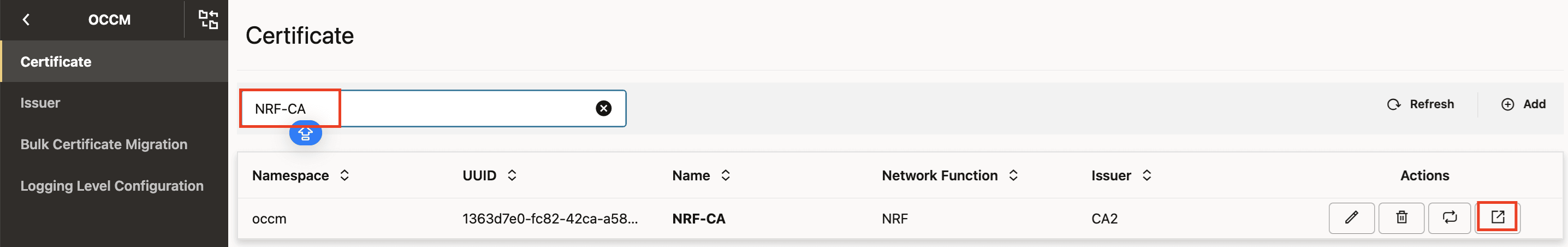

  1. Log in to CNC Console using your login credentials and select the OCCM Instance.
  2. Click OCCM from the left pane and then click Certificate.
  3. Click the Recreate Icon next to the certificate that you want to recreate. For example, to recreate NRF-CA1, click the recreate button for NRF-CA1.
    Figure -57 Recreate Icon
    Recreate Icon
    The Recreate Certificate dialog box appears.
    Figure -58 Recreate Certificate
  4. Click Recreate to proceed. Click Cancel to discard your progress and close the dialog box.
  5. Check the Grafana dashboard to view the recreated certificate
    1. Check the 'End Entity Certificate Expiry Time' panel to verify that the certificate expiry date has extended after successful recreation. In case the recreation fails, the certificate expiry date will not be extended and will display the remaining validity.
      Figure -59 End Entity Certificate Expiry Time
    2. Check the 'End Entity Certificate Readiness Status' panel to verify the certificate status. If recreation succeeds, the status will be set to READY, otherwise the status will be set to FAILED.
      Figure -60 End Entity Certificate Readiness Status
  6. Optionally, verify that the certificate validity has been extended by checking the content of the kubernetes secret corresponding to the configuration. Run the following command to verify the Kubernetes secret:
    $ kubectl get secret nrf-secret-ca-one -o=go-template='{{index .data "nrfcert.pem"}}' -n ns1 | base64 -d | openssl x509 -text -noout
    A sample response is as follows:
    Figure -61 Secret with Extended Validity

  1. Create the destination issuer CA2 with the requisite configuration. For more information about the steps, see Managing Issuers.
    1. Figure -62 Create Issuer
      Create Issuer
    2. Figure -63 Initial CMP Client (OCCM) Authentication Options
    3. Figure -64 MAC Authentication Input
    4. Figure -65 CMP Client Authentication Options For Other certificate
    5. Figure -66 Occm Trust-Store Secret Input
  2. Create CMP (OCCM) Identity certificate OCCM-CA2 corresponding to the destination issuer CA2. For more information about the steps, see Managing Certificates.
    1. Figure -67 Create Certificate
      Create Certificate
    2. Figure -68 Private Key
      Private Key
    3. Figure -69 Subject
      Subject
    4. Figure -70 Certificate Output
      Certificate Output

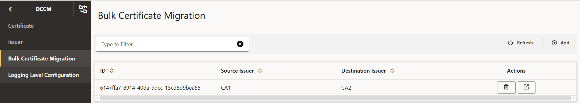

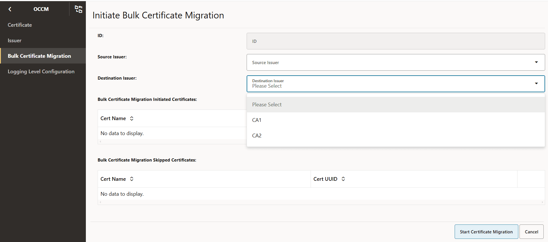

  3. Initiate the bulk certificate migration by choosing the source issuer as CA1 and destination issuer as CA2 from the drop downs list. Other fields must be empty.
    2. Click OCCM from the left pane and then click Bulk Certificate Migration.
    3. The Bulk Certificate Migration page appears. Click Add. The Initiate Bulk Certificate Migration page appears.
    4. Choose the source and destination issuer from the drop-down list and click on Start Certificate Migration.
      Figure -71 Initiate Bulk Certificate Migration
    5. A configuration is created and displayed as follows. This configuration can be viewed to know on which certificates migration was triggered and if it is skipped on any certificate.
      Figure -72 Bulk Certificate Migration

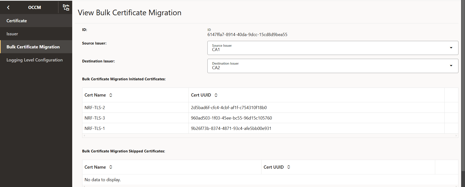

  4. View the configuration to check the certificates on which migration is initiated.
    Figure -73 View Bulk Certificate Migration
  5. Check the Grafana dashboard to verify the migration status of each certificate displayed under the field Bulk Certificate Migration Initiated certificates:
    1. When the migration is successful on a certificate.
      • To verify the migration status for each certificate refer to the End Entity Certificate Expiry Time and the End Entity Certificate Readiness Status panels .
      • On the End Entity Certificate Expiry Time the corresponding issuer of the certificate considered in bulk migration is updated to the destination issuer (CA2) and the expiry date will be extended based on the configuration.
      • On the End Entity Certificate Readiness Status the certificate will be in the READY state.
      In the following example, the bulk migration is triggered on three certificates. The updated issuer, expiry, and the readiness status are shown as follows:
      Figure -74 End Entity Certificate Expiry Time
      Figure -75 End Entity Certificate Readiness Status

      • The Bulk Cert Migrations Error panel will have an entry of the certificate whose migration has failed. To check for a given migration, you must filter on the Bulk Migration UUID field. The issuer displayed is the configured destination issuer. The failed migration on all the three certificates for the given bulk migration are as follows.
        Figure -77 Bulk Cert Migrations Error
      • Logs must be checked to find out the reason of the failure and corrective action must be taken.
