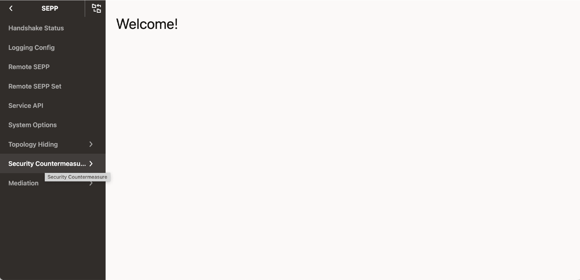

4.2.2 Logging Config
Logging Config allows the user to configure the application based log level and package based log level.
The Logging Config can be configured into SEPP mode and IPX mode. To enable the SEPP mode, set the operationMode flag to true. To enable the IPX mode, set the operationMode flag to false. In IPX mode, the user cannot enable or disable the log level for nfmanagement and nfdscovery services.

4.2.9 Security Countermeasure
The Security Countermeasure option is used to enable and configure the Cat-0 SBI Message Schema Validation feature, Cat 1 -Service API Validation feature, Cat 2 – Network ID Validation feature, and Cat 3 – Previous Location Check feature.
The Service API Allowed List REST API is used to do the configurations on the allowed list of REST APIs.

  1. From the left navigation menu, navigate to SEPP and then click Security Countermeasure.
  2. Click Cat 0 - SBI Message Schema Validation feature under Security Counter Measure, the Option appears underneath.

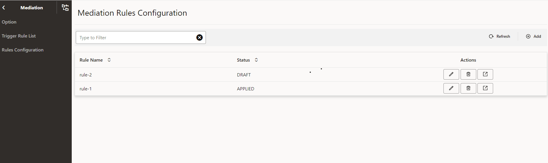

  1. From the left navigation menu, navigate to SEPP and then select Mediation. The Rules Configuration screen appears underneath.
  2. Click Rules Configuration, the list of all the existing rules with corresponding status appears.
    Figure 4-4 Mediation Rules Configuration Screen

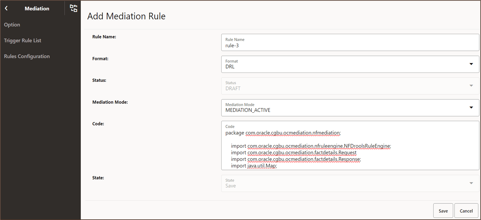

  3. Click Add to add a new rule. The Add Mediation Rule page appears and user can add the mediation rule information.
    Figure 4-5 Add Mediation Rule Screen
    Rule Name, Format, Status, Mediation Mode, Code, and State are the mediation rule parameters.

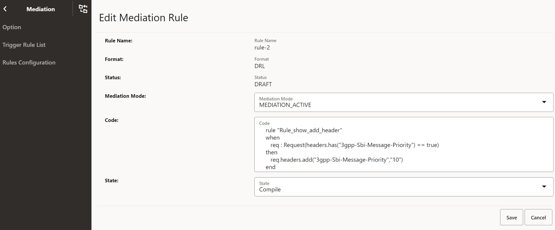

  4. Click Edit button of an existing rule to modify that rule. The Edit Mediation Rule page appears and user can edit the rule information.
    Figure 4-6 Edit Mediation Rule Screen

    import com.oracle.cgbu.ocmediation.factdetails.Response;
    import java.util.Map;
    import java.util.HashMap;
    dialect "mvel"
Format M Enum Rule format. Only DRL is supported currently.
New Rule Name C String New rule name is to be given only when state is clone.
  • The rule name for a rule in the DRAFT status must be unique. Otherwise, the new rule overwrites the old one.
  • The new rule is always created and saved with DRAFT status in the database. User needs to save the rule with APPLY state to apply the rule to mediation microservice.
