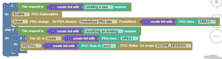

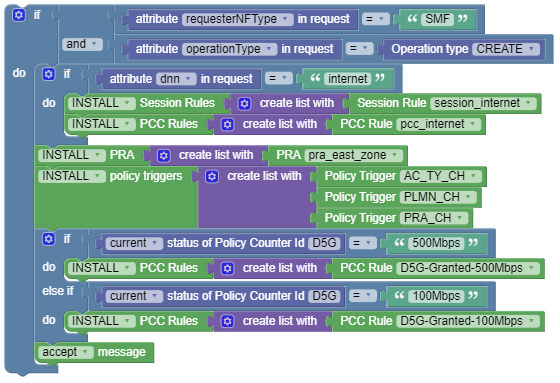

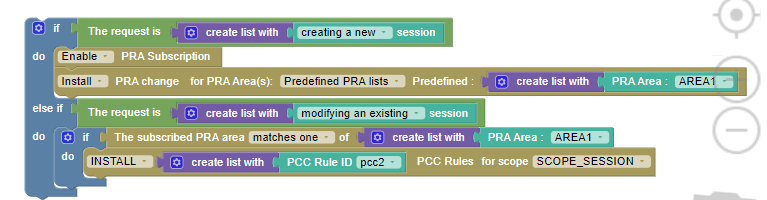

Use Case 1
When PCF receives a create association message, install the following:
  • a Session Rule and a PCC Rule for DNN “internet”

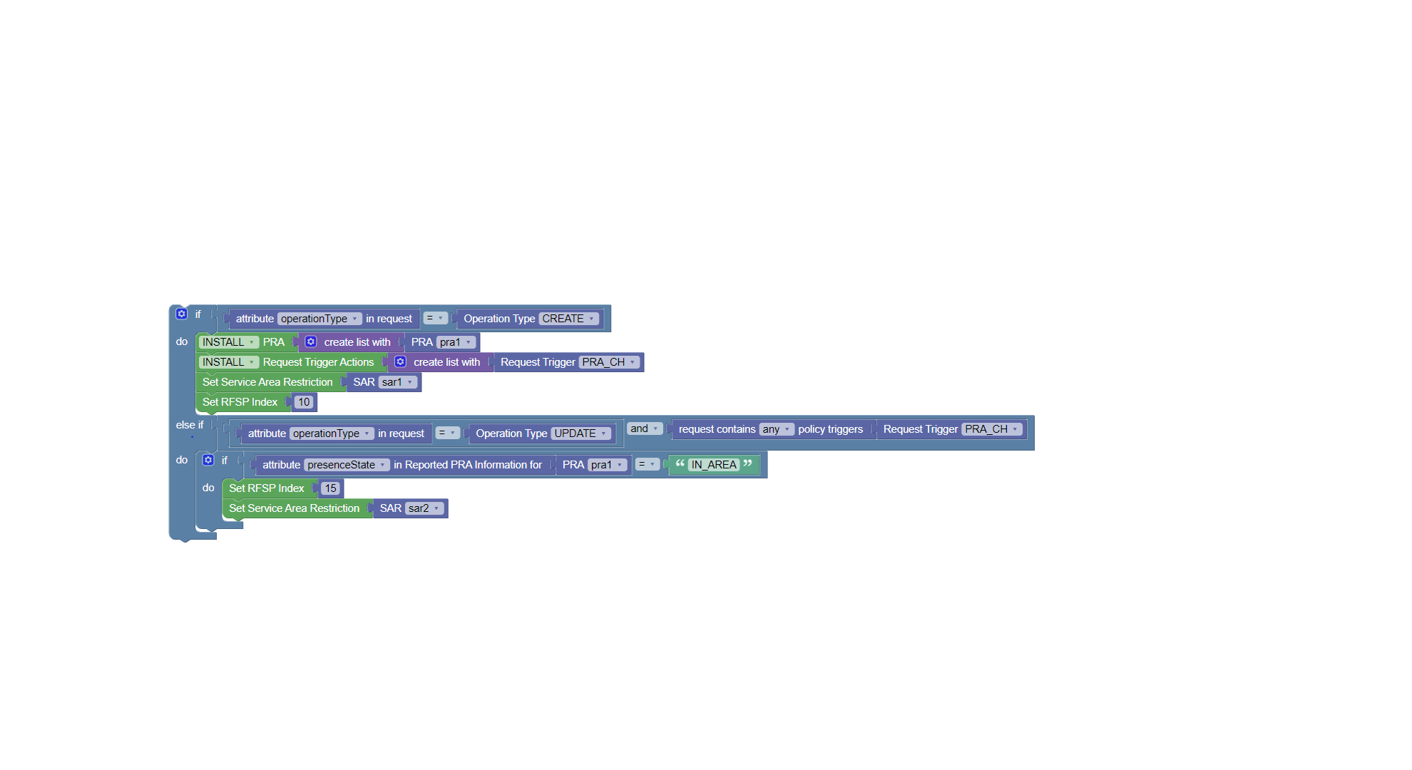

  • a PRA Rule and a list of Triggers
  • additional PCC Rules based on the initial status of Policy Counters received from CHF
The following screen capture shows the created policy after applying the above policy rules:use case 1
Use Case 2
When PCF receives an npcf-smpolicycontrol update association message due to PLMN_CHANGE, update a Session Rule and PCC Rule based on the MCC-MNC received.
The following screen capture shows the created policy after applying the above policy rules:use case 2

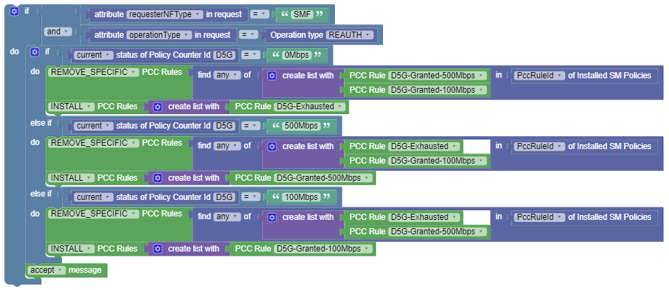

Use Case 3
When PCF receives Policy Counter Status from the Nchf interface, remove the previous rule and install a new PCC rule based on the current status of the Policy Counter.
The following screen capture shows the created policy after applying the above policy rules:use case 3

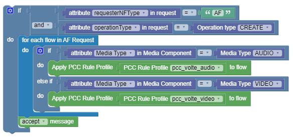

When PCF receives a npcf-policyauthorization create association request, which might be a translated Rx AAR request, then override PCC rules for the received flows based on the media type. If there are no policies, PCF generates a default flow and sends it to smf. To change this default flow, a policy is required.

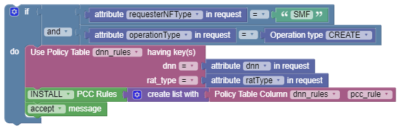

Check the DNN and RAT type in the smf create message, and then install a corresponding PCC Rule. The data is received from the Policy Table.

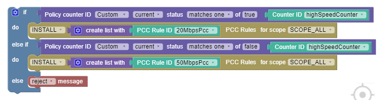

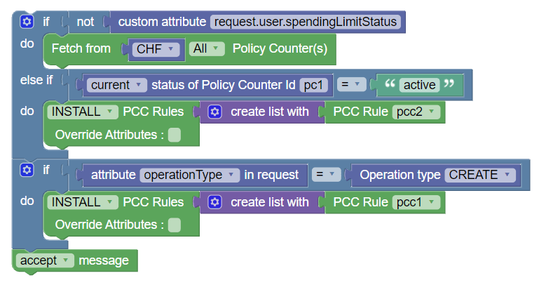

Use Case: Fetch Policy Counters from CHF
The following screen capture shows a sample policy condition to check if spendingLimitStatus is present or not in PRE request. If it is not present then it gives action to fetchFromCHF to SM service. Currently, PDS uses workflow for processing.
sample policy to fetch policy counters from CHF

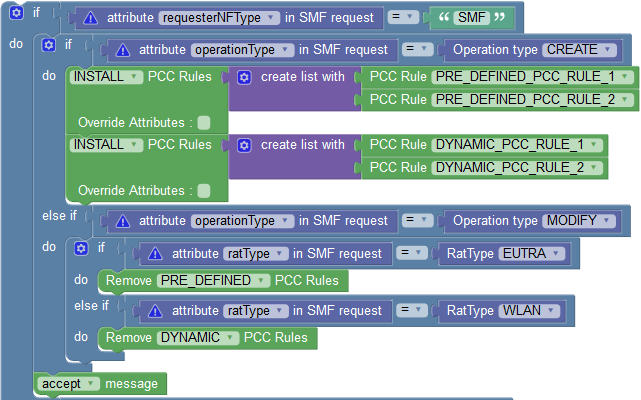

Use Case: Remove PCC Rules in Bulk
The following policy example shows how you can use Remove PCC Rules block to remove pre-defined and dynamic PCC rules in bulk.
Use Case for Remove PCC Rules Block
In the above example, the policy removes pre-defined PCC rules when SM policy association update request changes ratType to EUTRA. Similarly, when SM policy association update request changes ratType to WLAN, policy removes dynamic PCC rules.

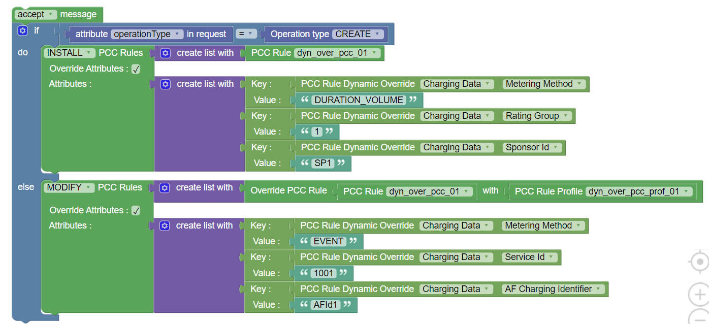

Use Case: Dyamic Update/Override of PCC Rule Attributes
The following policy example shows how you can override PCC rule attributes in real-time. It shows a create request to install PCC rule dynamically overriding Charging Data attributes.Use case for dynamic override of PCC rule attributes

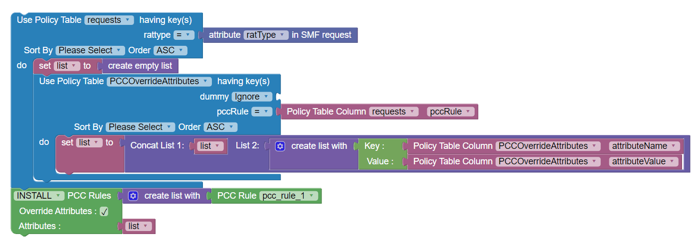

Use Case: Dynamic Override of PCC Rule Attributes with Policy Tables
The following policy example shows how you can use nested policy tables to override PCC rule attributes in real-time.Use case for dynamic override of PCC rule attributes with policy tables
In the above policy:
  • Outer Use Policy Table block filters table data by rattype that is received in request.
  • Inner Use Policy Table block loops through override attributes and their values for particular PCC Rule. After this step, list of override attributes becomes available.
    Concat List block is used to append {key:value} pair of attributes to list variable.
  • The list, received in the previous step, is directly added to override attributes in Install PCC Rule block.

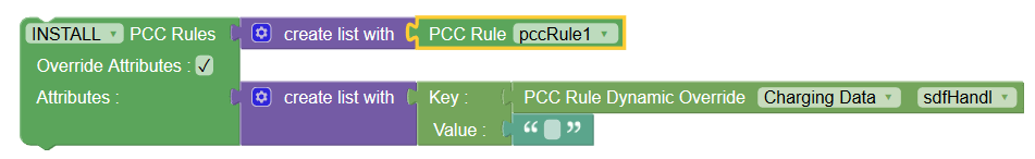

Use Case: Override sdfHandl attribute
The following sample policy shows how operators can use PCC Rule Dynamic Override block to override the value of sdfHandl attribute of Charging data. This attribute indicates whether the service data flow is allowed to start while the SMF is waiting for a response to the credit request from CHF.using PCC rule dynamic override block to support sdfHandl attribute

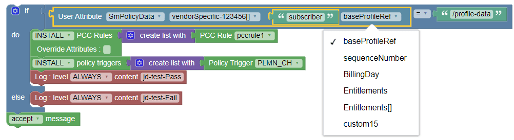

Use Case: Using Custom Attributes block for OperatorSpecificData
The following policy example shows how you can use Custom Attributes block to get value from OperatorSpecificData object.Using custom attribute block to get OperatorSpecificData value
When you select one attribute, the child attributes automatically appear in block. The attribute list is imported from the custom JSON schema.

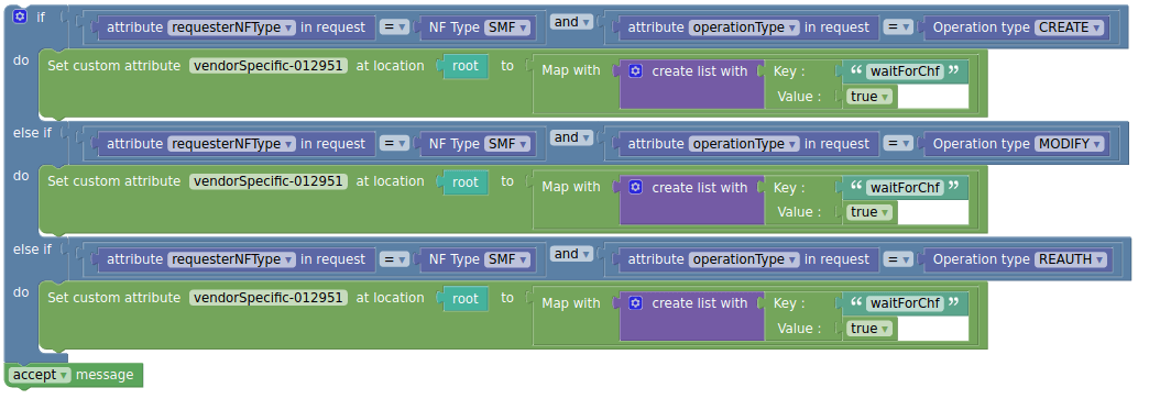

Use Case: WaitForChf VendorSpecific attribute provisioning over N7
Using the Set custom attribute block, operators may configure and send VendorSpecific waitForChf attribute to SMF in SMPolicyDecision via policy. Depending on the waitForChf attribute value, it is decided whether the SMF waits for the CHF session establishment response before installing rules in the UPF or sending the response towards the RAN.
If this attribute is included and set to true (default), SMF waits before proceeding with the UPF and RAN signaling.
The waitForChf attribute is not present when the online charging method is not applicable to the PDU session or to any of the PCC rules.
The following sample policy shows how operators can use Set custom attribute block to send VendorSpecific waitForChf attribute to SMF in SMPolicyDecision:sample policy for WaitForChf VendorSpecific attribute provisioning over N7

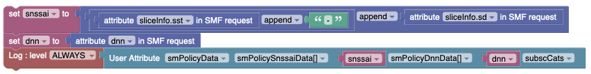

Use Case: Using User Attributes block for SmPolicyData
The following screen capture shows a sample policy where User Attributes block is used to access vendorSpecific-123456 attribute and trigger a policy:use case for user attribute block

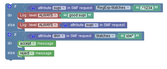

Use Case: Wildcard character matching
The following policy example shows how operators can use comparison block for wildcard pattern matching:sample policy for wildcard pattern matching

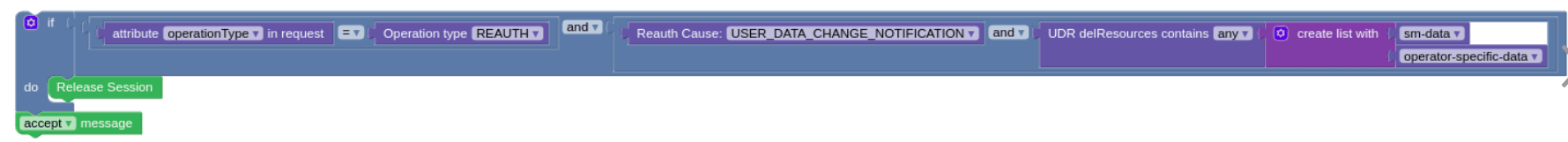

Use Case: UDR Subscriber Delete Resources
The following screen capture shows a sample policy to release a policy association and terminate active subscriber session by SM service when the subscriber resources are deleted on the UDR.sample policy for UDR subscriber delete resources

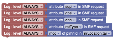

Use Case: PRE capturing log information using Log Blocks
PRE service records log information when an event occurs using blockly. In blockly, any condition blocks such as the accessor blocks are used along with log blocks to log application information. It logs subscriber identifier values of SUPI, GPSI, DNN, MCC-MNC. The Policy tables data are also logged.
The following screen capture shows a sample of enabling logging in PCF-SM.
Figure 4-10 Example 1: Blockly logging supi, gpsi, dnn and ratType values

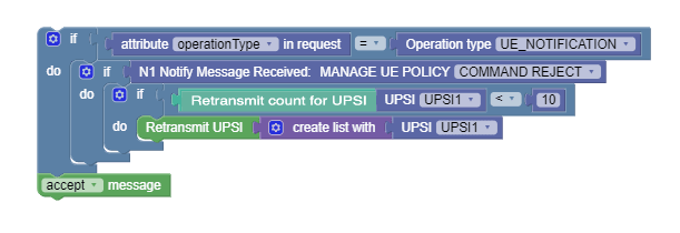

Figure 4-13 Use case scenario 1:
This policy will retransmit UPSI1 until the retransmit action has happened 10 times.
Note: The get retransmit count for UPSI statement is important since it will allow the policy to retransmit in a finite amount of times, otherwise it can go in an infinite loop.

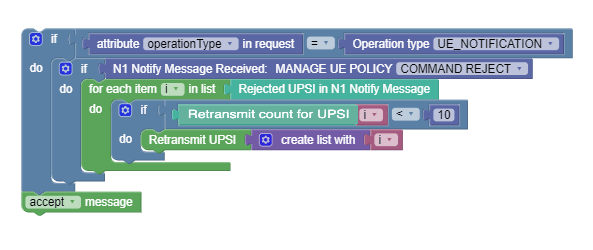

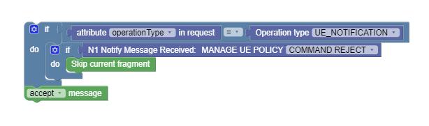

Figure 4-14 Use case scenario 2:
This policy skips the current transmit after encountering a Command Reject message from the AMF.

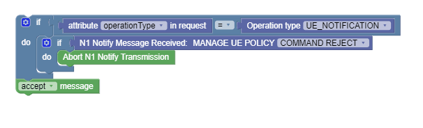

Figure 4-15 Use case scenario 3:
This policy aborts the current transmit after encountering a Command Reject message from the AMF.
Figure 4-16 Use case scenario 4:
This policy retransmits every rejected UPSI up to a maximum of 10 times.

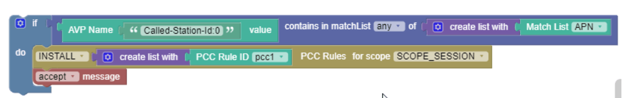

4.4 Cloud Native Policy Charging and Rules Function Use Cases
Following are the Cloud Native Policy Charging and Rules Function (PCRF) use cases:

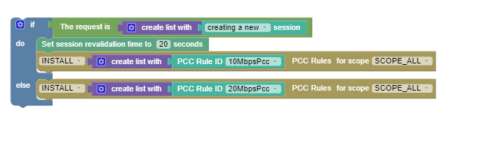

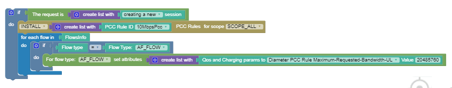

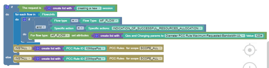

Use Case 1
When Cloud Native PCRF receives CCR-Initial requests, install 10MbpsPcc Rule. When Rx flow is observed, then modify the upload limit to 20 MBPS.

When Cloud Native PCRF receives CCR-Initial requests, install 10MbpsPcc Rule. When Cloud Native PCRF receives CCR-Update requests, install 20MbpsPcc Rule.
After Cloud Native PCRF receives CCR-Initial requests, when Rx flow is observed and specific action is INDICATION_OF_SUCCESSFUL_RESOURCES_ALLOCATION taken, then modify the maximum upload limit to 1234 MBPS.
The following screen capture shows the created policy after applying the above policy rules:Use Case 2

Use Case 4
When highSpeedCounter is received with current status as true from OCS, install 20MbpsPcc Rule. When highSpeedCounter is received with current status as false from OCS, install 50MbpsPcc Rule. For rest of the scenarios, such as when highSpeedCounter is not received from OCS or does not have current status as true or false, perform the "reject message" action.
use case 4

When Cloud Native PCRF receives requests with APN, install pcc1 Rule.
The following screen capture shows the created policy after applying the above policy rules:Use Case 5
Use Case 6
Single PRA: Installing PRA on initial request and removing on update request.
The following screen capture shows the created policy after applying the above policy rules:Single PRA use case
Multiple PRA: Installing PRA on initial request and removing on update request.
The following screen capture shows the created policy after applying the above policy rules:Multiple PRA use case

Policy Projects in CNC Console includes a Contains in matchList block, which indicates to select items specified in Match List block.
Match List specifies the list to be used for matching criteria.
Figure 4-56 Here is an example of match list functionality:
In the Match List Block Match List name is provided the right side and the value is provided on the left side. On the right side, multiple Match List can be given. But, it must contain only one value on the left side.
Possible values for Contains in matchList block are:
  • any - If the attribute value from left side matches with any of the values of Match List in the right side, the output of Contains in matchList will be true. Otherwise, false.
  • all - If the attribute value from left side is present in all the given values of Match List on the right side, the output of Contains in matchList will be true. Otherwise, false.
  • none - If the attribute value from left side not present in any of the given values of Match List on the right side, the output of Contains in matchList will be true. Otherwise, false.
