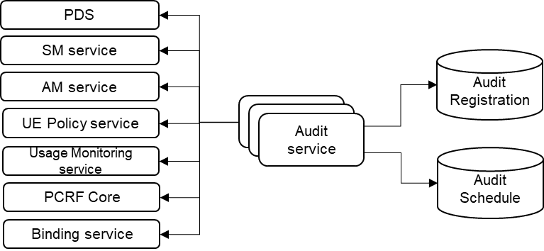

Figure 3-1 Audit Service Registration
The Audit Service Single Pod design
Audit service is mainly responsible for:
  • allows core services to dynamically register or de-register the tables for auditing process
  • core services can change other attributes at run time by using the Audit service restful interface
  • notifying the context owners about the expired records in the registered table for auditing
  • provide flow control of notifications towards the context owners
  • perform forceful deletion of stale records, in case no corrective action is taken by context owners
  • publish total count of records in the registered table for auditing
Audit service is not only responsible for stale session cleanup but has increased scope in other signaling features as well e.g., notifying core service for binding retry attempts.
Audit service with single pod deployment makes it neither scalable nor highly available. Audit service supports multiple pods, by using Audit Schedule. Audit Schedule helps to effectively manage and plan the audit service on the registered services.
Figure 3-2 Multiple Pod Audit Service

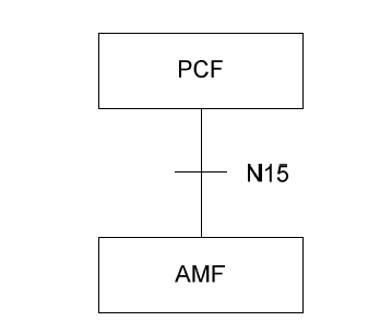

The following figure describes the communication between PCF and AMF over the N15 interface:
Figure 3-3 Communication between PCF and AMF over N15
PCF AMF interface

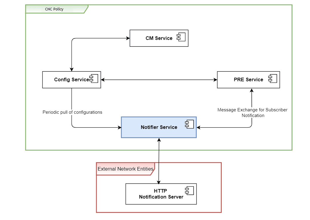

The following diagram shows how Notifier Service fetches configurations from Config service and on receiving notification request from PRE, sends out the notification to the subscriber via external notification server:
Figure 3-4 High Level Notifier Service Diagram

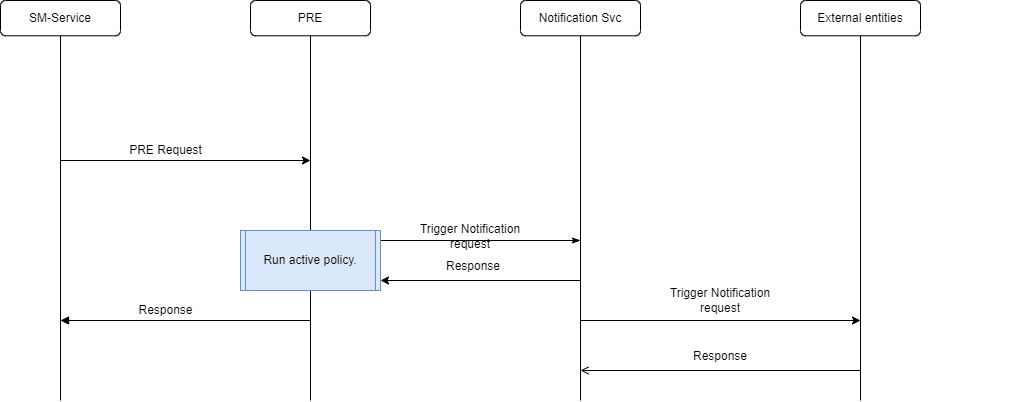

Call Flow
The following call flow diagram describes the notification call flow for SM service. As seen in the diagram, SM service sends a request to PRE that runs any given active policy and as a result triggers notification request to Notifier Service. Then, Notifier service sends a notification request towards the configured external server. On receiving success response, Notifier service sends the response to PRE, which in turn sends it to SM service.
Figure 3-5 Notifier Call Flow for SM Service

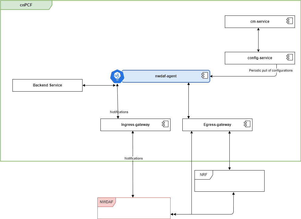

It also queries Network Repository Function (NRF) client for fetching NWDAF information. For NWDAF, autonomous NRF discovery and static configuration is only supported, on-demand is not yet supported. For more information on autonomously discovered NF profiles for NWDAF, see Discovered NF Instances.
A 5G network contains a vast number of devices and sensors generating an enormous amount of data. The NWDAF Agent allows the Communications Service Providers (CSPs) to efficiently monitor, manage, automate, and optimize their network operations by the data collected and analytics generated across the network. It also helps the CSPs in achieving the operational efficiency and provides an enhanced service experience. Currently, NWDAF Agent supports slice load level analytics as part of the analytics data that is provided from NWDAF.
The following diagram describes the interaction with NWDAF Agent and Policy:
Figure 3-6 Interaction between Policy and NWDAF Agent
Interaction between CNC Policy and NWDAF Agent

To enable the service, set the following parameter to true at the time of installing or upgrading Policy:
nwdafAgentServiceEnable
For information on how to set the parameter value, see Oracle Communications Cloud Native Core Policy Installation, Upgrade and Fault Recovery Guide.
Configure
Once the service is enabled, you should be able to see NWDAF Agent service menu under the Service Configurations on CNC Console for Policy.
For information on how to configure NWDAF Agent, see Configuring NWDAF Agent.
After the configuration you can use blockly to see the analytics data. For more information, see "Public Category" section in Oracle Communications Cloud Native Core, Converged Policy Design Guide.

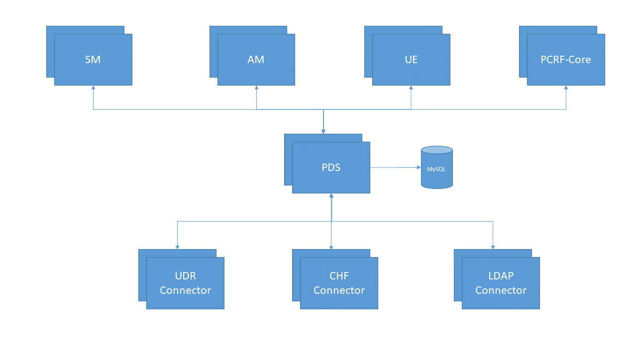

3.8 Policy Data Source (PDS) Service
Policy Data Source Service (PDS) is an intermediate layer which interfaces Core Services (SM/AM/UE/PCRF-Core) with the protocol specific connector layers (UDR/CHF/LDAP Connectors). PDS also holds the subscriber information in its database when a new session gets established for a given subscriber and cleans-up the information when the last session termination happens. PDS is also responsible for storing the Subscriber State Variables except session level in its database and provides these variable information across multiple core services which requests the information.
You could define the workflows for PDS and the workflow would define the flow of request processing. This workflow is internal to the PDS project and should consult with engineering team for any update.
The following figure depicts the PDS architecture:
PDS overview
For configuring PDS service, see PDS Settings.
Currently, PDS supports SUPI/GPSI as the search key. It does not support NAI as the search key.
UDR Connector- UDR Connector is a protocol specific layer which converts the request send by PDS to nUDR specific format and forwards to real UDR for subscription information. It also provides an ability to subscribe for profile change at UDR.
CHF Connector – CHF Connector is a protocol specific layer which converts the request send by PDS to nCHF specific format and forwards to actual CHF for fetching PolicyCounter Information. As per the standards, it automatically subscribes for profile change at CHF.
For configuring the UDR or CHF connector, see PCF User Connector.

3.10 UE Policy Service
Policy implements PCF UE Policy service to provision the UE policies, determined by PCF, to UE through AMF over the N15 interface.
Figure 3-8 PCF-AMF communication
PCF communicating to UE through AMF over N15 interface
PCF UE Policy service performs the following functions:
  • Transferring UE Route Selection Policies (URSP) rules to UE
  • Establishing the UE Policy Association requested by the NF service consumer
  • Deleting the UE Policy Association requested by the NF service consumer
  • Defining and delivering URSP message to UE via AMF using N1N2 message
Policy supports the following 3GPP defined service operations for the PCF UE Policy service:

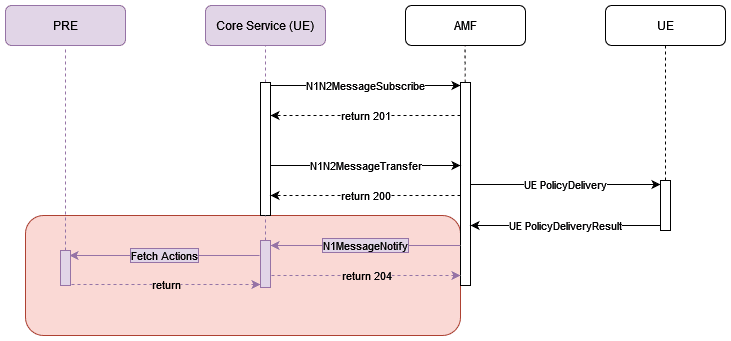

Figure 3-11 UE and PRE interaction
The policy writer can check if the message is "MANAGE UE POLICY COMPLETE" and then take actions like:
  • Write successfully the installed UPSI as a string value in VSA and update it to UDR.
  • Define remote state variables, set values to variables and write in VSA and update it to UDR.
The policy writer can check if the message is "MANAGE UE POLICY COMMAND REJECT" and then take actions like:
    • Retransmit the failed UPSIs or new UPSIs, based on conditions like PLMN, SUPI, the failed UPSIs.
    • Skip the retransmit of UPSIs, based on conditions like PLMN, SUPI, the failed UPSIs.
    • Abort the transaction of transferring the UEPolicy in N1N2Message based on conditions like PLMN, SUPI, the failed UPSIs.
    • Define remote variables other than UPSI, set values to variables and write in VSA and update it to UDR.

UE service allows deletion of URSP rule(s) in subsequent call flows that were previously sent over N1N2 NAS message delivery. The UPSI containers are updated and resent with the same UE Policy Section Code (UPSC) code and PLMN ID. An UPSI if being retransmitted because of URSP deletion will not further fragment the remaining URSPs within that UPSI as there is change in the size of the UPSI. The UPSI container honors the precedence of URSP rules while delivering in multiple fragments.
The operator can perform Install and Remove URSP rules in the same policy execution cycle.
