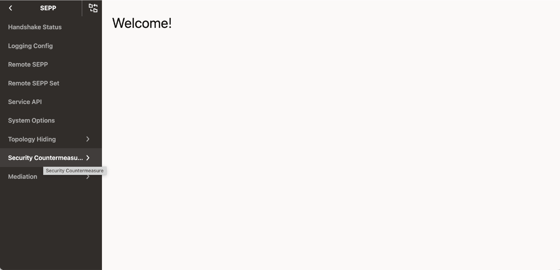

4.2.2 Logging Config
Logging Config allows the user to configure the application based log level and package based log level.
The Logging Config can be configured into SEPP mode and Roaming Hub mode. To enable the SEPP mode, set the operationMode flag to true. To enable the IPX mode, set the operationMode flag to false. In Roaming Hub mode, the user cannot enable or disable the log level for nfmanagement and nfdiscovery services.
Perform the following procedure to configure the log levels:
  1. From the left navigation menu, navigate to SEPP and then click Logging Config.
  2. On selecting Logging Config, the list of all application logs, package logs, and their levels configured in the system appear on the right pane.
  3. Click Edit icon to modify the log level. The page is enabled for modification.
  4. Click View to view the details of the log level List.

4.2.9 Security Countermeasure
The Security Countermeasure option is used to enable and configure the Cat-0 SBI Message Schema Validation feature, Cat 1 -Service API Validation feature, Cat 2 – Network ID Validation feature, and Cat 3 – Previous Location Check feature.
The Service API Allowed List REST API is used to do the configurations on the allowed list of REST APIs.

  1. From the left navigation menu, navigate to SEPP, and then select Security Countermeasure.
  2. Then select Cat 2 – Network ID Validation.
  3. The Header option appears underneath.
  4. Click Header, the Header screen appears at the right pane. The Header details are available on the screen.

  1. From the left navigation menu, navigate to SEPP and then click Security Countermeasure.
  2. Click Cat 3 - Previous Location Check feature under Security Countermeasure, the Trigger List appears underneath.
  3. Click Header, the Serving Network ID and UE ID appears underneath.
  4. Click Serving Network ID, the Serving Network ID Header details are available in the screen.
  5. Click Add to add a new header. The Add Serving Network ID Header page appears and user can add the Header information.

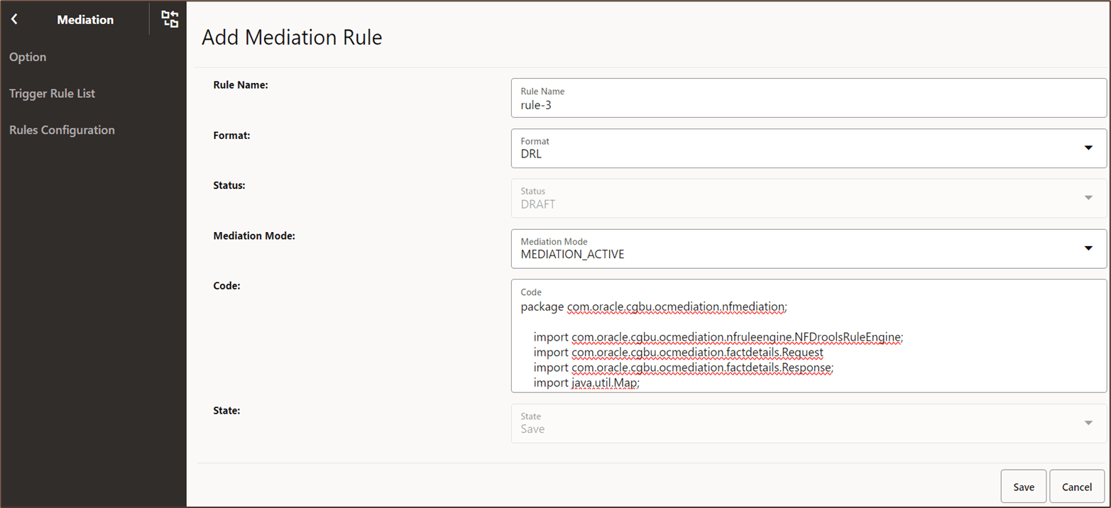

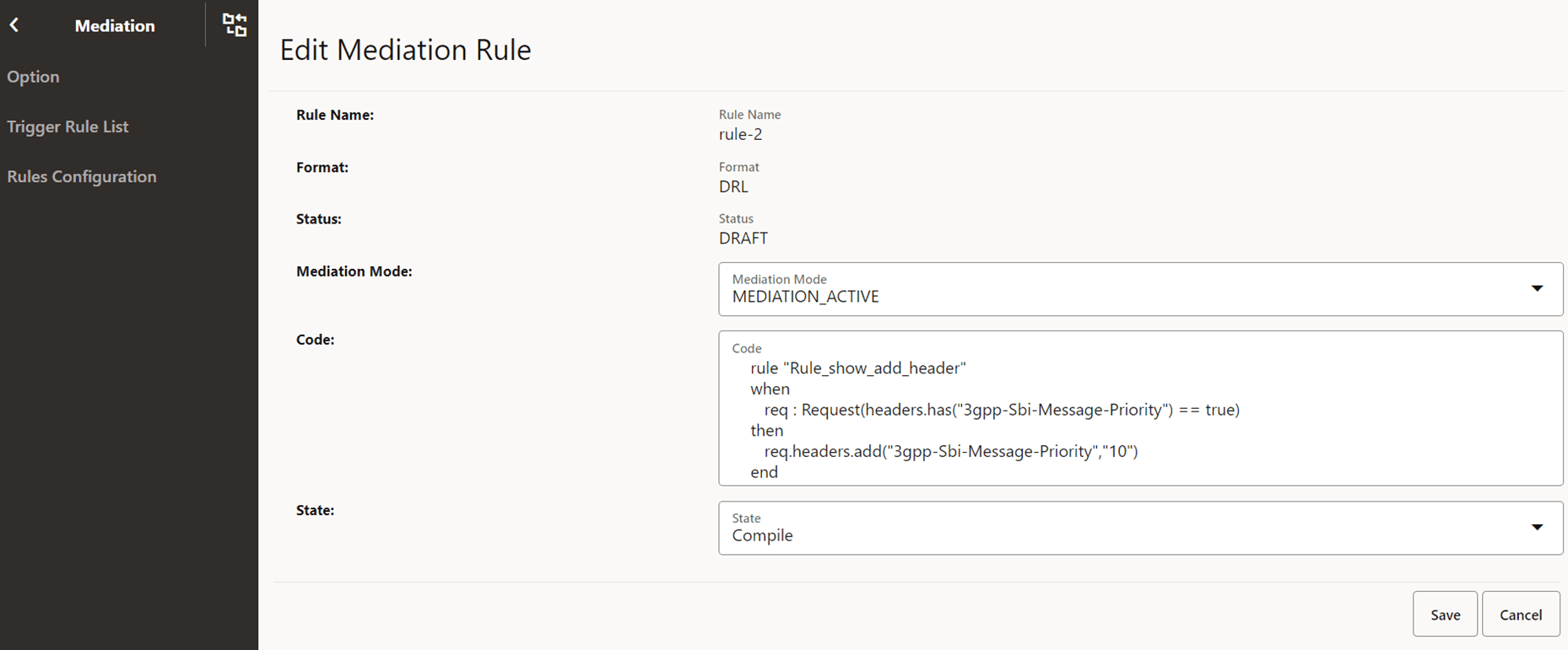

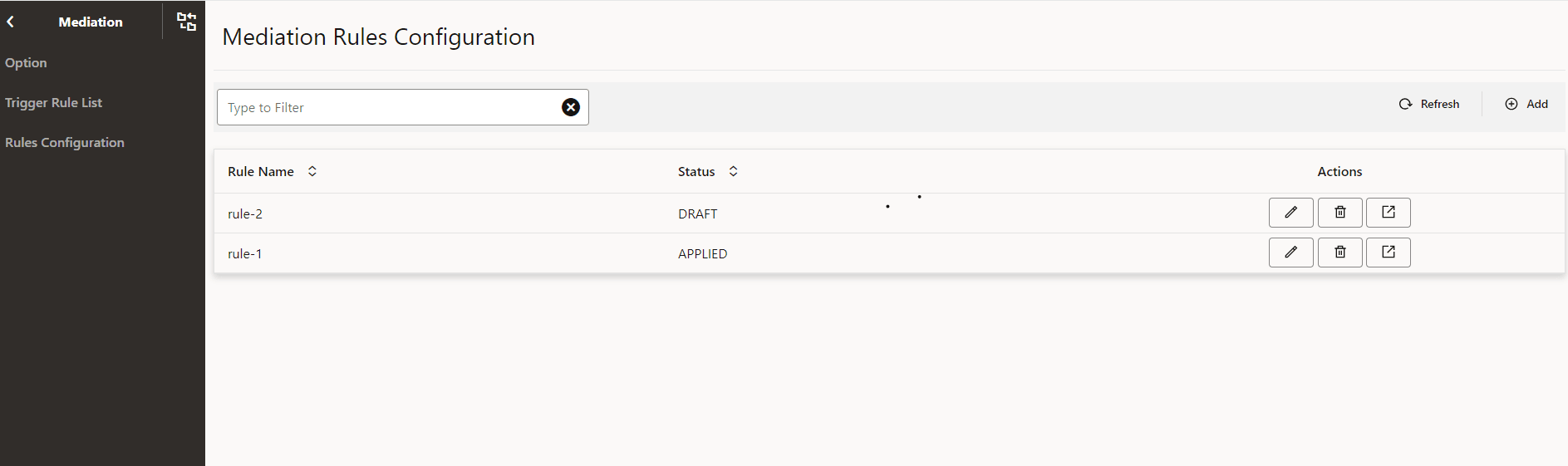

4.2.10 Mediation
The mediation option allows the user to set Mediation feature as ENABLED or DISABLED and configure the mediation options.
Perform the following procedure to enable or disable the mediation feature:
  1. From the left navigation menu, navigate to SEPP and then click Mediation. The options appears underneath.
  2. Click Options, the options screen appears at the right pane. The Mediation Feature and Error Configuration details are available in the screen.
  3. Click Edit icon to modify the Options. The Edit Options page appears.
  4. Set the Mediation Feature to True or False and configure the Error Configuration parameters Action, Status Code, and Title.
    The parameters are:
    Mediation Options
    Table 4-53 Mediation Options
    Parameter Name Mandatory(M)/Optional(O)/Conditional(C) Datatype Description
    Enable Mediation O Boolean A Boolean value to enable and disable the Mediation feature.
    true indicates Enabled
    false indicates Disabled. The feature is disabled (set to false) by default.
    Error Configuration M Object Error Configuration details
Mediation Trigger Rule List Configuration
Mediation Trigger Rule Configuration screen allows the user to configure a set of trigger rules which act as a filtering criteria for SEPP to send a particular request for mediation.
Perform the following procedure to configure the trigger rules:
  1. From the left navigation menu, navigate to SEPP and then select Mediation. The Trigger Rule List appears underneath.

  1. From the left navigation menu, navigate to SEPP and then select Mediation. The Rules Configuration screen appears underneath.
  2. Click Rules Configuration, the list of all the existing rules with corresponding status appears.
    Figure 4-4 Mediation Rules Configuration Screen
  3. Click Add to add a new rule. The Add Mediation Rule page appears and user can add the mediation rule information.
    Figure 4-5 Add Mediation Rule Screen
    Rule Name, Format, Status, Mediation Mode, Code, and State are the mediation rule parameters.
  4. Click Edit button of an existing rule to modify that rule. The Edit Mediation Rule page appears and user can edit the rule information.
    Figure 4-6 Edit Mediation Rule Screen

Rules Configuration Parameters
Table 4-57 Rules Configuration Parameters
Rule Name M String Mediation rule name
Status M Enum Mediation rule status: APPLIED or DRAFT
State M Enum
Compile, Clone, Save, Draft, Apply
The user can select one of these states.
Mediation Mode M Enum
MEIDATION_ACTIVE: its only applicable to mediation microservice active mode
MEDIATION_TEST: its only applicable to mediation microservice test mode
The user is required to configure the mediation rules using MEDIATION_ACTIVE mediation mode. MEDIATION_TEST mode is only for internal purpose.
Code M String
Mediation rule code content.
The user has to prepend the following data block along with the needed rules in the code section and save to create the rule in DRAFT status. If the user wants to apply the rule on mediation microservice then user can edit the rule and save it again with Apply state.
package com.oracle.cgbu.ocmediation.nfmediation;
    import com.oracle.cgbu.ocmediation.nfruleengine.NFDroolsRuleEngine;
    import com.oracle.cgbu.ocmediation.factdetails.Request;
    import com.oracle.cgbu.ocmediation.factdetails.Response;
    import java.util.Map;
    import java.util.HashMap;
    dialect "mvel"
Format M Enum Rule format. Only DRL is supported currently.
New Rule Name C String New rule name is to be given only when state is clone.
  • The rule name for a rule in the DRAFT status must be unique. Otherwise, the new rule overwrites the old one.
  • The new rule is always created and saved with DRAFT status in the database. User needs to save the rule with APPLY state to apply the rule to mediation microservice.
