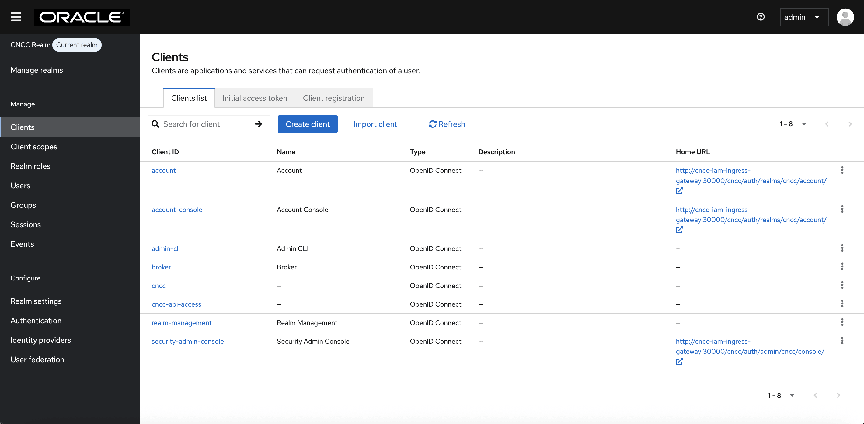

  3. On the right pane, click Clients. The following screen appears:
    Figure 6-1 Clients
    Clients

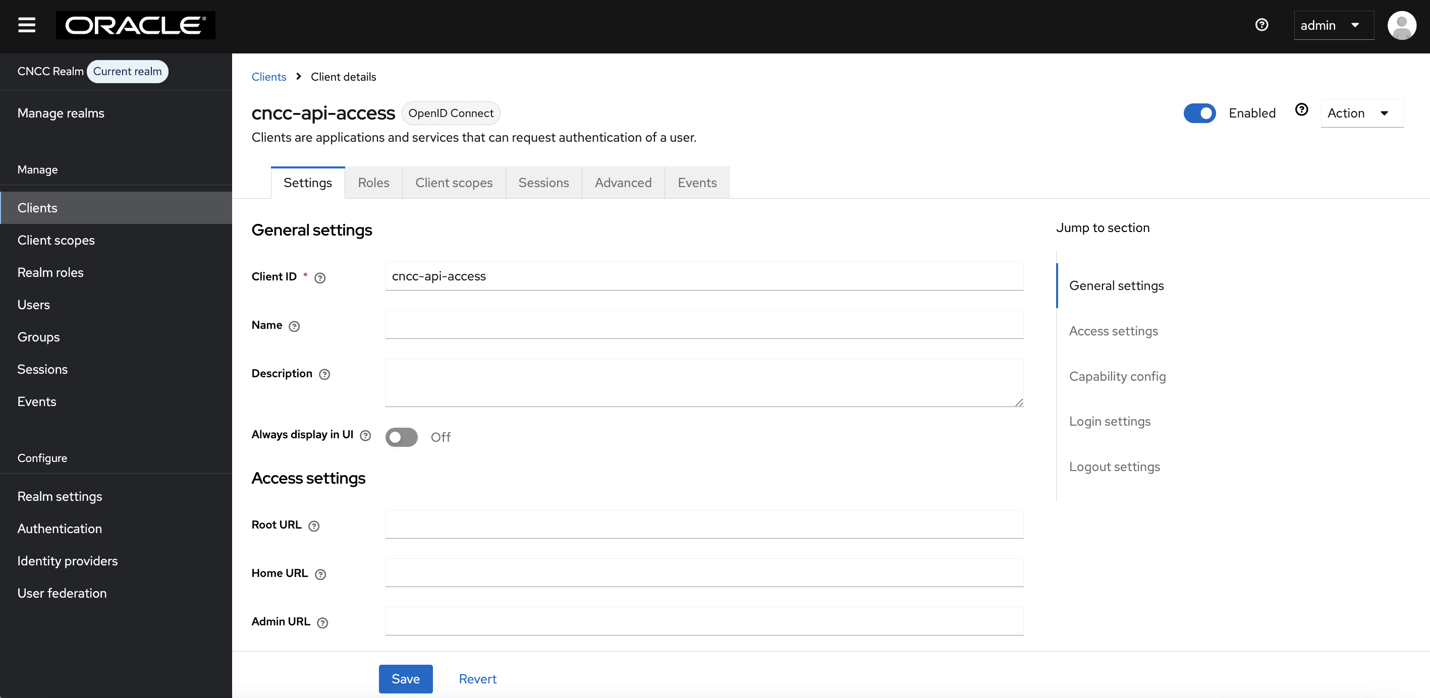

  4. Click cncc-api-access. The following screen appears:
    Figure 6-2 cncc-api-access
    cncc-api-access
