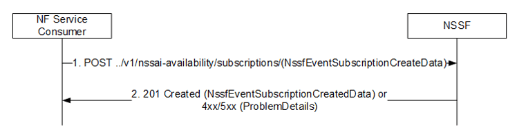

  2. Subscribe Service Operation
    The Subscribe operation is used by NF Service Consumer (AMF) to get the notifications for any change in NSSAI availability information.
    Figure 2-4 Subscription creation
    • AMF sends a POST request to NSSF with a notification URL and a list of TAIs as JSON body.
    • NSSF stores the subscription request and responds with the list of authorized S-NSSAI(s) per TAI in the request.
    • NSSF also returns a subscription-id and expiry (duration up to which NSSF sends notifications for any change in the status of S-NSSAI for subscribed TAI(s)).
    • The expiry duration is optional:
      • If not provided, NSSF sets it to maxExpiryDuration (Helm configuration)
      • If greater than maxExpiryDuration, NSSF resets it to maxExpiryDuration
      • If less than minExpiryDuration (Helm parameter), the request is rejected
      • If a remove operation is received on the Expires header, NSSF refreshes the subscription to ensure continuity and avoid rejection caused by unexpected or unwarranted NF consumer behavior
