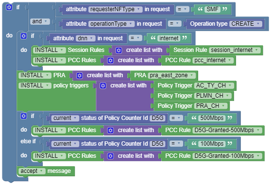

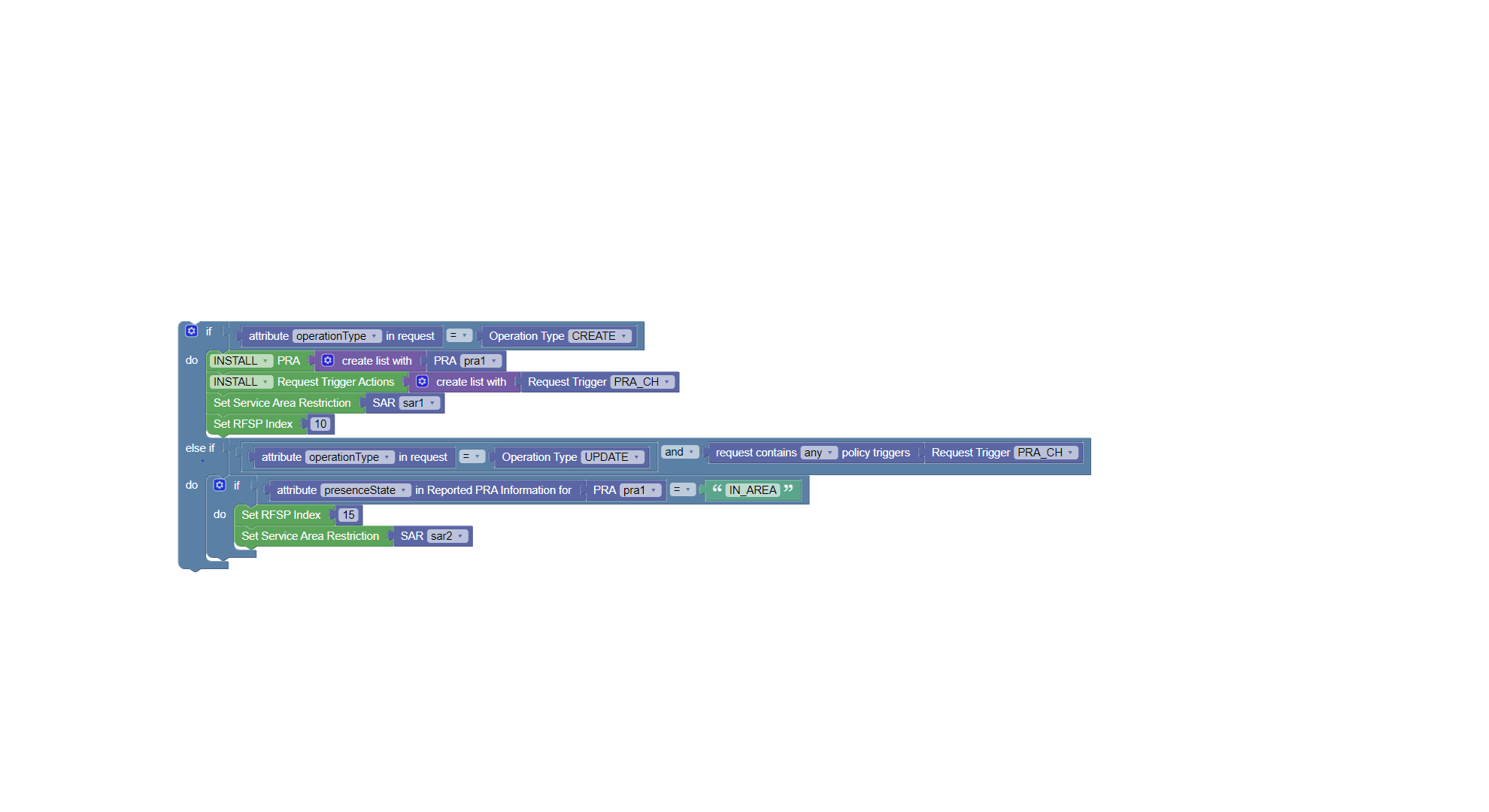

Use Case 1
When PCF receives a create association message, install the following:
  • a Session Rule and a PCC Rule for DNN “internet”
  • a PRA Rule and a list of Triggers
  • additional PCC Rules based on the initial status of Policy Counters received from CHF
The following screen capture shows the created policy after applying the above policy rules:use case 1

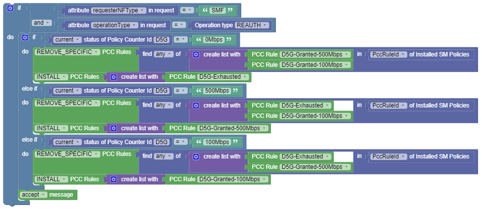

When PCF receives Policy Counter Status from the Nchf interface, remove the previous rule and install a new PCC rule based on the current status of the Policy Counter.
The following screen capture shows the created policy after applying the above policy rules:use case 3

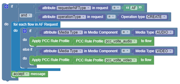

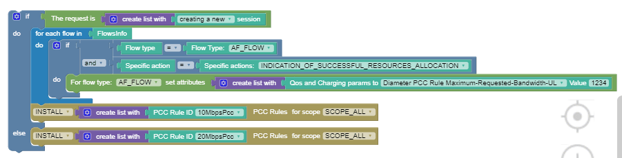

Use Case 4
When PCF receives a npcf-policyauthorization create association request, which might be a translated Rx AAR request, then override PCC rules for the received flows based on the media type. If there are no policies, PCF generates a default flow and sends it to smf. To change this default flow, a policy is required.

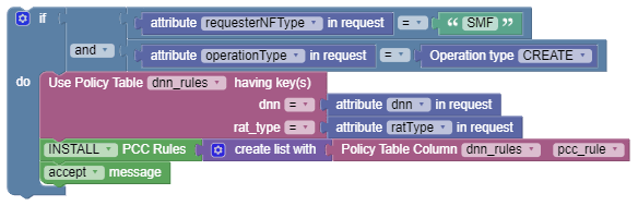

Check the DNN and RAT type in the smf create message, and then install a corresponding PCC Rule. The data is received from the Policy Table.

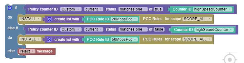

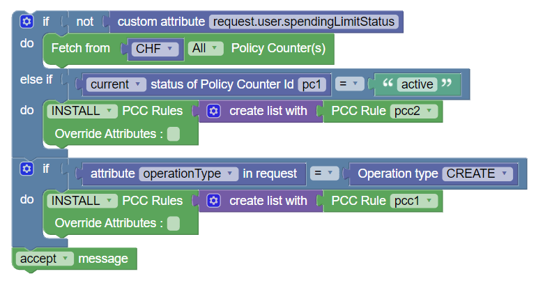

Use Case: Fetch Policy Counters from CHF
The following screen capture shows a sample policy condition to check if spendingLimitStatus is present or not in PRE request. If it is not present then it gives action to fetchFromCHF to SM service. Currently, PDS uses workflow for processing.
sample policy to fetch policy counters from CHF

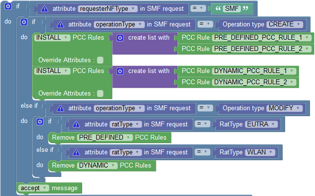

Use Case: Remove PCC Rules in Bulk
The following policy example shows how you can use Remove PCC Rules block to remove pre-defined and dynamic PCC rules in bulk.
Use Case for Remove PCC Rules Block
In the above example, the policy removes pre-defined PCC rules when SM policy association update request changes ratType to EUTRA. Similarly, when SM policy association update request changes ratType to WLAN, policy removes dynamic PCC rules.

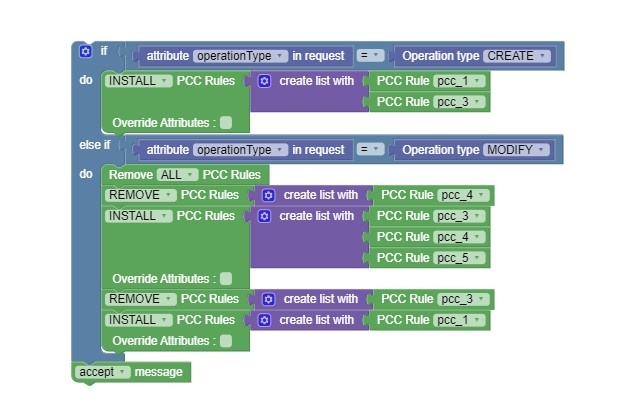

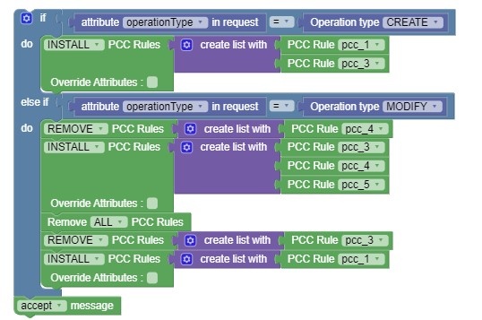

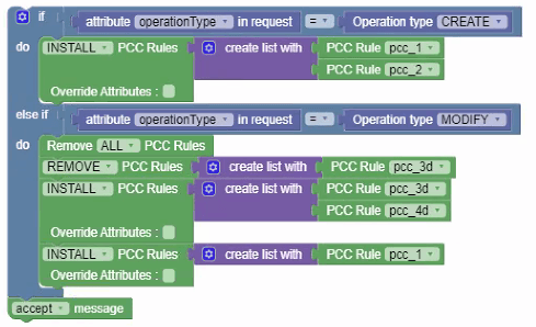

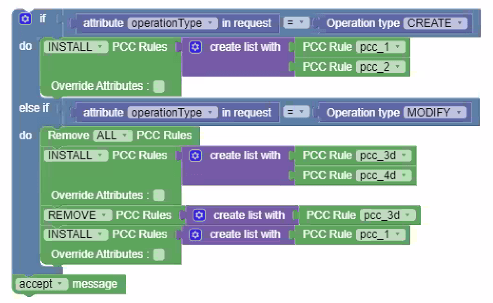

When PCF triggers INSTALL and REMOVE actions on the same PCC/Session Rules when the remove action is Remove ALL (ALL, Predefined, Dynamic, Conditioned, non-conditioned), the conflict is resolved based on the value of Install/Remove Rule Conflicts Strategy parameter under the Rule group on the PCF Session Management page in CNC Console.
The Install/Remove Rule Conflicts Strategy parameter can take the following values:
  • INSTALL/MODIFY: Indicates to Remove all Session/PCC Rules previously installed and ignore all the remove actions for rules in conflict.
  • REMOVE: Indicates to Remove all Session/PCC Rules previously installed and ignore all the install actions for rules in conflict.
  • IGNORE: Indicates to Remove all Session/Pcc Rules previously installed and ignore all actions for rules in conflict, and does not run anything(install/remove).
  • Default: Process the remove actions and then the INSTALL or MODIFY actions.
If Install/Remove Rule Conflicts Strategy parameter is not configured, the project first runs the INSTALL and MODIFY actions and then runs REMOVE action for the PCC rule/ Session.
Following are some of the examples of conflict resolution:
Figure 4-1 Example 1
Example 1
  • Removes the previously installed pcc_1 and pcc_2.
  • Installs pcc_3d and pcc_4d.
Figure 4-2 Example 2
Example 2
  • Installs pcc_4d.
  • Ignores installation of pcc_1 and pcc_3d which are in conflict.
Figure 4-3 Example 3
Example 3
  • Removes the previously installed pcc_1 and pcc_3.
  • Installs pcc_4.
  • Ignores install or remove actions on pcc_1 and pcc_3 which are in conflict.
Figure 4-4 Example 4
Example 4
  • Installs pcc_3d, pcc_4d_ and pcc_1
Figure 4-5 Example 5
Example 5
  • Installs PCC Rules pcc_4 and pcc_5.
  • Ignores installation of pcc_1 and pcc_3 which are in conflict.
Figure 4-6 Example 6
Example 6
  • Removes previously installed pcc_1 and pcc_3.
  • Installs PCC Rule pcc_5.
  • Ignores installation of pcc_3 and pcc_4.
Figure 4-7 Example 7
Example 7
  • Installs pcc_5.
  • Ignores INSTALL/ REMOVE actions on pcc_1 and pcc_3.
Figure 4-8 Example 8
Example 8
  • Installs pcc_4 and pcc_5.
Figure 4-9 Example 9
Example 9

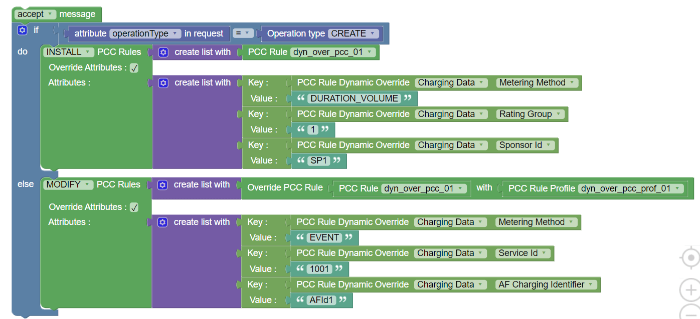

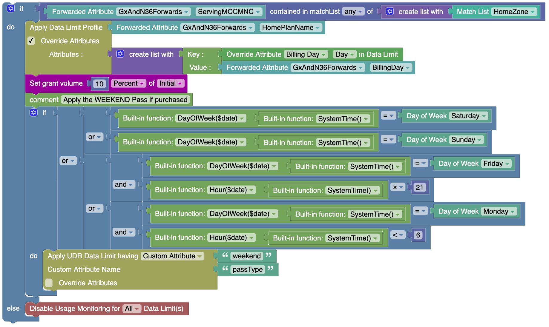

Use Case: Dyamic Update/Override of PCC Rule Attributes
The following policy example shows how you can override PCC rule attributes in real-time. It shows a create request to install PCC rule dynamically overriding Charging Data attributes.Use case for dynamic override of PCC rule attributes

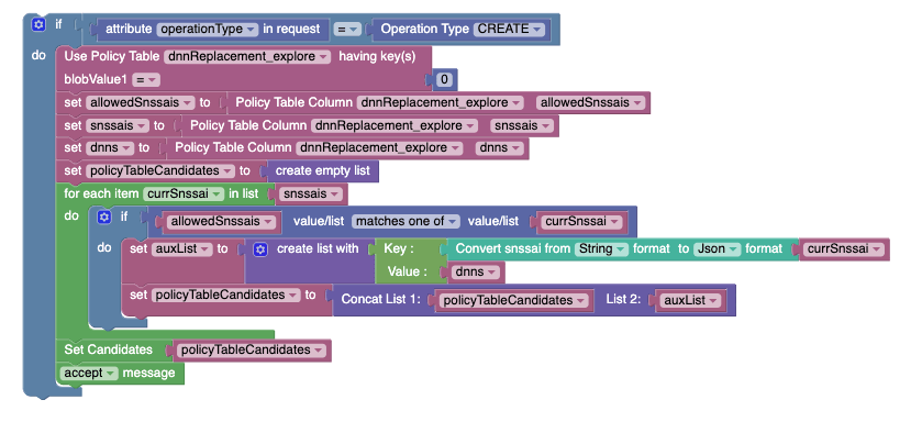

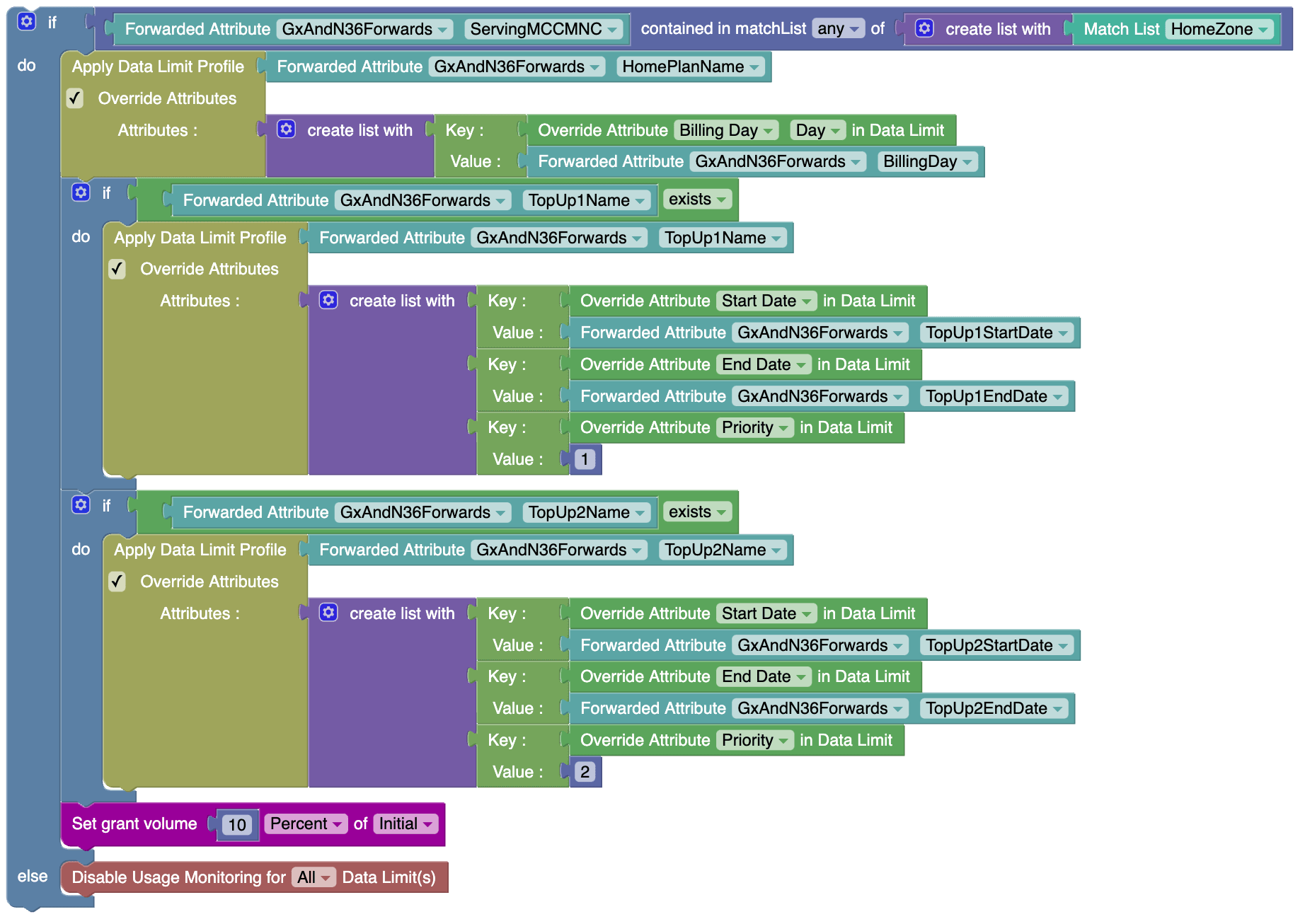

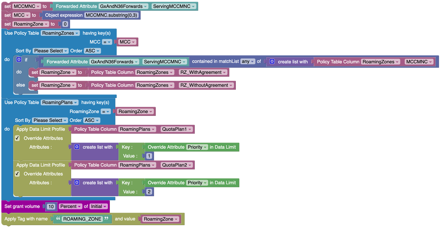

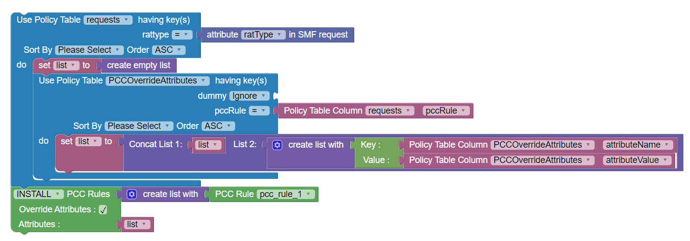

Use Case: Dynamic Override of PCC Rule Attributes with Policy Tables
The following policy example shows how you can use nested policy tables to override PCC rule attributes in real-time.Use case for dynamic override of PCC rule attributes with policy tables
In the above policy:
  • Outer Use Policy Table block filters table data by rattype that is received in request.
  • Inner Use Policy Table block loops through override attributes and their values for particular PCC Rule. After this step, list of override attributes becomes available.
    Concat List block is used to append {key:value} pair of attributes to list variable.
  • The list, received in the previous step, is directly added to override attributes in Install PCC Rule block.

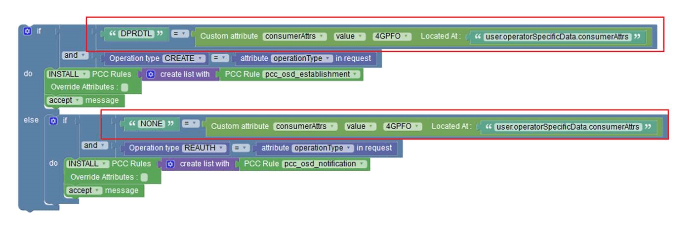

Use Case: Using Custom Attributes block for OperatorSpecificData
The following policy example shows how you can use Custom Attributes block to get value from OperatorSpecificData object.Using custom attribute block to get OperatorSpecificData value
When you select one attribute, the child attributes automatically appear in block. The attribute list is imported from the custom JSON schema.

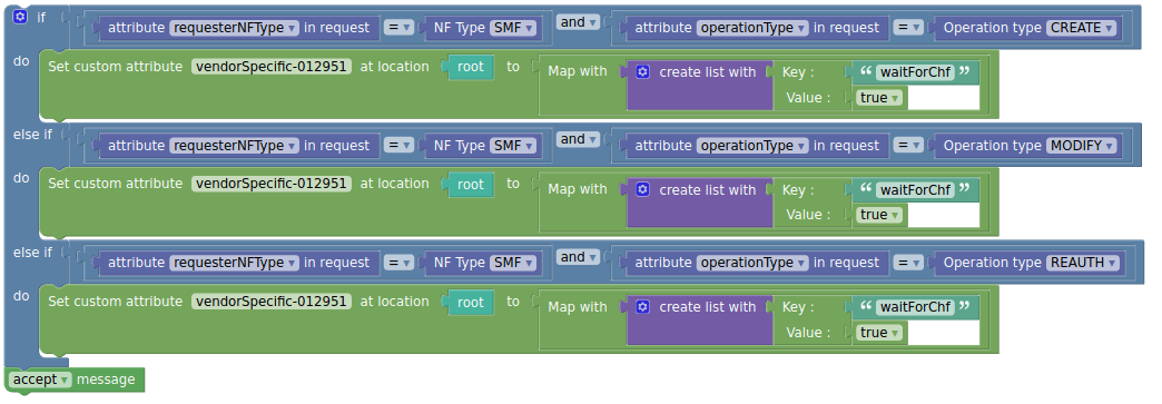

Use Case: WaitForChf VendorSpecific attribute provisioning over N7
Using the Set custom attribute block, operators may configure and send VendorSpecific waitForChf attribute to SMF in SMPolicyDecision via policy. Depending on the waitForChf attribute value, it is decided whether the SMF waits for the CHF session establishment response before installing rules in the UPF or sending the response towards the RAN.
If this attribute is included and set to true (default), SMF waits before proceeding with the UPF and RAN signaling.
The waitForChf attribute is not present when the online charging method is not applicable to the PDU session or to any of the PCC rules.
The following sample policy shows how operators can use Set custom attribute block to send VendorSpecific waitForChf attribute to SMF in SMPolicyDecision:sample policy for WaitForChf VendorSpecific attribute provisioning over N7

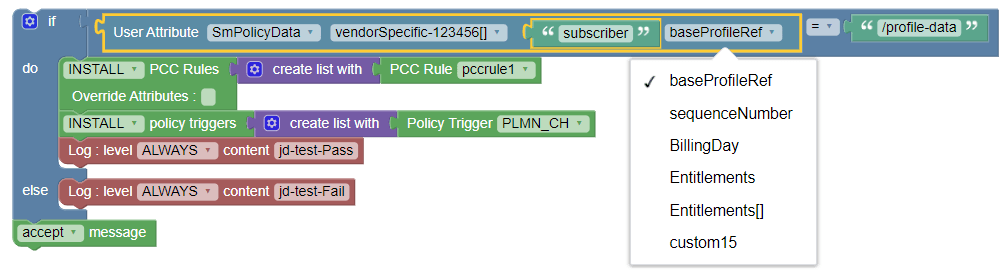

Use Case: Using User Attributes block for SmPolicyData
The following screen capture shows a sample policy where User Attributes block is used to access vendorSpecific-123456 attribute and trigger a policy:use case for user attribute block

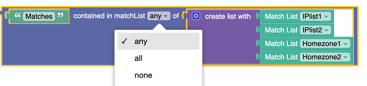

Use Case: Wildcard character matching
The following policy example shows how operators can use comparison block for wildcard pattern matching:sample policy for wildcard pattern matching

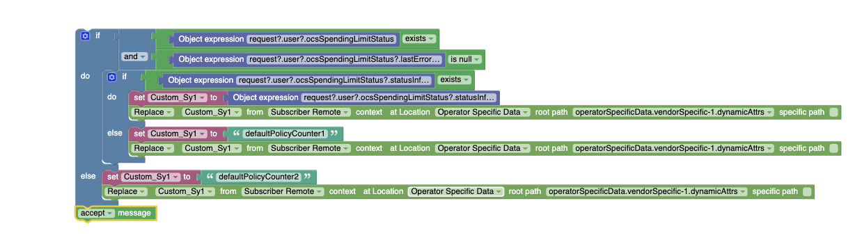

Use Case: Use Remote Subscriber State Variables to write OSD PATCH to UDR from OCS data
The following sample sends an OSD PATCH request by using OCS data with conditions for success and failure handling. You can use this sample for different operation types based on operator requirements. Use the following object expressions:
  • First: "request?.user?.ocsSpendingLimitStatus"

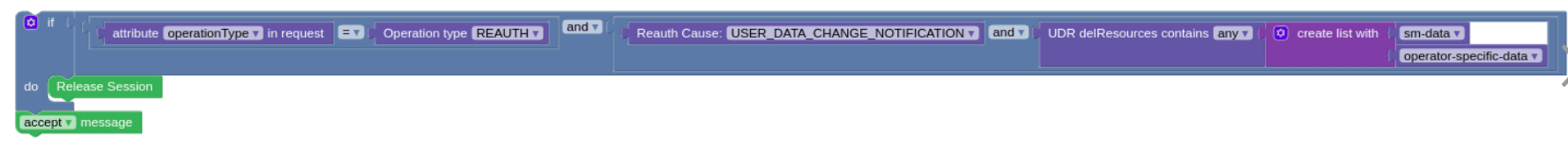

  • Second: "request?.user?.ocsSpendingLimitStatus?.lastErrorcode"
  • Thrid and fourth: "request?.user?.ocsSpendingLimitStatus?.statusInfos?.pc1?.policyCounterId"
Figure 4-13 Blockly to Use Remote Subscriber State Variables to write OSD PATCH to UDR from OCS data

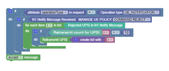

Figure 4-17 Use case scenario 4:
This policy retransmits every rejected UPSI up to a maximum of 10 times.

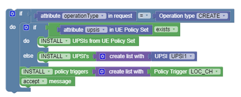

Use Case 1
The given screen capture shows a sample UE policy that evaluates if the subscriber profile for UE Policy in the UDR (UEPolicySet) has UPSIs provisioned, and then sends the same to UE in the N1 message transfer command. If not, it sends a configured UPSI. In addition, it arrms the location change trigger on the AMF.

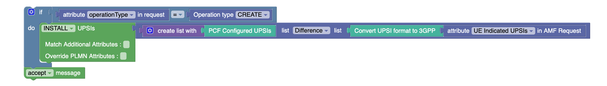

Sample projects to list and compare UPSIs received from UDR
To get the delta of UPSIs between the PCF configured UPSIs and the ones on AMF
Example:
PCF Configured UPSIs has UPSIs ids 1,2,3,4.
UE Indicated UPSIs in AMF Request has UPSIs ids 3,4,5,6.
Expected output of this project:
Install the delta of the UPSIs 1 and 2.

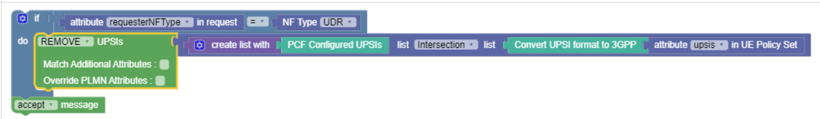

To get the Intersection of UPSIs between the PCF configured UPSIs and the ones from UDR
To get the delta of UPSIs between the PCF configured UPSIs and the ones on UDR
Example:
PCF Configured UPSIs has UPSIs ids 1,2,3,4,5.
UE Policy Set from UDR has UPSIS 5,6.
Remove the common UPSI 5.

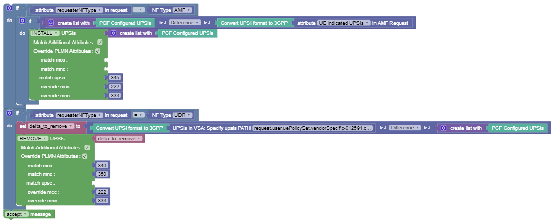

To get the delta of UPSIs between the PCF configured UPSIs and the ones on AMF and validate the matching parameters
To get the delta of UPSIs between the PCF configured UPSIs and the ones on AMF and validate the matching parameters.
Example:
VSA UPSIs from UDR has UPSIS 5,6.
Expected output of this Policy project:
  1. Install the UPSIs 1 and/or 2 if, for each of these UPSIs, its corresponding upsc is equal to 345, and override its PLMN to be 222-333.
  2. Remove the UPSIs 5 and/or 6 if, for each of theseUPSIs, its corresponding mcc is equal to 340 and mnc equals to 350, and override its PLMN to be 222-333.
Note: When Match Additional Attributes option is enable, it is not mandatory to fill all the attributes with a value, as shown in example.

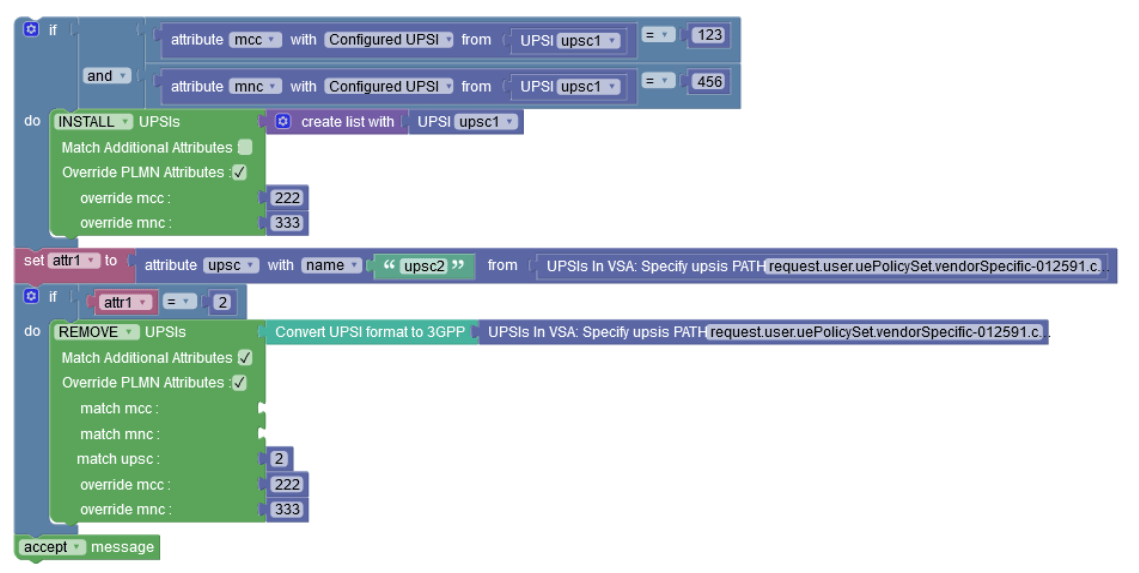

To check for specific attributes values from the PCF Configured UPSIs and the ones that are on VSA by name
In this example, the first part of the blockly will install the "upsc1" upsi if its mcc equals to 123 and mnc equals to 456 and override its PLMN to be 222-333.
Similar for the second part, it will assign a variable called attr1 with the attribute of upsc from the UPSI which has the name "upsc2" on the VSA UPSIs list, and if this value is equal to 2, it will remove this UPSI and will override its PLMN to be 222-333.

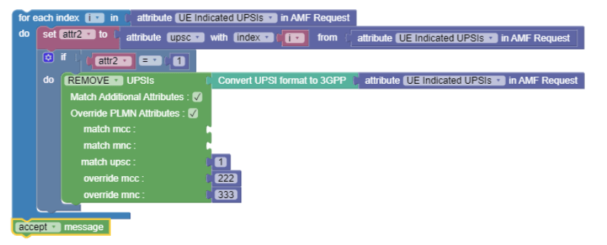

To loop on all the UPSIs that are located on AMF Request
This policy will loop on all the UPSIs that are located on AMF Request.
It allows to access an attribute from specific UPSI on AMF Request. In this example, it allows to check if any of the UPSIs on the list has its upsc as 2.
If found, it removes the corresponding UPSI and overrides its PLMN to be 222-333.

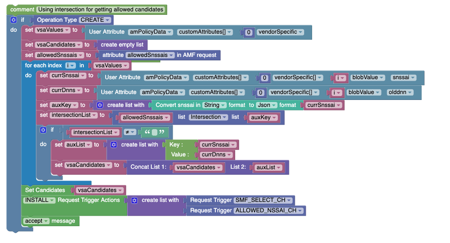

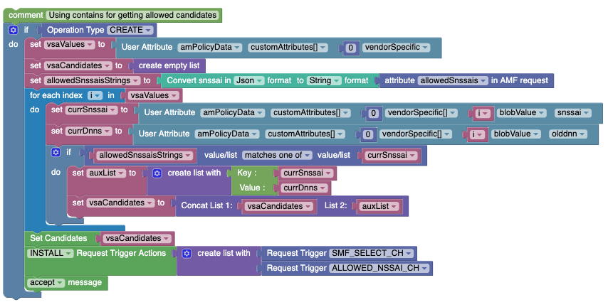

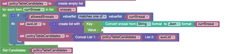

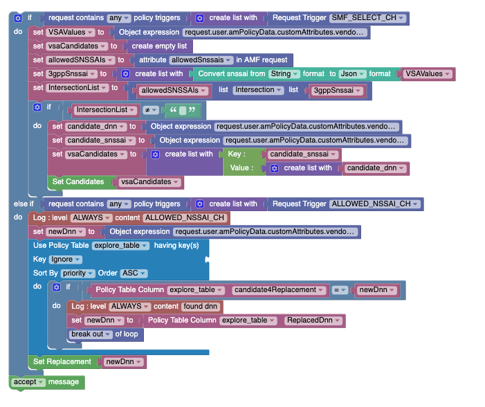

Use Case 2: Using Intersection for Getting Allowed Candidates
The following are Policy project examples to get allowed candidates using intersection list.
Figure 4-19 Using Intersection for Getting Allowed Candidates for Create Request

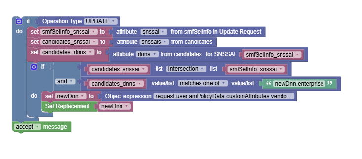

Figure 4-20 Using Intersection for Getting Allowed Candidates for Update Request
Use Case 3: Using Contains for Getting Allowed Candidates
The following are Policy project examples to get allowed candidates using contains list.
Figure 4-21 Using Contains for Getting Allowed Candidates

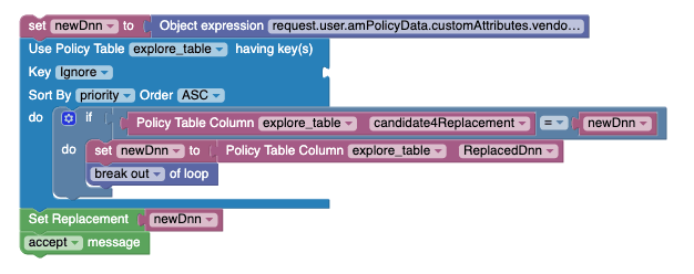

Use Case 4: Support for DNN Replacement and Slice Support in AM Policy
Here is sample usage of Policy Tables to set inputs in the policy design, such as: snssais, dnns, and allowedSnssais:
Table 4-2 Example format for defining the candidate for replacement
S-NSSSAI (String) DNNs (List)
1-010203 dnn1, dnn2, dnn3
1-030405 abiw.internet, newDnn.enterprise
2 newDnn
Also, using Policy Tables it is possible to set a new DNN replacement to be mapped for the candidate for replacement DNNs:
Table 4-3 Setting a new DNN replacement to be mapped with a candidate for replacement DNNs
CandidateForReplacement Replaced DNN
dnn3 EntInternet4
dnn2 EntInternet3
test3 EntInternet3
dnn1 EntInternet2
test1 EntInternet1
test2 EntInternet1
* EntCommon
When there are multiple CandidatesForReplacement with the same DNN, a Priority column must be added to define which replacement to consider.
Table 4-4 Defining priorities when there are multiple CandidatesForReplacement with the same DNN
Priority CandidateForReplacement Replaced DNN
1 dnn2 EntInternet3
1 dnn1 EntInternet2
1 test1 EntInternet1
1 test2 EntInternet1
1 * EntCommon
1 dnn3 newDnn3
1 test3 newDnn3
2 dnn3 EntInternet4
2 test3 EntInternet3
Currently, Policy does not support regex or comma separated values, such as dnn*, dnn1*. For more details, see Support for Comma Separated String, Regex, and Wildcard for CandidateForReplacement and ReplacementDnn table in Support for DNN Replacement and Slice Support in AM Policy section in Oracle Communications Cloud Native Core, Converged Policy User Guide
The maximum number of DNNs that can be configured for Policy Table, "Replacement DNN", is 3000.
Figure 4-22 Example1: DNN Replacement using Policy Tables

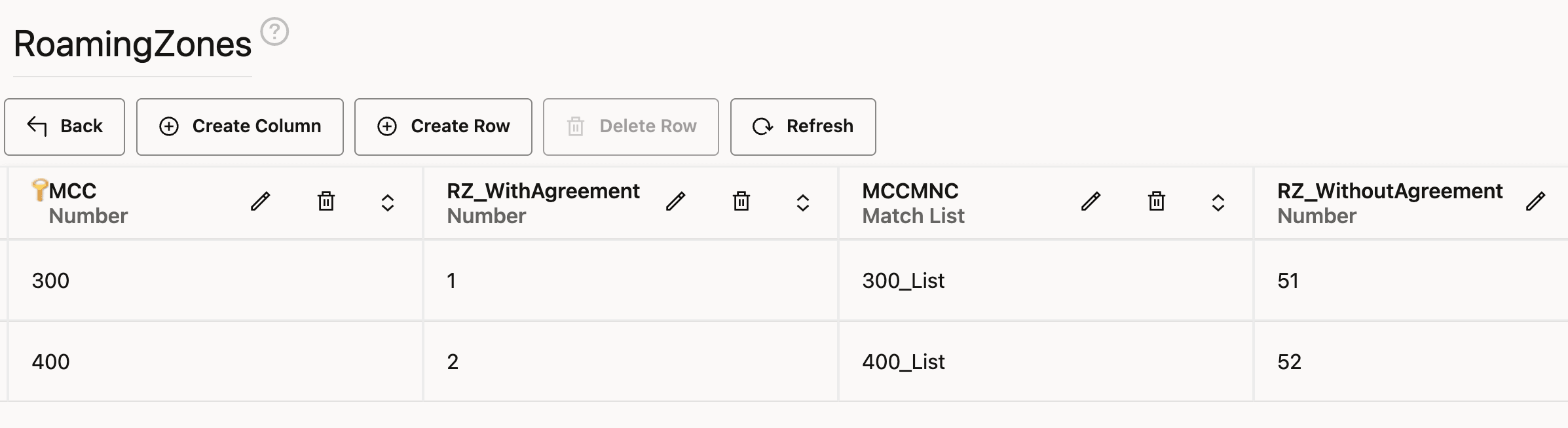

Table 4-5 Policy Table Values for Example1
BlobValueKey AllowedSNSSAIs DNNs DNN S-NSSAIs
0 1-010203, 1-010104 oldnn, abiwinternet newDnn 1-010203, 1-010104
Figure 4-23 Example2: DNN Replacement
Table 4-6 Policy Table Values for Example2
Key CandidateForReplacement ReplacedDnn Priority
1 dnn1 newDnn.corp1 1
2 dnn2 newDnn.corp2 1
3 dnn1 newDnn.corp2 2
Figure 4-24 Example3: DNN Replacement
Table 4-7 Policy Table Values for Example3
Figure 4-25 Example4: DNN Replacement - Candidates with no DNNs

When Cloud Native PCRF receives CCR-Initial requests, install 10MbpsPcc Rule. When Rx flow is observed, then modify the upload limit to 20 MBPS.
The following screen capture shows the created policy after applying the above policy rules:Use Case 1

Use Case 4
When highSpeedCounter is received with current status as true from OCS, install 20MbpsPcc Rule. When highSpeedCounter is received with current status as false from OCS, install 50MbpsPcc Rule. For rest of the scenarios, such as when highSpeedCounter is not received from OCS or does not have current status as true or false, perform the "reject message" action.

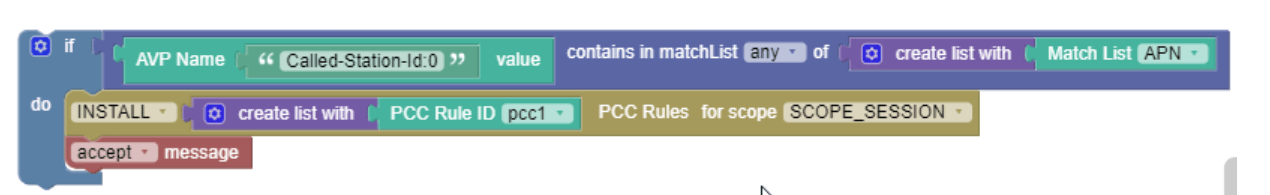

When Cloud Native PCRF receives requests with APN, install pcc1 Rule.
The following screen capture shows the created policy after applying the above policy rules:Use Case 5

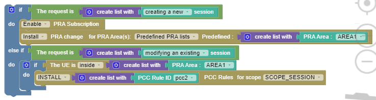

Single PRA: Installing PRA on initial request and removing on update request.
The following screen capture shows the created policy after applying the above policy rules:Single PRA use case

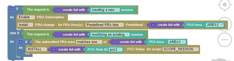

Multiple PRA: Installing PRA on initial request and removing on update request.
The following screen capture shows the created policy after applying the above policy rules:Multiple PRA use case

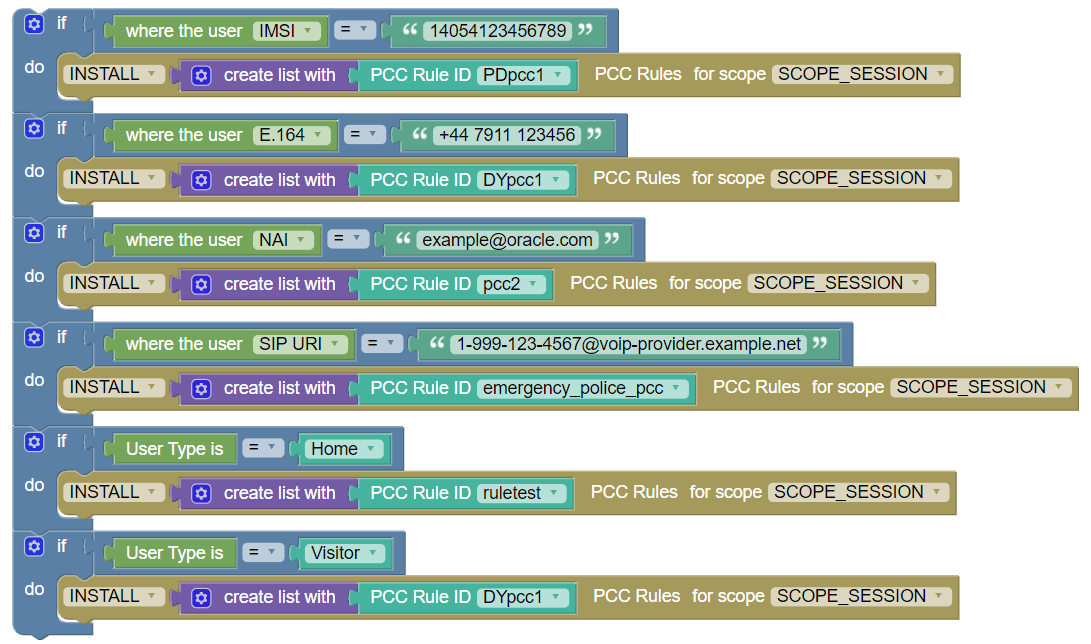

Use Case for User Specific Conditions
The following screen capture shows the created policy for user specific conditions:
Figure 4-27 Use case for User specific conditions
user specific condition use case

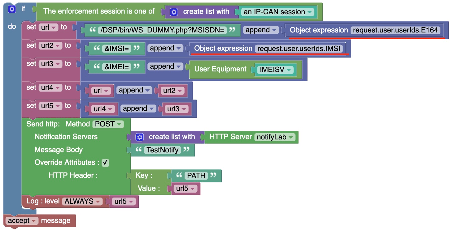

When HTTP end point is used for communication between Notification Service and the external Notification Server, to configure the URI based parameters, use the PATH key for HTTP Header blockly.
The PATH key accepts the url values from dynamic variables that are built with variables taken from object expression or other blocks.
The HTTP Header key: PATH must be in all capital letters as shown here.
The complete URI comprises the IPv4/IPv6/FQDN[:Port] (from the static configuration) followed by the value of the PATH key.
where [:Port] is optional. If port number is not specified, default port will be used.
If you are not using dynamic parameters, you can use the static UriPath from the configuration.
The value of PATH key will override the statically configured URI Path.
Figure 4-28 Configuring URI Based Parameters for Subscriber Notification
This blockly example depicts configuring URI based parameters for subscriber notification

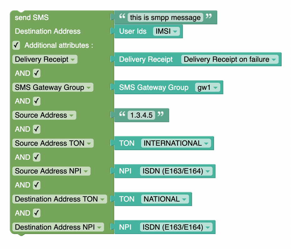

Use Case 2
When Notifier Service uses Short Message Service (SMS) based notification via an SMS gateway for communication between External Short Message Entities (ESME) and internal Message Centres (MC), use Send SMS action.
You can include text strings as message body and specify the Destination address with User IDs.
The list of User IDs includes:
  • E164
  • IMSI
  • NAI
  • IP
  • SIP
  • IMEI
  • IPO
The text message accepts string values and supports multiple languages.
To use Send SMS action, you must also configure additional attributes:
  • Source Address
  • Source Address TON
  • Source Address NPI
  • Destination Address TON
  • Destination Address NPI
  • Delivery Receipt
  • SMS Gateway Group
Figure 4-29 Sample Send SMS blockly configuration
For more details on Send SMS action and the additional attributes that must be configured, see Subscriber Notification under Public Category.

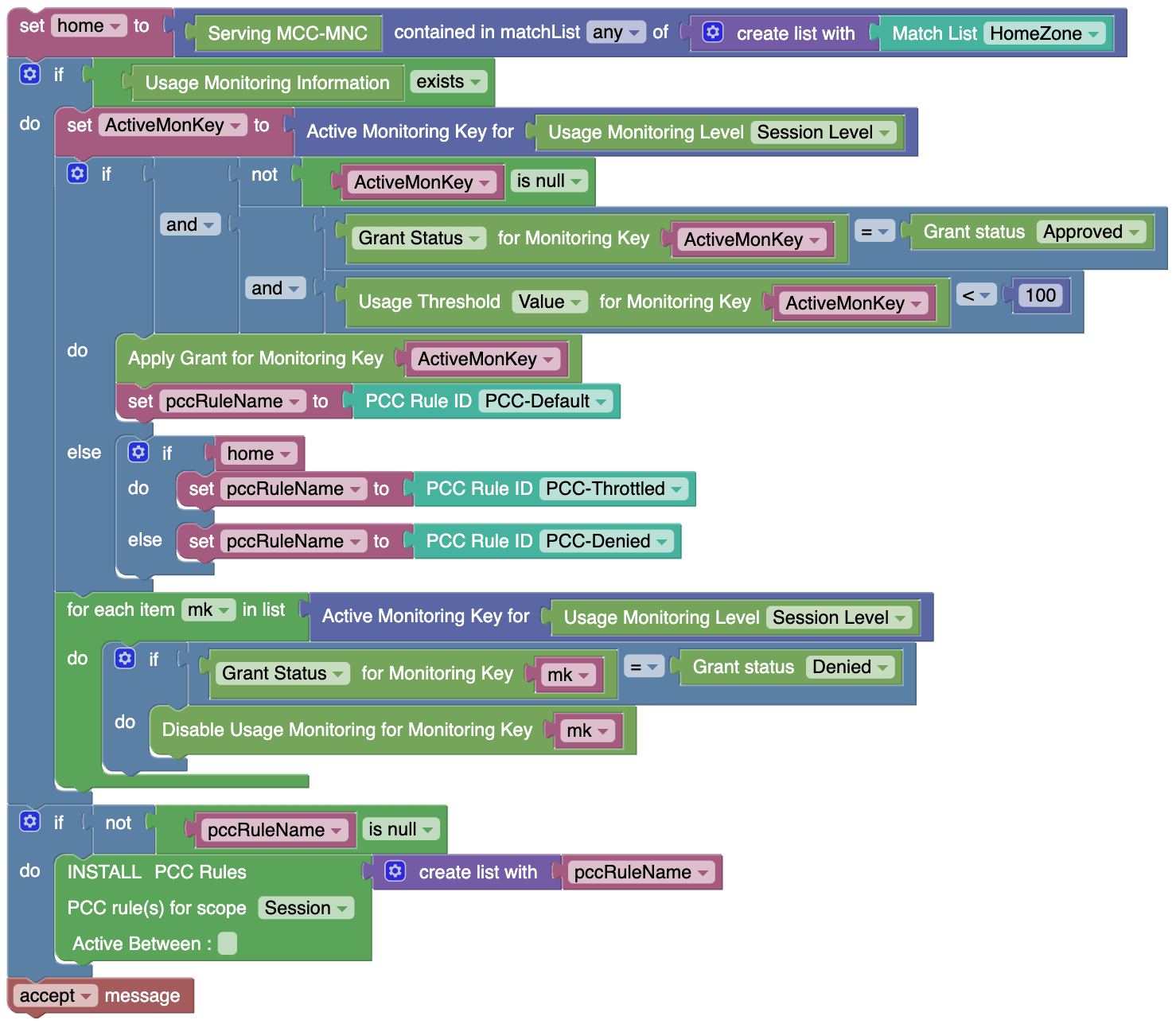

4.6 Usage Monitoring Use Cases
This section includes some of the Usage Monitoring and Control Use Cases.
Home Monthly Plan with Throttling
Scenario
  • All data plans are configured in CNC Console.
  • Subscriber has purchased a monthly plan. Name of the plan is provided in a vendor specific custom attribute "homePlanName" under SmData.
  • As long as subscriber is in the home region and has data left, the subscriber can use this plan.
  • Data is denied if the subscriber is in a roaming region.
  • QoS Throttling is applied when the data in the plan is exhausted.

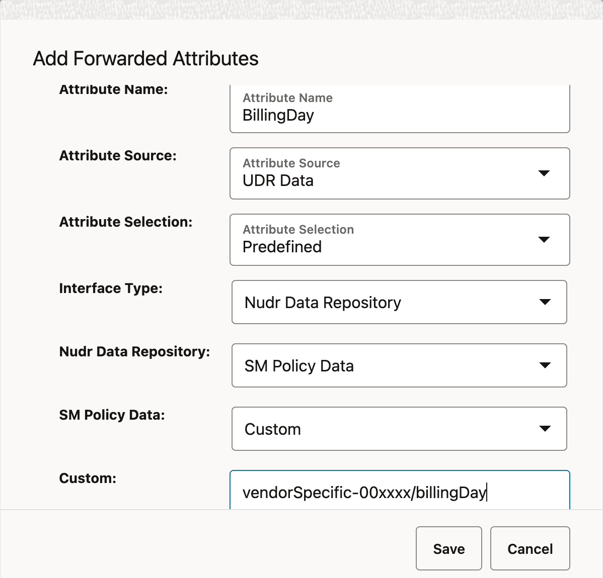

  • The Billing Day is provided in a vendor specific custom attribute "billingDay" under SmData.
ConfigurationData Limit Profile
In CNC Console, Navigate to Policy Data Configurations → Usage Monitoring → Data Limit Profiles and create a Data Limit Profile.
The following fields are mandatory to be set:
  • Name
  • Usage Limit
  • Reset Period

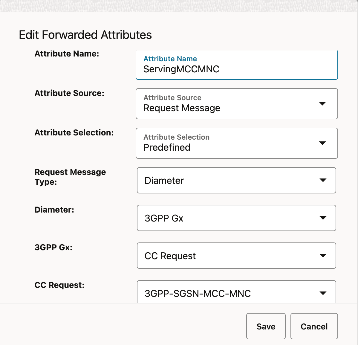

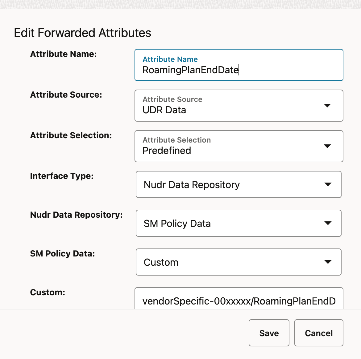

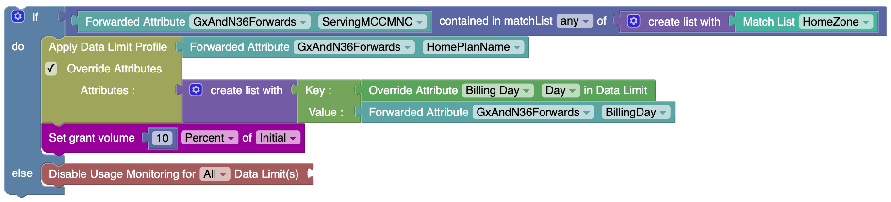

Attribute Forwarding Profile

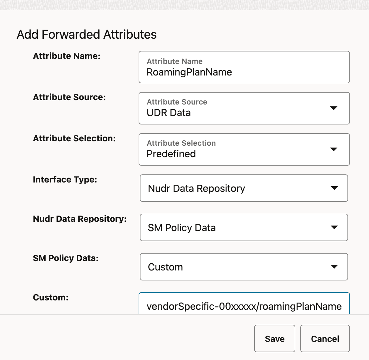

In CNC Console, Navigate to Service Configurations → Common Data → Attribute Forwarding Profile and create a Attribute Forwarding Profile with the field values as displayed in the below screenshot.
Figure 4-30 Forwarded Attributes for Home Monthly Plan with Throttling
Figure 4-31 Forwarded Attributes for Home Monthly Plan with Throttling for Billing Day as per Vendor Specific attribute in SMData
Figure 4-32 Forwarded Attributes for Home Monthly Plan with Throttling
PCRF Core Configuration
In CNC Console, Navigate to Service Configurations → PCRF Core → Settings and set the following field(s) under Usage Monitoring Group:
  • Enabled: true
  • APN List: the list of APNs for which Usage Monitoring is required.
  • Attribute Forwarding: the forwarding profile created for each desired interface/message type.
Usage Monitoring Service Configuration

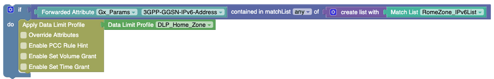

In CNC Console, Navigate to Service Configurations → Usage Monitoring and set the following field(s):
  • Enable PRE: true
Configure other fields as necessary.
Match List
In CNC Console, Navigate to Policy Data Configurations → Common → Match List and create a Match List to fill in the home MCC/MNCs.
Policy Table
Not required for this scenario.

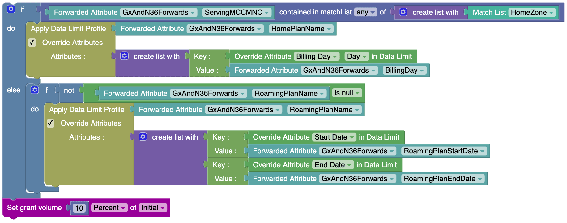

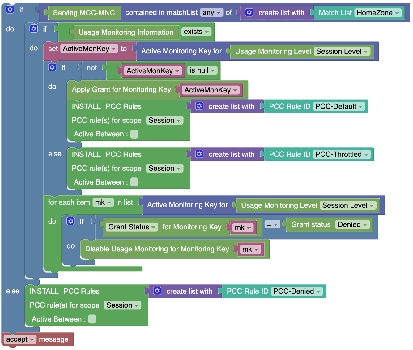

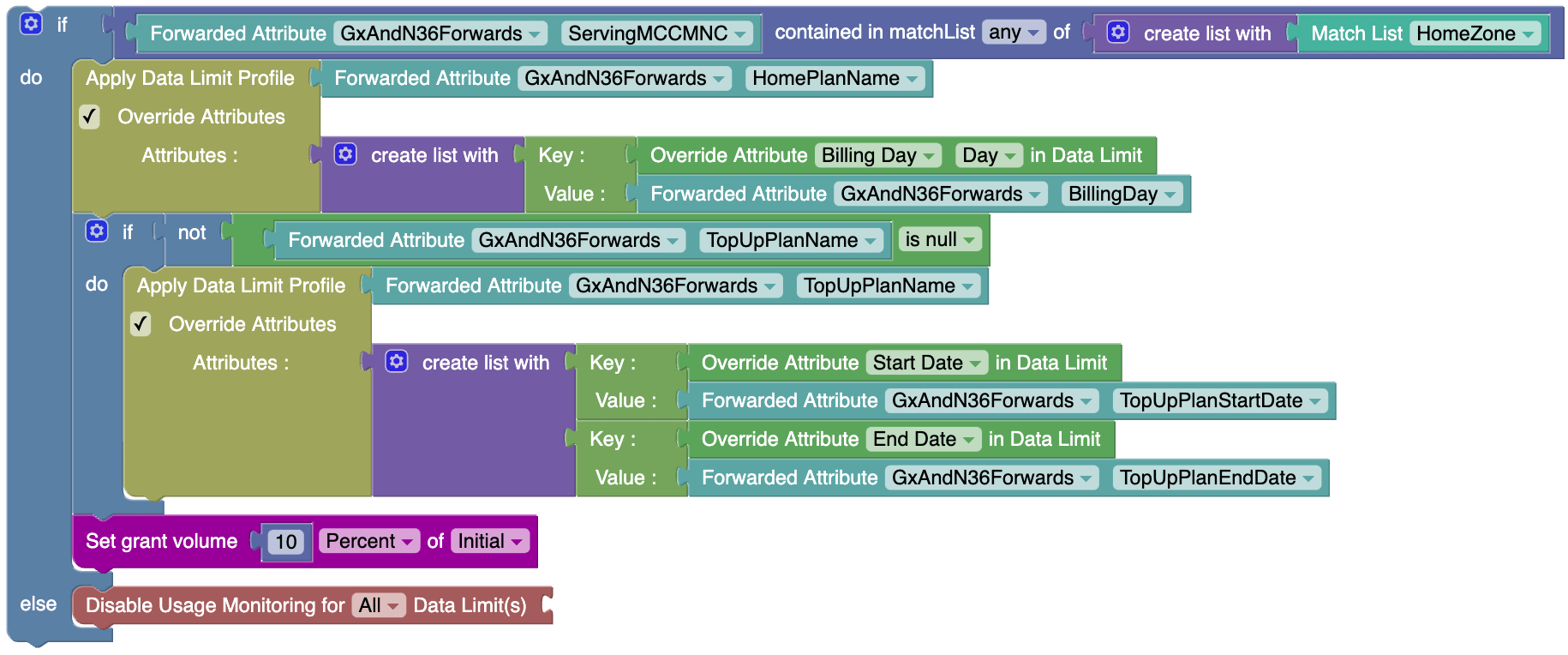

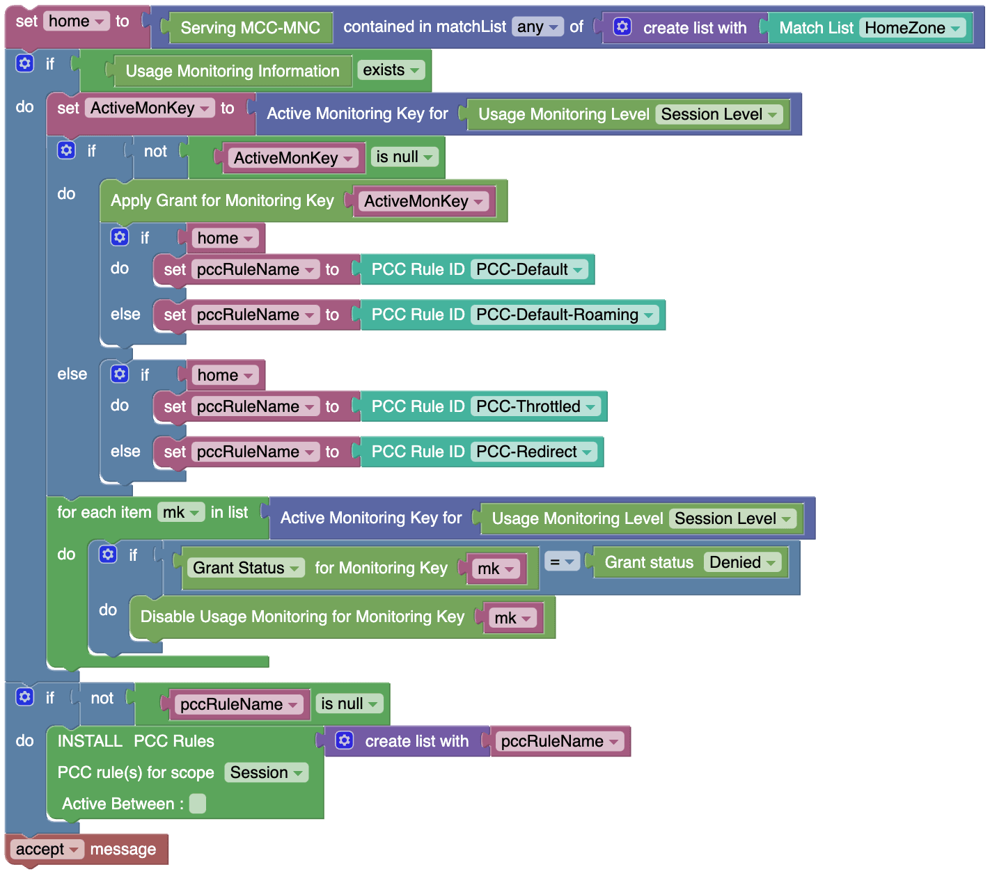

Usage Monitoring Policy
Figure 4-33 Policy Project
Policy Project
Figure 4-34 PCRF Core Policy Project

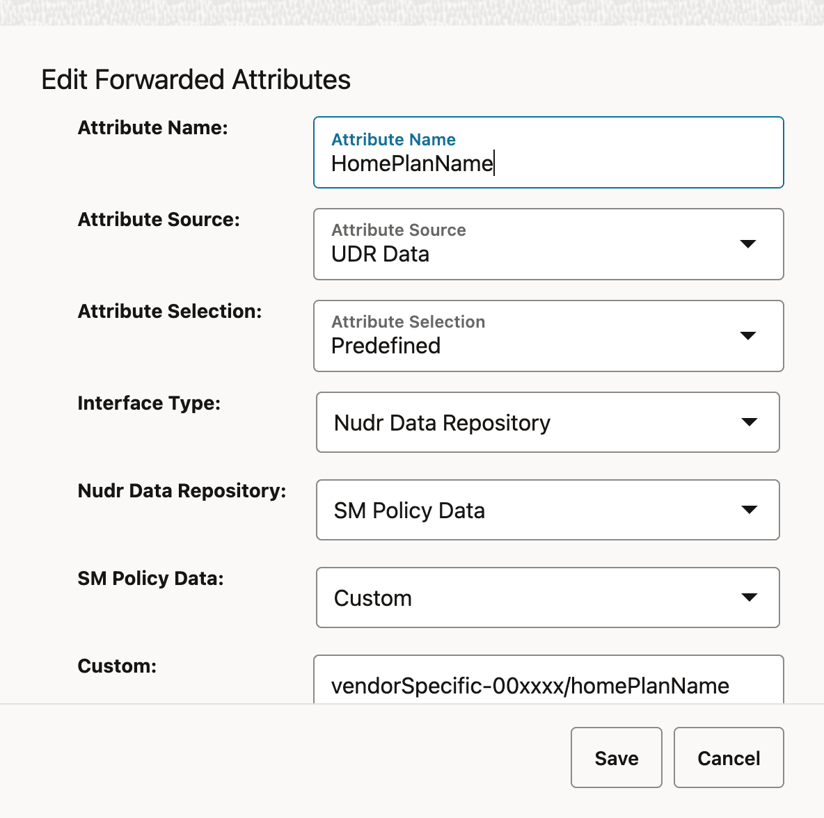

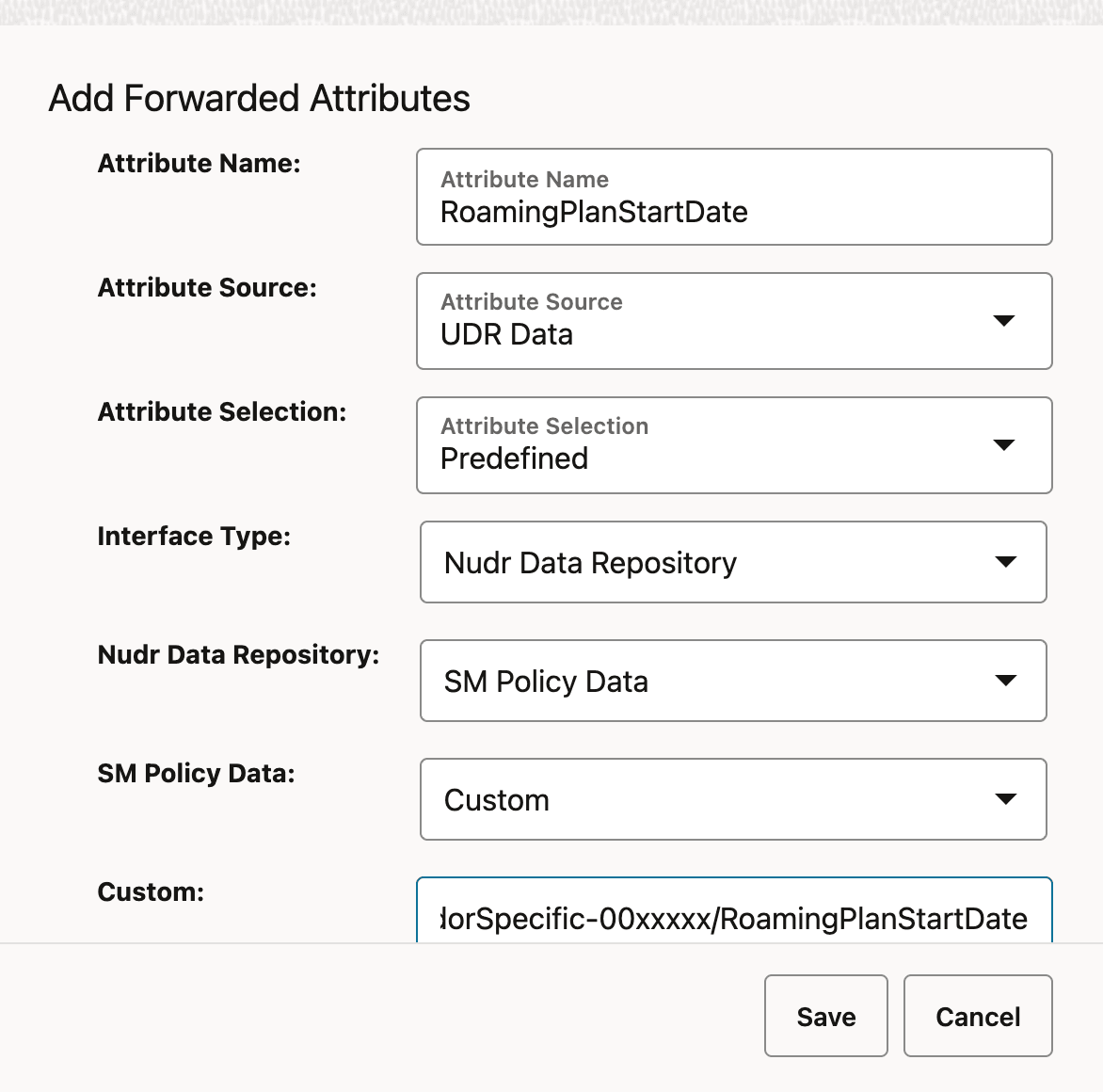

In CNC Policy, Navigate to Service Configurations → Common Data → Attribute Forwarding Profile and create a Attribute Forwarding Profile with the field values as displayed in the below screenshot.
Figure 4-35 Forwarded Attributes for Home Monthly Plan with Roaming Passes
Figure 4-36 Forwarded Attributes for Home Monthly Plan with Roaming Passes
Figure 4-37 Forwarded Attributes for Home Monthly Plan with Roaming Passes
Figure 4-38 Forwarded Attributes for Home Monthly Plan with Roaming Passes
Figure 4-39 Forwarded Attributes for Home Monthly Plan with Roaming Passes
Figure 4-40 Forwarded Attributes for Home Monthly Plan with Roaming Passes

Figure 4-41 Policy Project for Home Monthly Plan with Roaming Passes
Figure 4-42 PCRF Core Project for Home Monthly Plan with Roaming Passes
PCRF Project for Home Monthly Plan with Roaming Passes
Home Monthly Plan with Top-up
Scenario
  • All data plans are configured In CNC Policy
  • Subscriber has also purchased a Top-up. Name of the Top-up is provided in a vendor specific custom attribute "topUpName" under SmData. The start and end dates for this top-up are also provided in vendor specific custom attributes "topUpPlanStartDate", "topUpPlanEndDate" under SmData. This is a one-time plan and will expire when entirely consumed.
  • The base plan will be consumed before the top-up as long as there is quota left in the base plan.
  • QoS and Charging for base and top-up plans are same.
  • When both base and top-up quota are exhausted, QoS throttling is applied.
In CNC Policy, Navigate to Policy Data Configurations → Usage Monitoring → Data Limit Profiles and create a Data Limit Profile for Home Plan.
  • Name
  • Usage Limit
  • Reset Period
For Top-up, follow the same steps, however set the following field values:
  • Plan Type: Top-up
  • Reset Period: Empty

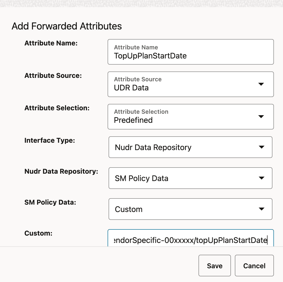

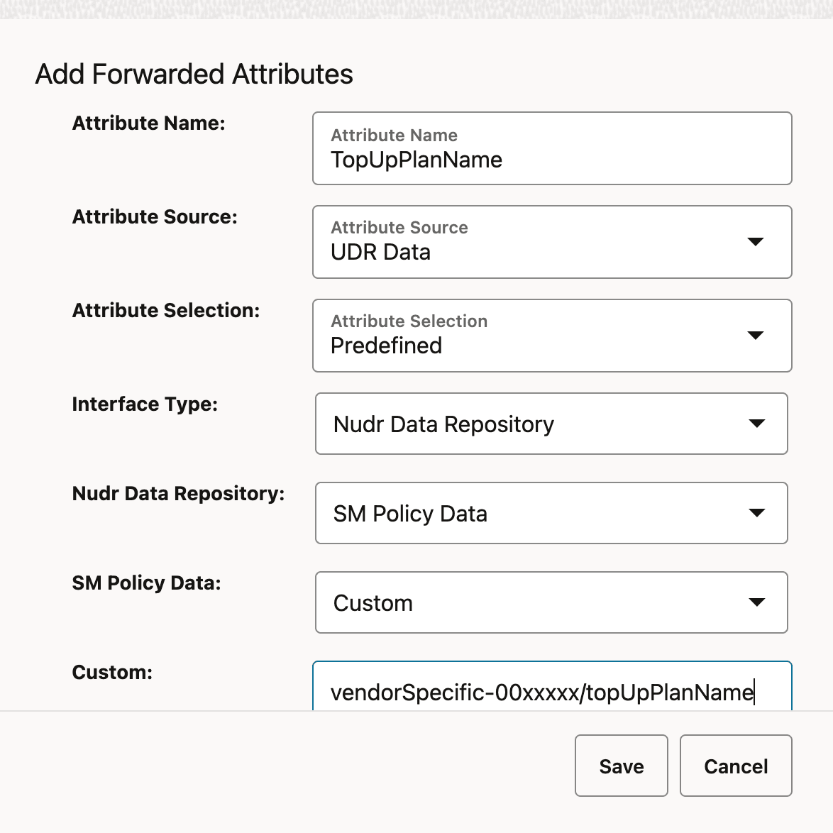

Figure 4-43 Forwarded Attributes for Home Monthly Plan with Top-up
Figure 4-44 Forwarded Attributes for Home Monthly Plan with Top-up
Figure 4-45 Forwarded Attributes for Home Monthly Plan with Top-up
Figure 4-46 Forwarded Attributes for Home Monthly Plan with Top-up
Figure 4-47 Forwarded Attributes for Home Monthly Plan with Top-up
In CNC Policy, Navigate to Service Configurations → PCRF Core → Settings and set the following field(s) under Usage Monitoring Group:
  • Enabled: true
Figure 4-50 Forwarded Attributes for Monthly Plan with Weekend Passes
Figure 4-51 Forwarded Attributes for Monthly Plan with Weekend Passes
Figure 4-52 Forwarded Attributes for Monthly Plan with Weekend Passes
Figure 4-54 Policy Project for Home Mobthly Plan with Weekend Passes
Monthly Plan with Multiple Top-ups
Scenario
  • Subscriber has purchased two Top-up Plans - the names of which are provided in the custom attributes "topup1Name" and "topup2Name" under SmData.
  • The start and end dates for these top-up plans are also provided in vendor specific custom attributes "topUpPlan1StartDate", "topUpPlan1EndDate", "topUpPlan2StartDate", "topUpPlan2EndDate" under SmData. These are one-time plans and will expire when entirely consumed.
  • "TOPUP1" will be consumed before "TOPUP2".
  • Subscriber has purchased two Top-up Plans - "TOP1" and "TOP2"
  • Name
  • Usage Limit
  • Reset Period
  • Plan Type: Top-up
In CNC Policy, Navigate to Service Configurations → Common Data → Attribute Forwarding Profile and create a Attribute Forwarding Profile as described in previous scenarios.
  • Enabled: true
In CNC Policy, Navigate to Service Configurations → Usage Monitoring and set the following field(s):
  • Enable PRE: true
  • data plans Selection Order:
Figure 4-55 Configuration for Monthly Plan with Multiple Top-ups
Match List
In CNC Policy, Navigate to Policy Data Configurations → Common → Match List and create a Match List to fill in the home MCC/MNCs.
Policy Table
Figure 4-56 Policy Project for Monthly Plan with Multiple Top-ups
Autoenrolled Roaming Subscriber with Multiple Roaming Passes
Scenario
  • All roaming subscribers are given roaming plans based on the roaming zone, which is defined based on MCC-MNC.
    • If there is a match found for the Country Code and Network Code => Zone=RZ_WithAgreement
    • If there is a match found for the Country Code but not for Network Code => Zone=RZ_WithoutAgreement
    • If there is no match found for Country Code => Zone=0
  • Each Subscriber is given two daily recurring Roaming Plans.
  • When Roaming Plan 1 is exhausted, Roaming Plan 2 is applied.
  • When Roaming Plan 2 is exhausted, subscribers belonging to Zone 0 are redirected to a Portal, rest are Throttled.

Policy Table

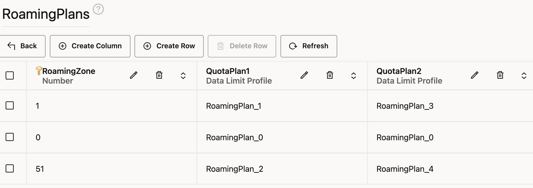

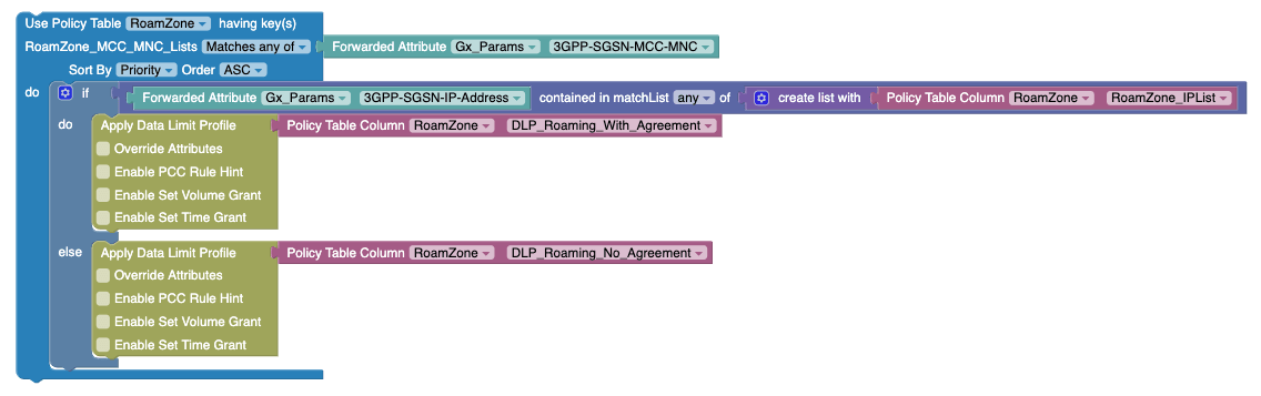

Figure 4-57 Roaming Zones for Autoenrolled Roaming Subscriber with Multiple Roaming Passes
Figure 4-58 Roaming Plans for Autoenrolled Roaming Subscriber with Multiple Roaming Passes

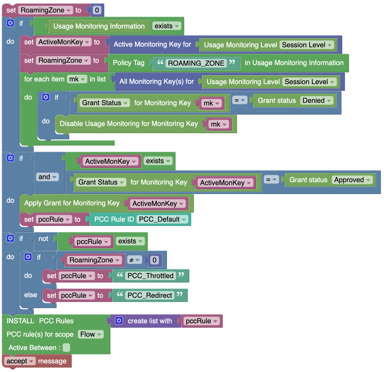

Figure 4-59 Policy Porject for Autoenrolled Roaming Subscriber with Multiple Roaming Passes
Figure 4-60 PCRF Core Porject for Autoenrolled Roaming Subscriber with Multiple Roaming Passes
4.7 Match List
A match list is a set of values in various categories, including access point names (APNs), subscriber IMSIs, location area codes (LACs), service area codes (SACs), Internet addresses, and user equipment identities. A match list can function as a whitelist (listing items to be included) or a blacklist (listing items to be excluded). By using a match list, you can, for example, apply a policy to all subscribers in a set of LACs, or block access to a list of Internet addresses known to be high risk.
Match List is used during a list creation to either select or omit the items from a list. The items in the list must be homogeneous.
You can create the list of items using Match List page under Common section for Policy Data Configuration in CNC Console.
For more details, see Match List section in Configuring CNC Console in Oracle Communications Cloud Native Core, Converged Policy User Guide.
Policy Projects in CNC Console includes a Contains in matchList block, which indicates to select items specified in Match List block.
Match List specifies the list to be used for matching criteria.
Figure 4-61 Here is an example of match list functionality:
In the Match List Block Match List name is provided the right side and the value is provided on the left side. On the right side, multiple Match List can be given. But, it must contain only one value on the left side.
Possible values for Contains in matchList block are:
  • any - If the attribute value from left side matches with any of the values of Match List in the right side, the output of Contains in matchList will be true. Otherwise, false.
  • all - If the attribute value from left side is present in all the given values of Match List on the right side, the output of Contains in matchList will be true. Otherwise, false.
  • none - If the attribute value from left side not present in any of the given values of Match List on the right side, the output of Contains in matchList will be true. Otherwise, false.

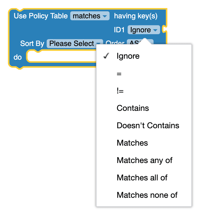

The possible values of Use Policy Table block are:
  • Matches: For Matches to be used in Policy Table, the data type must be String.
    Figure 4-67 Example: Use Policy Table with Matches option
    In the above example, in table DNN1, the value of column dnn is matched with "DNNAdminAccess: and the value of column dnnType is matched with "ADMIN".
  • Matches all of: The data type of the Policy table should be MatchList or MatchLists (array of matchlist)
    If the data type is MatchLists, the array of MatchList can be present per row (in policy table) and in this case all the MatchList should be matched in a single row (policy table) to return true and pass that row.
    Figure 4-68 Example: Use Policy Table with Matches All Of option
    In the above example, the value of Forwarded Attribute block (such as "333444") is matched with both "DNN2" and "DNN" or "IPList" and "HomeZone" to return the respective row.
  • Matches any of: The data type of the Policy table should be MatchList or MatchLists (array of MatchList)
    If the data type is MatchLists, the array of MatchList can be present per row (in policy table) and in this case any MatchList should be matched in a single row (Policy table) to return true and pass that row.
    Figure 4-69 Example: Use Policy Table with Matches Any Of option
    In the above example, Forwarded Attribute the value is (such as "333444") is matched with any of "DNN2" and "DNN" or "IPList" and "HomeZone" to return the respective row.
    The data type of the policy table column MatchList is same for both the operators Matches all of and Matches any of, as there will be only one MatchList present per row.
  • Matches none of: The data type of the Policy table should be MatchList or MatchLists (array of MatchList).
    If the data type is MatchLists, the array of MatchList can be present per row (in policy table) and in this case all MatchList should not be matched in a single row (policy table) to return true and pass that row.
    Figure 4-70 Example: Use Policy Table with Matches None Of option
    In the above example, the value of Forwarded Attribute block (such as "333444") must not match with both "DNN2" and "DNN" or "IPList" and "HomeZone" to return the respective row
Using Policy Table Columns
Policy supports matching the value of a particular column similar to Match Lists.
Figure 4-71 Policy Table Column
Policy Table Column
Figure 4-72 Example: Use of Policy Table Column block
In the above example, If PRE value for the Forwarded Attribute block should be an exact match or the wildcard match with column DNNString in the table HomeZone1, then in the if condition block, the PRE value for the Forwarded Attribute block should match with the match list defined in the column IPList under the table HomeZone1.
If the given value "311", which exactly matches with the column name MCC, then in the MatchList block the given value "311490" will match with any of the value in the table column MCCMNC.
It can have any MatchList data type such as string, wildcard, IPv4, IPv6, or Regular expression.
