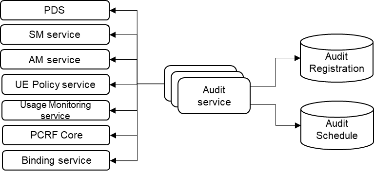

The Audit Service Single Pod design
Audit service is mainly responsible for:
  • allows core services to dynamically register or de-register the tables for auditing process
  • core services can change other attributes at run time by using the Audit service restful interface
  • notifying the context owners about the expired records in the registered table for auditing
  • provide flow control of notifications towards the context owners
  • perform forceful deletion of stale records, in case no corrective action is taken by context owners
  • publish total count of records in the registered table for auditing
Audit service is not only responsible for stale session cleanup but has increased scope in other signaling features as well e.g., notifying core service for binding retry attempts.
Audit service with single pod deployment makes it neither scalable nor highly available. Audit service supports multiple pods, by using Audit Schedule. Audit Schedule helps to effectively manage and plan the audit service on the registered services.
Figure 3-2 Multiple Pod Audit Service

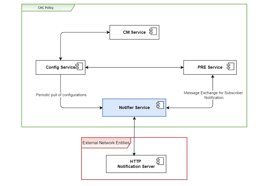

Policy Notifier service is an optional service that allows Policy to send notifications to the subscribers about their current data usage. This service is independent of deployment mode and can be enabled in all the supported deployment modes.
As part of subscriber quota management and based on the defined policies, the user is notified about their current usage at various levels. For example, when a user consumes 80% of the granted quota, a notification must be sent to notify the user about its usage. Similarly, when they reach or exceed the threshold, a notification must be sent informing the user about reduced quality of service or even suspension of service. With the Notifier service, Policy can send either HTTP notification or short messages (SMS) using SMPP to subscribers, based on the policies configured by operators, through an external notification server.
In the current release, Policy supports subscriber notification only using HTTP and SMPP protocols.
This feature is supported only for PCRF-Core call flows.
The following diagram shows how Notifier Service fetches configurations from Config service and on receiving notification request from PRE, sends out the notification to the subscriber via external notification server:
Figure 3-4 High Level Notifier Service Diagram

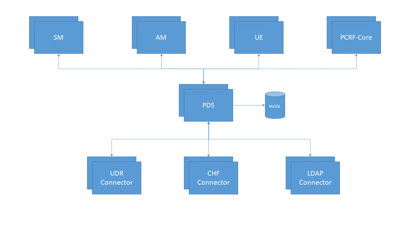

3.8 Policy Data Source (PDS) Service
Policy Data Source Service (PDS) is an intermediate layer which interfaces Core Services (SM/AM/UE/PCRF-Core) with the protocol specific connector layers (UDR/CHF/LDAP Connectors). PDS also holds the subscriber information in its database when a new session gets established for a given subscriber and cleans-up the information when the last session termination happens. PDS is also responsible for storing the Subscriber State Variables except session level in its database and provides these variable information across multiple core services which requests the information.
You could define the workflows for PDS and the workflow would define the flow of request processing. This workflow is internal to the PDS project and should consult with engineering team for any update.
The following figure depicts the PDS architecture:
PDS overview
For configuring PDS service, see PDS Settings.
Currently, PDS supports SUPI/GPSI as the search key. It does not support NAI as the search key.
UDR Connector- UDR Connector is a protocol specific layer which converts the request send by PDS to nUDR specific format and forwards to real UDR for subscription information. It also provides an ability to subscribe for profile change at UDR.
CHF Connector – CHF Connector is a protocol specific layer which converts the request send by PDS to nCHF specific format and forwards to actual CHF for fetching PolicyCounter Information. As per the standards, it automatically subscribes for profile change at CHF.
For configuring the UDR or CHF connector, see PCF User Connector.
