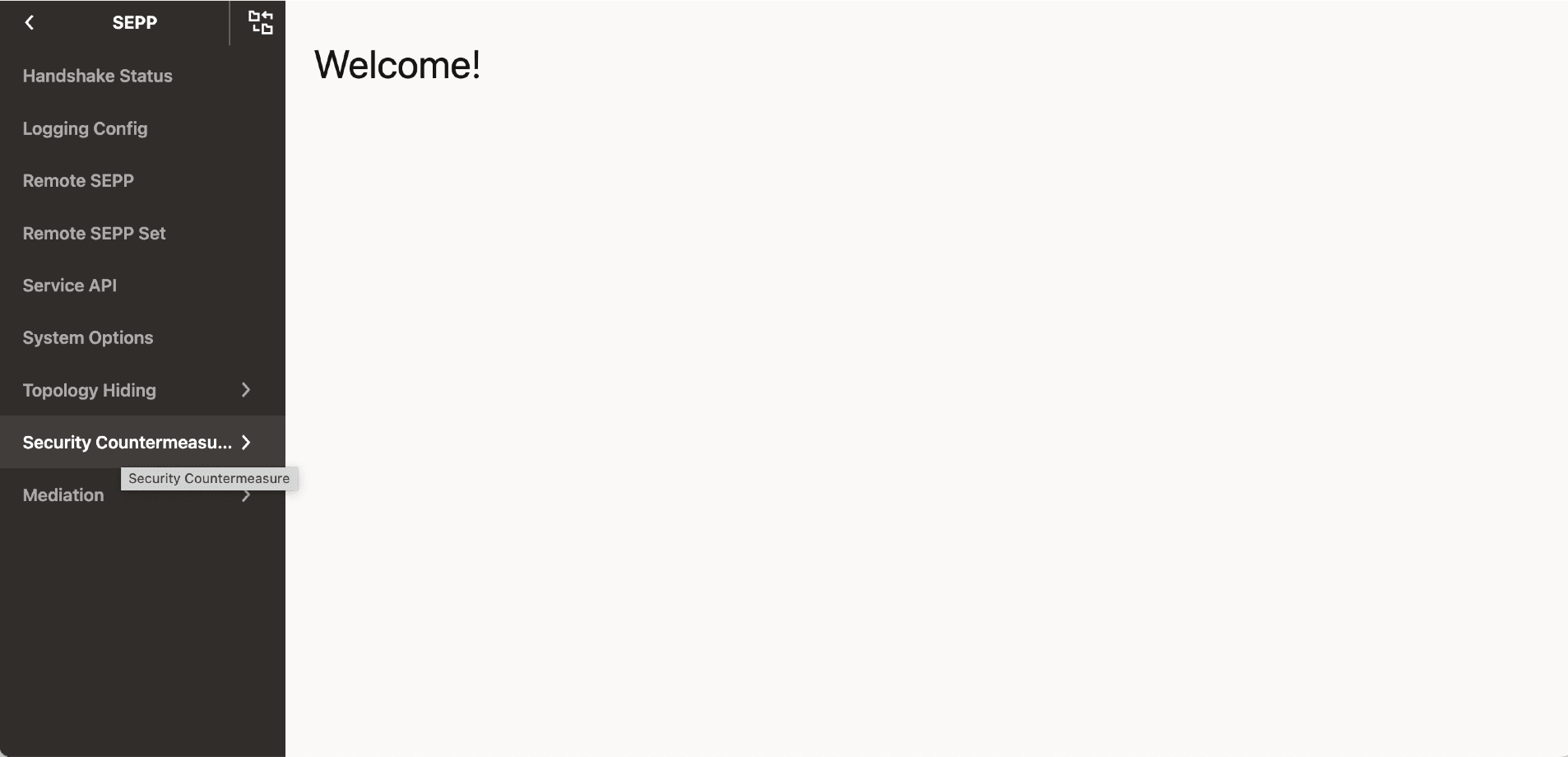

On selecting SEPP from the drop-down list, the following screen appears:
Figure 4-3 SEPP Welcome Screen
SEPP Welcome Screen

4.2.9 Security Countermeasure
The Security Countermeasure option is used to enable and configure the Cat-0 SBI Message Schema Validation feature, Cat 1 -Service API Validation feature, Cat 2 – Network ID Validation feature, and Cat 3 – Previous Location Check feature.
The Service API Allowed List REST API is used to do the configurations on the allowed list of REST APIs.

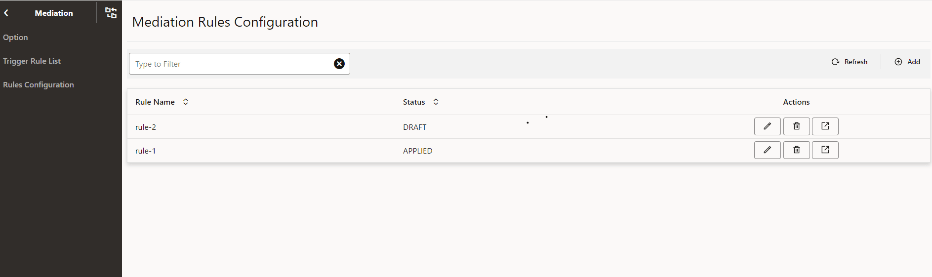

  1. From the left navigation menu, navigate to SEPP and then select Mediation. The Rules Configuration screen appears underneath.
  2. Click Rules Configuration, the list of all the existing rules with corresponding status appears.
    Figure 4-4 Mediation Rules Configuration Screen

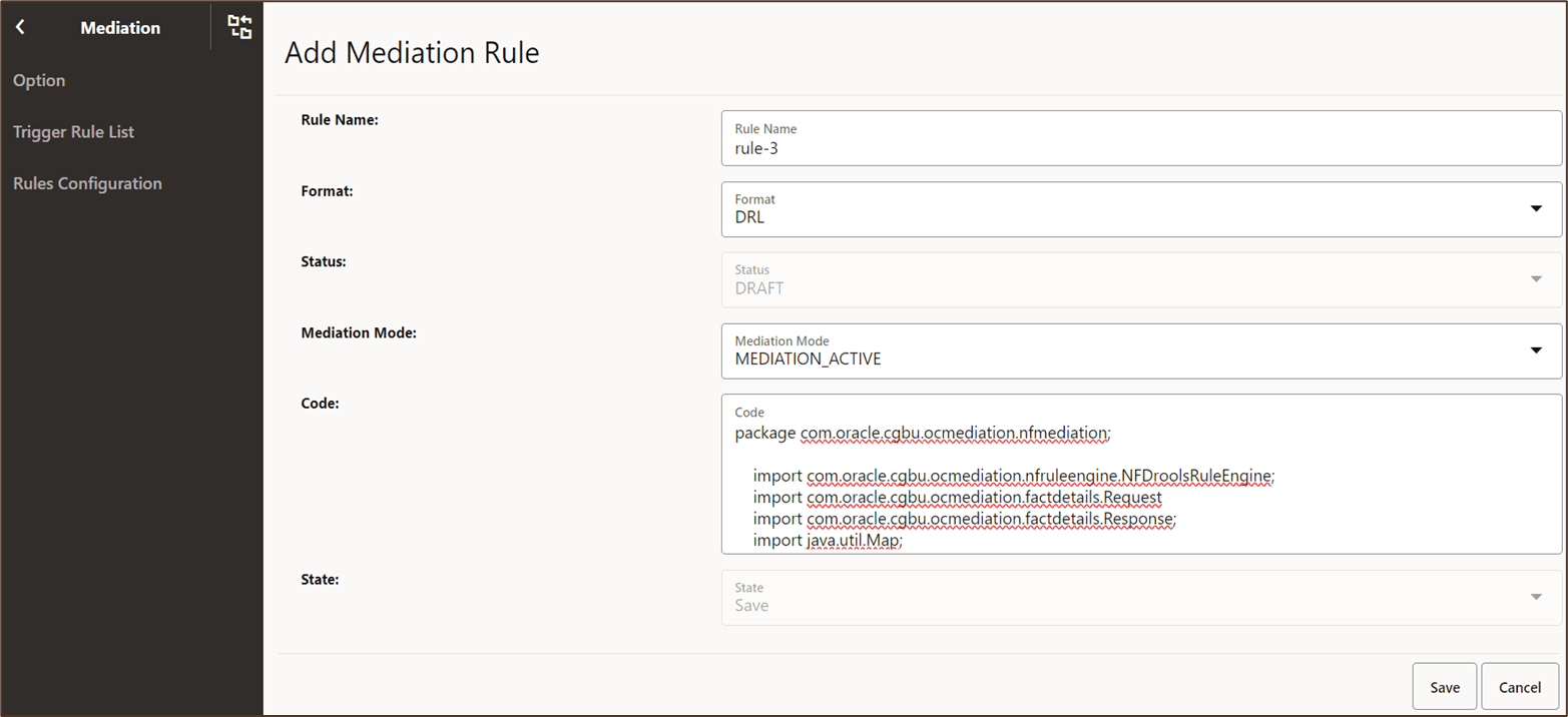

  3. Click Add to add a new rule. The Add Mediation Rule page appears and user can add the mediation rule information.
    Figure 4-5 Add Mediation Rule Screen
    Rule Name, Format, Status, Mediation Mode, Code, and State are the mediation rule parameters.

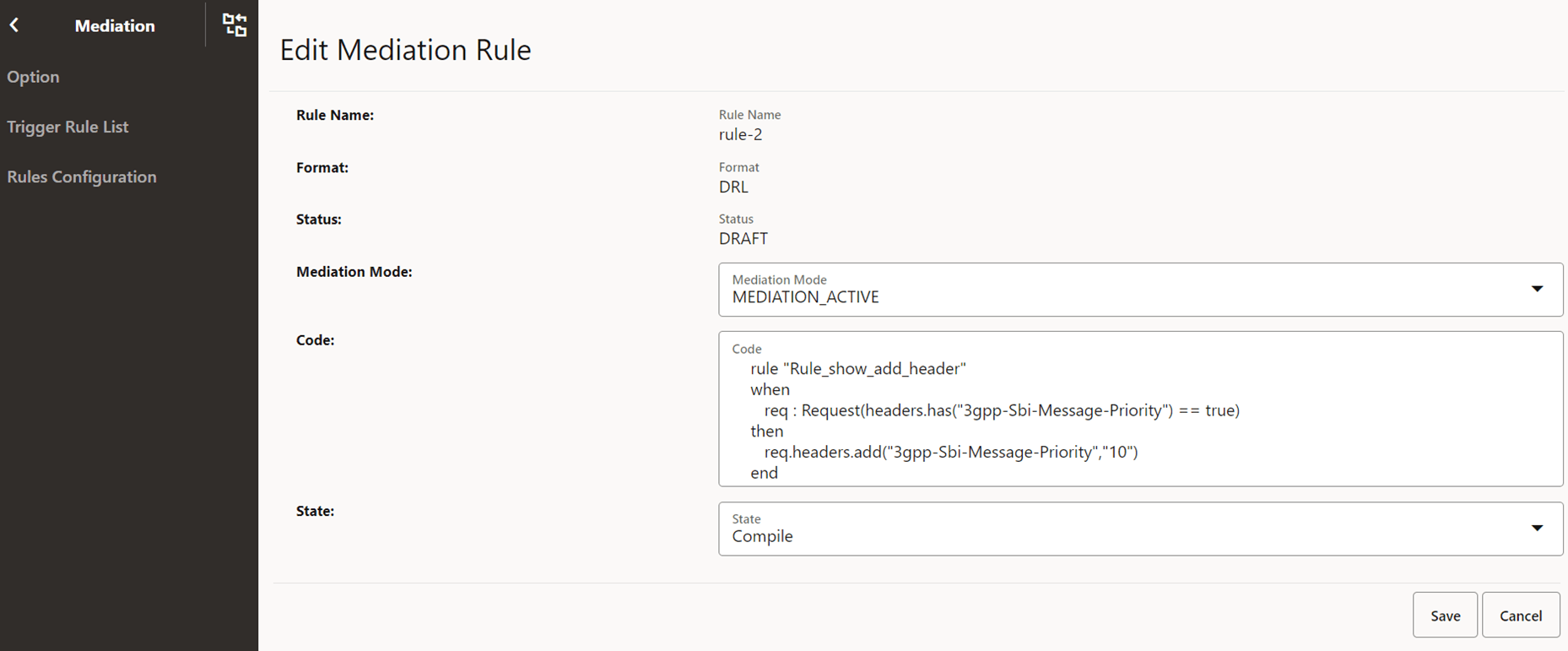

  4. Click Edit button of an existing rule to modify that rule. The Edit Mediation Rule page appears and user can edit the rule information.
    Figure 4-6 Edit Mediation Rule Screen

Code M String
Mediation rule code content.
The user has to prepend the following data block along with the needed rules in the code section and save to create the rule in DRAFT status. If the user wants to apply the rule on mediation microservice then user can edit the rule and save it again with Apply state.
package com.oracle.cgbu.ocmediation.nfmediation;
    import com.oracle.cgbu.ocmediation.nfruleengine.NFDroolsRuleEngine;
    import com.oracle.cgbu.ocmediation.factdetails.Request;
    import com.oracle.cgbu.ocmediation.factdetails.Response;
    import java.util.Map;
    import java.util.HashMap;
    dialect "mvel"
Format M Enum Rule format. Only DRL is supported currently.
New Rule Name C String New rule name is to be given only when state is clone.
