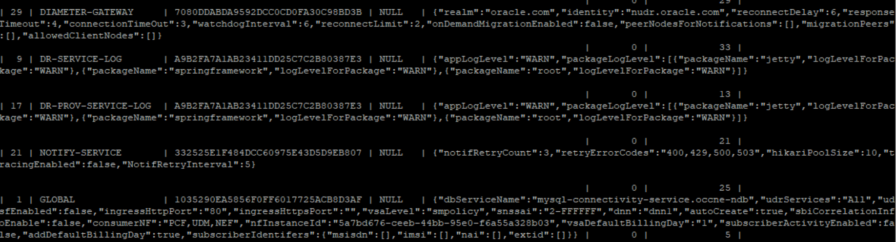

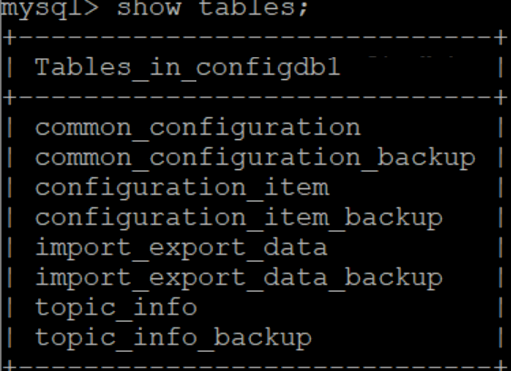

If requests for ocudr-nudr-config fail, try to find the root cause from configdb using following guidelines:
- If you get a BAD REQUEST for GET API, then make sure all the tables shown
below is present in configdb table.
Figure 4-37 Configdb Table

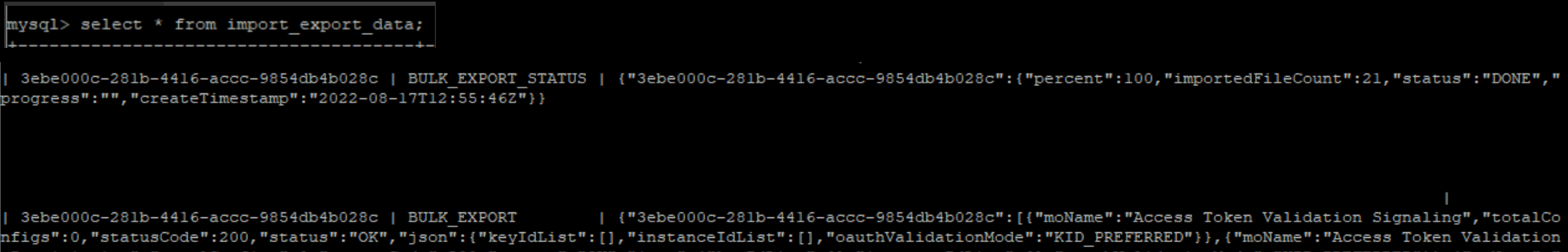

- If you get a BAD REQUEST and NOT FOUND for Import and Export API,
then you must verify the import and export data table shown below.
Figure 4-39 Import and Export Data

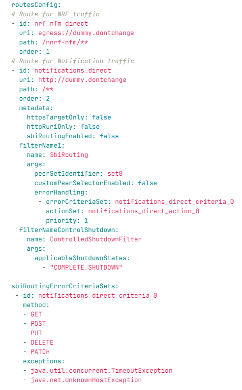

UDR Egress Gateway route configurations are performed to route all the notifications through SCP, and the NRF traffic is sent directly to the NRF host. If the routing does not work, then configure the routes as follows:
Figure 4-40 Routes Config
The above configuration is present as part of default values.If you want to send notifications through SCP, configure Egress Gateway as shown in the following image. If setId 0 is used, configure both httpConfigs and httpsConfigs as shown in the image. For setId having static host configuration for httpsConfigs (even if its not used), it is mandatory to configure this parameter using dummy values as shown in the image. If it is not configured, then the Egress Gateway log shows NullPointerException.
Figure 4-41 Sending Notification Through SCP

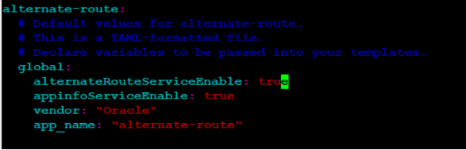

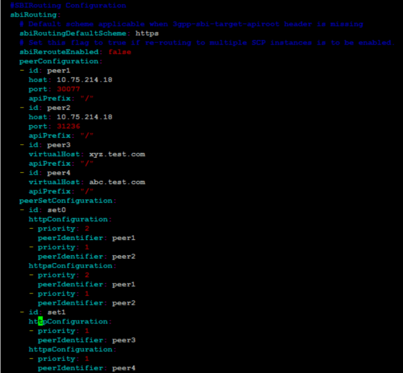

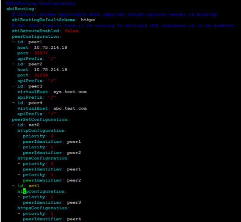

If it uses setId 1 or 2, enable Alternate Route service and configure proper host details for Egress Gateway to communicate with alternate route service. If configurations are not done as expected, then it gives 425 error, which is the default error configured for virtual FQDN lookup failure. If you see 503 or other 4xx errors, then it is because the actual endpoint or SCP is not reachable.
Figure 4-42 Using setId 1 or 2
Figure 4-43 Using setId
Figure 4-44 Using setId 1 or 2 (cont..)
Figure 4-45 Using setId 1 or 2 (cont..)

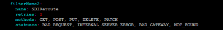

Figure 4-46 SCP Retry

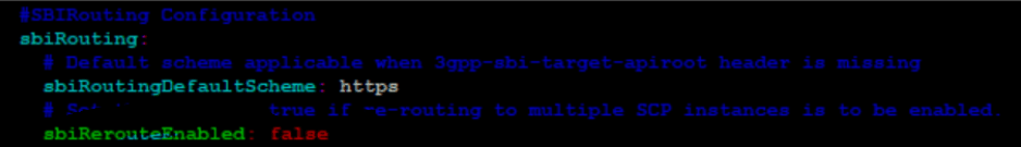

Also, ensure that scpRerouteEnabled is set to true.
Figure 4-47 scpRerouteEnabled set to true

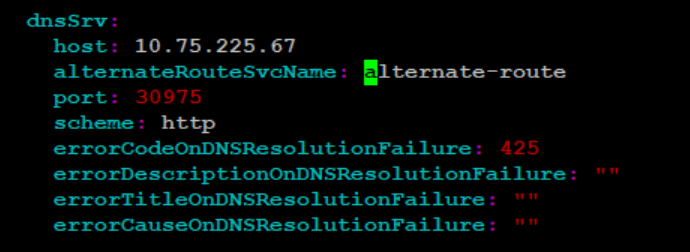

Figure 4-48 DNS Srv Configuration

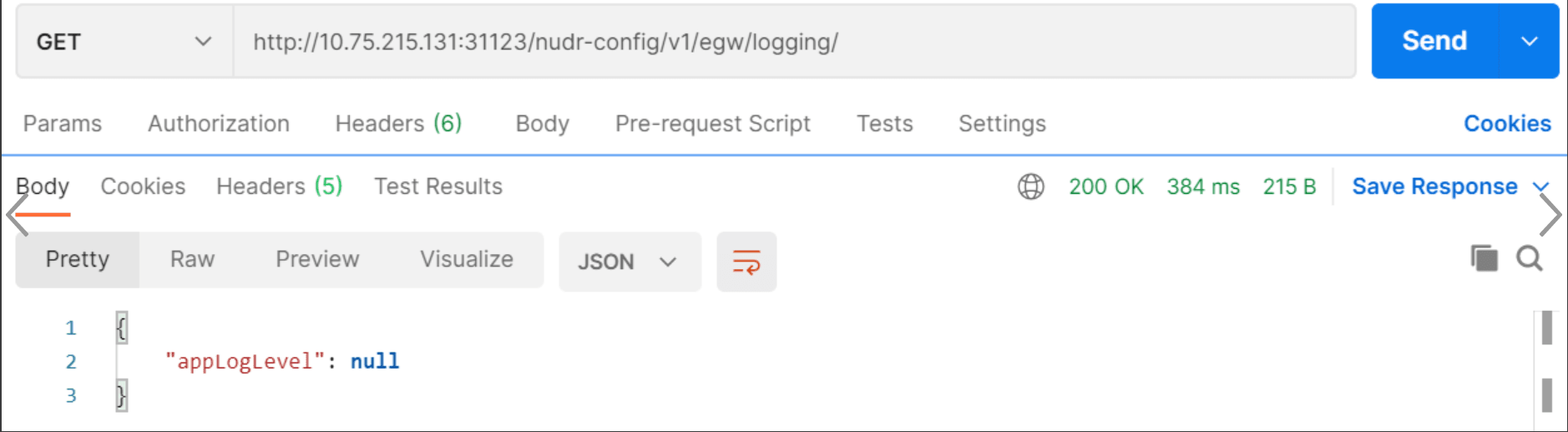

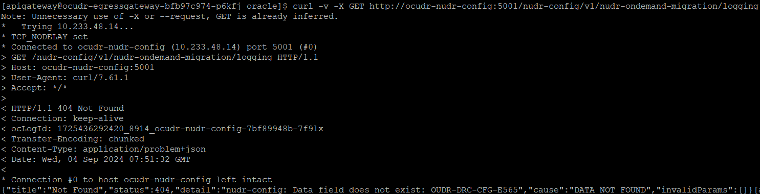

- Check for 400 Error: If the following request fails with 400
status code with "404 Not Found", it indicates that the logging level
information is not present in the database or the microservice is not
enabled.
Figure 4-49 Checking for 400 Error
