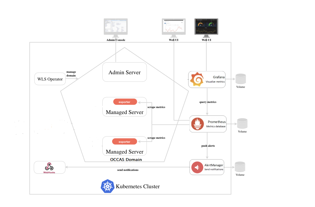

Prometheus and Grafana are optional third-party monitoring tools that you can install to gather metrics on your Converged Application Server installation. When both are installed, Converged Application Server uses the WebLogic Monitoring Exporter to export Prometheus-compatible metrics that are then exposed to Grafana, which visualizes the metrics over time to provide futher insights into the data.
Figure 1-1 Cluster Architecture with Monitoring Tools
Refer to the Prometheus documentation and the Grafana documentation for how to configure and use those products.
