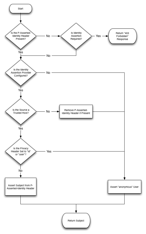

The presence of a P-Asserted-Identity header combined with
the Privacy header also determines the way in which Converged
Application Server proxies incoming requests. The value of the
@SipLogin annotation is also considered.

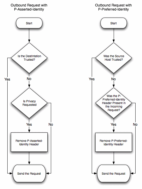

The presence of a P-Asserted-Identity header or a
P-Preferred-Identity header also affects the processing of outbound
SIP requests.
Figure 5-3 Managing Outbound Requests Having P-Asserted-Identity or P-Preferred Identity
