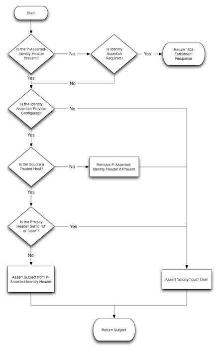

Converged Application Server supports the P-Asserted-Identity SIP header as described in IETF RFC 3325: Private Extensions to the Session Initiation Protocol (SIP) for Asserted Identity within Trusted Networks. This functionality automatically logs in using credentials specified in the P-Asserted-Identity header when they are received from a trusted host. When combined with the privacy header, P-Asserted-Identity also determines whether the message can be forwarded to trusted and non-trusted hosts.
Figure 3-2 Asserted Identity Handling in Converged Application Server
The flowchart illustrates asserted identity handling in Converged Application Server
It is also possible to use Converged Application Server in scenarios that do not involve trusted hosts. See "Standards Alignment" for a more detailed description of Converged Application Server standards compliance.
