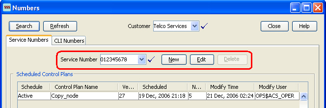

On the relevant tab of the Numbers screen, select the number that scheduling changes are required for, in the Numbers area of the screen.
Description of the illustration acsacsnumbersnumbershighlevel_2-4-2.jpg -

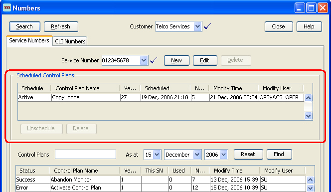

Select an existing scheduled control plan from the Scheduled Control Plans table.
Description of the illustration acsacsnumberscpschedulehighlevel_2-4-2.jpgTip: When you select a scheduled control plan, the control plan is highlighted in the Control Plans table, and the template is highlighted in the Templates table.
The following functions are now available to you on the Scheduled Control Plans frame of the screen, as shown on the example screen above:
Unschedule – Go to step 4 to detach a control plan from the current service.
Delete – Go to Step 5 to remove the selected control plan from the system.
Click Unschedule to detach this control plan from the current service.
Result: The control plan now displays as historical and is therefore no longer scheduled for activity within the current service.
With the control plan selected on the Scheduled Control Plans table, click Delete.
Tip: Only historical control plans are able to be deleted from this table as they are no longer scheduled for activity within the current service.
Warning: Unscheduling all control plans for a service number or CLI number will discontinue processing of calls for that number.
Click Delete to confirm.
