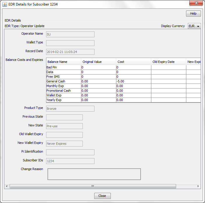

About Auditing Changes to Subscriber Data
The EDR auditing feature enables you to monitor changes to the financial data held for subscribers. When EDR auditing is enabled, a user is forced to enter a reason for changes they make to financial data in a special Change Reason dialog box; for example, when editing a subscriber to:
  • Update the subscriber's wallets
  • End a reservation
  • Reverse charges in the EDR Viewer
The reason for the change, and the user who made the change are reported in the Change Reason, and Operator Name fields in the corresponding VWS EDR. You can view this information by displaying the EDR in the EDR Viewer.
The EDR auditing feature is enabled by the EDR auditing global configuration option. For more information, see the discussion on EDR auditing in Global Configuration .

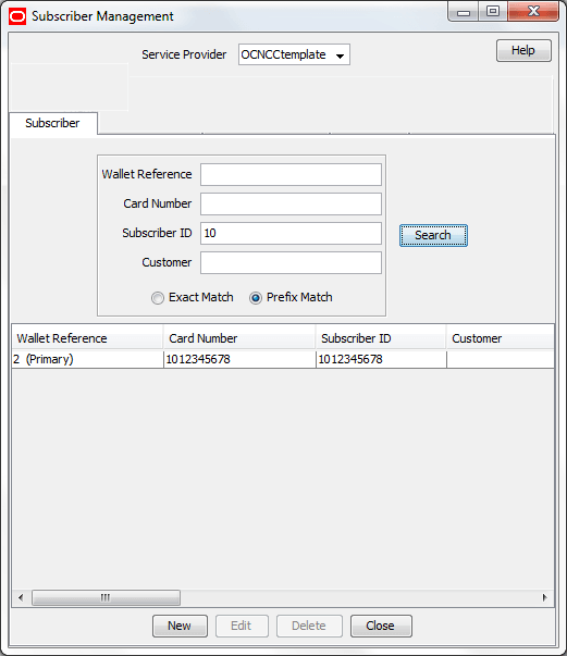

Finding subscribers
Follow these steps to search for an existing subscriber.
Step Action
1 In the Subscriber Management screen, select the service provider from the Service Provider list.
2
On the Subscriber tab, enter the search strings to use to find the required subscriber. Enter the first few characters of the corresponding string in one of the following fields:
  • Wallet Reference
  • Card Number
  • Subscriber ID
  • Customer
Tip: If you enter characters in more than one field, the Search button will be disabled.
3
Specify whether to search for an exact match, or for a prefix match. Select:
  • Exact Match to search for the subscriber with the specified subscriber ID
  • Prefix Match to search for all subscribers with subscriber IDs that match the specified prefix
4
Click Search.
The search returns a maximum of 100 rows. If the required subscriber is not displayed and more than 100 rows were returned, enter a longer search string and click Search again.
Note: If a subscriber has more than one wallet then the search returns additional rows for the subscriber; one for each wallet. The wallet type is displayed next to the wallet reference number.

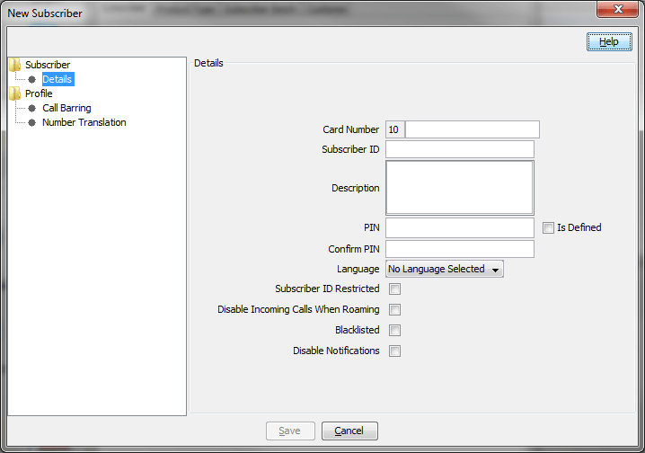

Subscriber Screen Example
Here is an example New Subscriber screen.
Note: The tabs or options available to you on a screen will depend upon which CCS components have been installed on the system and the Oracle license agreement.
This is image alt text.

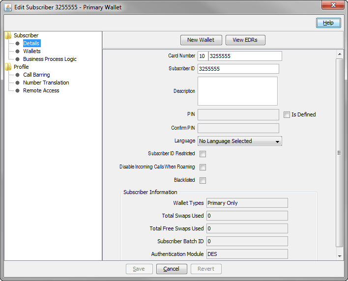

Details
Follow these steps to configure basic details for a new subscriber or edit the details of a current subscriber.
Step Action
2
On the Subscriber tab, to:
  • Create a new subscriber, click New.
  • Edit a subscriber, select the subscriber from the table and click Edit.
Result: You see the New Subscriber screen or the Edit Subscriber screen, with the Subscriber, Details option selected.
3
In the Card Number field, enter the card number for this subscriber. This field is required.
Tip: Most commonly, this is the same as the subscriber ID.
4
In the Subscriber ID field, enter the Calling Line Identifier (CLI) for this subscriber. This identifies the line which the call is being placed from. When a call is made using CCS, the system determines which wallet to charge based on the subscriber ID of the caller. If the subscriber ID is not recognized, the card number and PIN is used to determine the subscriber and validity of the call.
The subscriber ID is mandatory.
5 In the Description field, enter a description for the new subscriber.
6 To add a PIN for this subscriber, select the Is Defined PIN check box. This will enable the PIN and Confirm PIN fields for entry.
7
Skip this step if a PIN is not required for this subscriber.
If a PIN is required, configure the PIN by doing the following:
  1. In the PIN field, enter the PIN number.
  2. In the Confirm PIN field, re-enter the same PIN number. The two fields must match before the new subscriber record can be saved.
To use the PIN, the eserv.config parameter AccountLength must be set to the required length for card numbers, or a large value for variable length card numbers, for example 50, (default = 10).
For more information, see the CCS Technical Guide.
When using the PIN option to recharge vouchers, the length of the Wallet Reference number must equal the AccountLength parameter (that is, variable length wallet references cannot be used).
Tip: A PIN is recommended for security reasons.
8
From the Language drop down box, select the language to use for announcements for this subscriber.
The list displays all languages available to the current service provider. Languages are configured on the Tools screen. To create a new language or give a service provider permission to use a language, see ACS User's Guide.
9 If the subscriber should be allowed to set the presentation restricted indicator in the outgoing connect message for all services other than CCS_ROAM, select the Subscriber ID Restriction check box.
10 If this subscriber should not be able to receive incoming calls while roaming, select the Disable Incoming Calls When Roaming check box.
11
If this subscriber should be:
  • Able to use the service, ensure the Blacklisted check box is not selected.
  • Stopped from using the service, select the Blacklisted check box.
For more information about blacklisted subscribers, see Black List .
12 If the subscriber should not be sent SMS notifications, select the Disable SMS Notifications check box.
13
Select another option to configure for this subscriber or click Save.
Note: When you save a new subscriber, you will see the New Wallet screen. See Wallets for more information.

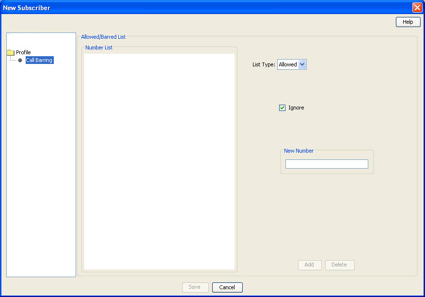

Call Barring
Follow these steps to add or edit call barring configuration details for a subscriber.
Note: Allowed/barred lists can also be configured at the following levels:
  • System-wide
  • Service provider (see the Barred List tab)
  • Product type (see Call Barring option).
Step Action
1
In the New or the Edit Subscriber screen, select the Profile, Call Barring option from the left hand menu.
Result: You see the Call Barring (See example) configuration option fields.
2
In the Allowed/Barred List section, select whether the listed numbers will be allowed or barred from the List Type drop down list.
Tip: Depending on the list type, all numbers in the list are allowed, or all numbers are barred for this subscriber. It is not possible to have some allowed and some barred numbers in the list.
3 If you want the service to ignore the allowed/barred list for this subscriber, select the Ignore check box.
4 To add a number to the list, enter the number in the New Number field and click Add.
5 To delete a number from the list, select it in the Number List and click Delete.
6 Repeat steps 4 and 5 as required to complete the number list.
7
Note: When you save a new subscriber, you will see the New Wallet screen. Refer to Wallets to finish configuring the new subscriber.
Call Barring option
Here is an example New Subscriber screen, Call Barring option.
.This is image alt text.

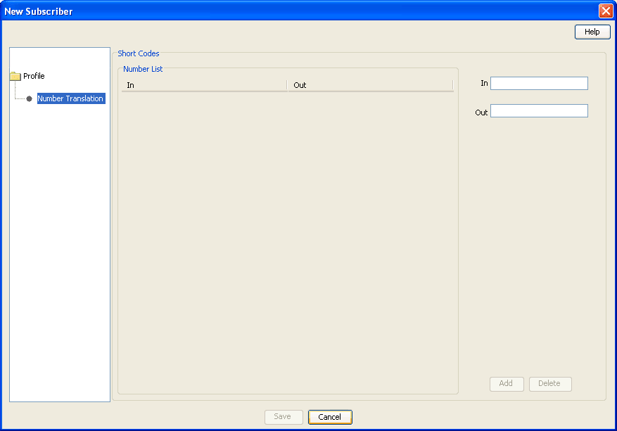

Number Translation
Follow these steps to add the number translation details to a new subscriber.
Note: Number translation can also be configured at the following levels:
  • System-wide
  • Service provider
  • Product type.
Step Action
1
In the New Subscriber screen, select the Profile, Number Translation option from the left hand menu.
Result: You see the Number Translation (See example) configuration option fields.
2
In the Short Codes section, edit the number list.
  • To add a number to the list:
  • In the In field, enter the service short code to translate
  • In the Out field, enter the termination number to translate the short service code to
  • Click Add
  • To delete a number from the list:
  • Select the number in the Number list
  • Click Delete
3 Repeat step 2 until the number list contains all the required numbers.
4
Note: When you save the new subscriber, you will see the New Wallet screen. Refer to Wallets to finish configuring the new subscriber.
Here is an example New Subscriber, Number Translation option.

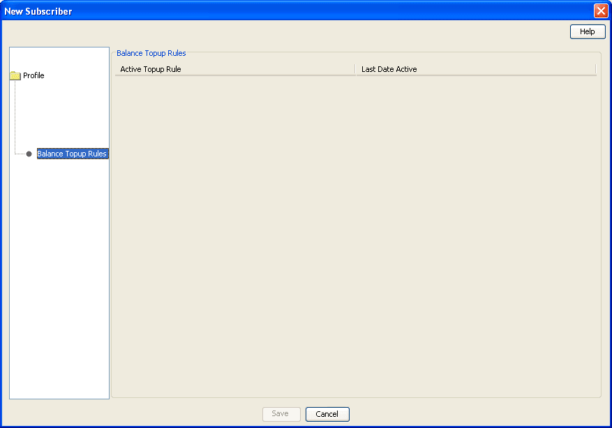

Balance Topup Rules
The Balance Topup Rules option lets you view the active topup rules defined for the subscriber, and when they were last activated. The rules are used to allocate additional items, such as additional notifications, to specified balance types on a regular basis. For details on creating and activating balance topup rules, see CCS Technical Guide.
Follow these steps to view the active balance topup rules for a subscriber.
Step Action
1
In the New or the Edit Subscriber screen, select the Balance Topup Rules option from the left hand menu.
Result: You see the Balance Topup Rules (See example ) configuration option.
2
Here is an example New Subscriber screen, Balance Topup Rules option.

Editing Subscribers
Introduction
The Edit Subscriber screen allows you to edit a subscriber's configuration and profile configuration options.
From this screen you can also:
  • Record subscriber comments
  • Configure subscriber zones
  • Edit wallets
  • Change wallet balance adjustment limits
  • View EDRs
  • Execute business process logic
  • View subscriber promotions
  • Perform credit transfers
If the Convergent Charging Controller EDR auditing feature is enabled, and you update the financial data for a subscriber; for example, by updating their wallets, then you will be required to record the reason for the change when you save the subscriber record. For more information, see About Auditing Changes to Subscriber Data.
Edit subscriber screen layout
The configuration and layout for the Edit Subscriber screen is defined in the Subscriber Profile Manager (SPM). When you open the Edit Subscriber screen, the fields and options you see depend on the configuration defined in the SPM for the subscriber's product type and service provider (see following screen example). This means that you may see one of the following:
  • The default configuration for the Edit Subscriber screen containing all the fields and options available as a standard
  • A customized Edit Subscriber screen containing a subset of the standard fields and options, plus any subscriber profile groups, fields and zones that have been configured specifically for you. The labels given to the fields and options may also be different from the default labels
You see the available options listed in the menu on the left hand side of the screen. To view or edit the fields for a particular option, select the option in the list.
Note: For information on configuring the Edit Subscriber screen, refer to Subscriber Profile Manager User's Guide.
Example Edit Subscriber screen
Here is an example Edit Subscriber screen configured to show subscriber details when the Details option is selected.
Access to elements of this screen are controlled by user permissions. If you cannot see some of the functionality described for this screen, your permissions may have been set to restrict access to that element.
Reverting unsaved changes
You can revert any unsaved changes to a subscriber's configuration by clicking Revert. The data will revert to the most recently saved version of the subscriber's configuration.
For details see Reverting subscriber edits .
Subscriber details fields
This table describes the function of the standard subscriber details fields that may be available in the Edit Subscriber screen.
Note: Some of these fields may have been given different labels in your screens depending on how the Edit Subscriber screen has been configured.
Field Description
Card Number Specifies the card number for the subscriber.
Subscriber ID The Calling Line Identifier (CLI) for this subscriber. This identifies the line that the call is being placed from. When a call is made, the system determines which wallet to charge based on the subscriber ID of the caller.
Description A description for this subscriber.
Is Defined Either removes a subscriber's PIN (unselected), or enables adding or editing a subscriber's PIN (selected)
PIN Sets the subscriber's PIN (Is Defined must be selected).
Confirm PIN Confirmation of the subscriber's PIN (Is Defined must be selected).
Language Sets the language to use for announcements for this subscriber.
Subscriber ID Restricted Sets whether or not the subscriber may set the presentation restricted indicator in the outgoing connect message for services. For further information refer to CCS User's Guide.
Disable Incoming Calls When Roaming Sets whether or not the subscriber may receive incoming calls while roaming.
Blacklisted
Sets whether or not the subscriber may use the service. When selected, the service will be disabled.
For more information about blacklisted subscribers, see Adding Subscribers .
Disable SMS Notifications Sets whether or not the subscriber may receive SMS notifications.
Subscriber Information Core information about the subscriber. For information purposes only.
Editing subscriber configuration
Follow these steps to edit the configuration for an existing subscriber.
Step Action
2 On the Subscriber tab, search for the subscriber to edit. For details see Finding subscribers .
3
Select the row in the search results for the subscriber to edit.
Note: If the subscriber has both a primary and a secondary wallet, there will be a row in the search results for each wallet. The wallet type is displayed next to the wallet reference number. Select the row for the wallet type to edit.
4
Click Edit.
Result: You see the Edit Subscriber screen with the wallet type indicated in the screen title bar.
5 Edit the subscriber details fields as required. See Editing configuration options .
6 Edit the subscriber profile options as described in Adding Subscribers .
7 Edit the wallets for the subscriber as required. See Edit Wallets .
8 Run business process logic actions as required. See Run Business Process Logic .
9 Perform credit transfers as required. See Perform Credit Transfers.
10 Click Save.
11
If EDR auditing is enabled and you have changed the financial status of the subscriber, then the Change Reason dialog displays. Enter the reason for the change in the Change Reason field, and click OK. The reason can be up to 200 characters long.
See About Auditing Changes to Subscriber Data for more information.

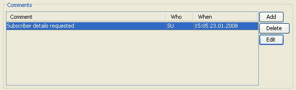

Comments panel
Here is an example Comments panel in the Edit Subscriber screen.
Adding a comment
Follow these steps to add a comment to a Subscriber record.
Step Action
1 On the left hand panel in the Edit Subscriber screen, select the option containing the Comments panel.
2 Click Add.
Result: You see the Add Comment screen.
3 In the Comment Text field type in your comment. The comment can be up to 50 characters long.
4
Click Save.
Result: You are returned to the Edit Subscriber screen

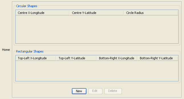

Zone group
Zones are defined in zone group panels in the Edit Subscriber screen. A zone group panel can be included where needed using the Subscriber Profile Manager.
Zone group panel
Here is an example zone group panel.
Adding a new zone shape
Follow these steps to add a new shape to a zone.
Step Action
1 In the Edit Subscriber screen, select the option that holds the zone to add a shape to.
2
In the group for the zone, click New.
Result: You see the New Zone screen. (See example )
3
Select the option for the zone shape, select one of:
  • Circular Shapes
  • Rectangular Shapes
4
If you are specifying a circular zone shape, in the boxes enter the coordinates for the center of the circle and its radius.
  • X (Deg): The longitude coordinate. Restricted to between -179.99999 (W) and 180.00000 (E) degrees.
  • Y (Deg): The Latitude coordinate. Restricted to between -90.00000 and 90.0000 degrees.
  • R (Kms): The radius. Restricted to between 0.0000000 and 99999999.9999999 kilometers.
5
If you are specifying a rectangular zone shape, enter the coordinates for the top left and bottom right corners of the rectangle.
Top-Left Corner:
  • X (Deg): The longitude west coordinate. Restricted to between -179.99999 (W) and 180.00000 (E) degrees and must not equal the value for the longitude east coordinate.
  • Y (Deg: The latitude north coordinate. Restricted to between -90.00000 and 90.0000 degrees and must be a higher number than the latitude south coordinate.
Bottom-Right Corner:
  • X (Deg): The longitude east coordinate. Restricted to between -179.99999 (W) and 180.00000 (E) degrees and must not equal the value for the longitude west coordinate.
  • Y (Deg: The latitude south coordinate. Restricted to between -90.00000 and 90.0000 degrees and must be a lower number than the latitude north coordinate.
6 Click Save.
Zone screen
Here is an example Zone screen.

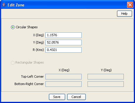

Editing a zone shape
Follow these steps to edit a Zone shape.
Step Action
1 In the Edit Subscriber screen, select the option where the zone to edit is defined.
2
In the zone group select the shape to edit and click Edit.
Result: You see the Edit Zone screen (See example ).
3 Edit the shape definition as described in Adding a new zone shape .
4 Click Save.
Deleting a zone shape
Follow these steps to delete a Zone shape.
Step Action
1 In the Edit Subscriber screen, select the option where the zone shape to delete is defined.
2
In the zone group select the shape to delete and click Delete.
Result: The zone shape is deleted.

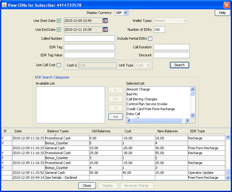

View EDRs
Introduction
From the Edit Subscriber screen you can search for and view the EDRs that have been generated for the subscriber. For each EDR you can:
  • View the EDR details
  • Reverse any associated charges
If the EDR auditing feature is enabled, then you can monitor operator updates to a subscriber's financial data by viewing the reason entered by the operator for any updates that have been made through the Subscriber Management screens. The reason displays in the Change Reason field in the resulting EDR. For more information, see About Auditing Changes to Subscriber Data.
View EDRs for Subscriber screen
Here is an example View EDRs for Subscriber screen. This screen appears when you click View EDRs in the Edit Subscriber screen.

View EDRs for Subscriber fields
This table describes the function of each field.
Field Description
Use Start Date
If Use Start Date check box is selected, EDRs that have been generated after a specified date and time will be displayed.
Note: The start date field is populated with the current date and time. Select a different date and time if required. For details, see Time and Date panels.
Use End Date
If Use End Date check box is selected, EDRs that have been generated before a specified date and time will be displayed.
Note: The end date field is populated with the current date and time. Select a different date and time if required. For details, see Time and Date panels.
Wallet Types
The type of wallet for which the EDRs will be displayed.
The options are:
  • Primary
  • Secondary
Number of EDRs The maximum number of EDRs to search for. This can be left blank to find all the EDRs.
Called Number A specific called party number dialed by the subscriber for which the EDRs will be displayed. This value is derived from the TN field of the resulting EDR.
EDR Tag The operator defined EDR tag.
EDR Tag Value The tag values of the EDRs describe the type and length of data required, and a description of the value per EDR.
Include Partial EDRs By default only completed EDRs are shown. Select this box to also show intermediate partial EDRs.
Call Duration The duration of the entire call, that is, the length of call in seconds. This value is derived from the DURATION field of the resulting EDR.
Discount
A list of discounts that exist for this call. This value is derived from the following fields of the resulting EDR:
  • DISCOUNT,
  • DISCOUNTS
  • CBTD_DISCOUNTS
Unit Type
The balance unit type for which the call cost is displayed. This is one of:
  • Cash
  • Time
  • Units
Call Cost
The call cost is based on the sum of all the associated costs (recharge or charge) for a specified balance unit type for the call. This value is derived from the COSTS field of the resulting EDR.
Note: The cost for a recharge will be a negative value; the cost for a charge will be a positive value.
Finding EDRs
Follow these steps to find the EDRs that have been generated for a subscriber.
Note: The view EDRs panel is now pre-populated with default search conditions for the current subscriber. The search parameters are defined in smsGui.bat/smsGui.sh and ccpGui.bat/ccpGui.sh files. If no parameters are defined, search defaults to 2 days and all categories.
Step Action
1
In the Edit Subscriber Screen, click View EDRs.
Result: You see the View EDRs for Subscriber screen (See example ) for the current subscriber, pre-populated with default search results.
Note: If no parameters are found, this defaults to two days and all categories.
2
Enter the desired search criterion.
For more information about the fields on this screen, see View EDRs for Subscriber fields.
3
Add the EDR Search Categories to search for to the Selected List. To:
  • Add a search category to the list, select it in the Available List and click >.
  • Add all the search categories to the list, click >>.
  • Remove a search category from the list, select it in the Selected List and click <.
  • Remove all the search categories from the list, click <<.
Note: If no search categories are selected then all the EDRs that match the search criteria will be returned.
4
Click Search.
Result: All the EDRs that match the search criteria are displayed in the EDR search results table at the bottom of the screen.
Tip: The text See Details in the Balance Types column indicates either that more than one balance type was used to charge for that EDR or that no charge was made and hence you must go into the details of the EDR itself.

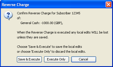

Reversing a charge
Follow these steps to reverse a charge detailed in an EDR record.
Step Action
1 In the EDRs for Subscriber screen, search for the EDR record to reverse. For details on searching for EDRs see Finding EDRs.
2 Highlight the record in the search results table.
3
Click Reverse Charge.
Result: You see the Reverse Charge prompt.
4
Do one of the following:
  • If you want to reverse the charge without saving any updates to the subscriber configuration, click Run Only.
  • If you want to save the updates you have made to the subscriber configuration, and then reverse the charge, click Save & Run.
5 If you clicked Save & Run, and EDR auditing is enabled, then the Change Reason dialog displays. Enter the reason for the change in the Change Reason field, and click OK. The reason can be up to 200 characters long.
6
Click OK when the Reverse Charge prompt displays.
The charge is reversed for all the affected balance types and the subscriber data is reloaded. You are then returned to the Edit Subscriber screen.

EDR Details for Subscriber screen
Here is an example EDR Details for Subscriber screen.

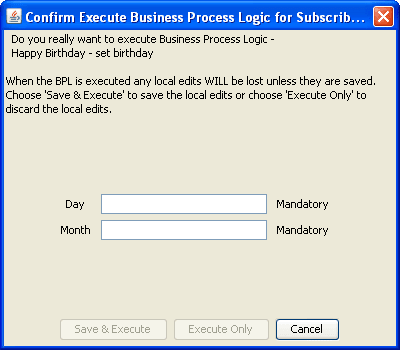

Executing a BPL
Follow these steps to run a BPL for a subscriber.
Note: BPLs can only be run for existing subscribers.
Step Action
1
In the Edit Subscriber screen select the Subscriber option where the BPL to run is located.
Result: You see a button for each of the available BPLs.
2
Click the button for the BPL to run.
Result: You see the Confirm Run Business Process Logic for Subscriber prompt.
3
If any parameters have been defined for the BPL, enter values for these as prompted.
Warning: You must enter a value for all mandatory parameters.
4
To save any changes you have made to the subscriber configuration in the Edit Subscriber screens and then run the BPL, click Save & Run.
To run the BPL without saving changes to the subscriber configuration, click Run Only.
  Result: You see the Run BPL Result prompt.
5 Click OK.

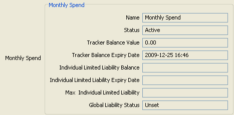

Promotion Info Field example
Here is an example Promotion Info Field in the Edit Subscriber screen. This field has been configured with the Monthly Spend Display Name.
Promotion info field fields
The Promotion Info Field displays status, balance and expiry details for a specified promotion. The promotion is specified when the Promotion Info Field is configured in the Subscriber Profile Manager.
Field Description
Name Promotion name.
Status Promotion status. Either active or inactive.
Tracker Balance Value The total value of the tracker balance used to trigger the promotion for the subscriber.
Tracker Balance Expiry Date
Displays the first expiry date for the tracker balance. If an expiry date has not been specified, then "Does not expire" will be displayed.
Note: This field will only be visible if the Show Expiry Date check box was selected when this Promotion Info Field was configured in the SPM.
Individual Limited Liability Balance The subscriber's total balance held in the limit balance type configured for the promotion.
Individual Limited Liability Expiry Date Displays the first expiry date for the individual limited liability balance. If an expiry date has not been specified, then Does not expire will be displayed.
Max Individual Limited Liability Maximum individual limited liability configured for the promotion.
Global Liability Status
The options are
  • Unset
  • Eligible
  • Not Eligible
