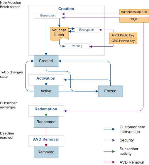

Voucher Life Cycle
This diagram shows the life cycle of a voucher.
Voucher batches have a slightly different life cycle.
Figure 1-1 Voucher Life Cycle
Voucher States
Here is the list of voucher and voucher batch states:
  • Created
  • Active
  • Frozen
When you create a voucher batch the batch state is set to Created. You must set the batch state to Active if you want to redeem the vouchers in the batch. You may also need to set the state of each voucher within the batch to Active.
A voucher may only be redeemed if it is in an active state and the voucher batch it belongs to is also in an active state.
