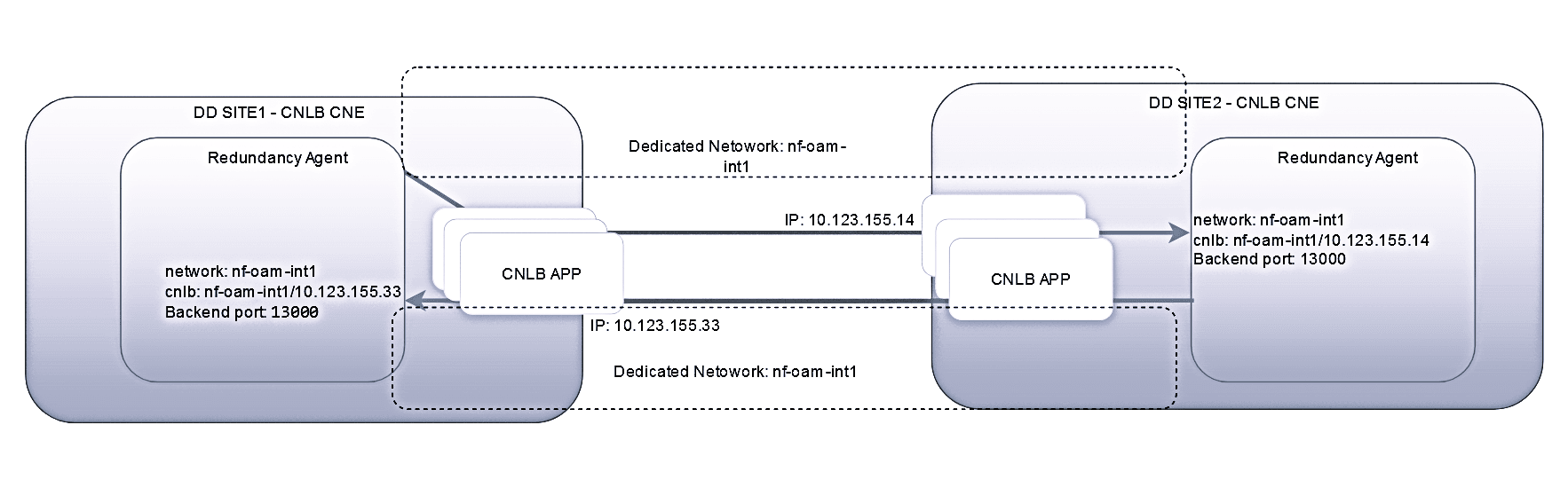

11.1.4 Enabling External IPs for the Redundancy Agent via CNLB
In the two-site redundancy feature, two Redundancy Agents communicate with each other to sync configuration based on the redundancy configuration. If one or both sites are deployed in a CNLB CNE environment, the Redundancy Agents must be enabled for CNLB to provide external access. In this case, network and CNLB annotations need to be configured in the Redundancy Agents as well. The Redundancy Agents use the ingress NAD with a single network for ingress communication and external access.
Refer to the following scenarios for deploying redundancy agents across two sites:
a) Both sites are deployed in the CNLB-enabled cluster
The following points should be considered:The two sites should have the same name for the egress NAD definitions, else the consumer adapter may stop processing the data if the NAD name is not present in the site.
b) One site is deployed in the CNLB-enabled cluster, and the other in an LBVM-based CNE cluster
The following points should be considered:- The bi-directional configuration sync will not work if the primary site is CNLB enabled and secondary site is not CNLB enabled. In this case on the primary site, the consumer adapter feed configuration should be modified to include the NAD name in the feed.
- Discrepancy alarm is expected when the configuration sync is unidirectional and Primary site is CNLB enabled and Secondary site is non CNLB.
c) Both sites are deployed in an LBVM-based CNE cluster
Skip to the section "Enable Two-Site Redundancy Support" to continue with enabling the two-site redundancy feature in the Data Director.
11.1.4.1 Enabling CNLB in the Redundancy Agent
In the Primary Site (Site 1):
If the Redundancy Agent (RA) in the Data Director is deployed within a CNLB CNE environment, follow the steps below:
Step 1: Extract the Network and NAD Information for the Ingress-Egress NAD
Caution:
The script/var/occne/cluster/$OCCNE_CLUSTER/artifacts/cnlbGenAnnotations.py
can be run by a user with admin privileges or the root user.
- Either get the necessary admin privileges from the cluster administrator before running the step below.
- Or have the command executed by an admin user and note down the output, which will be used in Step 2.
Extract NADs:
- Run the script
in CNE to fetch the available ingress-egress network information as per the inputs provided (Network Name: OAM, Segregation Type: INT, Network Type: SN, and Port Name: any value likehttp,8080
).# python3 /var/occne/cluster/$OCCNE_CLUSTER/artifacts/cnlbGenAnnotations.py
Example inputs and outputs:
# python3 /var/occne/cluster/$OCCNE_CLUSTER/artifacts/cnlbGenAnnotations.py Network Names that application will use? Valid Choice example - oam OR comma seperated values - oam,sig,sig1 = oam Application pod external communication ? Valid choice - IE(Ingress/Egress) , EGR(Egress Only), INT(Ingress Only) = INT Pod ingress network type ? Valid choice - SI(Single Instance -DB tier only) , MN(Multi network ingress / egress) , SN(Single Network) = SN Provide container ingress port name for backend from pod spec , external ingress load balancing port? Valid choice - Example (http,80) = http,80 ... ... ------------------------------------------------- Pod network attachment annotation , add to application pod spec ------------------------------------------------- k8s.v1.cni.cncf.io/networks: default/nf-oam-int7@nf-oam-int7 oracle.com.cnc/cnlb: '[{"backendPortName": "http", "cnlbIp": "10.121.44.138","cnlbPort": "80"}]'
Step 2: Update the ocnadd-custom-values.yaml
- Copy the
cnlbIp
andnetworks
values from the script output and update theocnadd-custom-values.yaml
file as shown below:cnlb.redundancyagent.enabled: true cnlb.redundancyagent.network: "default/nf-oam-int7@nf-oam-int7" cnlb.redundancyagent.externalIPs: "10.121.44.138"

If the Redundancy Agent (RA) in the Data Director is deployed in an LBVM CNE environment, skip the steps below and follow the Enable Two-Site Redundancy Support section to continue with enabling the two-site redundancy feature.If the Redundancy Agent (RA) in the Data Director is deployed within a CNLB CNE environment, follow the steps below:
Step 1: Extract the Network and NAD Information for the Ingress-Egress NADCaution:
The same script/var/occne/cluster/$OCCNE_CLUSTER/artifacts/cnlbGenAnnotations.py
- Either obtain admin privileges from the cluster administrator before running the script.
- Or have the command executed by an admin user and note down the output for use in Step 2.
Extract NADs:
- Run the script
in CNE to fetch the available ingress-egress network information (similar inputs as in the primary site).# python3 /var/occne/cluster/$OCCNE_CLUSTER/artifacts/cnlbGenAnnotations.py Network Names that application will use? Valid Choice example - oam OR comma separated values - oam,sig,sig1 = oam Application pod external communication ? Valid choice - IE(Ingress/Egress) , EGR(Egress Only), INT(Ingress Only) = INT Pod ingress network type ? Valid choice - SI(Single Instance -DB tier only) , MN(Multi network ingress / egress) , SN(Single Network) = SN Provide container ingress port name for backend from pod spec , external ingress load balancing port? Valid choice - Example (http,80) = http,9188 ... ... ------------------------------------------------- Pod network attachment annotation, add to application pod spec ------------------------------------------------- k8s.v1.cni.cncf.io/networks: default/nf-oam-int7@nnf-oam-int7 oracle.com.cnc/cnlb: '[{"backendPortName": "http", "cnlbIp": "10.121.44.138","cnlbPort": "9188"}]'
- Copy the
cnlbIp
andnetworks
file as shown below:cnlb.redundancyagent.enabled: true cnlb.redundancyagent.network: "default/nf-oam-int7@nf-oam-int7" cnlb.redundancyagent.externalIPs: "10.123.155.34" global.deployment.primary_agent_ip: 10.10.10.10 ====> should be updated with ip 10.123.155.33 as extracted from CNLB on the primary site
Step 3: Follow the procedure in the section Enable Two-Site Redundancy Support to continue enabling the two-site redundancy feature in the Data Director.
