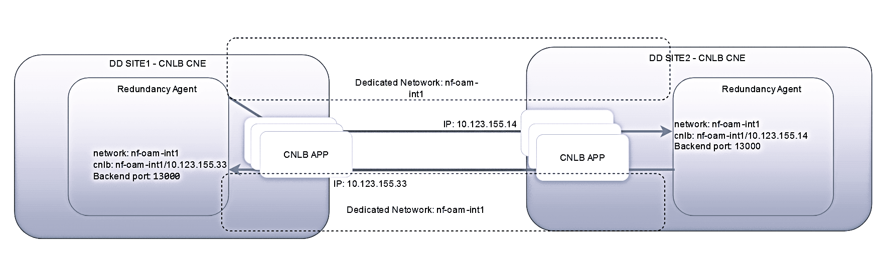

a) Both sites are deployed in the CNLB-enabled cluster
Both the sites in the CNLB enabled cluster
Follow the procedure to enable CNLB in the Redundancy Agent on both sites.
The following points should be considered:
The two sites should have the same name for the egress NAD definitions, else the consumer adapter may stop processing the data if the NAD name is not present in the site.

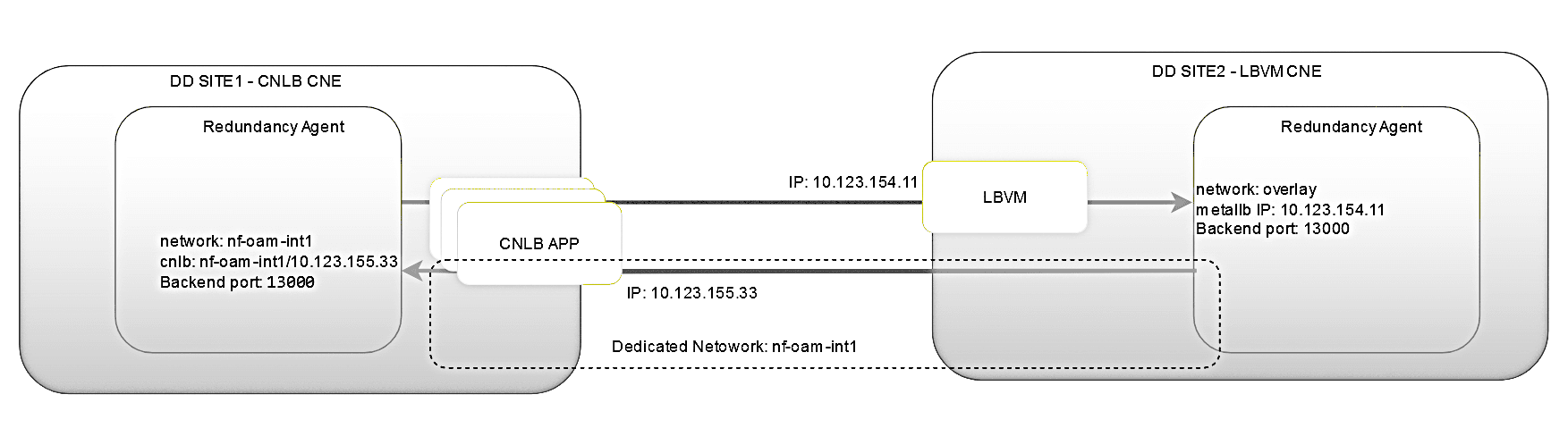

b) One site is deployed in the CNLB-enabled cluster, and the other in an LBVM-based CNE cluster
Only one site in the CNLB enabled cluster
Follow the procedure to enable CNLB in the Redundancy Agent.
  • The bi-directional configuration sync will not work if the primary site is CNLB enabled and secondary site is not CNLB enabled. In this case on the primary site, the consumer adapter feed configuration should be modified to include the NAD name in the feed.
  • Discrepancy alarm is expected when the configuration sync is unidirectional and Primary site is CNLB enabled and Secondary site is non CNLB.
