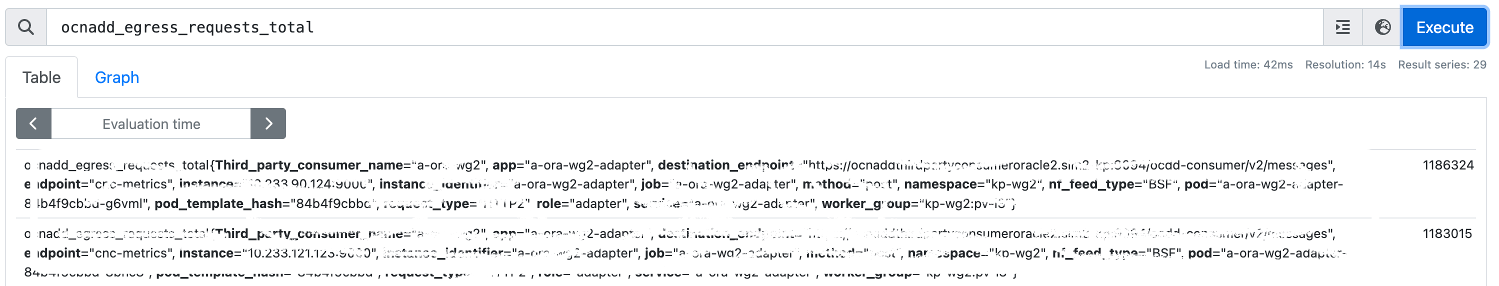

ocnadd_egress_requests_total
This metric will be pegged as soon as the request reaches the ocnadd egress adapter.
This metric peg count of total request which has to be forwarded to third party. This metric is used for the Egress MPS at DD.
Metric Type: Counter
  • method
  • instance_identifier
  • nf_feed_type
  • request_type
  • Third_party_consumer_name
  • worker_group
  • destination_endpoint

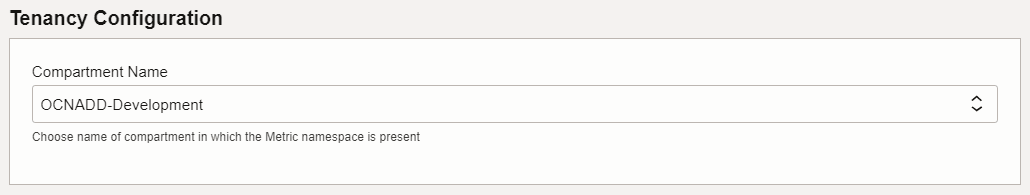

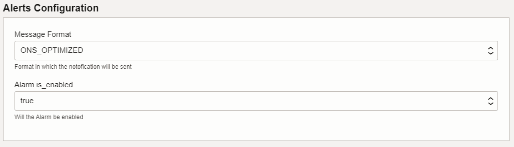

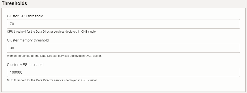

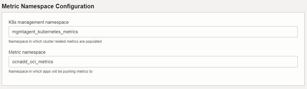

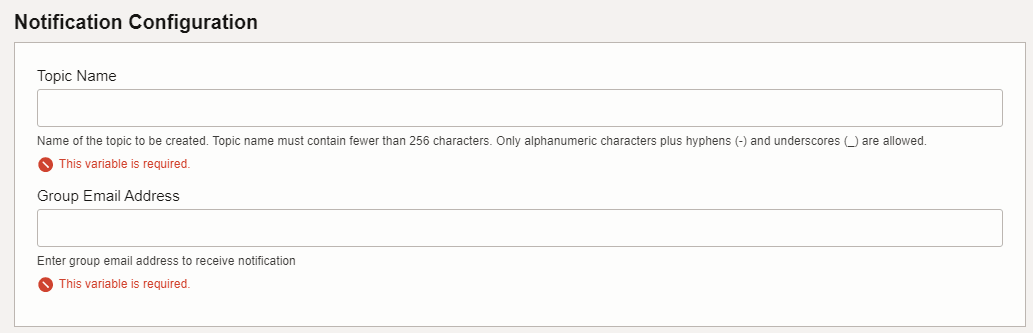

  3. Provide appropriate values for the parameters requested in the Terraform script as shown in the following screenshots:
    Tenancy Configuration
    Metric Namespace Configuration
    Notification Configuration
    Alerts Configuration
    Thresholds

  2. Notification and Topic Setup: During the execution of the Terraform script, notifications and topics for the alerts will be automatically created.

    2. Edit the chart files at the specified locations (paths mentioned in the table below) to include the same Prometheus annotations, ensuring changes persist during upgrades.
    3. Verification of Changes:
      1. Run the following to verify annotations are applied:
        kubectl describe deployments.apps -n <namespace> app-1-adapter | grep "prometheus"
        Expected Output:
        Annotations:      prometheus.io/path: /actuator/prometheus
                          prometheus.io/port: 9000
                          prometheus.io/scrape: true
      2. Verify metrics availability in Prometheus.
        Verify metrics on prometheus.

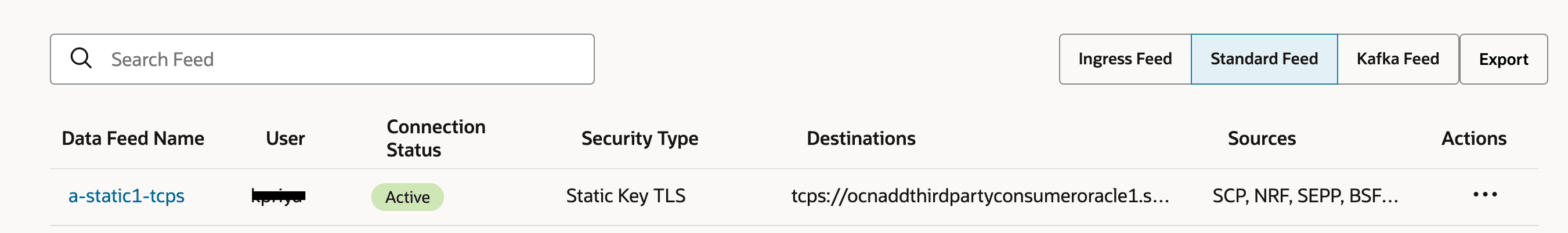

      3. Confirm "ACTIVE" status of feeds on the DD UI when traffic is successfully flowing.
