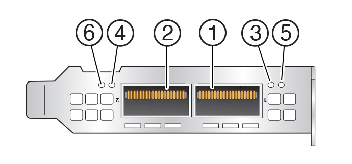

Mellanox ConnectX-6 Dx SmartNIC Status Indicators
The Mellanox ConnectX-6 Dx Dual Port RoCE SmartNIC status indicators are defined as follows:
| Callout | Description |
| 1 | Port 1 |
| 2 | Port 2 |
| 3 | Port 1 status indicator: OFF = Link has not been established SOLID GREEN = Valid link has been established BLINKING GREEN = Link activity BLINKING AMBER = 1 Hz blink indicates a beacon command is being run to locate the adapter card; 4 Hz blink indicates a problem with the physical link |
| 4 | Port 2 status indicator:OFF = Link has not been established SOLID GREEN = Valid link has been established BLINKING GREEN = Link activity BLINKING AMBER = 1 Hz blink indicates a beacon command is being run to locate the adapter card; 4 Hz blink indicates a problem with the physical link |
| 5 & 6 | Not used. |

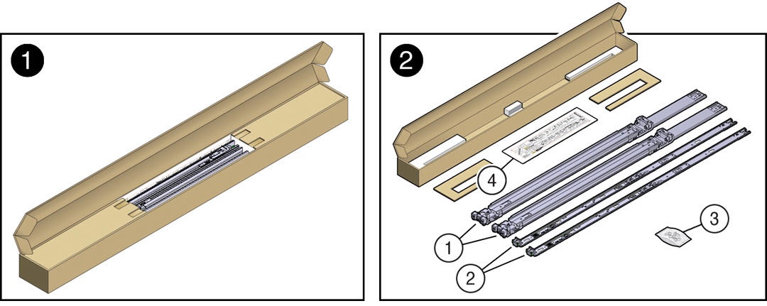

Rackmount Kit Contents
The following figure shows the Rackmount Kit contents. For additional instructions on how
to install your server in a four-post rack using the slide-rail and cable management arm
options, refer to the Rackmounting Template.
| Call Out | Description |
| 1 | Slide-rails |
| 2 | Mounting brackets |
| 3 | Four M4 x 5 fine-pitch mounting bracket securing screws (optional) |
| 4 | Rackmounting Template |

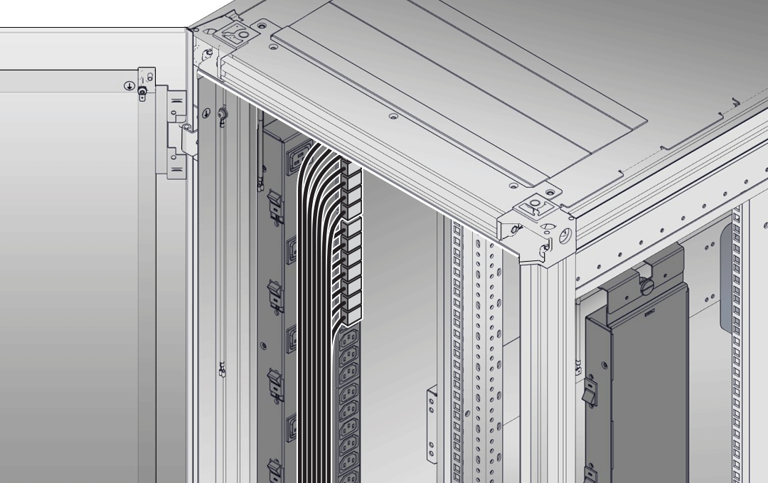

Stabilize the Rack
Refer to your rack documentation for detailed instructions for the following steps.
Open and remove the front and back doors from the rack cabinet, only if they impinge on the mounting bay.
To prevent the rack cabinet from tipping during the installation, fully extend the rack cabinet anti-tilt bar, which is located at the bottom front of the rack cabinet.
If the rack includes leveling feet beneath the rack cabinet to prevent the rack from rolling, extend these leveling feet fully downward and lock to the floor.
Related Rack Documentation

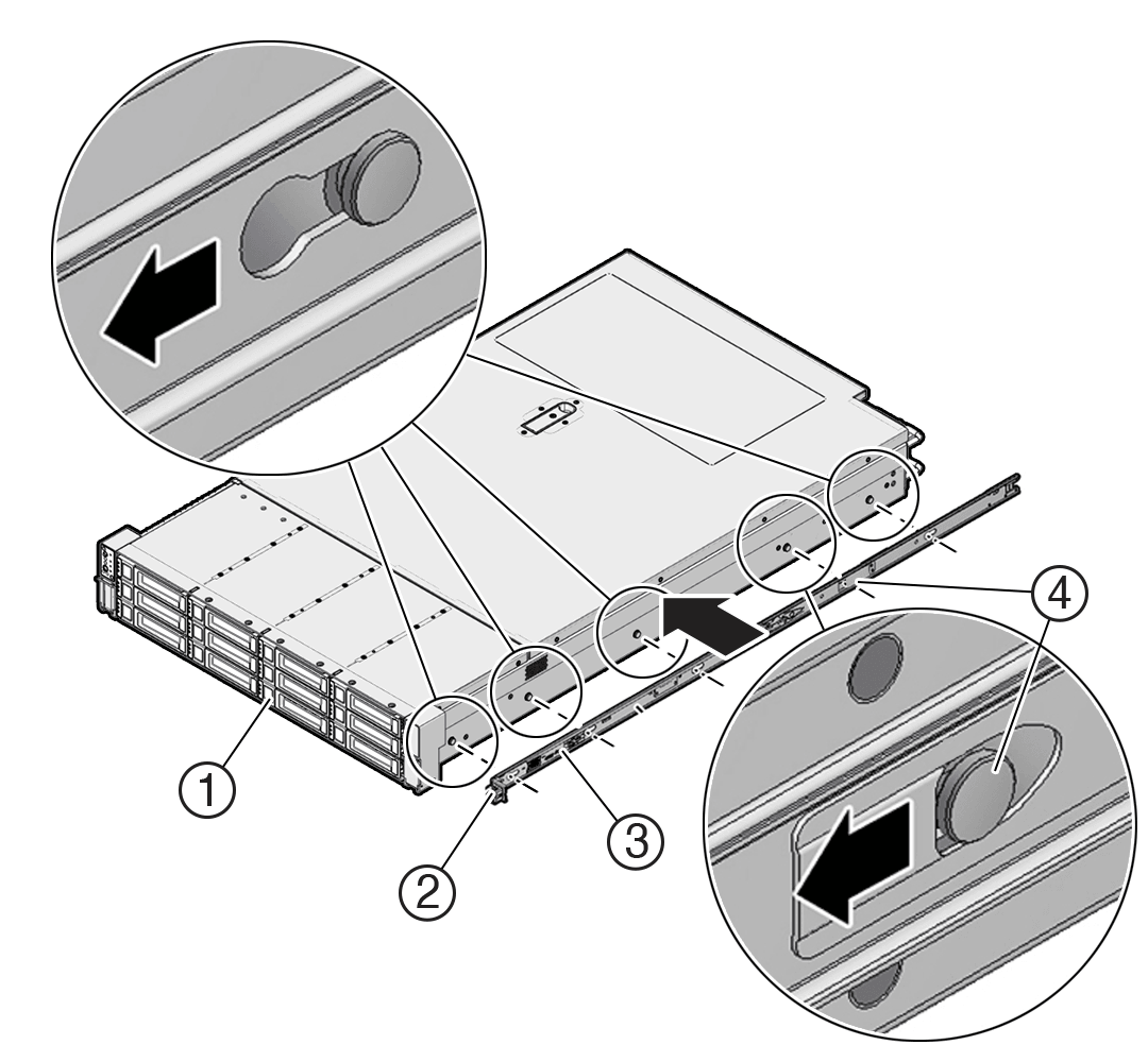

Install Mounting Brackets on the Server
To install the mounting brackets on the sides of the server:
Position a mounting bracket against the chassis so that the slide-rail lock is at the server front, and the five keyhole openings on the mounting bracket are aligned with the five locating pins on the side of the chassis.
Call Out Description 1 Chassis front 2 Slide-rail lock 3 Mounting bracket 4 Mounting bracket clip -
When the heads of the five chassis locating pins protrude through the five keyhole openings in the mounting bracket, pull the mounting bracket toward the front of the chassis until the mounting bracket clip locks into place with an audible click.
Verify that the back locating pin is engaged with the mounting bracket clip.
Repeat Step 1 through Step 3 to install the other mounting bracket on the other side of the server.

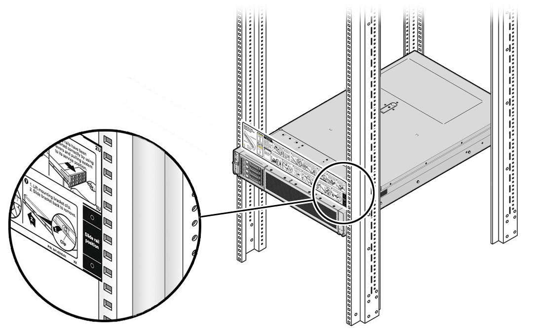

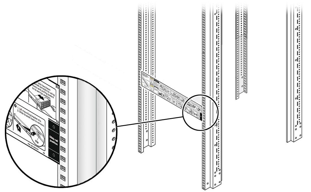

Mark the Rackmount Location
Identify the location in the rack where you want to place the server. Oracle Server E6-2L requires two rack units (2U). Use the Rackmounting Template to identify the correct mounting holes for the slide-rails.
Ensure that there is at least two rack units (2U) of vertical space in the rack cabinet to install the server. See Rack Compatibility.
Place the Rackmounting Template against the front rails, and measure up from the bottom of the Rackmounting Template. The bottom edge of the Rackmounting Template card corresponds to the bottom edge of the server.
Mark the mounting holes for the front slide-rails.
Mark the mounting holes for the back slide-rails.
Install AC Power Cables and Slide-Rails
Before you install the slide-rails into the rack, install server right-angle AC power cables into the left-side and right-side PDU electrical sockets. Use part number 7079727 - Pwrcord, Jmpr, Bulk, SR2, 2m, C14RA, 10A, C13, 2-meter, right-angle AC power cable for this procedure.
Install the slide-rails into the rack. See Attach the Slide-Rails.

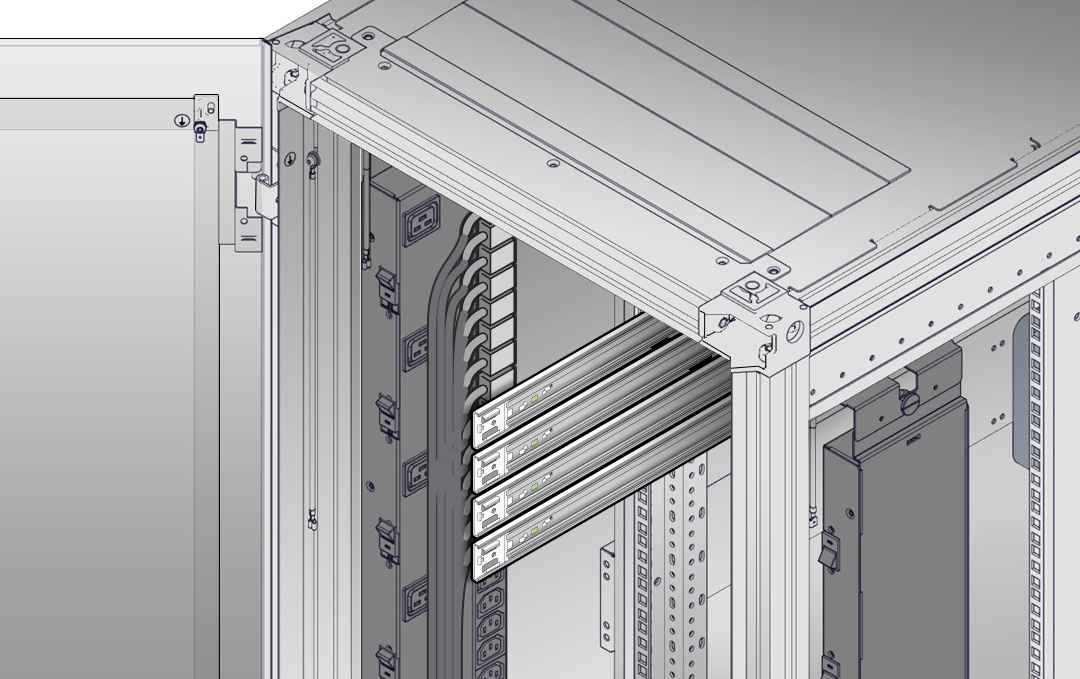

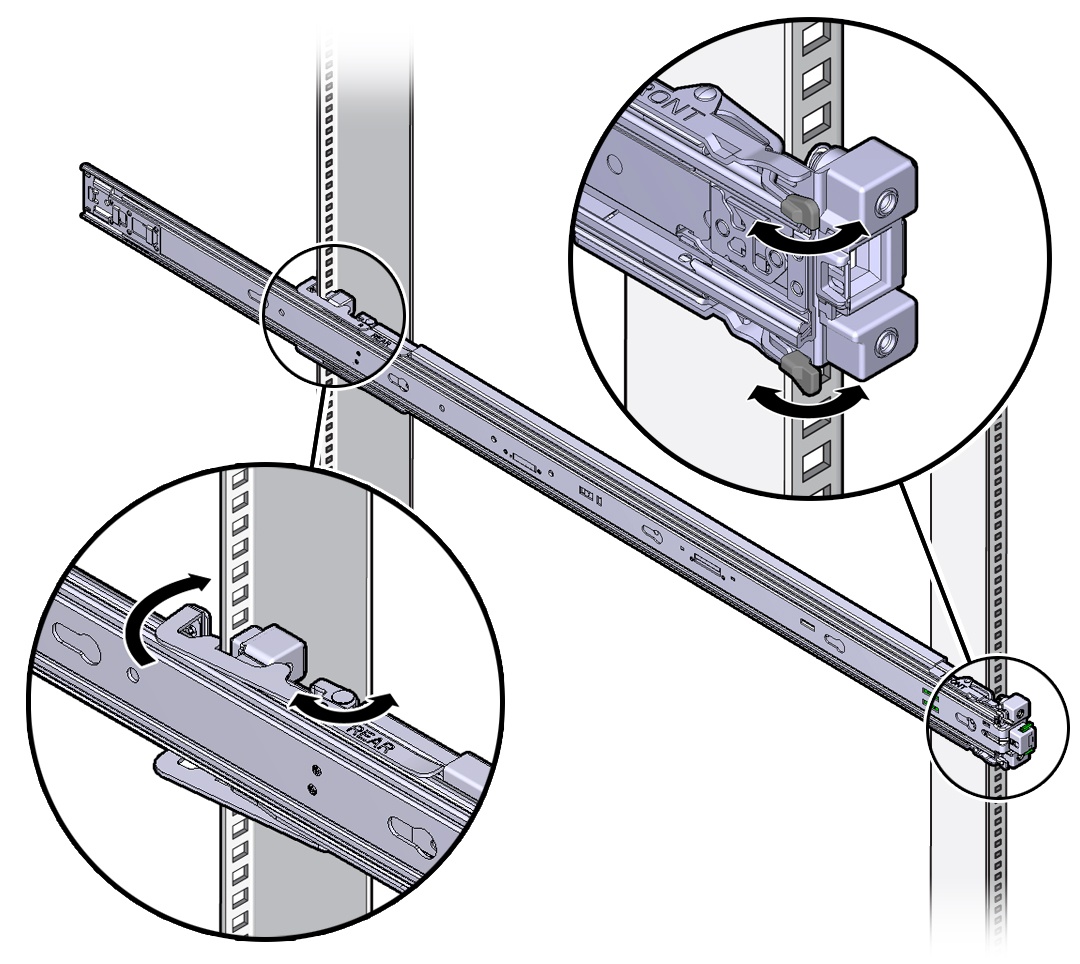

Use this procedure to attach slide-rail assemblies to the rack.
Before you install the slide-rails, be sure to install the server right-angle AC power cables (part number 7079727 - Pwrcord, Jmpr, Bulk, SR2, 2m, C14RA, 10A, C13). In the 1000 mm rack, the standard rail kit slide-rails obstruct access to the front of the 15kVA, 22kVA, and 24kVA Power Distribution Unit (PDU) electrical sockets. If you use the standard AC power cables, first plug them in, and then install the slide-rails into the rack. After you install the slide-rails, you cannot disconnect or remove the standard AC power cables from the PDU but you can remove them from the system.
Orient the slide-rail assembly so that the ball-bearing track is forward and locked in place.
Call Out Description 1 Slide-rail 2 Ball-bearing track 3 Ball-bearing locking mechanism -
Starting with either the left or right side of the rack, align the back of the slide-rail assembly against the inside of the back rack rail, and push until the assembly locks into place with an audible click.
Align the front of the slide-rail assembly against the outside of the front rack rail, and push until the assembly locks into place with an audible click.
Repeat Step 1 through Step 3 to attach the slide-rail assembly to the other side of the rack.

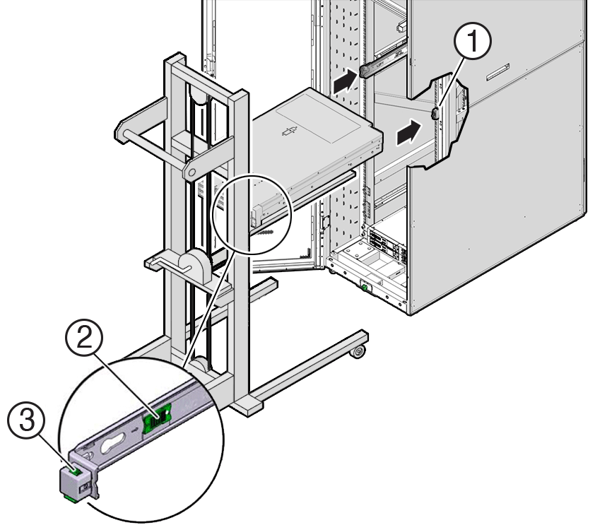

Install the Server Into the Slide-Rail Assemblies
Use this procedure to install the server chassis with mounting brackets into the slide-rail assemblies that are mounted to the rack.
Always load equipment into a rack from the bottom up so that the rack does not become top-heavy and tip over. Extend the rack anti-tilt bar to prevent the rack from tipping during equipment installation.

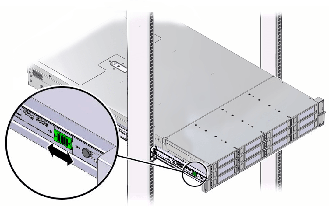

Push the slide-rails as far as possible into the slide-rail assemblies in the rack.
Position the server so that the back ends of the mounting brackets are aligned with the slide-rail assemblies that are mounted in the rack.
Insert the mounting brackets into the slide-rails, and then push the server into the rack until the mounting brackets are flush with the slide-rail stops (approximately 30 cm or 12 inches).
Call Outs Description 1 Inserting mounting bracket into slide-rail 2 Slide-rail release button 3 Slide-rail lock -
Simultaneously push and hold the green slide-rail release buttons on each mounting bracket while you push the server into the rack. Continue pushing the server into the rack until the slide-rail locks (on the front of the mounting brackets) engage the slide-rail assemblies with an audible click.

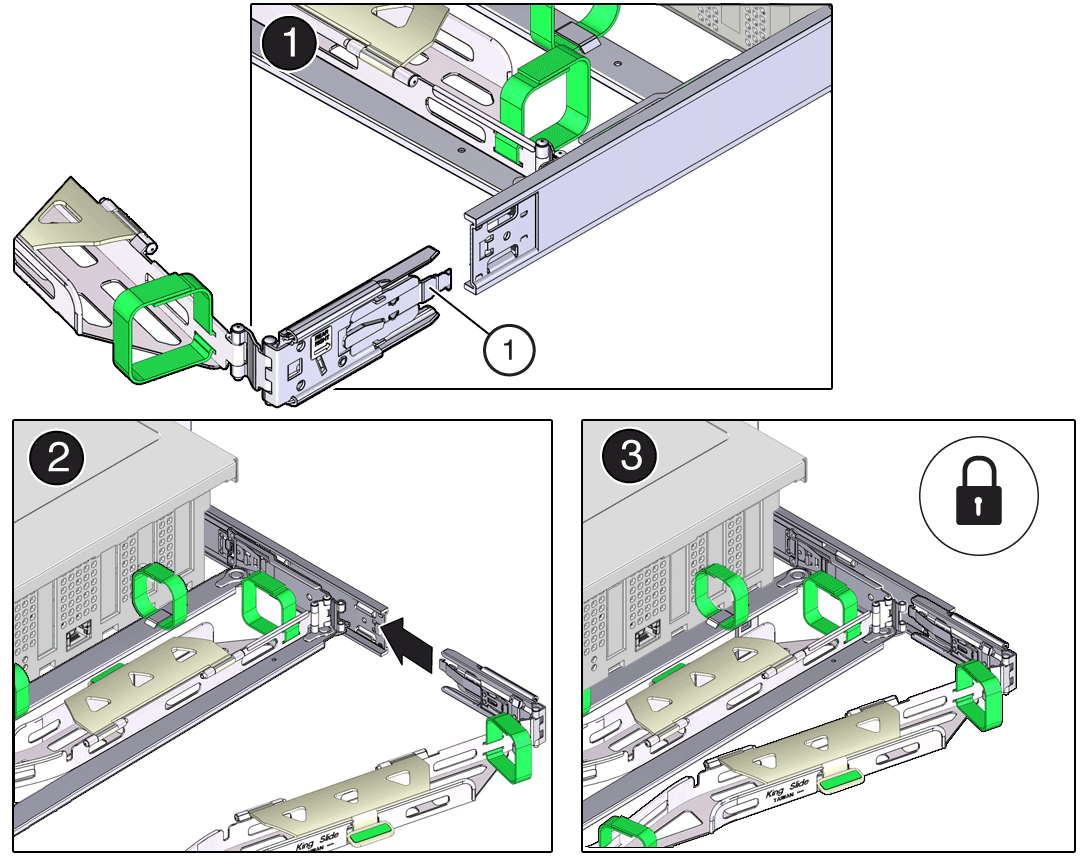

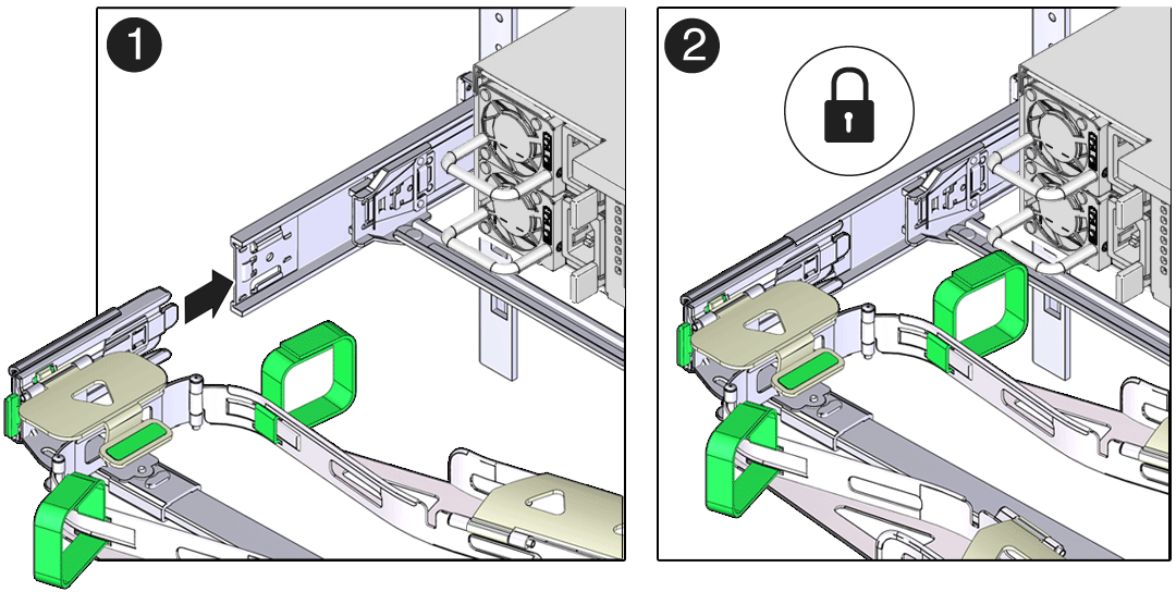

To install CMA connector C into the right slide-rail:
Align connector C with the slide-rail so that the locking spring (callout 1) is positioned inside (server side) of the right slide-rail [1].
Call Out Description 1 Connector C locking spring -
Insert connector C into the right slide-rail until it locks into place with an audible click [2 and 3].
Gently tug on the right side of the CMA back slide bar to verify that connector C is properly seated.

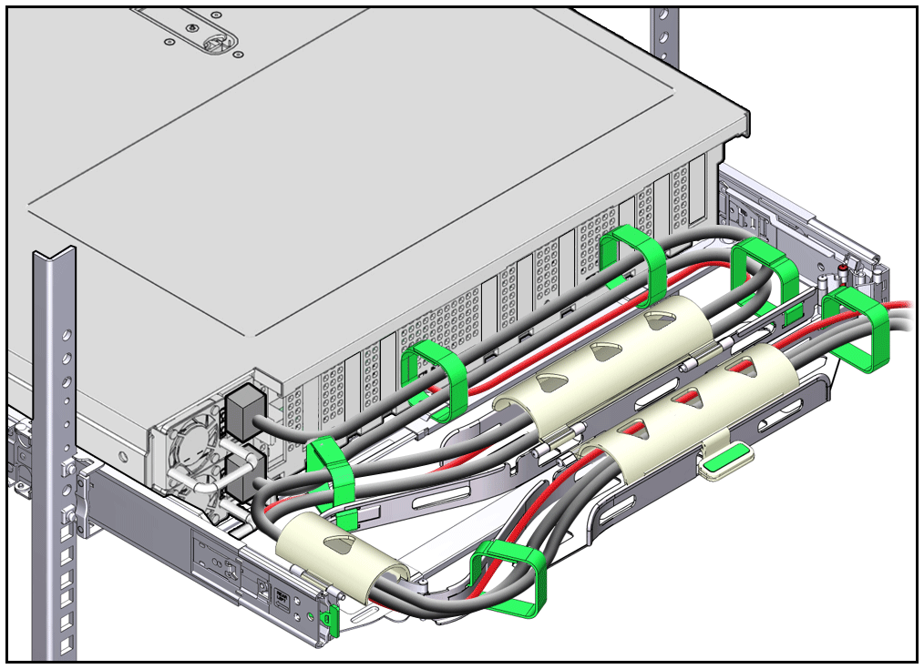

Open the CMA cable covers, route the server cables through the CMA cable troughs (in the order specified in the following steps), close the cable covers, and secure the cables with the six Velcro straps.
First through the front-most cable trough.
Then through the small cable trough.
Then through the back-most cable trough.
Ensure that the secured cables do not extend above the top or below the bottom of the server to which they are attached. Otherwise, the cables might snag on other equipment installed in the rack when the server is extended from the rack or returned to the rack.
If necessary, bundle the cables with additional Velcro straps to ensure that they stay clear of other equipment. If you need to install additional Velcro straps, wrap the straps around the cables only, not around any of the CMA components. Otherwise, expansion and contraction of the CMA slide bars might be hindered when the server is extended from the rack and returned to the rack.

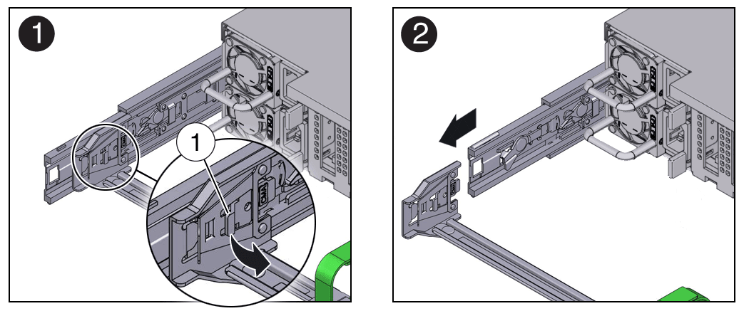

To disconnect connector A:
Place your left arm under the CMA to support it and grasp the back end of connector A with your left hand.
Use your right thumb to pull the connector A release lever to the right, away from the left slide-rail (callout 1), and use your left hand to pull the connector out of the slide-rail [1 and 2].
Call Out Description 1 Connector A release lever -
