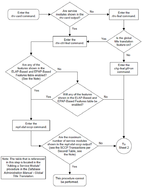

    If service modules are shown in the rtrv-card output, shown by the entry VSCCP in the APPL column, continue the procedure with unresolvable-reference.html#GUID-FA0B3F5F-E5F4-41DD-AF10-AF282BECCFFF__STEP_BD0272E65D3746D6A5AE90158EF63388.
    If service modules are not shown in the rtrv-card output, continue the procedure with unresolvable-reference.html#GUID-FA0B3F5F-E5F4-41DD-AF10-AF282BECCFFF__STEP_ECE3B7C7CA164B97A6D1D4A81A77520D.
  2. Verify that the GTT feature is on by entering the rtrv-feat command. If the GTT feature is on, the GTT field should be set to on. For this example, the GTT feature is off.
    The rtrv-feat command output contains other fields that are not used by this procedure. To see all the fields displayed by the rtrv-feat command, refer to the rtrv-feat command description in Commands User's Guide.
    If the GTT feature is on, continue the procedure with unresolvable-reference.html#GUID-FA0B3F5F-E5F4-41DD-AF10-AF282BECCFFF__STEP_BD0272E65D3746D6A5AE90158EF63388.
    If the GTT feature is off, continue the procedure with unresolvable-reference.html#GUID-FA0B3F5F-E5F4-41DD-AF10-AF282BECCFFF__STEP_77F62693E7EC4F7E9A0F5F726B11D281.

  5. Verify the number of service modules in the EAGLE by entering the rept-stat-sccp command. The number of service modules is shown in the SCCP Cards Configured field of the rept-stat-sccp output. This is an example of the possible output.

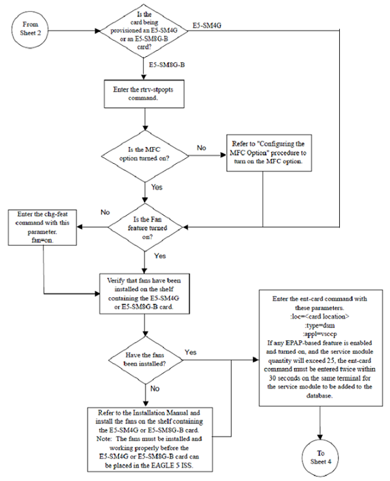

    The rept-stat-sccp command output contains other fields that are not used by this procedure. If you wish to see all the fields displayed by the rept-stat-sccp command, refer to the rept-stat-sccp command description in Commands User's Guide.
    **INTERNAL XREF ERROR** shows the maximum number of service modules that can be provisioned based on the type of SCCP traffic the EAGLE is handling and whether or not the Throughput Capacity or the EAGLE SCCP Capacity Increase features are enabled and turned on.
    Table 4-8 SCCP Transactions Per Second
    Type of Traffic Maximum Transactions per Second for the EAGLE Transactions per Second for each Service Module Maximum Number of Service Modules
    Throughput Capacity Feature for either 5000 or 6800 SCCP Transactions per Second is not Enabled or Turned On
    GTT Traffic or ANSI41 AIQ only - No EPAP-Based Traffic or ELAP-Based (LNP) Traffic 52,700 1700 32
    ELAP-Based (LNP) Traffic 40,800 1700 25
    EPAP-Based Traffic 40,800 1700 - for a SLIC card 25
    20,400 850 - for a DSM 25
    Throughput Capacity Feature for 5000 SCCP Transactions per Second is Enabled and Turned On (See Notes 1 and 2)
    GTT Traffic or ANSI41 AIQ only - No EPAP-Based Traffic or ELAP-Based (LNP) Traffic 150,000 5000 32
    ANSI G-Flex EPAP-Based Traffic Only 150000 5000 32
    EPAP-Based Traffic (except ANSI G-Flex Traffic) 96,875 3125 32
    ELAP-Based (LNP) Traffic 85,000 5000 18 (See Note 3)
    Throughput Capacity Feature for 6800 SCCP Transactions per Second is Enabled and Turned On (See Notes 1 and 2)

Figure 4-1 Add a Service Module - Sheet 1 of 4
Figure 4-2 Add a Service Module - Sheet 2 of 4

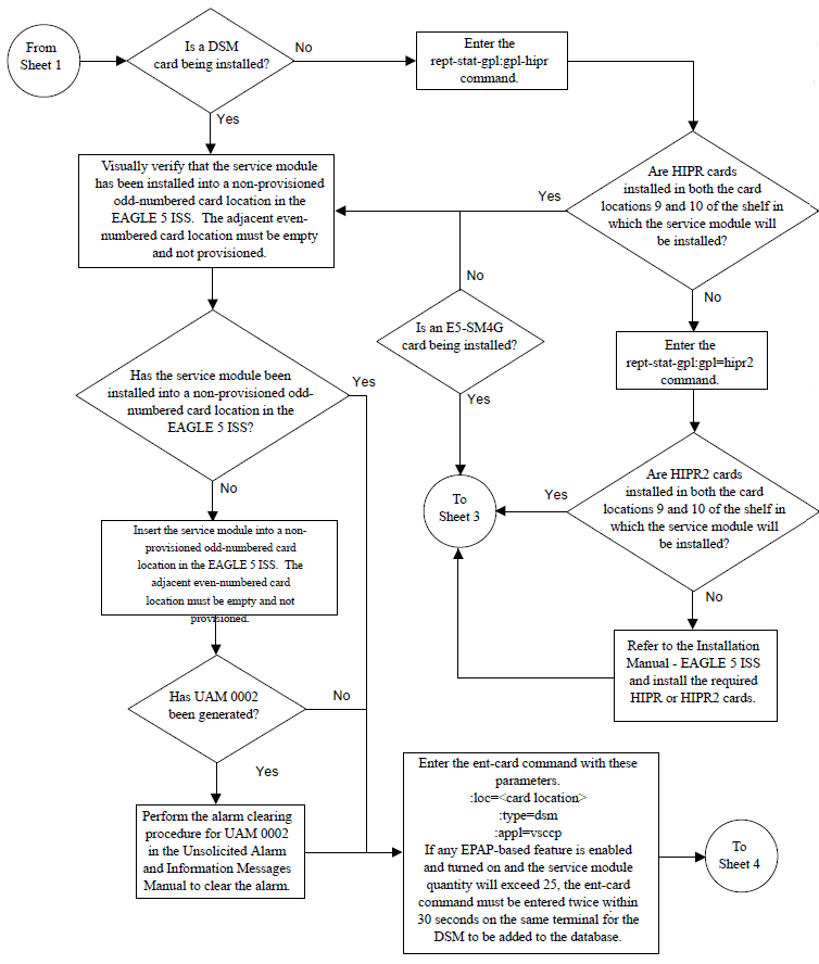

Figure 4-3 Add a Service Module - Sheet 3 of 4
