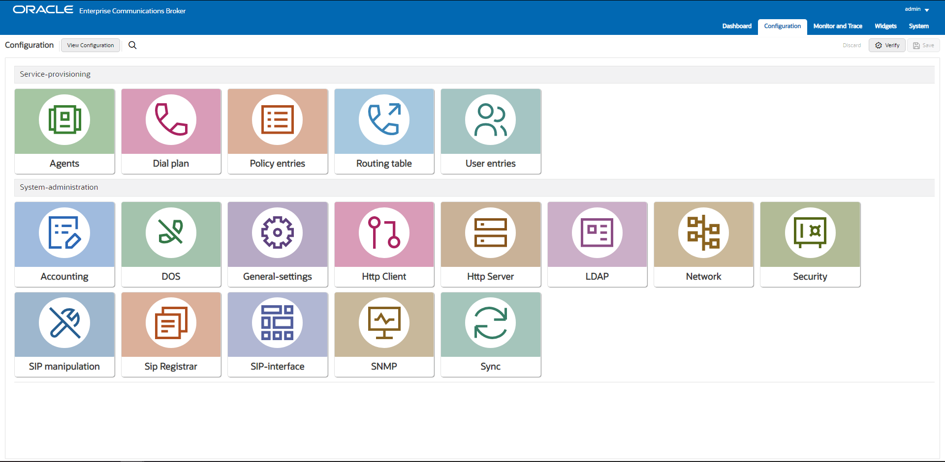

The Configuration Tab Display
The following screen capture shows the locations of all of the Configuration tab controls.

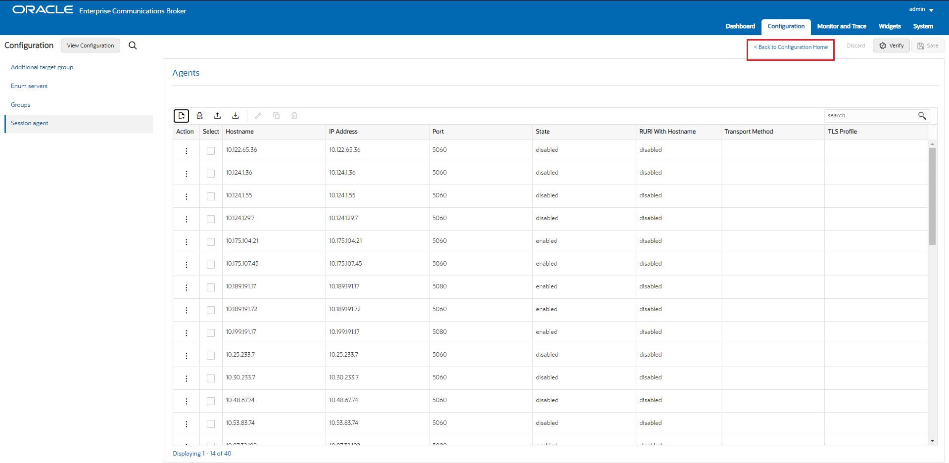

From any sub object on the a configuration icon's page, there is a Back to Configuration Home link.

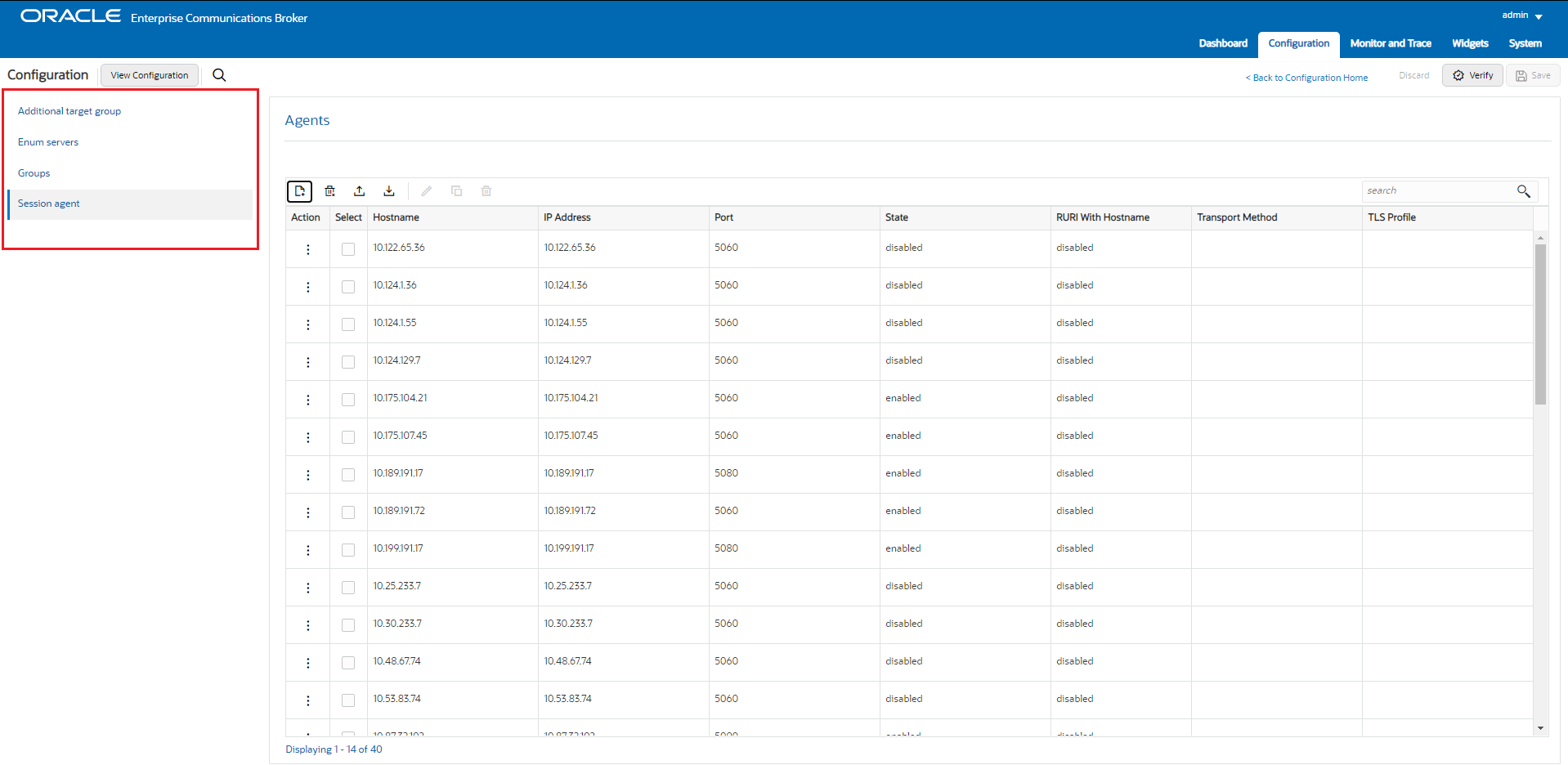

The navigation object on the left side of an icon's configuration dialog is only available for objects that include sublinks.
The navigation object on the left side of an icon's configuration dialog does not display for objects that have no sublinks.

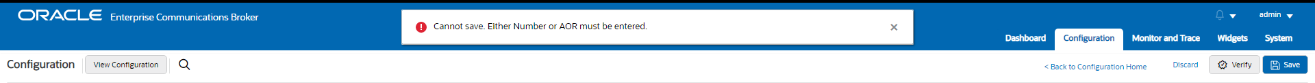

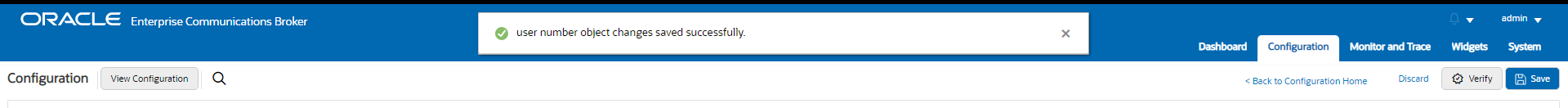

The OECB displays Error and Success messages at the top of each configuration dialog.
This image displays a configuration success message.
Controls in the Navigation Pane
The navigation pane is on the left side of configuration lists and remains there as screens change within the center pane. You can think of the Navigation Pane as similar to a table of contents. It displays links to configuration objects or drop down controls to drill into sub-categories of configuration objects.

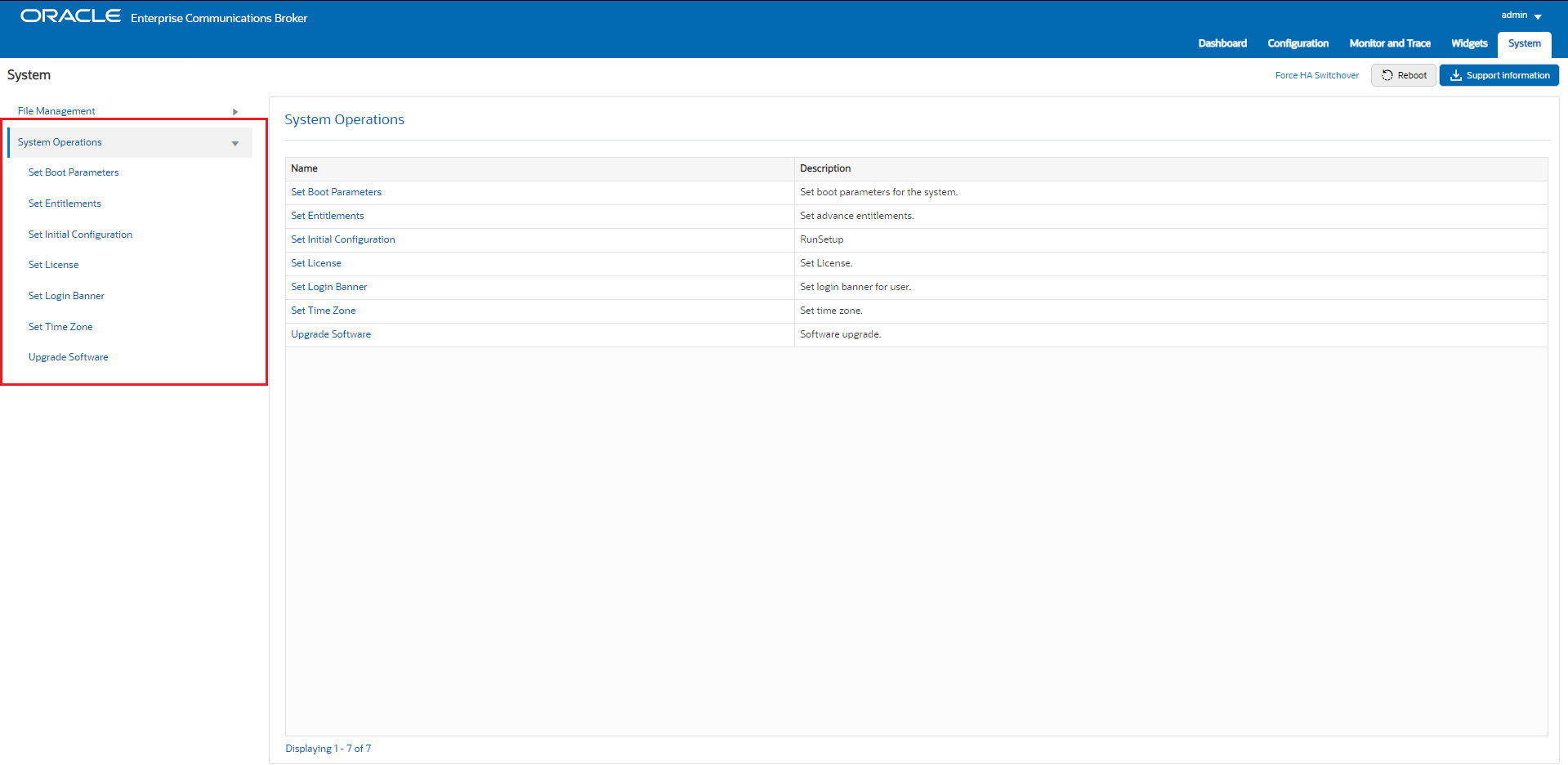

For example, the System Tab includes a navigation pane that shows Systems Operations and File Management category links. When you click the Systems Operations link, the system opens a drop-down showing all System Operations functions and a table with function descriptions in the center pane. When you click a function, from either the Navigation of Center pane, the system displays that function's configuration dialog.
This screen capture shows the list of Systems Operations configurations and provides their descriptions.

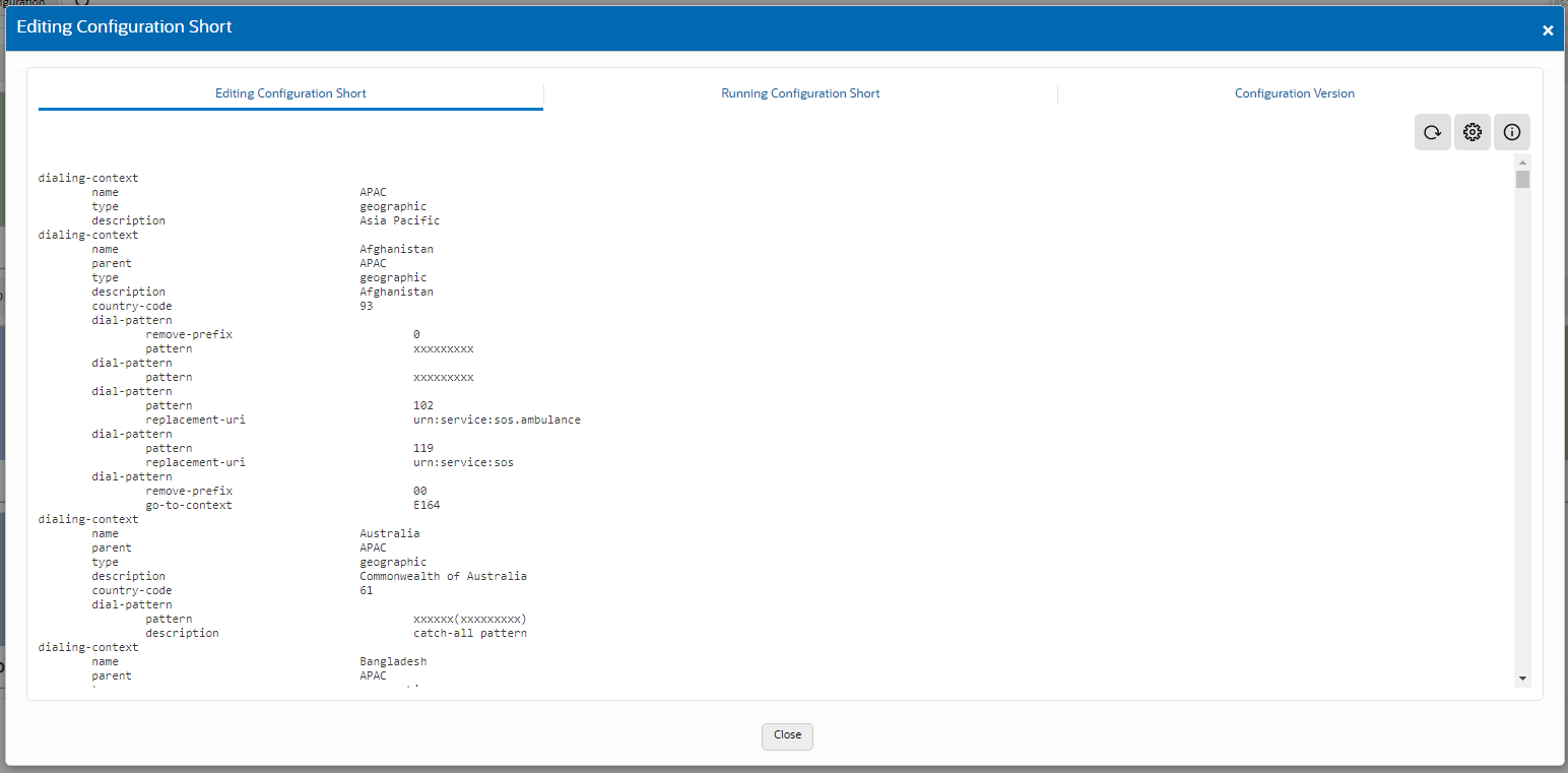

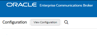

This screen capture shows the View Configuration button.
The Editing, Running and Configuration Version commands are available from the top of this dialog.

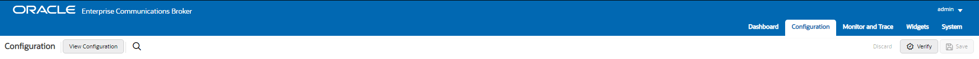

The controls located at the top of the center pane on a configuration page help you manage configuration objects.
This screen capture shows the controls located at the top of the center pane on any configuration pane.
These controls are described in the following table.
| Save | Use to save the current configuration session. Upon Save, the system displays a prompt giving you a choice of whether or not to activate the configuration. If you do not activate the configuration, you can continue to make changes and Save again. When finished, you can save and activate all of the configuration changes. |
| Verify | Use to confirm that the configuration is valid before you save it. |

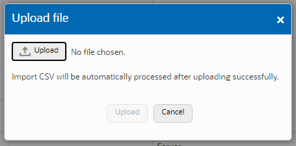

| Upload | Use to upload a configuration file in CSV format. |

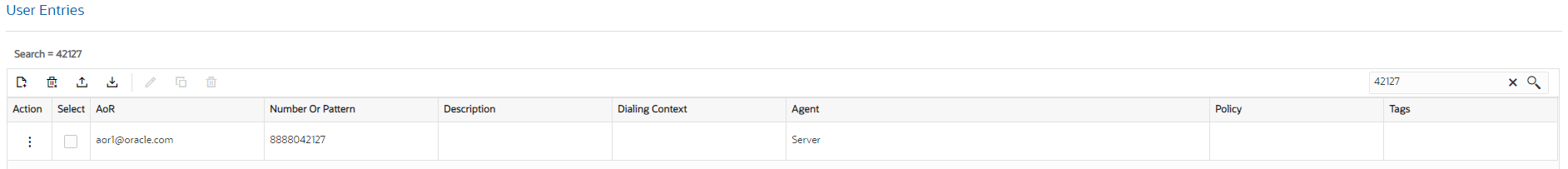

| Search | Use to search the list of multi-instances for a specific instance. When you enter the name of an instance, the Web GUI displays it at the top of the list. |
Set System Operations
The System Operations link under the System tab displays a list of procedures, for performing selected configuration procedures for the Oracle Enterprise Communications Broker (OECB).
| Set Boot Parameters | Specify the boot file and the boot parameters. |
| Set Entitlements | Set the number of sessions that a license entitles you to, and enable advanced features. |
| Set Initial Configuration | Configure a new OECB or reconfigure an existing one. Includes configuring High Availability. |
| Set License | Enter the license number for a feature that requires a license. |
| Set Login Banner | Customize the text on the Web GUI log on banner. |
| Set Time Zone | Select the time zone for the deployment. |
| Upgrade Software | Upload a newer version of the software. |

Configuration Error Messages
If you save a configuration that contains errors, the system displays the following error message: There were errors! Are you sure you want to activate the configuration?
The system displays a list of errors at the bottom the page. Click an error to go to the location in the configuration where the error occurred and edit the configuration as needed.

Uploading and Downloading Configuration File Elements
The Oracle Enterprise Communications Broker allows you to upload and download files containing certain key elements of your configuration that are more easily managed separately from the overall system configuration. Such elements include:
- Dial Plans
- Dial Patterns
- User Database Entries
- Route Database Entries
- SIP Manipulation Rules
The corresponding dialogs for the items in the preceding list include controls for uploading and downloading files, depending on which action you choose. When you click the Upload button, for example, the system displays the Upload file dialog, which includes a Browse button. When you click Browse, the system opens a browse dialog, from which you can select the file that you want to upload. Download behavior is similar. The system performs the file transfer to the correct system directories in the correct format without requiring any intervention. The following screen capture shows an example of the Upload File dialog.
