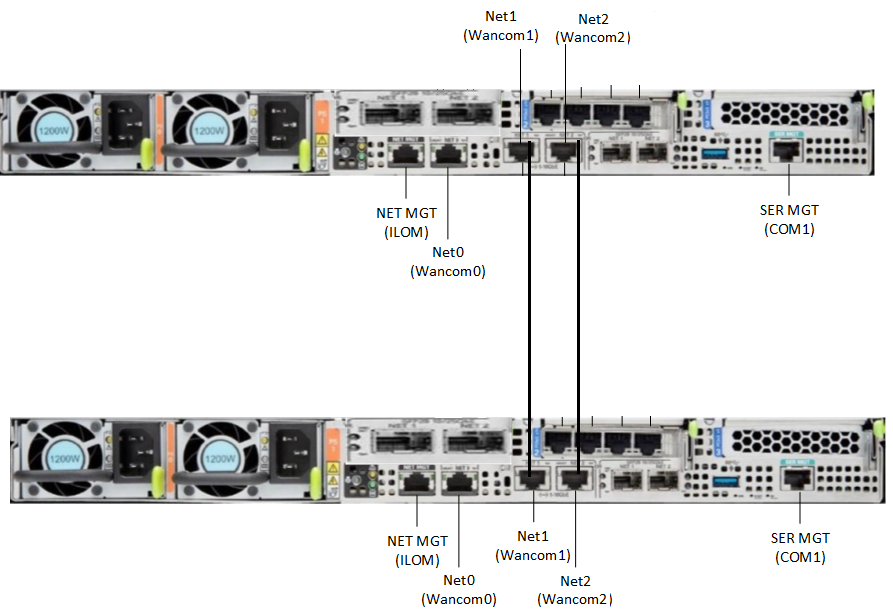

Category 6 Ethernet cables are required for cabling two HA nodes together.
Rear Panel Cabling for HA
You can use one connection for High Availability (HA) redundancy support between the two members of an HA node. Oracle recommends reserving wancom0 as the boot and maintenance interface. You can use wancom1 or wancom2 for sharing HA information.

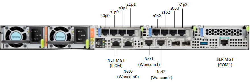

Figure 1-32 Oracle X8-2 Configuration A (4x10 GigE NIC)

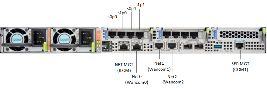

Figure 1-33 Oracle X8-2 Configuration B (Two 4x10 GigE NICs)

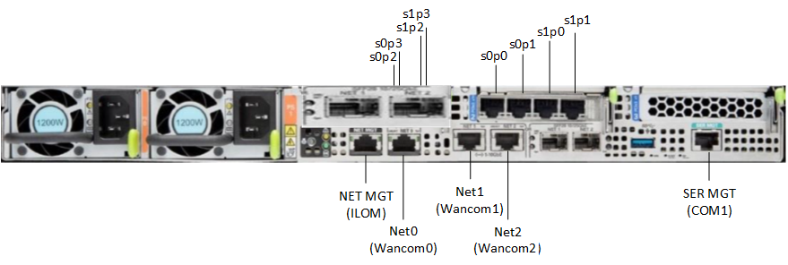

Figure 1-34 Oracle X8-2 Configuration B (One QSFP and One 4x10 GigE NICs)
