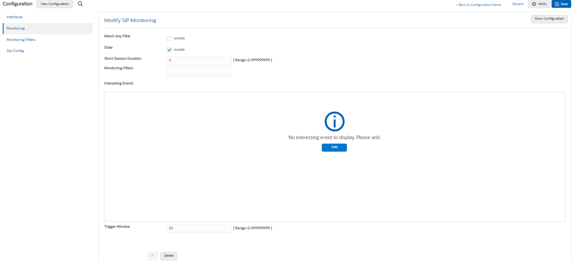

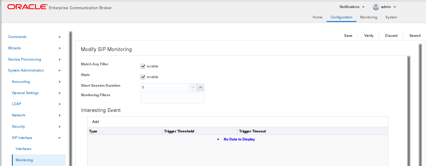

SIP Monitor and Trace Filter Configuration
The SIP Monitor and Trace function allows you to monitor SIP sessions for notable events and display the results in the Oracle Enterprise Communications Broker (OECB) SIP Notable Events summary. Such information may help you perform troubleshooting. For more targeted monitoring, you can configure filters on particular users and addresses on the OECB, and on a specific agent.

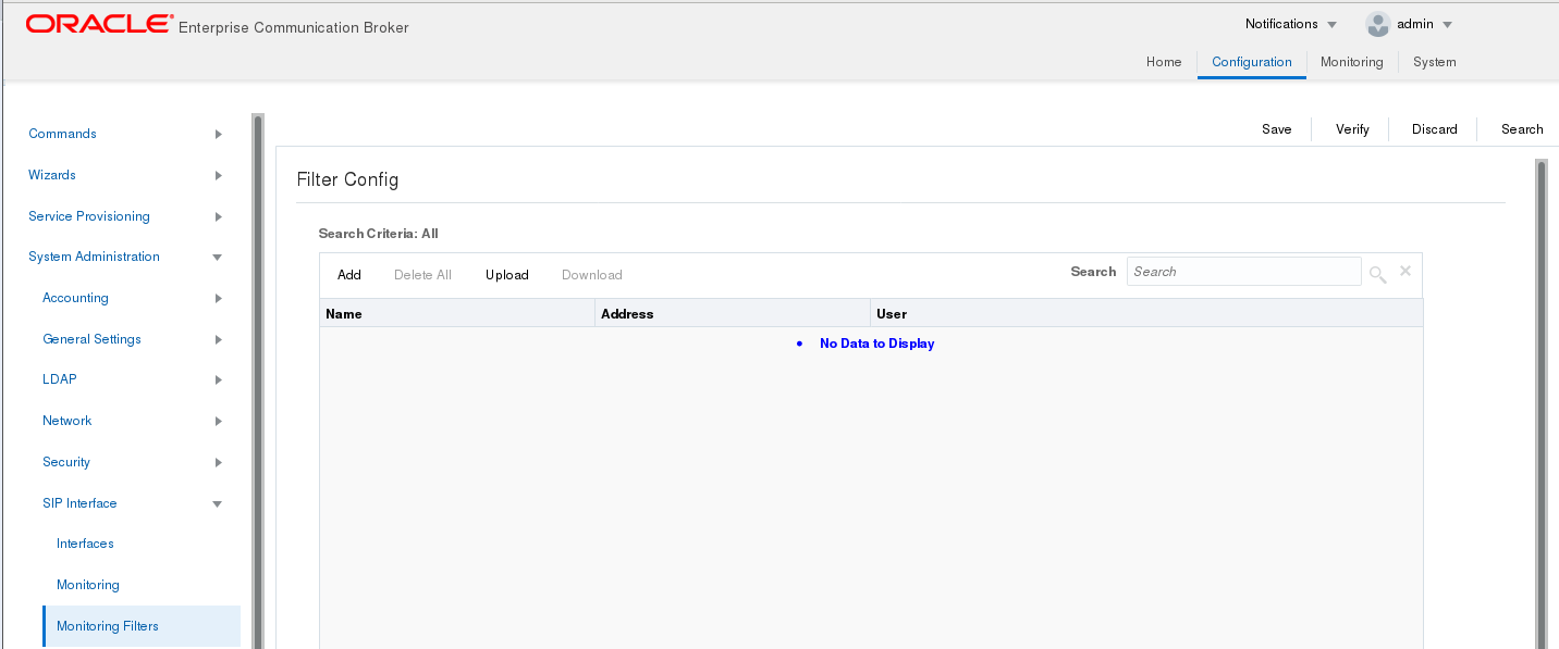

- The SIP Interface configuration page
displays the Monitoring Filters object in the navigation pane, which you use
to configure individual filters.
- The Monitoring object
on the SIP interface configuration page displays the Monitoring
Filters element in the dialog. Use it to apply filters to the
OECB.
- The Add Agents configuration page
displays the Monitoring Filters configuration element to the Advanced
section. Use it to apply filters to an agent.
After the P-CZ2.0.0m4 release, the system does not support the former "Enable SIP Monitor and Trace" setting. You must re-configure SNMP event traps through the dialogs described in this topic.
- Create one or more filters in the Monitoring Filters object. You may use an asterisk character as a filter, if you want to monitor all session data.
- Add one or more filters to the Monitoring object.
- (Optional) Add one or more monitoring filters to an agent that you want to monitor.

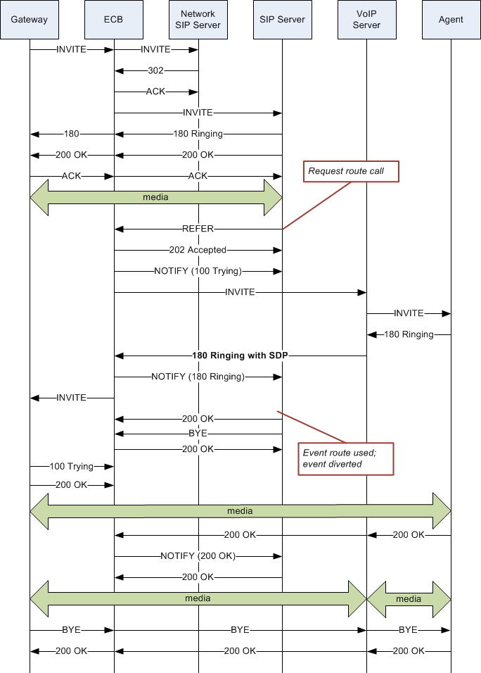

The following ladder diagram shows an example of call flow for an unattended call transfer:

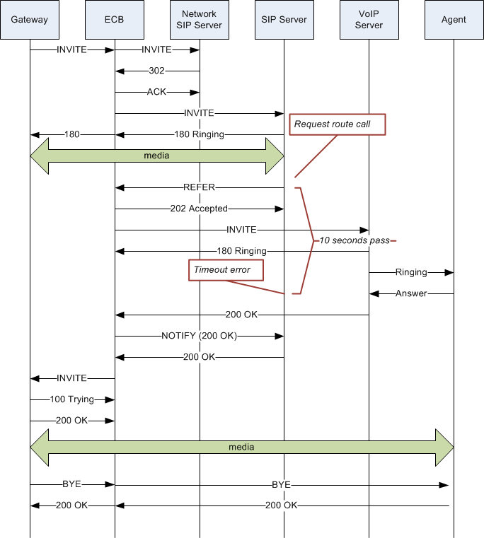

The following ladder diagram shows an example call flow of an attended call transfer:

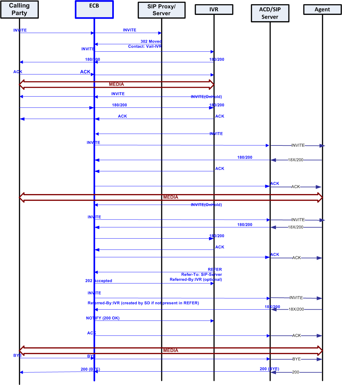

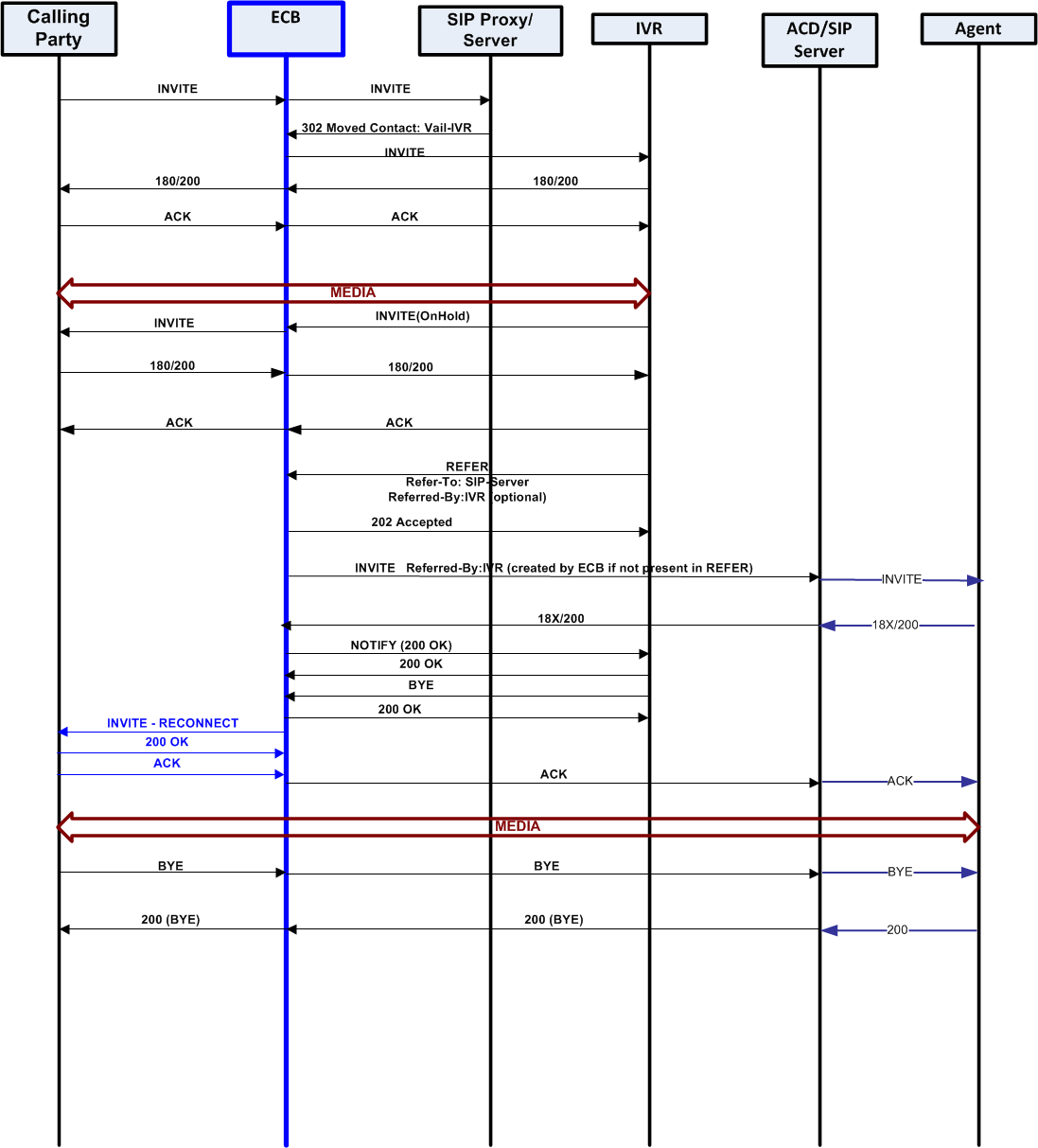

In the basic scenario for REFER initiated call transfer, a call is established between two User Agents (Alice and Bob). User Agent Bob then sends a REFER request to transfer the call to a third User Agent Eva. With dynamic call-transfer enabled, the OECB prevents the REFER from being sent to Alice and generates the INVITE to Eva.
- If the INVITE to Eva succeeds, the OECB sends a re-INVITE to Alice modifying the SIP session as described in Section 14 of RFC 3261, SIP: Session Initiation Protocol. At this point the OECB cancels the original dialog between the OECB and Bob.
- If the INVITE to Eva fails, call disposition depends on whether or not Bob issued a BYE after the REFER call transfer. If the OECB did receive a BYE from Bob (for instance, a blind transfer), it proxies the BYE to A. Otherwise, the OECB retains the original SIP session and media session, thus allowing Bob to re-establish the call with Alice by sending a re-INVITE. In this case, the OECB sets a timer (32 seconds), and then sends a BYE.
- If a REFER method is received containing no Referred-By header, the OECB adds one, allowing the OECB to support all call agent screen applications.

The following ladder diagram shows how a sample call flow times out when the Send NOTIFY Messages for REFER Provisional Responses parameter is not set.
When you compare the call flow above to the following one depicting the scenario when the OECB has the Send NOTIFY Messages for REFER Provisional Responses changed from its default, the difference is that the OECB now responds with a NOTIFY in response to the 202 Accepted and it sends another one after the 180 Ringing. This prevents the timeout and allows the event to be diverted successfully.
