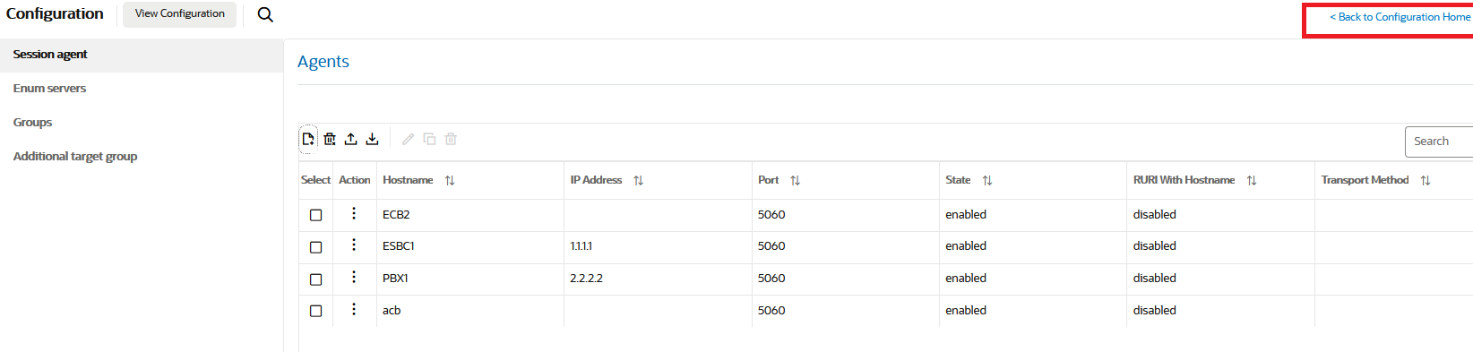

From any sub object on the configuration icon's page, there is a Back to Configuration Home link.
Figure 4-9 The Configuration Tab Display
Figure 4-10 Back to Configuration Home

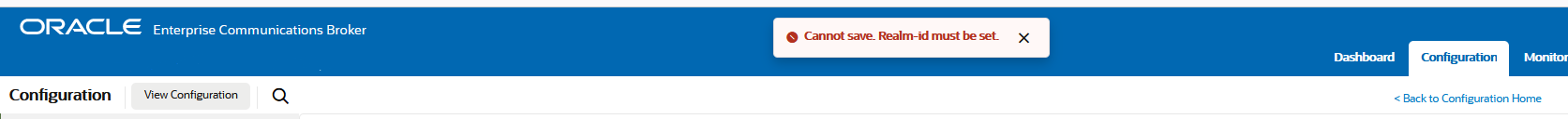

The ECB displays Error and Success messages at the top of each configuration dialog.
Figure 4-13 Error Panel
This image displays a configuration success message.
Figure 4-14 Success Message Panel

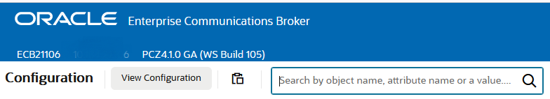

This screen capture shows the View Configuration button.
Figure 4-16 View Configuration button
The Editing, Running and Configuration Version commands are available from the top of this dialog.
Figure 4-17 View Configuration

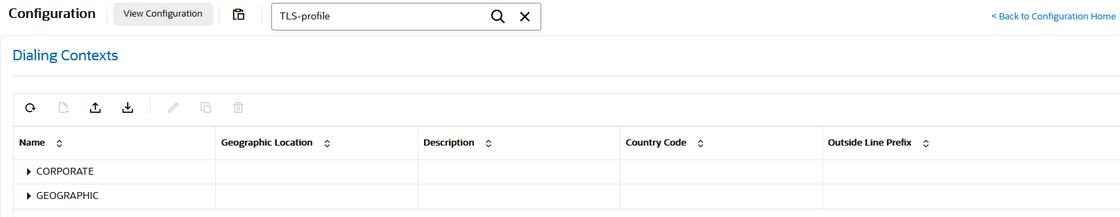

The controls located at the top of the center pane on a configuration page help you manage configuration objects.
This screen capture shows the controls located at the top of the center pane on any configuration pane.
Figure 4-18 Center Panel
These controls are described in the following table.
| Paste | Opens the Paste Configuration window, in which you can paste the configuration details for one or more objects and save it. |
| Save | Use to save the current configuration session. Upon Save, the system displays a prompt giving you a choice of whether or not to activate the configuration. If you do not activate the configuration, you can continue to make changes and Save again. When finished, you can save and activate all of the configuration changes. |
| Verify | Use to confirm that the configuration is valid before you save it. |
| Discard | Discard the current changes to configuration. |

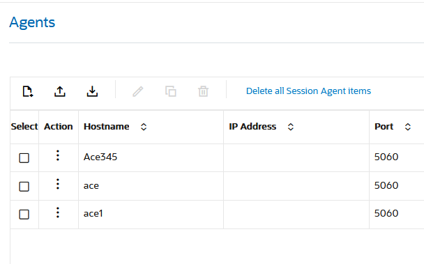

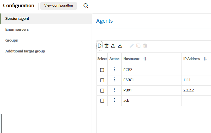

Controls for Multi-Instance Objects
The controls located at the top of a list of multi-instance objects help you manage the objects on the list. The following screen capture shows the controls.
Figure 4-19 Controls located at the top of the center pane on any multi-instance list
| Add | Use to add another instance of the configuration object with one or more parameters set differently. |
| Delete All | Use to delete all instances.
Caution: You cannot select a sub-set of instances and delete only those. The system deletes all instances, regardless of how many you select. |
| Upload | Use to upload a configuration file in CSV format. |
| Download | Use to download a configuration file in CSV format. |
| Search | Use to search the list of multi-instances for a specific instance. When you enter the name of an instance, the Web GUI displays it at the top of the list. |
| Edit | Use to edit the selected configuration element. |
| Copy | Use to copy the selected configuration element. |
| Delete | Use to delete the selected configuration element. |

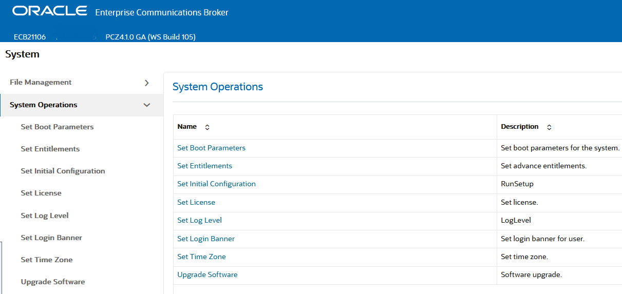

Set System Operations
The System Operations link under the System tab displays a list of procedures, for performing selected configuration procedures for the Oracle Enterprise Communications Broker (OECB).
| Set Boot Parameters | Specify the boot file and the boot parameters. |
| Set Entitlements | Set the number of sessions that a license entitles you to. |
| Set Initial Configuration | Configure a new ECB or reconfigure an existing one. Includes configuring High Availability. |
| Set License | Enter the license number for a feature that requires a license. |
| Set Login Banner | Customize the text on the Web GUI log on banner. |
| Set Time Zone | Select the time zone for the deployment. |
| Upgrade Software | Upload a newer version of the software. |

Configuration Error Messages
If you save a configuration that contains errors, the system displays the following error message: There were errors! Are you sure you want to activate the configuration?
The system displays a list of errors at the bottom the page. Click an error to go to the location in the configuration where the error occurred and edit the configuration as needed.
| Severity | Identifies the level of severity that the Oracle
Enterprise Session Border Controller assigns to the error. Valid values are:
| Message | Identifies the element field where the error, warning, or critical error occurred, and the reason for the error. |
| Object | Identifies the element and the field for that element where the error occurred. |
| Attribute Name | Identifies the attribute within the element where the error occurred. |
| Other | Identifies any other pertinent information relating to the error. |

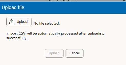

Uploading and Downloading Configuration File Elements
The Oracle Enterprise Communications Broker allows you to upload and download files containing certain key elements of your configuration that are more easily managed separately from the overall system configuration. Such elements include:
- Dial Plans
- Dial Patterns
- User Database Entries
- Route Database Entries
- SIP Manipulation Rules
The corresponding dialogs for the items in the preceding list include controls for uploading and downloading files, depending on which action you choose. When you click the Upload button, for example, the system displays the Upload file dialog, which includes a Browse button. When you click Browse, the system opens a browse dialog, from which you can select the file that you want to upload. Download behavior is similar. The system performs the file transfer to the correct system directories in the correct format without requiring any intervention. The following screen capture shows an example of the Upload File dialog.
Figure 4-21 Upload File
