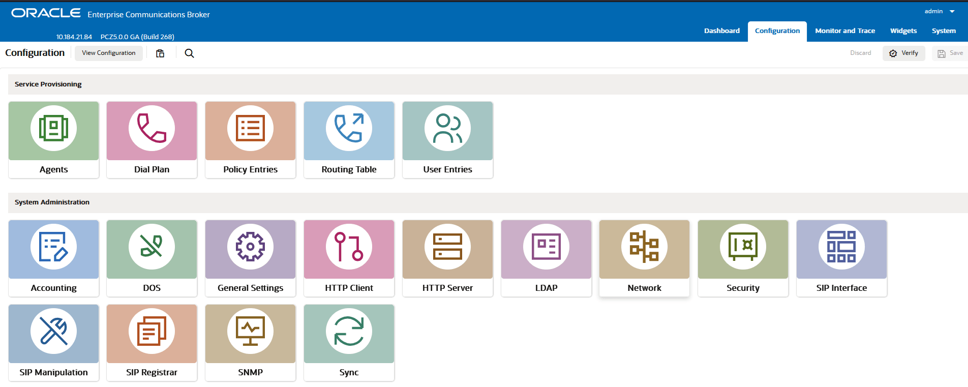

The following screen capture shows the locations of all of the Configuration tab controls.

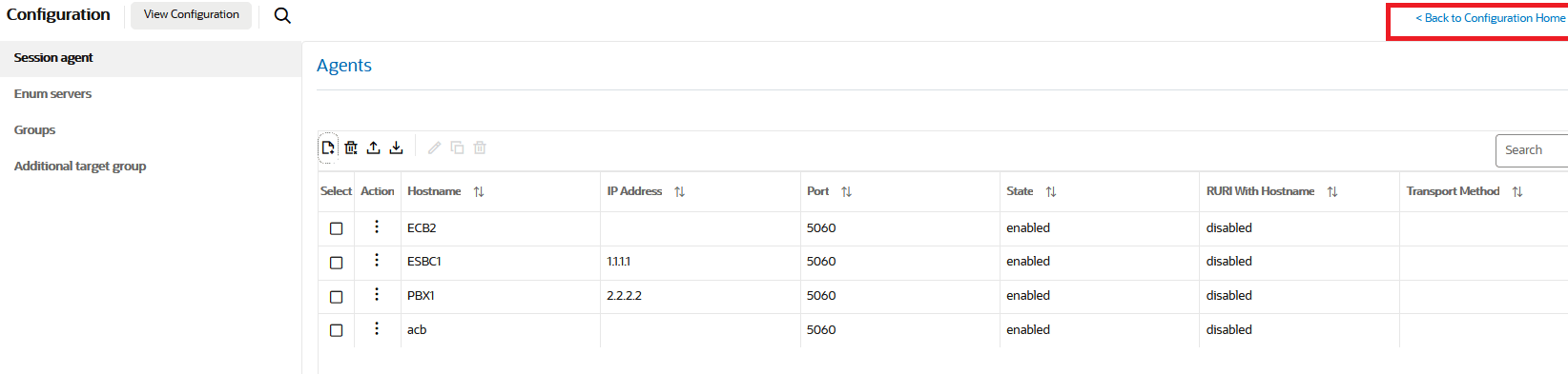

From any sub object on the configuration icon's page, there is a Back to Configuration Home link.
Figure 4-9 The Configuration Tab Display
Figure 4-10 Back to Configuration Home

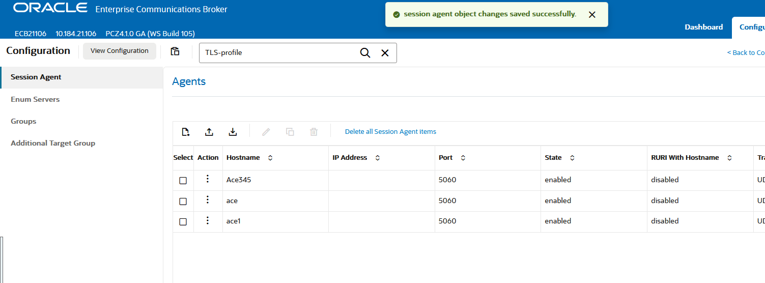

The Communications Broker displays Error and Success messages at the top of each configuration dialog.
Figure 4-13 Error Panel
This image displays a configuration success message.
Figure 4-14 Success Message Panel

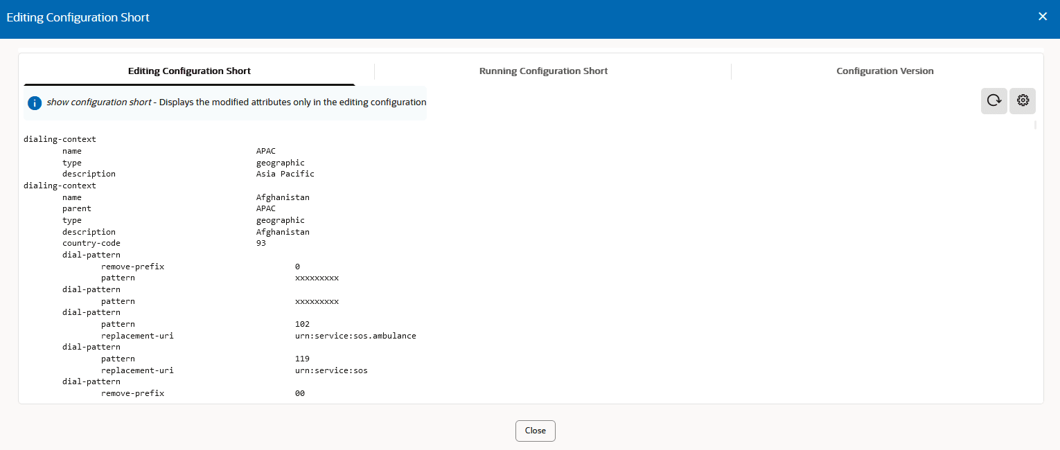

This screen capture shows the View Configuration button.
Figure 4-16 View Configuration button
The Editing, Running and Configuration Version commands are available from the top of this dialog.
Figure 4-17 View Configuration

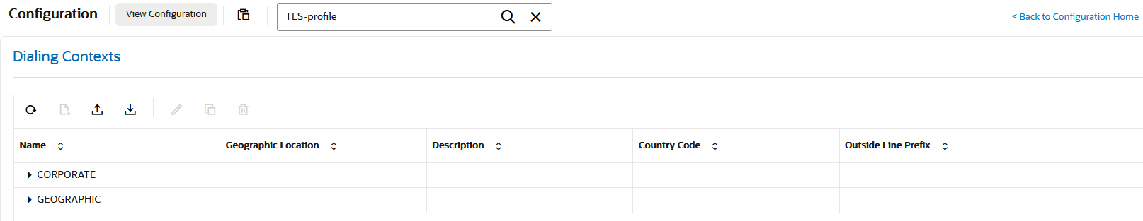

The controls located at the top of the center pane on a configuration page help you manage configuration objects.
This screen capture shows the controls located at the top of the center pane on any configuration pane.
Figure 4-18 Center Panel

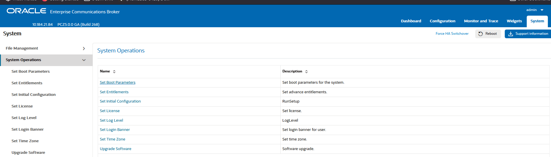

Set System Operations
The System Operations link under the System tab displays a list of procedures, for performing selected configuration procedures for the Communications Broker.
| Set Boot Parameters | Specify the boot file and the boot parameters. |
| Set Entitlements | Set the number of sessions that a license entitles you to. |
| Set Initial Configuration | Configure a new Communications Broker or reconfigure an existing one. Includes configuring High Availability. |
| Set License | Enter the license number for a feature that requires a license. |
| Set Login Banner | Customize the text on the Web GUI log on banner. |
| Set Time Zone | Select the time zone for the deployment. |
| Upgrade Software | Upload a newer version of the software. |
ACLI output sometimes refers to System Operations using the common term, wizard.Set Boot Parameters
