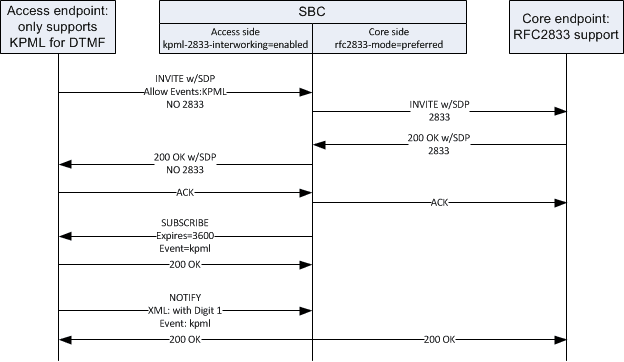

The following diagram shows the standard case where KPML to RFC 2833 interworking is performed.
This image shows the Enterprise SBC interworking KPML and RFC 2833.

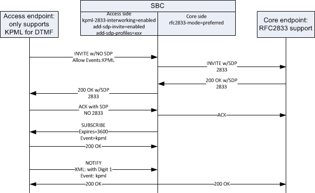

KPML to RFC 2833 translation is also supported when used in conjunction with SDP insertion on the KPML side of the call. For example:
This image shows the Enterprise SBC translating KPML and RFC 2833 with SDP inserted on the KPML side of the call.

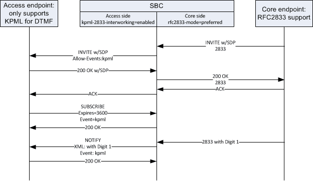

The following diagram shows a typical RFC2833 to KPML interworking call flow. Note the following:
  • While the example has SDP in the INVITE, delayed offer scenarios where the SDP exchange occurs in the 20 0OK and the ACK are supported
  • The rfc2833-mode parameter in the in either the SIP interface or session agent, is considered in the interworking. See next section:
  • If the call negotiates to RFC 2833 to RFC 2833, no KPML interworking is performed.
  • In RFC 2833 to KPML scenarios, if the SUBSCRIBE is not received quickly enough, RFC 2833 digits are dropped.
This image shows the Enterprise SBC performing typical KPML and RFC 2833 interworking

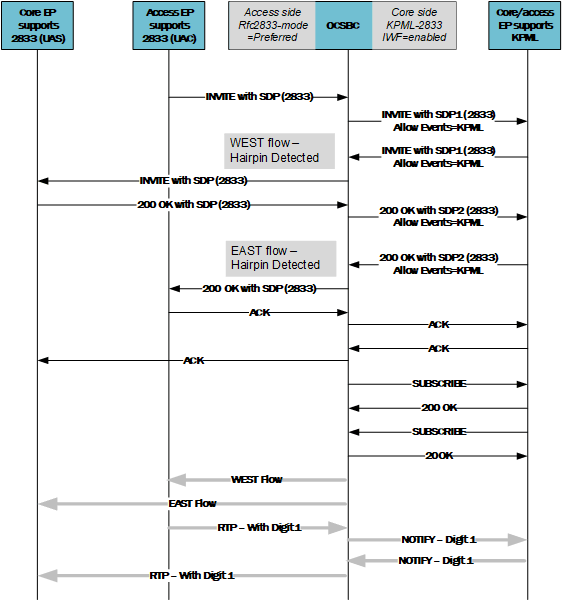

Interworking RFC 2833 and KPML for Hairpin Sessions
The Enterprise SBC supports RFC 2833-KPML interworking scenarios that include forwarded calls that hairpin to an endpoint out the original interface. If the initial callee supports one of these digit encapsulation methods, and the caller and final callee support the other, the default Enterprise SBC behavior of preferring RFC 2833 may block the KPML digit tranmission. You can configure the Enterprise SBC to support interworking within these hairpin scenarios in the egress direction.
Forwarded hairpin calls can cause a problem to RFC 2833-to-KPML interworking for which the Enterprise SBC can recognize and compensate. The issue exists for both RFC 2833-to-KPML and KPML-to-RFC 2833 calls, wherein a called endpoint that requires this interworking forwards the call back to the Enterprise SBC, which hairpins the call to an endpoint that supports the initial encapsulation.
By default, the Enterprise SBC uses RFC 2833 for digit transmission if there is an SDP attribute that includes telephone-event. This remains true even if there is also an allow event parameter set to kpml. The above scenario results in an SDP that includes both, causing the Enterprise SBC to present digit encapsulation towards the KPML endpoint within RFC 2833 RTP.
To compensate for environments that need to support this hairpin forwarding, you can enable the kpmlRFC2833-iwf-on-hairpin parameter on the applicable session-agent or sip-interface. When configured for this hairpin support:
  • RFC 2833-to-KPML with hairpin to a RFC 2833 endstation—Although the Enterprise SBC receives an SDP answer that supports both KPML and RFC 2833 from KPML side, it honors the SUBSCRIBE request from the KPML endpoint and generates NOTIFY requests with DTMF digits towards the KPML end point.
  • KPML-to-RFC 2833 with hairpin to a KPML endstation—Although the Enterprise SBC receives an SDP offer that supports both KPML and telephone event from the KPML endpoint, it sends NOTIFY requests with the DTMF digits towards the RFC 2833 end point.
The diagram below shows an endpoint supporting RFC 2833 initiating a call, which terminates via hairpin on another RFC 2833 endpoint. The call initially targets an endpoint supporting KPML, but is forwarded back to the Enterprise SBC. SDP2 includes the KPML allow event parameter and the telephone-event attribute. But this configuration causes the Enterprise SBC to send digits to the KPML endpoint using NOTIFY message, and encapsulate those same digits in RTP for the RFC 2833 endpoints.
This call flow shows the Enterprise SBC supporting RFC 2833-KPML interworking despite a hairpin to an endpoint that does not require the IWF.

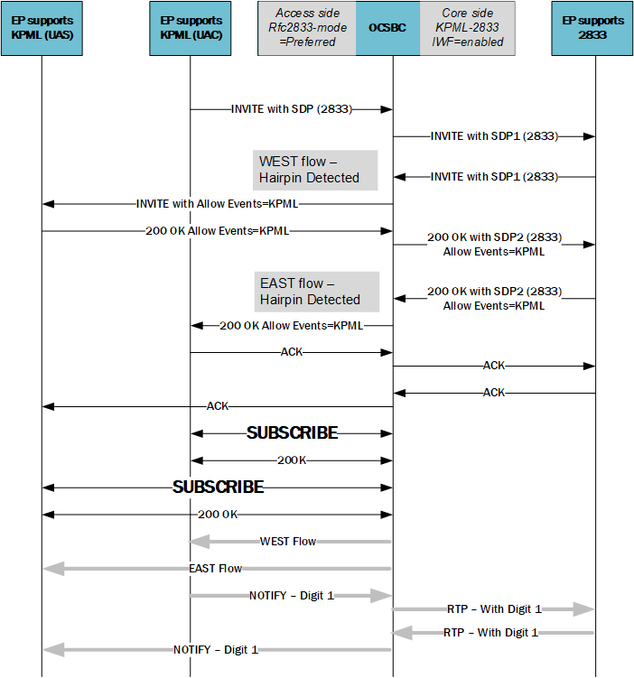

Bi-Directional Subscriptions
Within the context of hairpinned sessions that starts from a KPML endpoint and ultimately targets a KPML endpoint, the Enterprise SBC both accepts the SUBSCRIBE from the called endpoint, and sends a SUBSCRIBE to the calling endpoint. In the diagram below, The Enterprise SBC hairpins a call originating from a KPML endpoint, towards an RFC 2833 endpoint, and back out the initial interface to another KPML endpoint. Within the context of the INVITE signaling, the Enterprise SBC issues and receives KPML SUBSCRIBE messages from both endpoints. Given the preference outlined in RFC 4370 that KPML subscriptions be unique to each DIALOG, the Enterprise SBC monitors the local tag (From:) to discriminate between subscriptions, thereby supporting bi-directional subscriptions.
This image depicts the Enterprise SBC handling incoming and issuing outgoing SUBSCRIBE messages to support hairpinned KPML to RFC 2833 IWF sessions.
