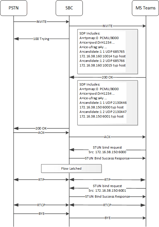

When you have configured this feature, applicable call signaling proceeds as follows:
  1. The Enterprise SBC initiates ICE operation when it receives an INVITE that includes SDP with ICE attributes, effectively asking for an ICE call setup. This INVITE would also include two media candidates.
  2. The Enterprise SBC sends its own INVITE towards the callee, requesting ICE and providing two media candidates.
  3. If the callee can support ICE, it responds by accepting the call.
  4. After accepting, the callee issues an RTP STUN request to the RTP port advertised by the Enterprise SBC.
  5. Having received this request, the Enterprise SBC replies with a STUN Bind Success Response and instantiates the RTP and RTCP flows. The system can then begin transmitting RTP and RTCP between the negotiated ports.
  6. The callee issues an RTCP STUN request to the RTCP port.
  7. Having received this request, the Enterprise SBC replies with a STUN Bind Success Response.
  8. When the callee sends periodic RTCP STUN requests, the Enterprise SBC replies with success responses. These exchanges can be understood as a keepalive function.
This call flow depicts the SBC supporting an ICE call setup that uses two ports.

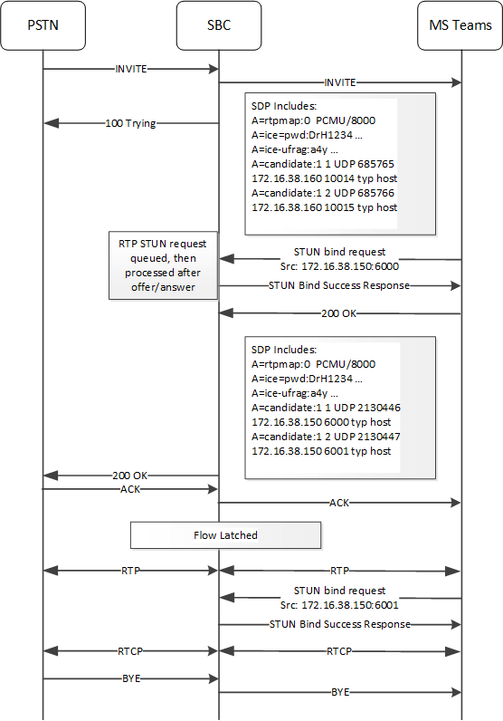

Early STUN Bind Requests
In some call flows, the ICE end station may issue a STUN bind request prior to the call's 200 OK. In these cases, the Enterprise SBC behavior is dependent on the type of bind request.
The call flow below presents this scenario with an RTP bind request. In this case, the Enterprise SBC is able to latch the flow and start sending/receiving RTP media as soon as the 200 OK arrives. The call flow below also has the RTCP bind request arriving after the RTP flows are operational. The Enterprise SBC responds by setting up the RTCP flow upon its successful bind reply.
This call flow depicts the SBC supporting an ICE call setup that supports RTP flows before the RTCP STUN bind request.
If, however, the early bind request was for RTCP, the Enterprise SBC would not queue the RTCP channel for setup after the 200 OK. In this case, the Enterprise SBC needs to wait for the RTP bind request and issue a successful reply. As soon as the RTP bind request is successful, the Enterprise SBC starts passing both RTP and RTCP media.
