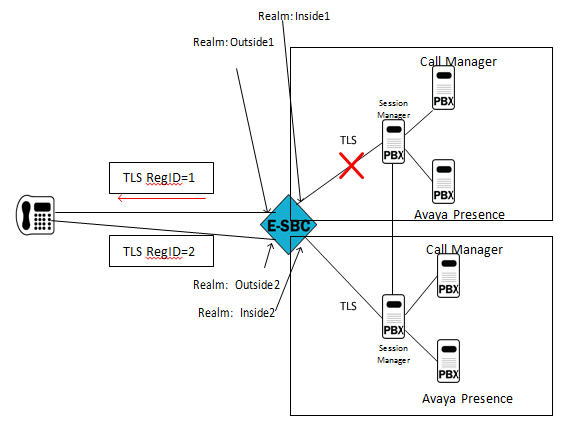

How Avaya Session Manager (SM) Redundancy Works
To support Avaya SM redundancy, you configure multiple realms on the access side and the core side of the Oracle Enterprise Session Border Controller. These realms create the primary path and backup path for accessing a redundant Avaya SM.
Consider two Avaya SMs deployed for redundancy. You configure a core side realm for each Avaya SM and you configure two access side realms. Each access side realm is associated with the applicable core side realm, to which a UA sends registration messaging. The following illustration shows this configuration.
Supporting Avaya Session Manager redundancy.
The operational scenario consists of the Avaya SM infrastructure providing configuration information to the UAs. The information includes the 2 proxy addresses, targeting the Enterprise SBC access-side interfaces. The UA knows which proxy is for the primary path, and sends initial REGISTER messages by way of that path. While the primary Avaya SM is up, the UA manages all registration exchanges, including refresh and re-register procedures, on the primary path. If the primary Avaya SM stops responding, the infrastructure informs the UA that it needs to register with the backup Avaya SM. The UA registers with the backup Avaya SM using the backup path.
The UA, by way of configuration, populates the backup registration and subsequent registration messages so that the Avaya SM infrastructure knows that the registrations are for the same UA. Key elements of the messaging and their use by the Avaya dual registration infrastructure include:
  • reg-id - A contact header field parameter value that specifies individual registrations. UAs use unique reg-id values to specify registrations for individual flows.
  • instance-id (+sip.instance) - A URN within the contact header that specifies a UA instance. UAs use the same Instance ID information in REGISTER exchanges to indicate that the registrations belong to the same UA.
  • Route - The target proxy for the message. The UA uses route headers to define the separate paths to the Enterprise SBC.
The Avaya SM uses reg-id in conjunction with instance-ID to manage dual registrations. By keeping instance-ID the same and sending a new reg-id, the infrastructure recognizes that a redundant registration was generated because a session manager switchover occurred.
Normally, multiple reg-ids based on a single contact would trigger a "move" procedure. The presence of a single instance-ID tells the infrastructure that the reg-id change does not indicate a move.

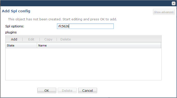

You can also configure the rfc5626 option using the Web GUI. The procedure consists of simply opening the spl-config dialog, adding the SPL option, then saving and activating.
This screenshot shows the Web GUI's spl-config dialog box.

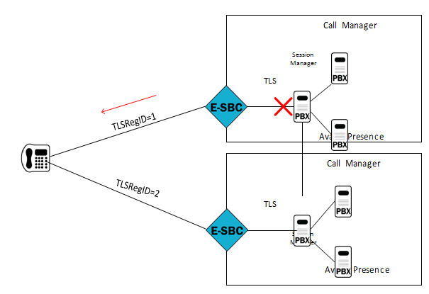

Avaya Client Failover
Avaya telephones (clients) require notification when the connection between the access Oracle Enterprise Session Border Controller (Enterprise SBC) and the Avaya Session Manager, which provides client subscription and registration services, stops responding. In the absence of such notification, the Avaya client can become unreachable for up to 24 hours. Oracle addresses this problem by enabling the Enterprise SBC that loses connectivity with an Avaya Session manager to transmit a TCP/FIN(ish) to all Avaya clients previously supported by the unreachable Session Manager. The TCP/FIN alerts clients of the need to re-register when connectivity to the Session Manager is restored.
In addition to issuing alerts to impacted clients, the Enterprise SBC also deletes all registrations associated with the out-of-service Session manager from the Enterprise SBC registration cache.
The following diagram shows atypical Avaya topology consisting of a single Avaya client (a telephone), a single Enterprise SBC, and a single Avaya Session Manager that provides subscription and registration services for the telephone. If connectivity between the Enterprise SBC and the Session Manager is lost, the Avaya client requires a TCP/FIN(ish) message that alerts the client to invalidate its subscription status and to re-subscribe when the TCP connection becomes available. Without receipt of the TCP/FIN, the phone remains unaware of its state change and will not receive notifies from the Session Manager until it re-subscribes (which by default is 24 hours later).
An Avaya Session Manager client waiting for the network to support re-registration.
The Enterprise SBC supports redundant access topologies, based on RFC 5626—Managing Client-Initiated Connections in the Session Initiation Protocol (SIP). This topology accomplishes redundancy by registering an Avaya telephone to multiple Session Managers, as shown below.
Establishing redundancy to minimize Avaya Session Manager client downtime.
In the preceding diagram, the Enterprise SBC maintains connections with two Avaya Session Managers, which both share state information and act as a registrar and proxy for the Avaya telephone. The client establishes redundancy with two TCP connections to the domain. Redundant connections are differentiated by a unique reg-id contact header field parameter. In the preceding illustration, two reg-ids TLSRegID 1 and TLSRegID 2 are created for different Session Managers on the same Enterprise SBC. If a Session Manager goes out-of-service, the Enterprise SBC sends a TCP/FIN message to the Avaya client for the reg-id associated with the unavailable Session Agent, and deletes all associated registration cache entries.
