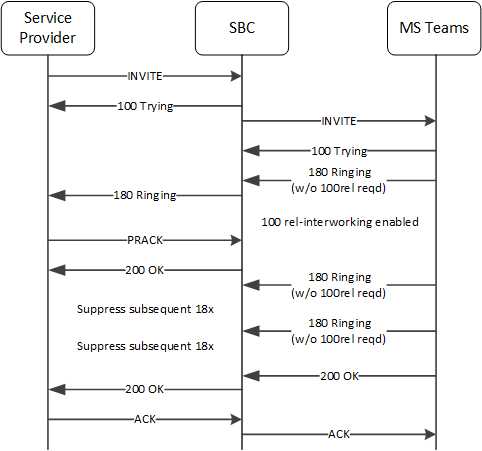

Scenario-1: MS Teams – Media Bypass Enabled, single device login
This scenario includes the Enterprise SBC forwarding the first 180 response to the UAC side (Service Provider) and then suppressing subsequent 180 responses received from the UAS side (MS Teams). This scenario requires that you enable the Drop-Additional-Provisional configuration in the spl-options on the egress side.
This image depicts the system suppressing extraneous 180 messages.

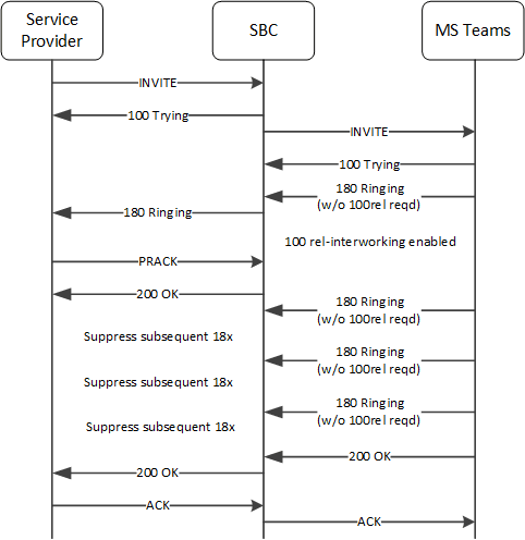

Scenario-2: MS Teams – Media Bypass Enabled, multiple device login
In this scenario, the Enterprise SBC forwards the first 180 to the PSTN from MS-Teams and suppresses all subsequent 180 messages. In this case, there are multiple endstations responding to the INVITE within the MS Teams domain.
Any device that previously send a 180 can send the 200 OK. If a 200 OK comes from the device where the respective 180 ringing was suppressed, the Enterprise SBC forwards the 200 OK to the service provider as soon as it receives it from MSTeams. In this case, the service provider must be configured to be aware that the 200 OK may have a “to:” tag that does not match the previous 180/183 received.
This image depicts the system suppressing extraneous 18x messages from multiple endpoints.

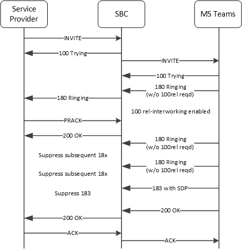

Scenario-3: MS Teams – Media Bypass Disabled
This scenario includes the Enterprise SBC forwarding the first 180 response to the UAC side (Service Provider) and then suppressing subsequent 180 responses, including 183 response from the UAS side (MS Teams). This scenario requires that you enable the Drop-Additional-Provisional SPL option on the egress side.
This image depicts the system suppressing extraneous 180 and 183 messages.

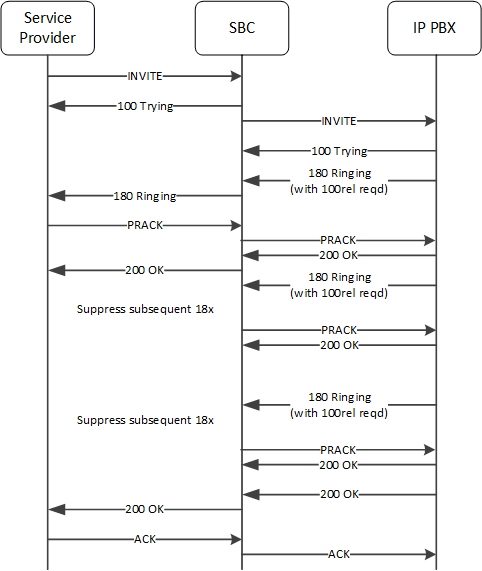

Scenario-4: 180 Response received with 100rel required
In this scenario, the Enterprise SBC forwards only the first 180 with 100rel required while suppressing the subsequent 180s. In addition, the system sends PRACKs to the IP-PBX for the suppressed 180s, and accepts the 200 OKs for those PRACKs.
This scenario requires that you enable 100rel-interworking on the egress sip-interface to manage the 180/PRACK sequences with the IP PBX. Similarly, you must enable 100rel-interworking on the ingress sip-interface to manage the 180/PRACK transaction with the service provider.
This image depicts the system suppressing extraneous 180 messages in addition to supporting 100 release.
